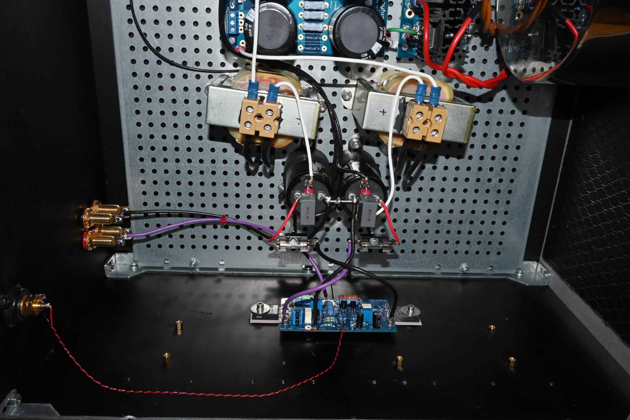

I tested the two F8 amps in my system after fine adjustment of offset / Iq but no music yet. No smoke either so far but a lot of hum. With input shorted total silence. Could it be the 15R GBR that causes this in my system setup?
It is the same system as with Lazy Singing Bush which were very silent.
Think I will try tomorrow and take out the GBR in one channel (and make a short instead) and check if this helps?
In all other amps I have built the input signal Gnd has always been the PSU Gnd. M2X were in the boxes before and those were silent as well.
Could be interesting to hear other F8 builders if they have installed GBR resistor or not.
GBR are there to help/prevent possible GND loop in case of using common PSU for both channels
if building dual mono, GBR can be either 0R or 15R (as per schm), without any functional or sound difference
now, post pics how you did it
my F8 are dead silent even on crummy T-Bed
and I believe I'm not only one who already built it without problems

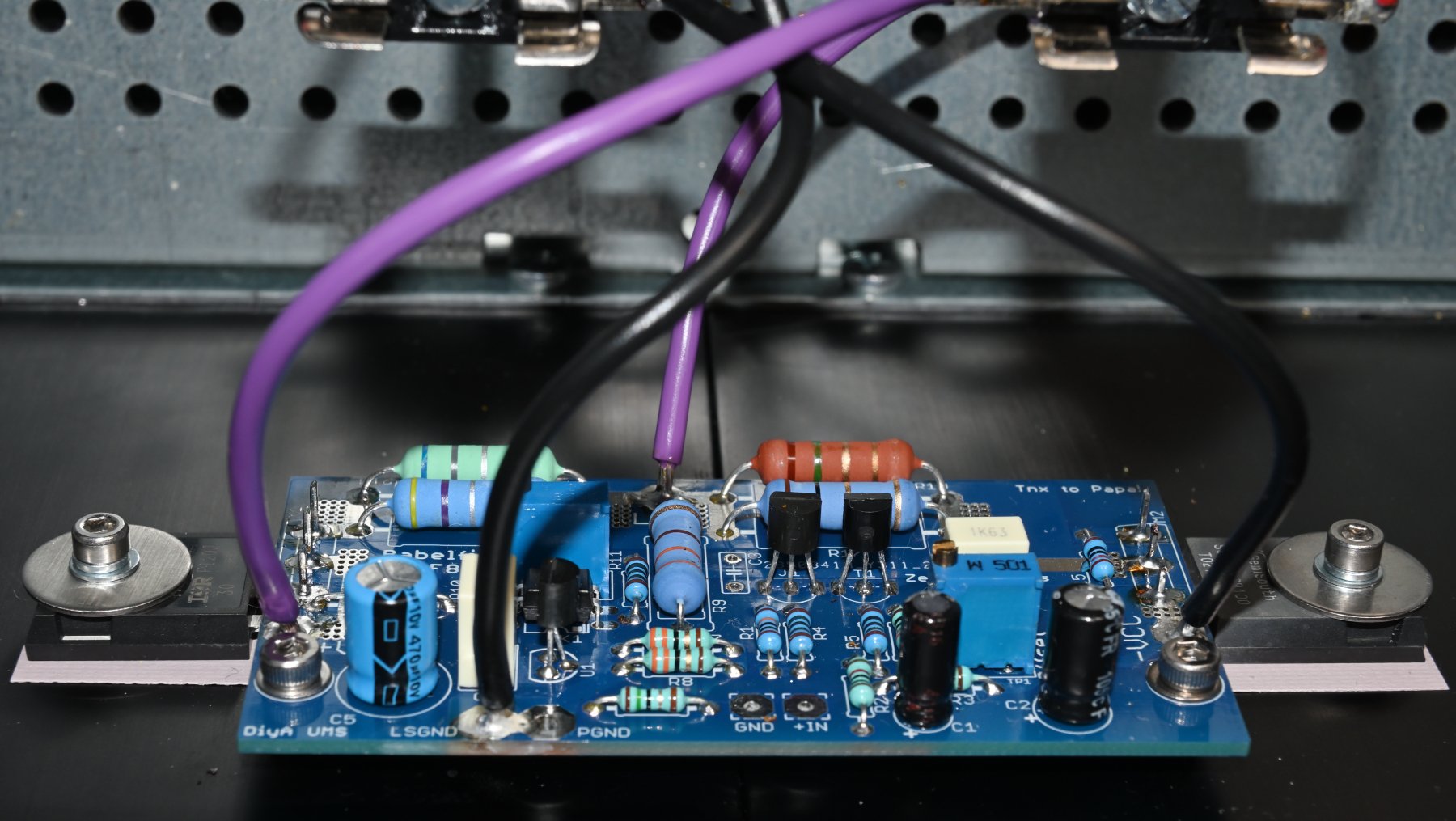

PSU Gnd is at the two black capacitors. PSU Gnd goes to chassis via a NTC (not in picture).
Same PSU as used for M2X which where silent.
Speaker return goes to cap and from there a short wire to PSU Gnd at PCB.
The RCA cables I use for signal is a type with a twisted pair and then a metalized polyester screen that is connected in one end only (at source end).
It is not a traditional coax.
M2X is passive gain/no NFB thingie
even if B. F8 isn't massive gain gadget, it's still more criticall than M2
anyhow, sole thing I can see is - you took GND from PSU to channel pcb from dirtiest place - cap pin
if not done in some other way, where GND takeout is actually taken from point physically away of pulsing currents paths, at least take that wire from cap pin to exact middle of solid core bridge, connecting two caps
there is hopefully "silent" point, where current pumping to left and right cap are nulling each other
and take speaker neg from channel pcb, not from PSU

The PSU is a CRCLC so the two caps are after the DC chokes. So should be silent point there.
The CRC is the DIY store PSU boards which is not in picture. Ripple is very low. A few mV.
The hum was massive so moving the speaker return wire from caps to PCB should not make a massive difference?
Also with no input amp is silent so it is not self generated hum from PSU itself.
As the GBR is not needed this could be the first try?
I am here to learn so curious to see what difference it makes to short the GBR.
It is first time I see such a configuration. Normally the ground breakers are between signal Gnd and chassis (at least the ones I have seen in this forum).
But here it is between the PSU Gnd to a new "virtual" signal Gnd.
I will report back tomorrow if there is any difference. If not I will look at the other options.
You should still install the "ground lift" thermistor (or alternate versions). The Hum Breaking Resistor is an option that is normally effective if there is a cross channel hum problem in stereo amplifiers that share a power supply between channels. And it is in addition to the "ground lift", not in place of.
