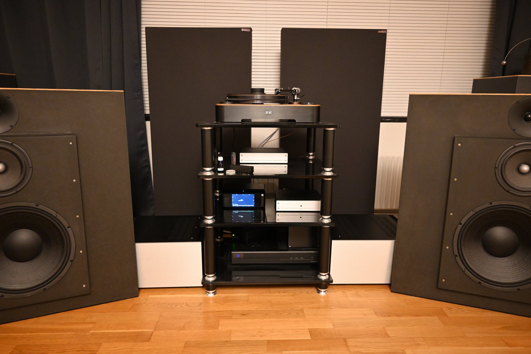

I have now played my F8 mono blocks for some time. I am extremely satisfied. It is the most silent setup I ever had.

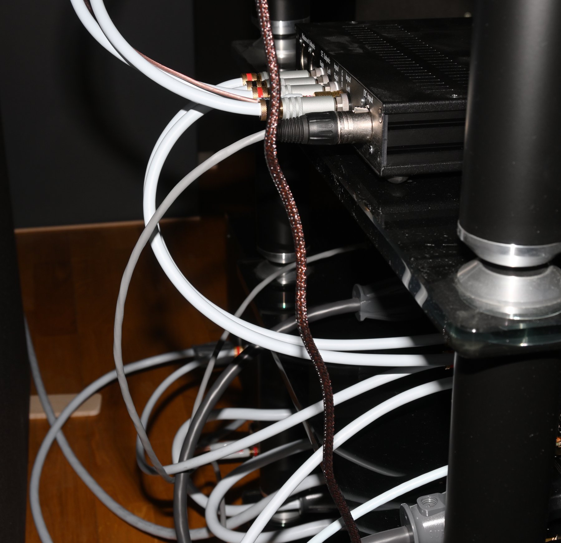

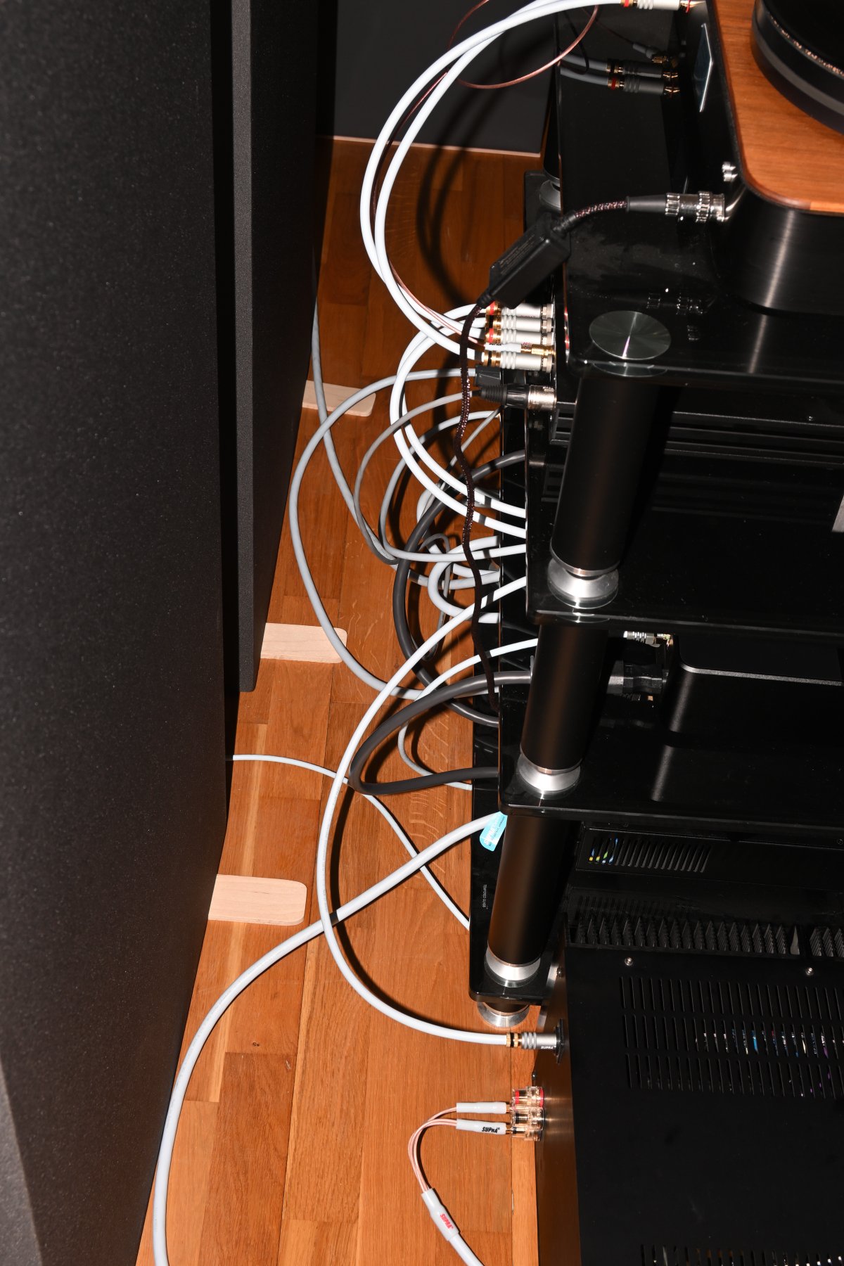

Some images attached from my setup. I spend some time on the connections (RCA, mains cables) so they are only as long as needed.
All mains cables screened. It maybe looks like a mess but it is quite well organized I think.
My source is a Bluesound Icon network player (Qobuz hi-res agreement). From router I use a Supra CAT8+ cable. Should be fast enough for Hi-res music.
Output from Icon goes directly to F8 (0.6-0.7m RCA cable).

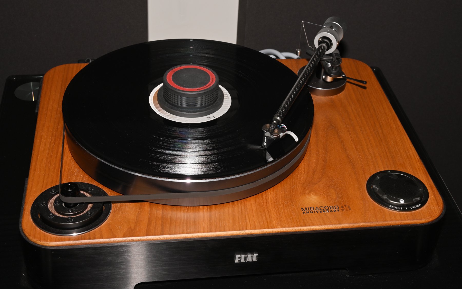

Other source is turntable. I use Pearl3 riaa and output goes into the analog input of Icon (0.3-0.4m RCA cable). An ESS ES9826 SABRE® ADC takes care of that. That solved the volumen problem. I use digital volumen. This turntable setup is by far the most silent I have had. Then from Bluesound app I can switch between the two sources.
3D imaging is extremely good and I like the "silence" around instruments. It is easy to pinpoint every instrument / voice in the 3D image.
For normal critical listening level vol is about 65-70%. For just nice background level vol is about 40-50%.
Treble is crisp and still "silky".
Difficult to describe sound. Only solution is to come and listen 🙂
