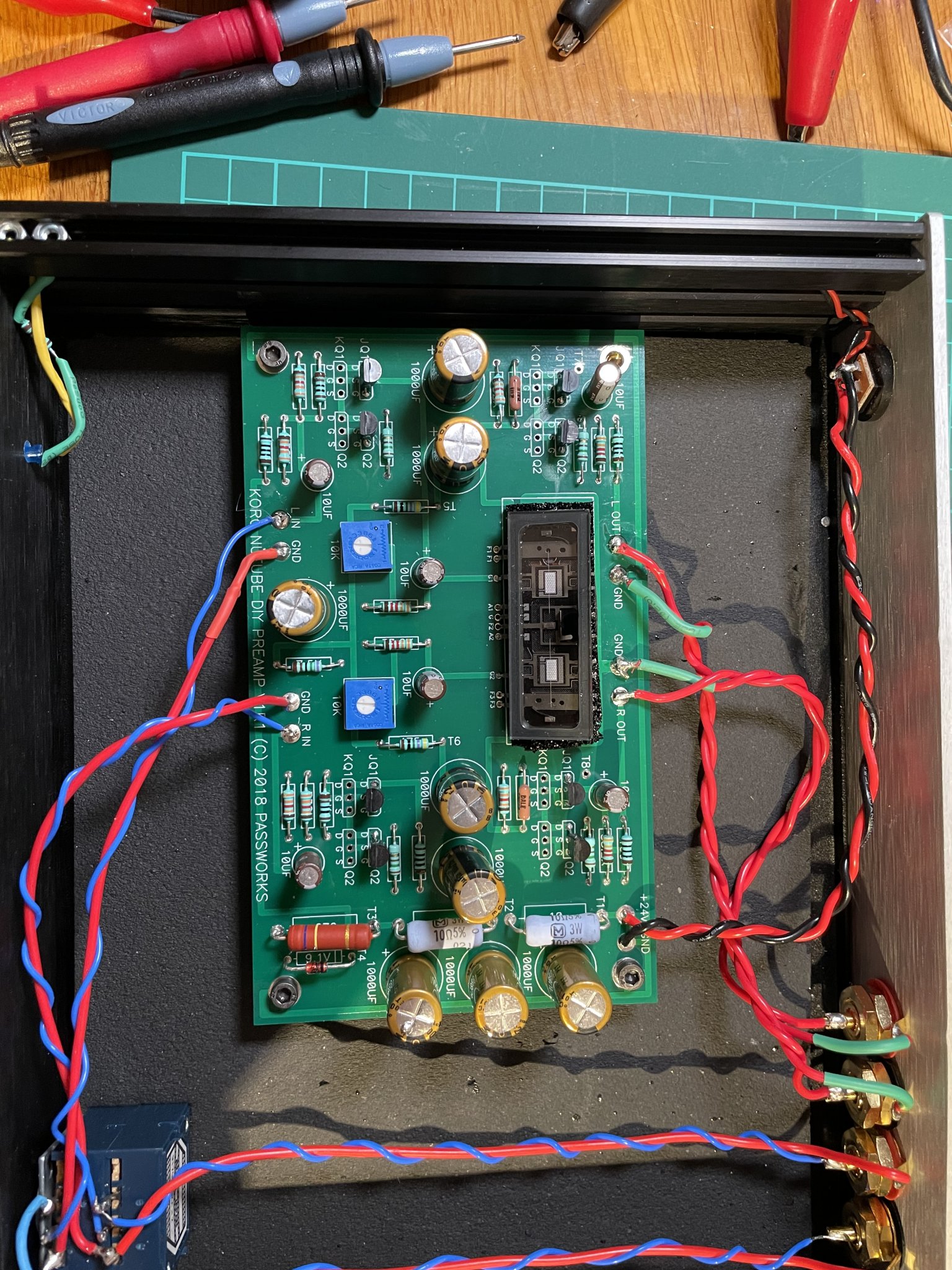

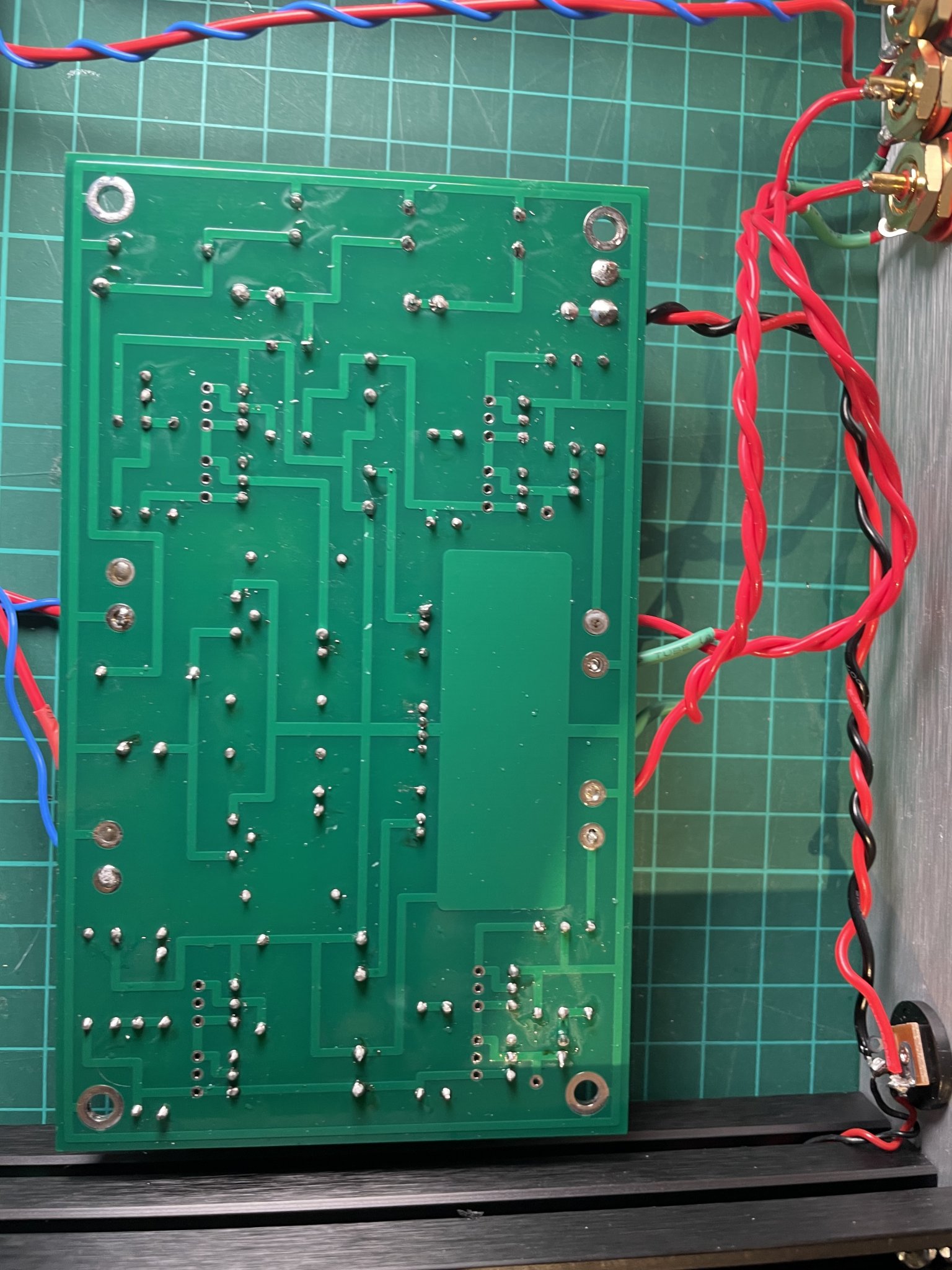

Hi everyone,
I’m returning to build my 3rd pre-amp after a year of inactivity ;-) I’m stuck troubleshooting it and I’d like your advice.
I started to build as per the guide from 6L6 - after stuffing the first part (PSU) the Zener is showing 9.5V and 24V accross as per the guide. Then I carry on stuffing the other parts and wanted to test it. The Zener is now in mini volts… T7/T8 are showing almost 19v (!). I disconnected everything and trying to find the mistake(s) but so far I cant’ find it. All resistors have been tested before soldering and I check again. The cap look all ok (and they are new).
Any help will be greatly appreciated!

OK, that was trivial try 🙂
recheck soldering from bottom side, possible to have some solder whisker
Is that the lowest voltage you can get after adjusting the trim pots? Mine was ~19V until I set the trim pots.T7/T8 are showing almost 19v (!).
