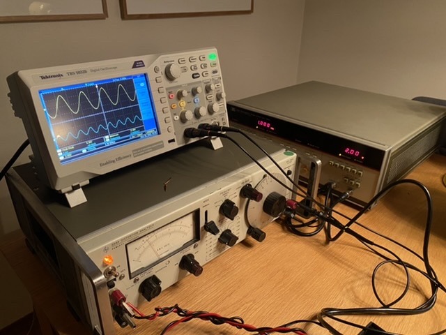

Few pics. Disregard my 18V6 advice. It oscillates at that voltage. I did not succeed in adjusting for a clean neg 2nd harmonic, with nice sines. The cleanest sines are @ stock 9V5, positive phase 2nd harmonic. Thank you, Papa 🙂 Reference is reference.
old school equip up working for the first time. For me, an achievement.

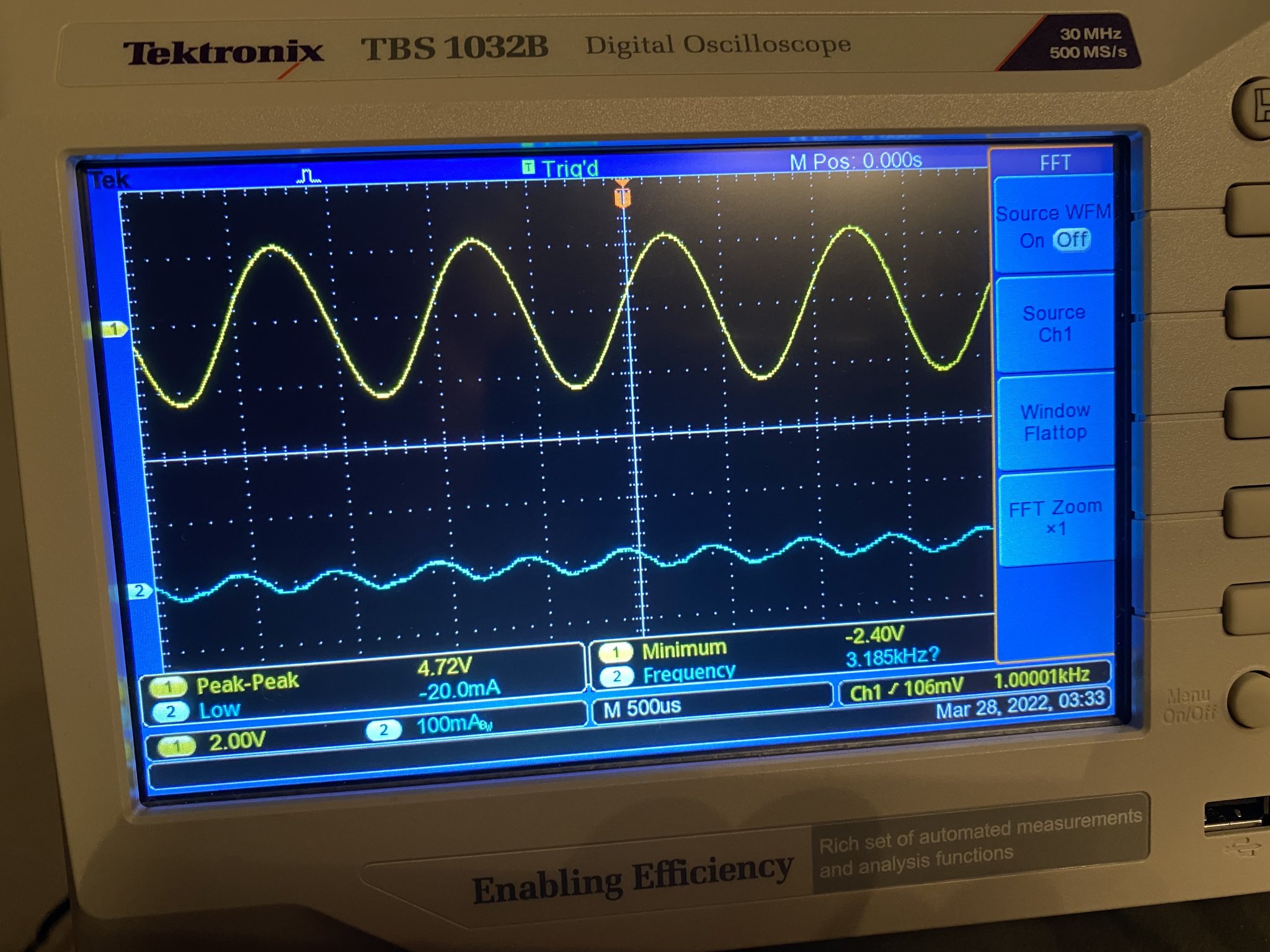

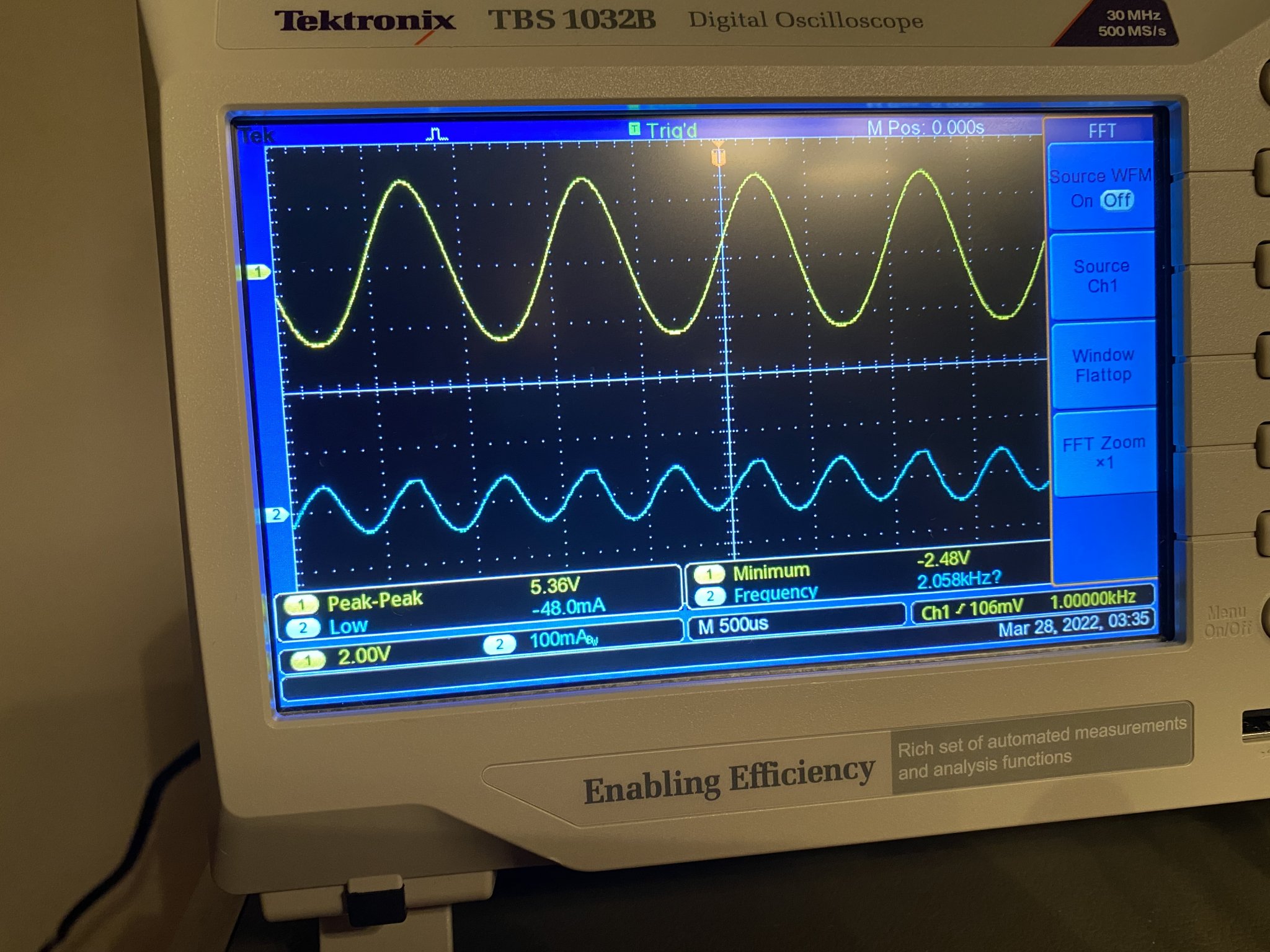

notice the 3rd harmonic adjustment, @ approx 13V7. It is possible to adjust distortion even lower, but not with a clean sine.
then the happy positive phase 2nd harmonic, meaning negative after inverting @ speaker posts.

Audio tested it today, and it is sweet! It literally was layed on the desk on top of paper towel, and no microphonics. Now to cnc mill down the case. Such sweet device, kudos 😊
I’ll try to explain it in greenhorn terms. Easy, since I am one to begin with.I'm on a learning curve with oscilloscopes. I have a Hantek desktop 2 channel scope of the same fundamental form-factor as the Tektronix.
What's the basic concept to set it up to show the primary signal and the second harmonic as I see there?
The chain starts with the HP signalgen. It sends a 1khz sinewave to the preamp inputs. In this specific example, the output is 2Vrms (signalgen is a bit unstable, unsure if it actually sent out 2V).
Then I set the preamp, using the pot, to approx 1VAC output (according to scope it seems I didn’t get this quite right). I connect the preamp output to one of the scopes inputs.
then I tap the preamp output once again, this time to the HP334A distortion analyzer. I adjust the analyzer to the fundamental signal, and then use it to filter out «everything» but the distortion residual waveform.
I send this residual to the other input of the scope. Then I adjust the scope so it shows the two signals as depicted.
I spent some time learning how to do this. Also, a functioning 334A in my area was hard to find. A former employee of Electrocompaniet sold it to me cheap. I consider myself lucky 🙂 Also, this means I don’t need to invest in computer hardware iot find out these things (e.e reconfirm Papa’s design) iow, completely useless
anyways, point is there are easier ways to do this, I am told. And cheaper too. Dunno if they will show residual the same way tho.
i just wanted to do this the old school way.

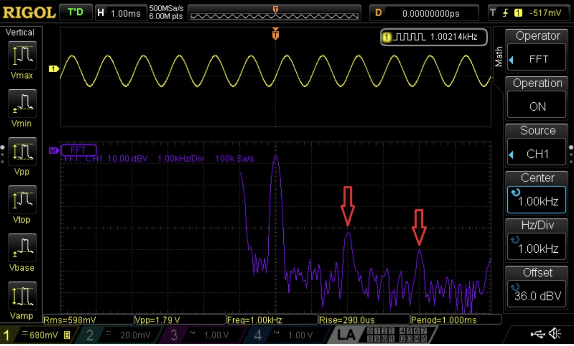

You can use the scopes FFT to show the harmonic spectra too. And you will know the phase of the distortion in most of Papa’s construction. And from there adjust amount. But, it will be difficult to confirm sinewave shapes for fine tuning. There are ways to do this, tho, using just a scope. Or so I have been told. Haven’t gotten there yet 🙂
Edit: I think the 3rd harmonic pic might actually be the 2nd null point. Wil remeasure. damn greenhorns!
