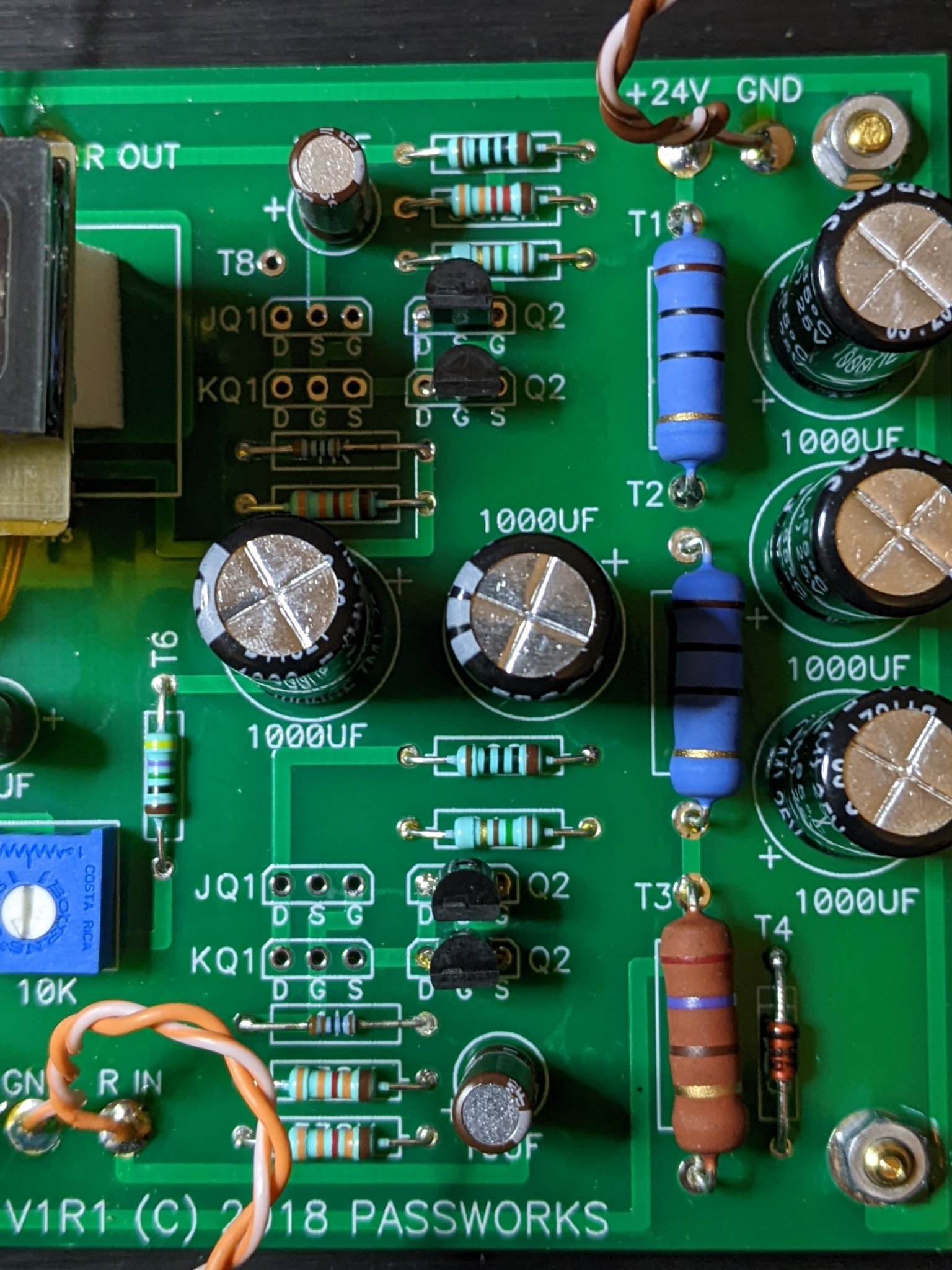

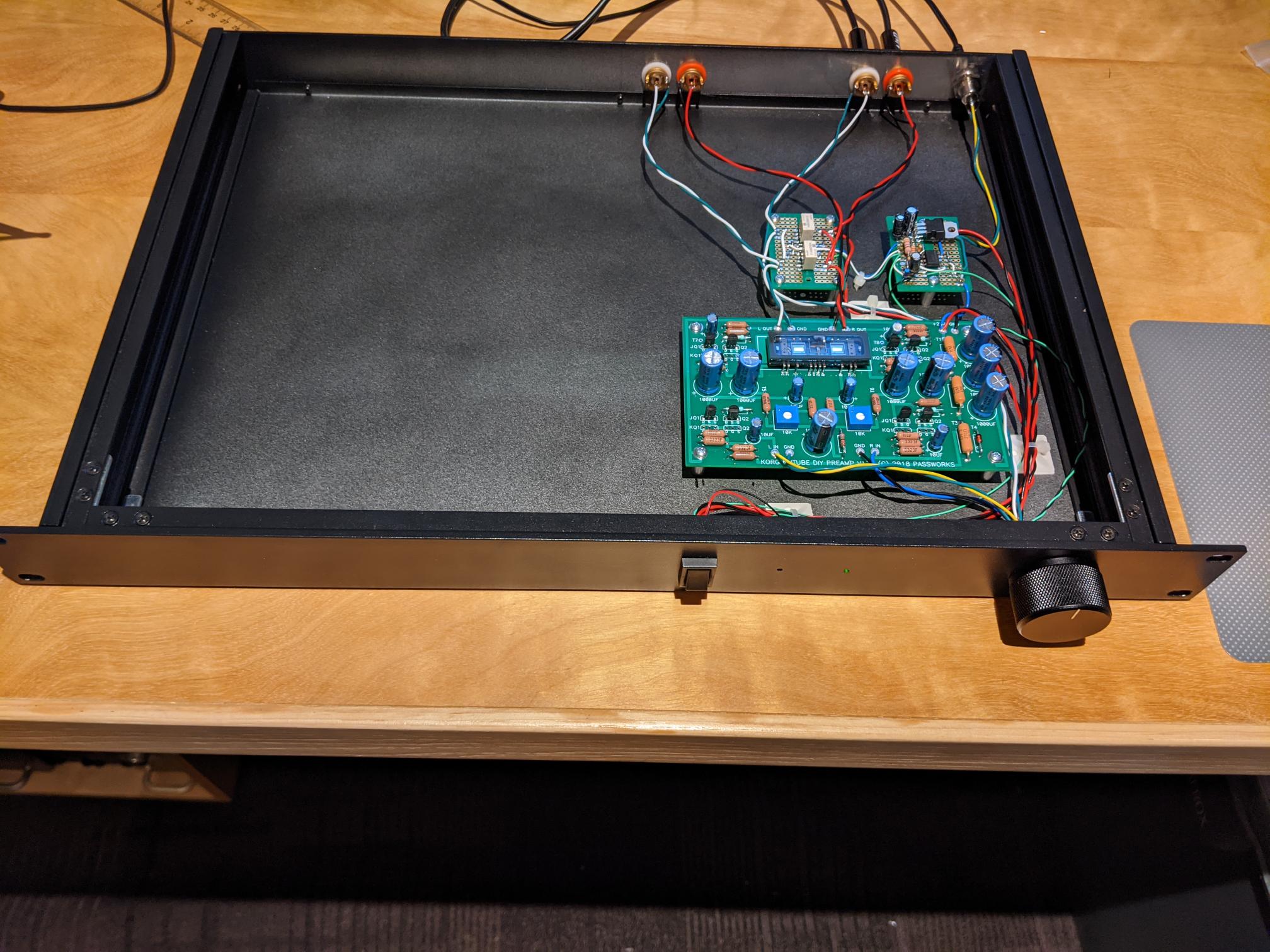

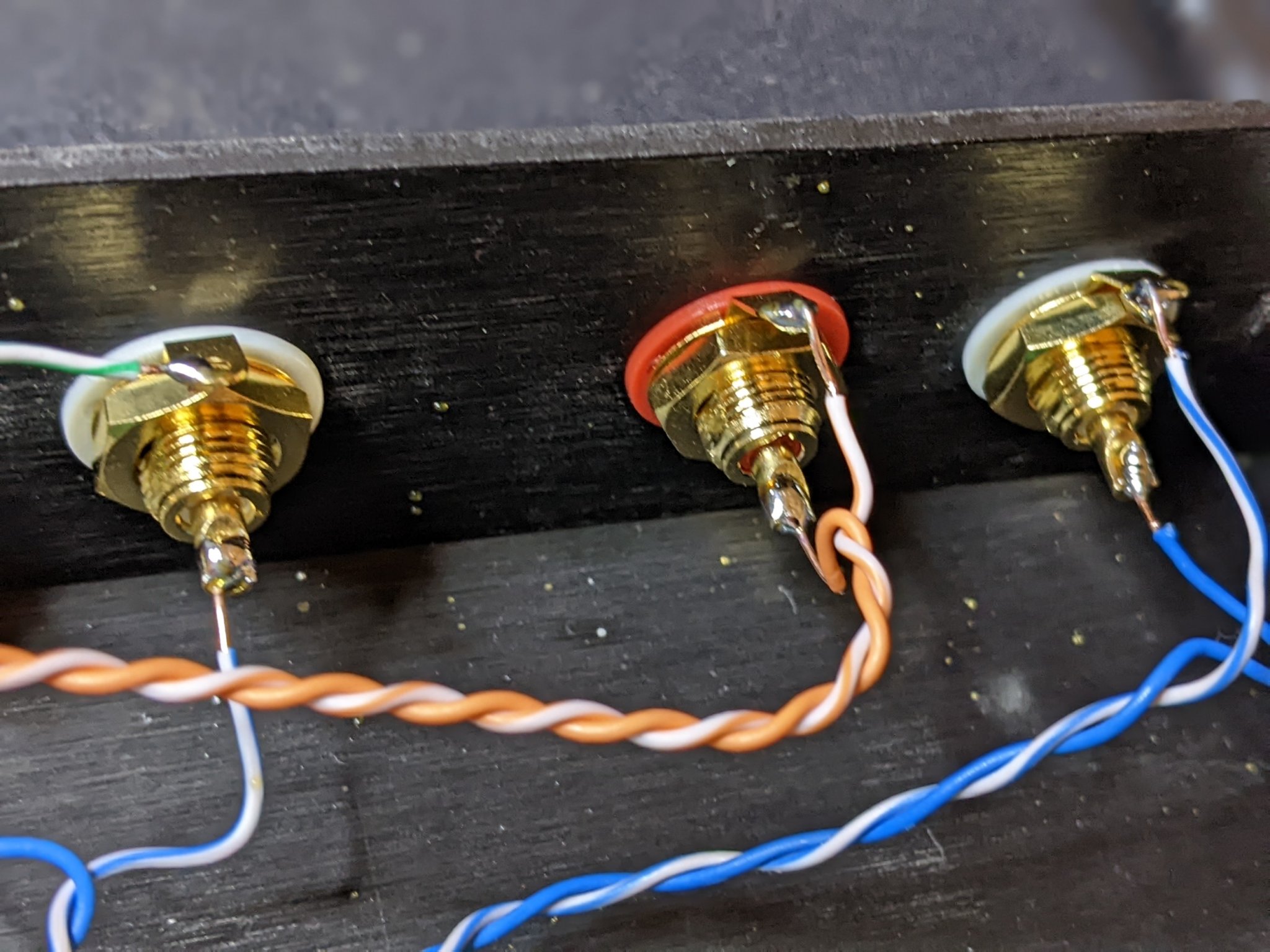

Arcadia234,
1. Was this build from the diyAudio kit, with Q1, Q2, and R1 matched? What is the value of the R1 resistors? What is the voltage across each R1 (meter probe at each end of the resistor), (V1, V2, V5, V6)?
2. Did you measure the voltage at T5 and T6 and were they correct?
3. Did you adjust the pot in each channel to try to get 10V at T7 and T8?
4. What is the voltage across the 332k resistors (meter probe at each end of the resistor), (V3, V4)?
4. Post pictures that show the whole preamp, including wires to inputs, outputs, switches, volume control, and closer pictures of the board.

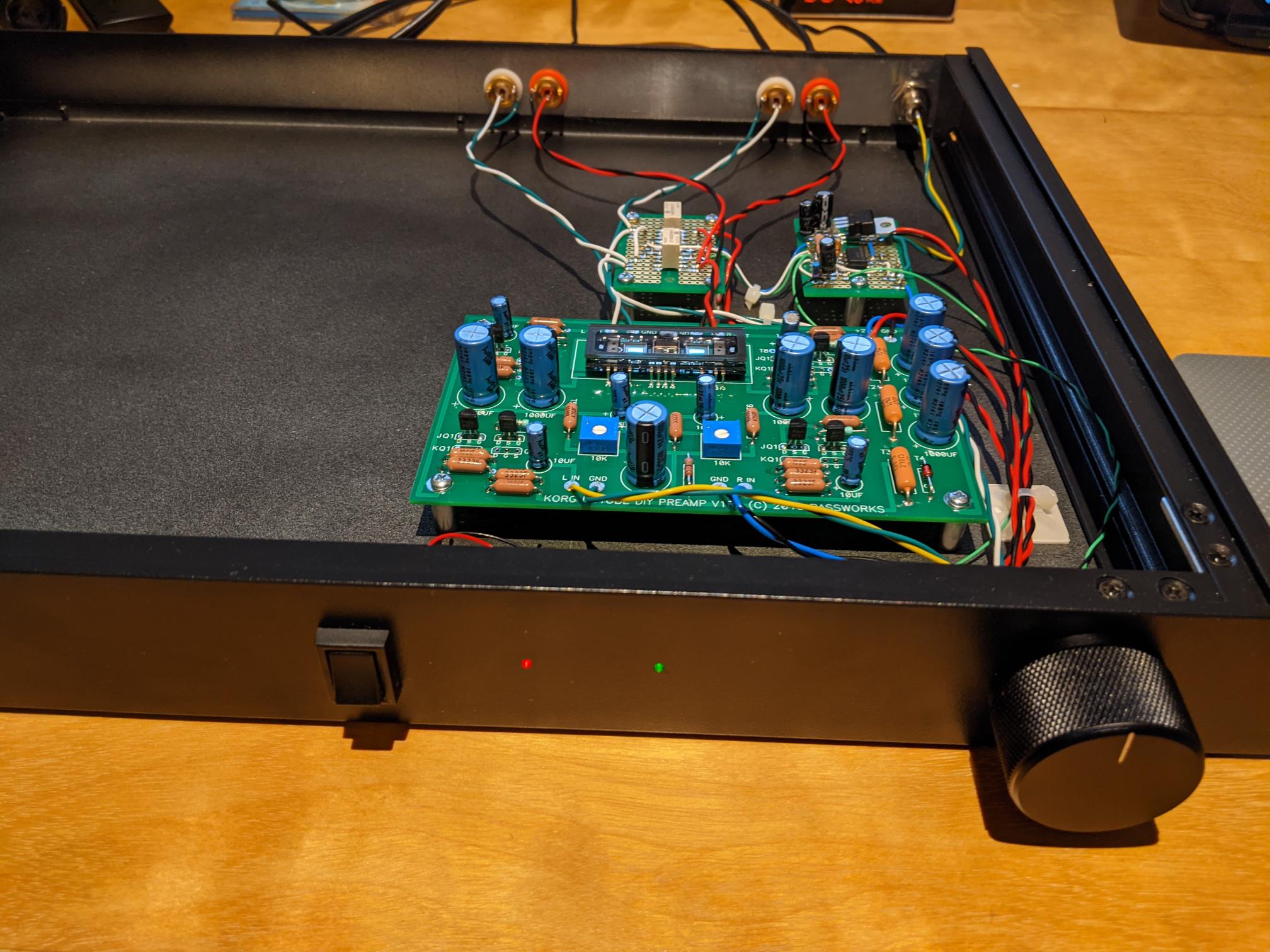

I'm happy to provide photos if you can tell me what you want to see.

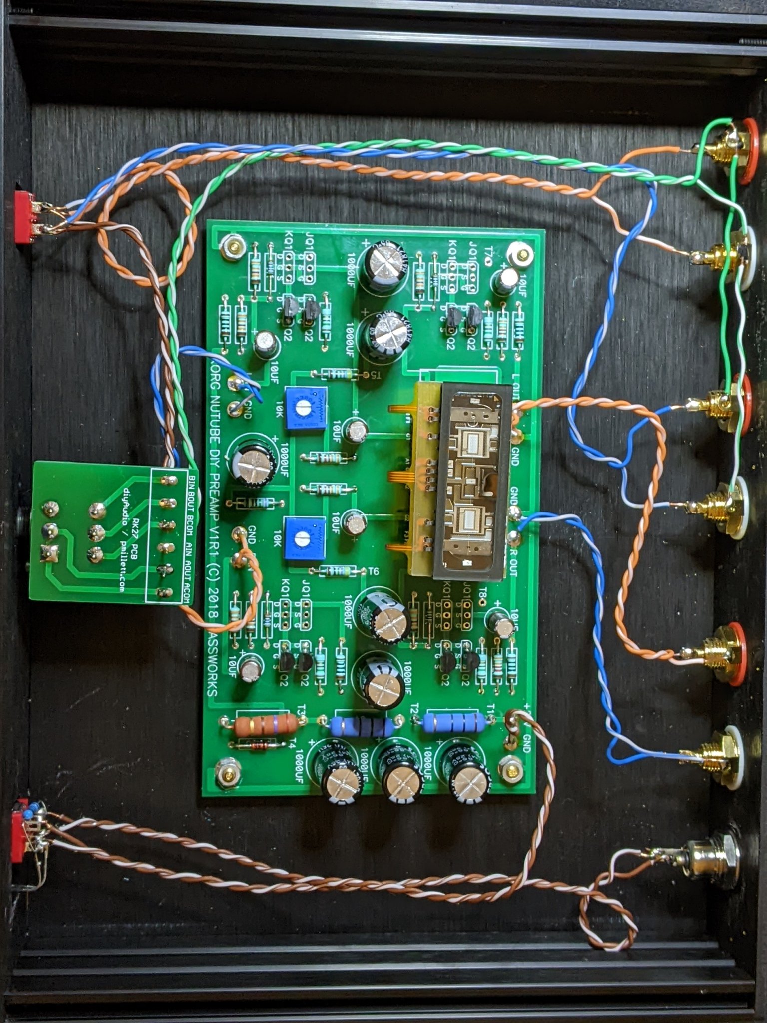

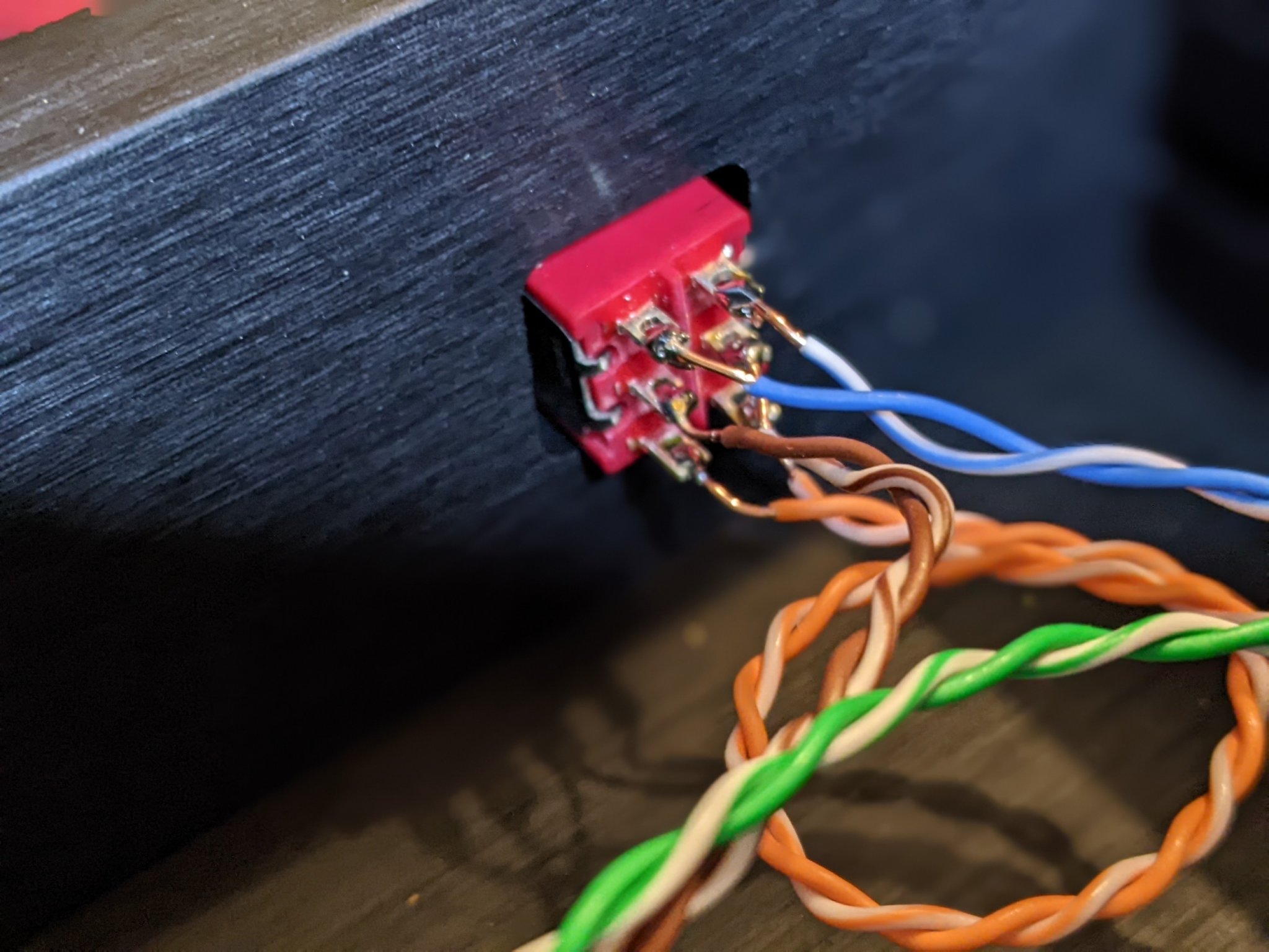

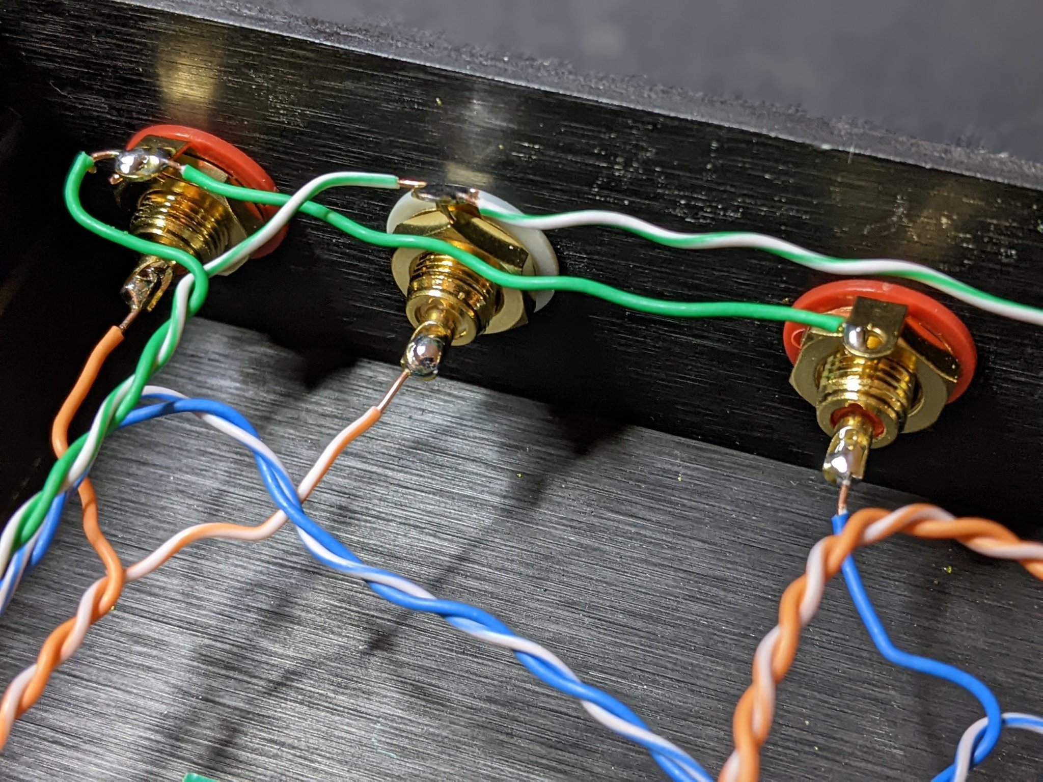

Thanks for the assist, Ben. Glad to have you on board... Board! Get it?Arcadia234,

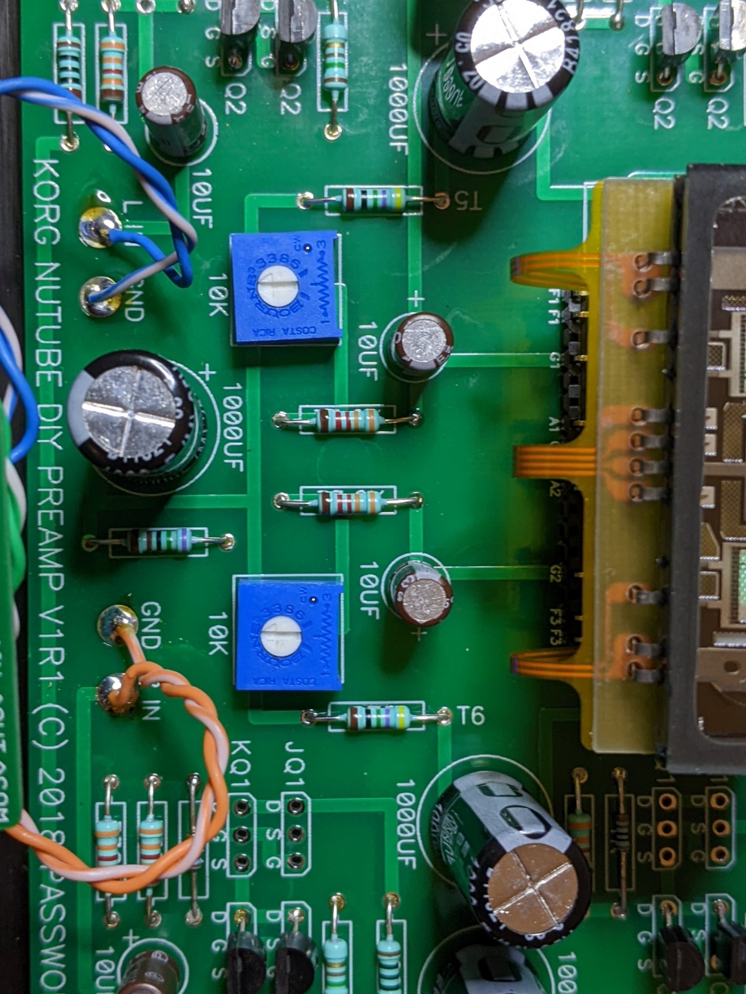

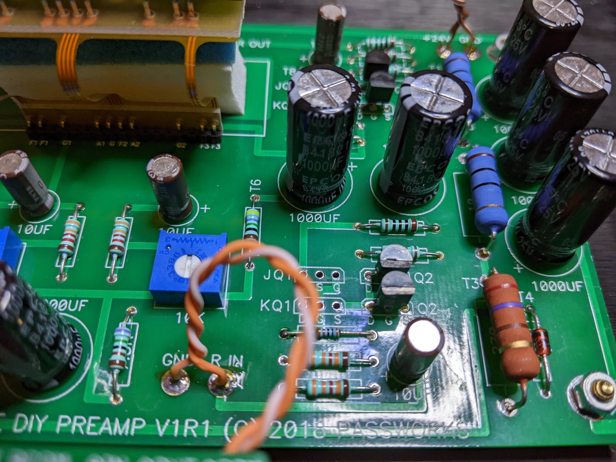

Q: Was this build from the diyAudio kit, with Q1, Q2, and R1 matched?
A: Yes, I bought the kit from diyaudio.com
Q: What is the value of the R1 resistors?
A: 150 ohm (brown, green, brown, gold)
Q: What is the voltage across each R1 (meter probe at each end of the resistor)?
A: right bottom - 66.9
right top - 67.9
left bottom - 65.8
left top - 65.8

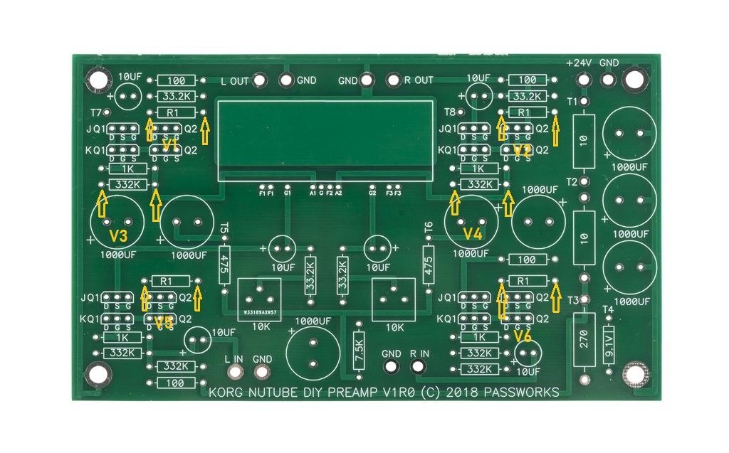

Q: What is the voltage across V1?
A: I don't see any reference to V1 in the schematic or build guide. Please elaborate.
Q: What is the voltage across V2?
A: I don't see any reference to V2 in the schematic or build guide. Please elaborate.
Q: What is the voltage across V5?
A: I don't see any reference to V5 in the schematic or build guide. Please elaborate.
Q: What is the voltage across V6?
A: I don't see any reference to V6 in the schematic or build guide. Please elaborate.
Q: Did you measure the voltage at T5 and T6 and were they correct?
A: T5 - .63
T6 - .64
Q: Did you adjust the pot in each channel to try to get 10V at T7 and T8?
A: Adjusting the pot resulted in no change from 0
Q: What is the voltage across the 332k resistors?
A: The "top" 332k resisters on both sides are 33.1 on my meter (set to V 200k). The rest are -69.6, -72.3, -72.3, -72.3, -72.3, -70.3
Q: What is the voltage across V3?
A: I don't see any reference to V3 in the schematic or build guide. Please elaborate.
Q: What is the voltage across V4?
A: I don't see any reference to V4 in the schematic or build guide. Please elaborate.
And for good measure...
T1 - 23.8
T2 - 23.3
T3 - 22.7
T4 - 8.7

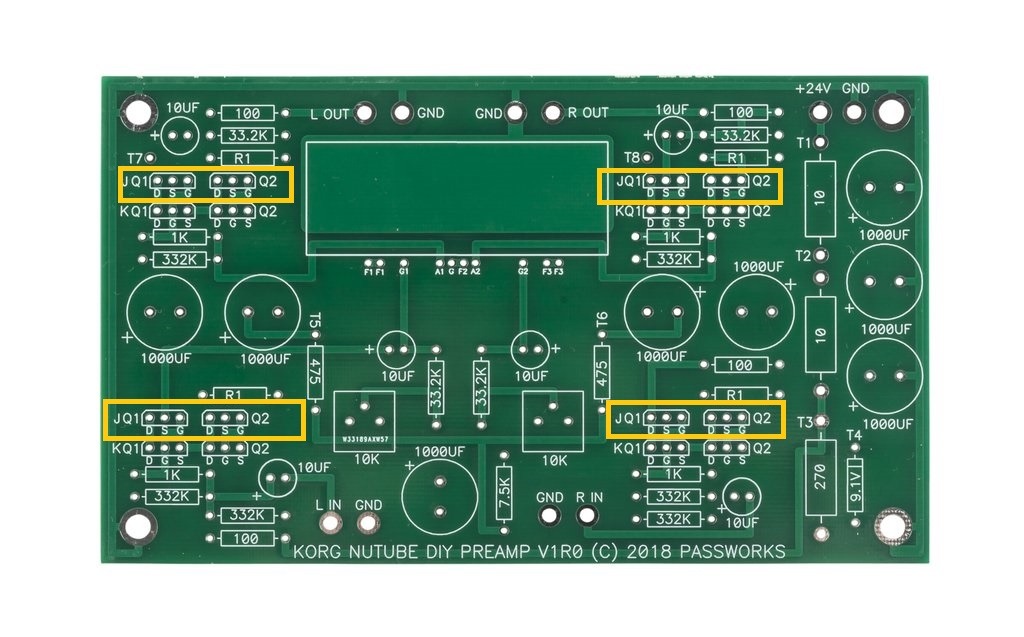

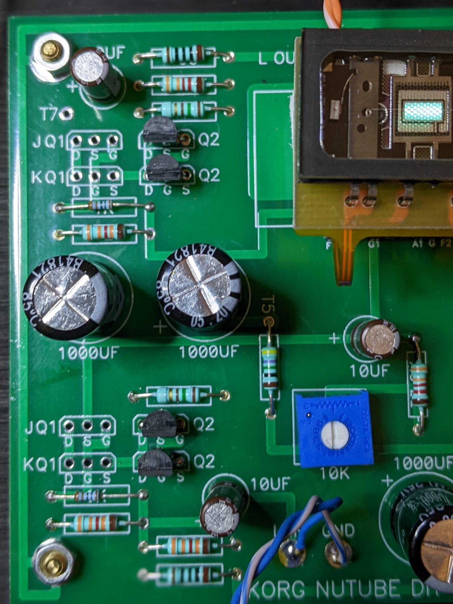

Your transistors are in the wrong positions. You should have populated JQ1 and JQ2, matching resistors and JQ2 transistors go together.
That'll do her. I do recall that section being less than sensical but I was tired and trying to drive on. Reading it now, it makes perfect sense. I suppose a picture is worth a thousand words. Thanks for the help guys.What bloqhed said. See attachment for J113 locations.
Re:V1 to V6: Those were the voltages at the resistors that I marked up on the attachment image of the pcb.

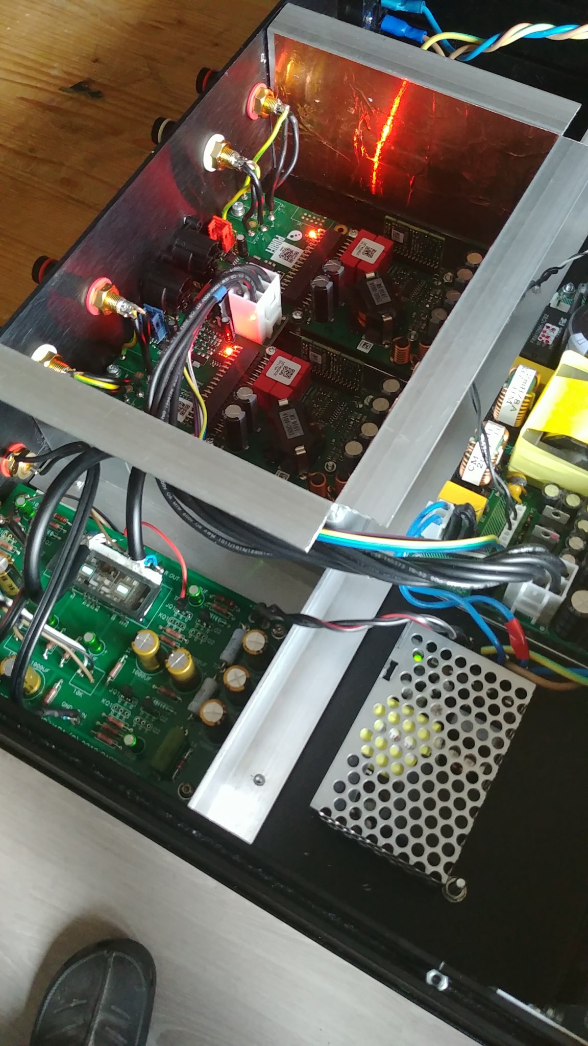

Enjoying my first unit for over a year, decided to build a second one of these. First one was a full kit. For the new one I bought the Nutube and board from diystore. Sourced wall wart, resistors and caps from Mouser, everything else was in the parts bin including volume knob, pot, wires, case and connectors. Built as a single channel buffer but left room for another set of inputs is needed. Using as a buffer, volume at 12 oclock is unity gain.
Added a 12V circuit for relays and comparators. When pulgged in, 12V is always powered and the red LED indicates StandBy. The on switch sends 24V to the main board, and also starts a 16 second timer to allow thumps to clear before the output relays are enabled. Both LEDS are on until the relays enable at which point the red StandBy lamp goes out. Unit can be unpowered (unplugged) and the input will pass thru to the output.
Built it in a cheap 1U rack. Used one side in case I wanted to do something else in the future. Probably will upgrade the PS and add IEC.
