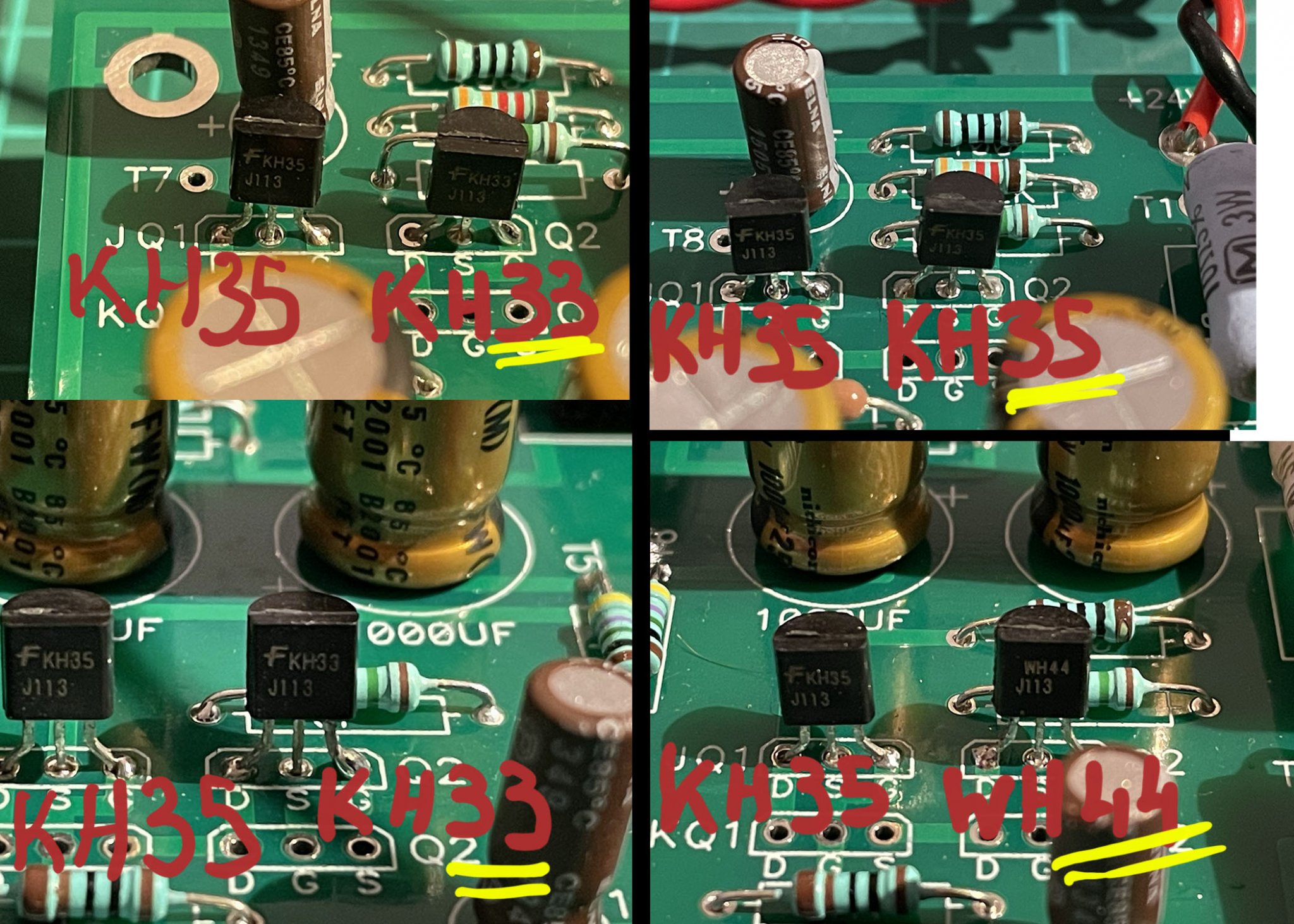

You’ve probably ruled it out, but just for those playing at home: you are using Fairchild jfets, correct?

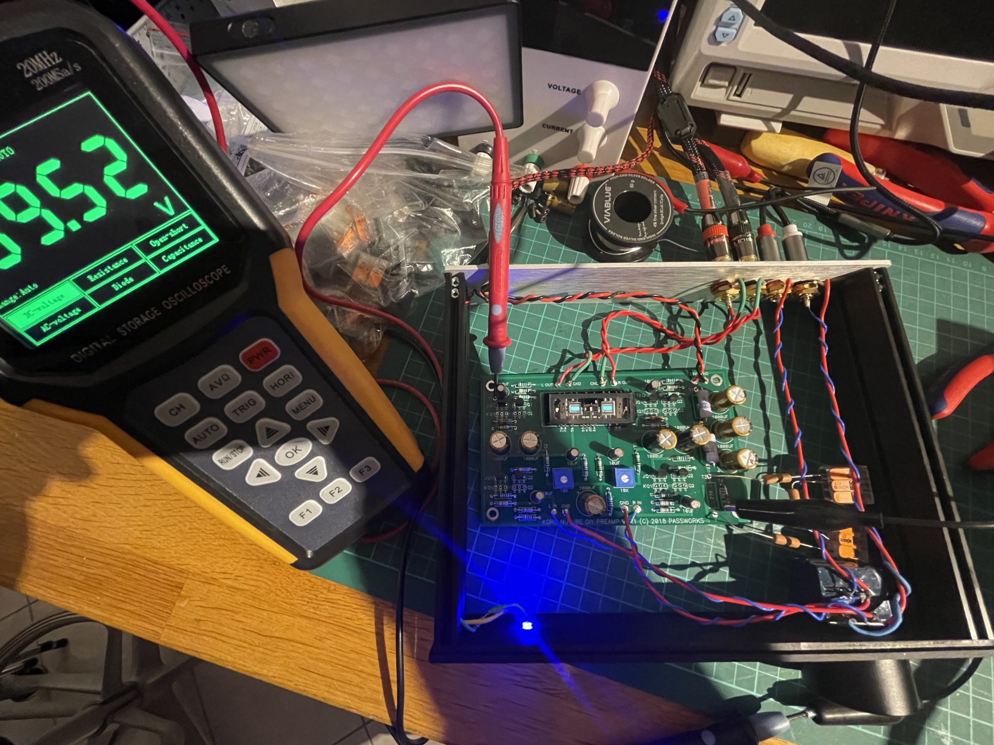

if you don't have 9V1 where it must be, start with that
pull one pin of 9V1 zener out and test it with diode test of your DMM

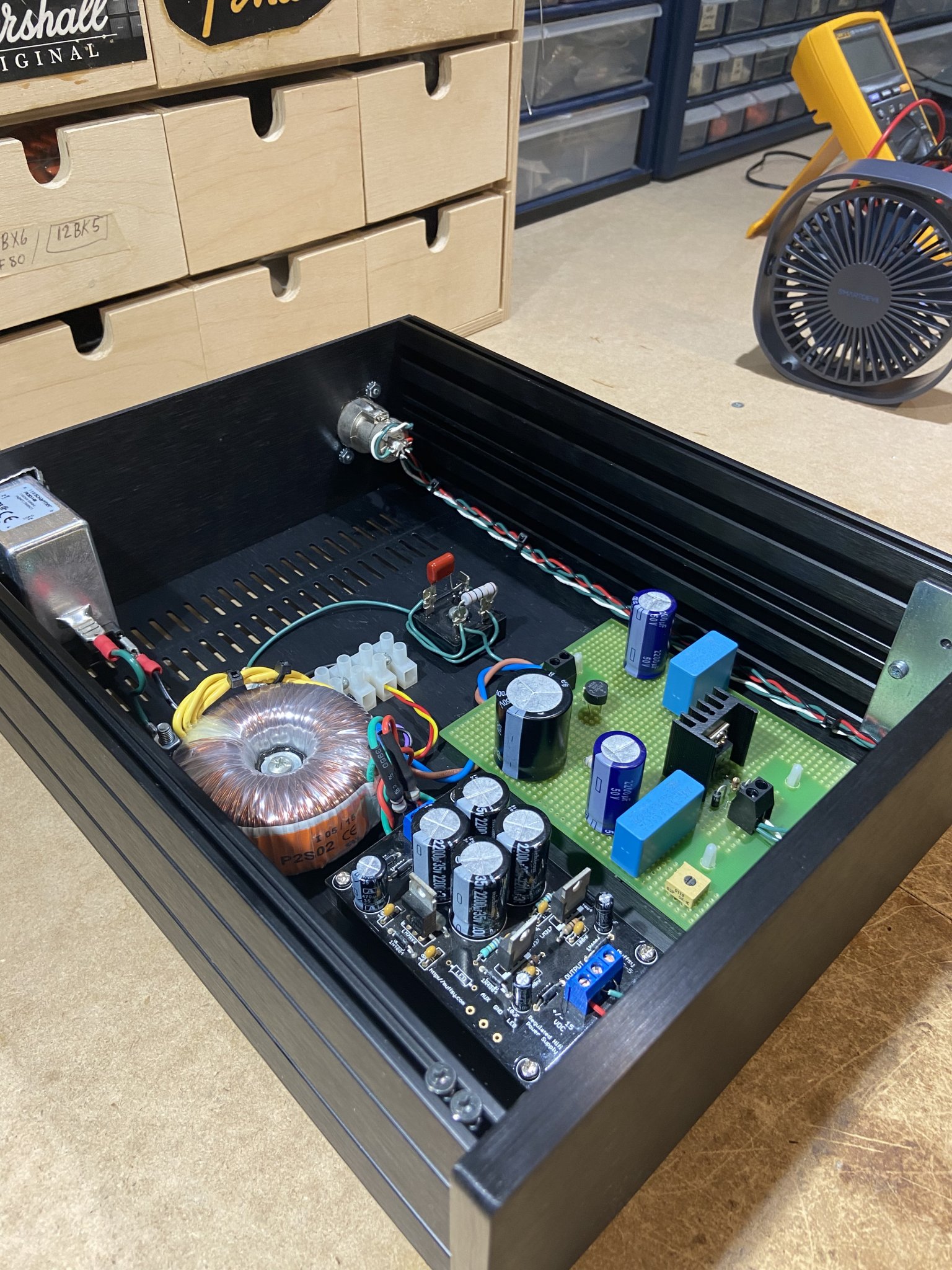

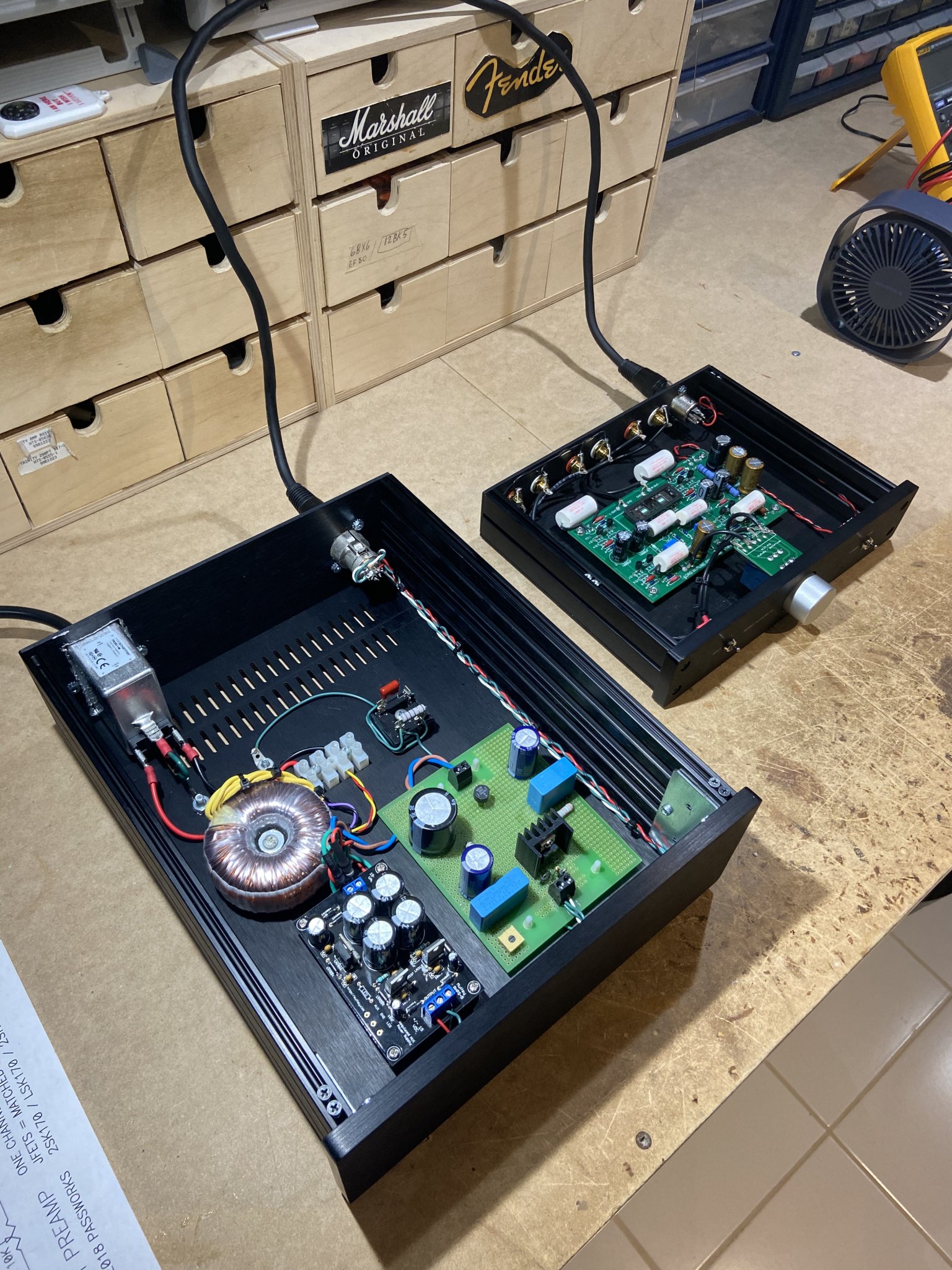

Today I upgraded the B1K PSU.
The external 24V PSU is LM317 based, built on perf board with lots of pre-filtering. I also added a half wave rectifier/regulator PSU PCB left over from another project for 12V/-12V for a Muse volume control (when I get around to ordering/installing!).
Still have T7/T8 at 9.5V. Haven’t got around to experimenting yet. Listening to the new RHCP album now and it sounds VERY good!

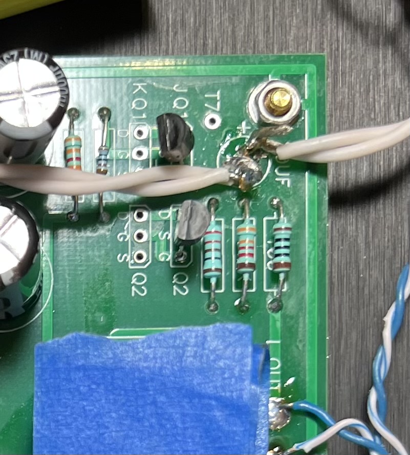

@Zen Mod - ARG! That was it. 270kOhm instead of 270 Ohm 😵😵😵
I manage to find 3x 100Ohm (3W) and tested a frankestein interim. It is alive now at 9.5V on T7. This one will be finish for Easter as a present ;-)

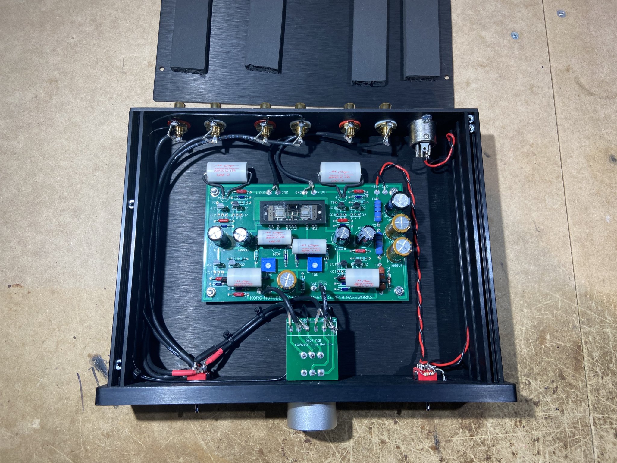

Still loving my B1K with upgraded coupling caps, increased capacitance in the onboard PS caps, a few "nicer" signal path resistors, shielded wire, and linear PS (though I may "upgrade" the perfboard LM317 setup to PCB based shunt regulator down the road).
If I had to do the build again after knowing what I know and reading this entire thread I'd:
Still plan to upgrade the stock pot to an Academy Audio Muse volume control, really curious how that changes the sound. Also need to play around with bias, still sitting pretty at 9.5V
