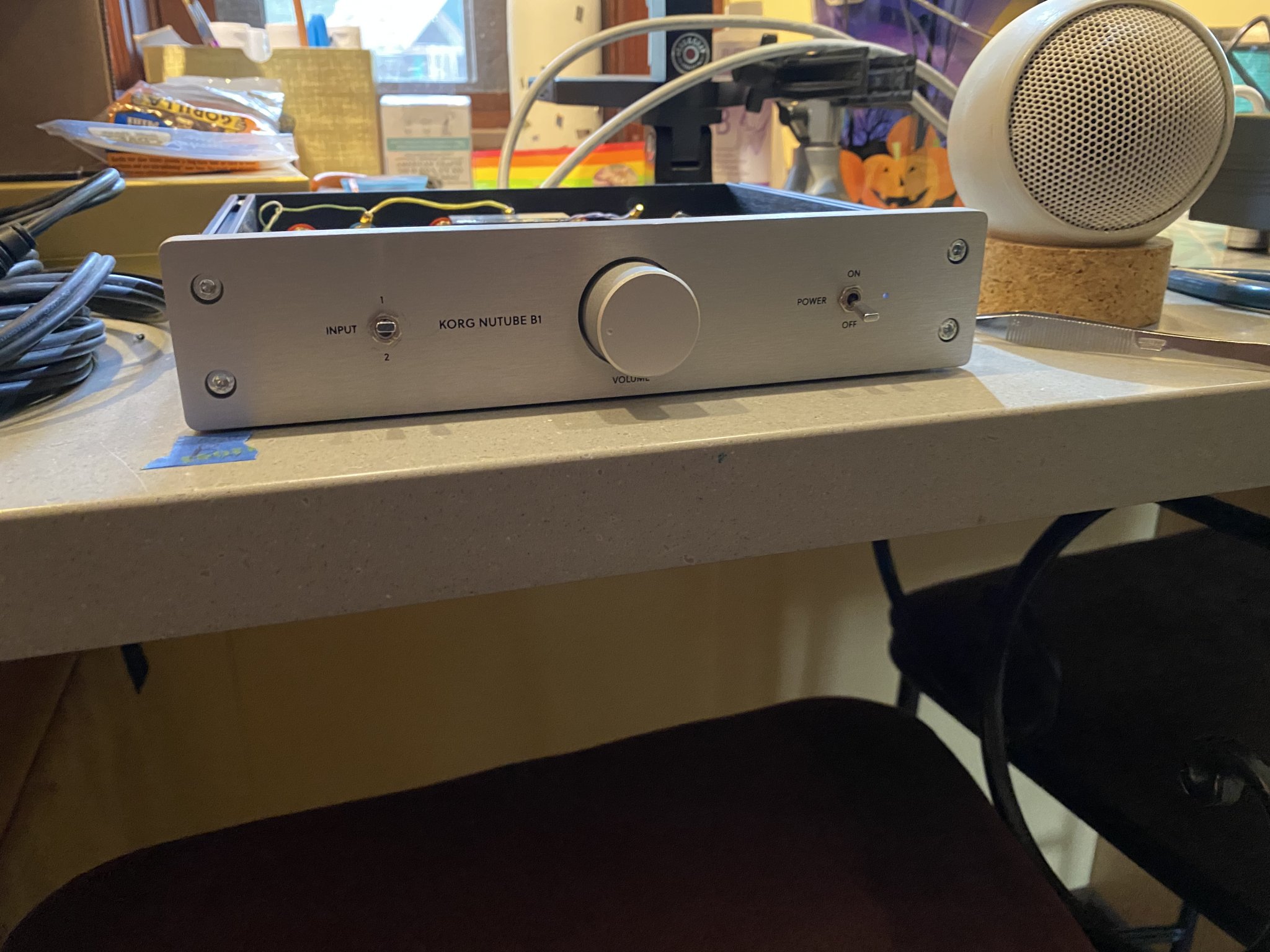

And with that, I’ve screwed on the top cover and am calling it done! The B1 Korg Christmas version in the DIYAudio store chassis. Thank you Nelson Pass for a super fun preamp that’s been on the to do list for much, much too long.

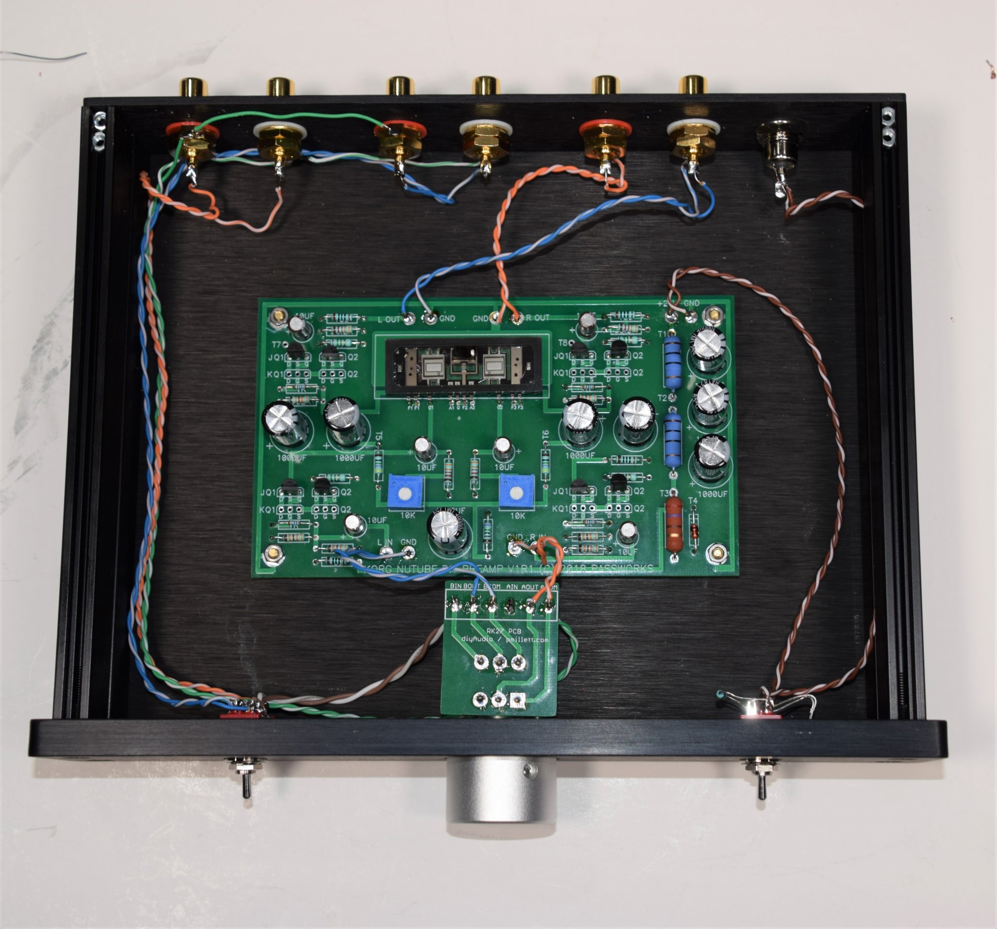

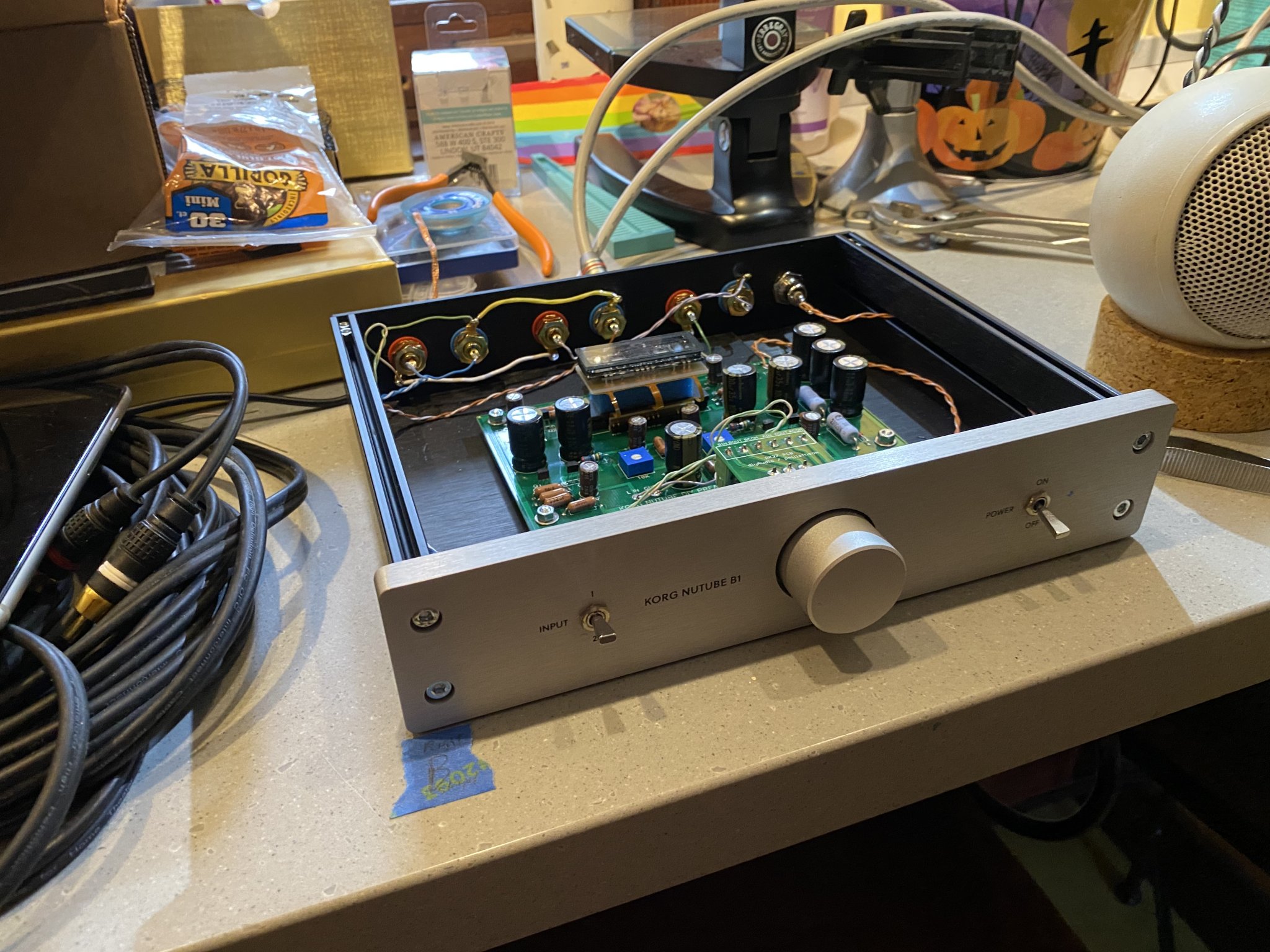

Joining the ranks of my fellow B1K builder/owners today as I received my kit in the mail. Pretty excited to build and eventually listen to it.
I stated the assembly after checking out the various build guides and threads and have encountered my first (likely silly) question.

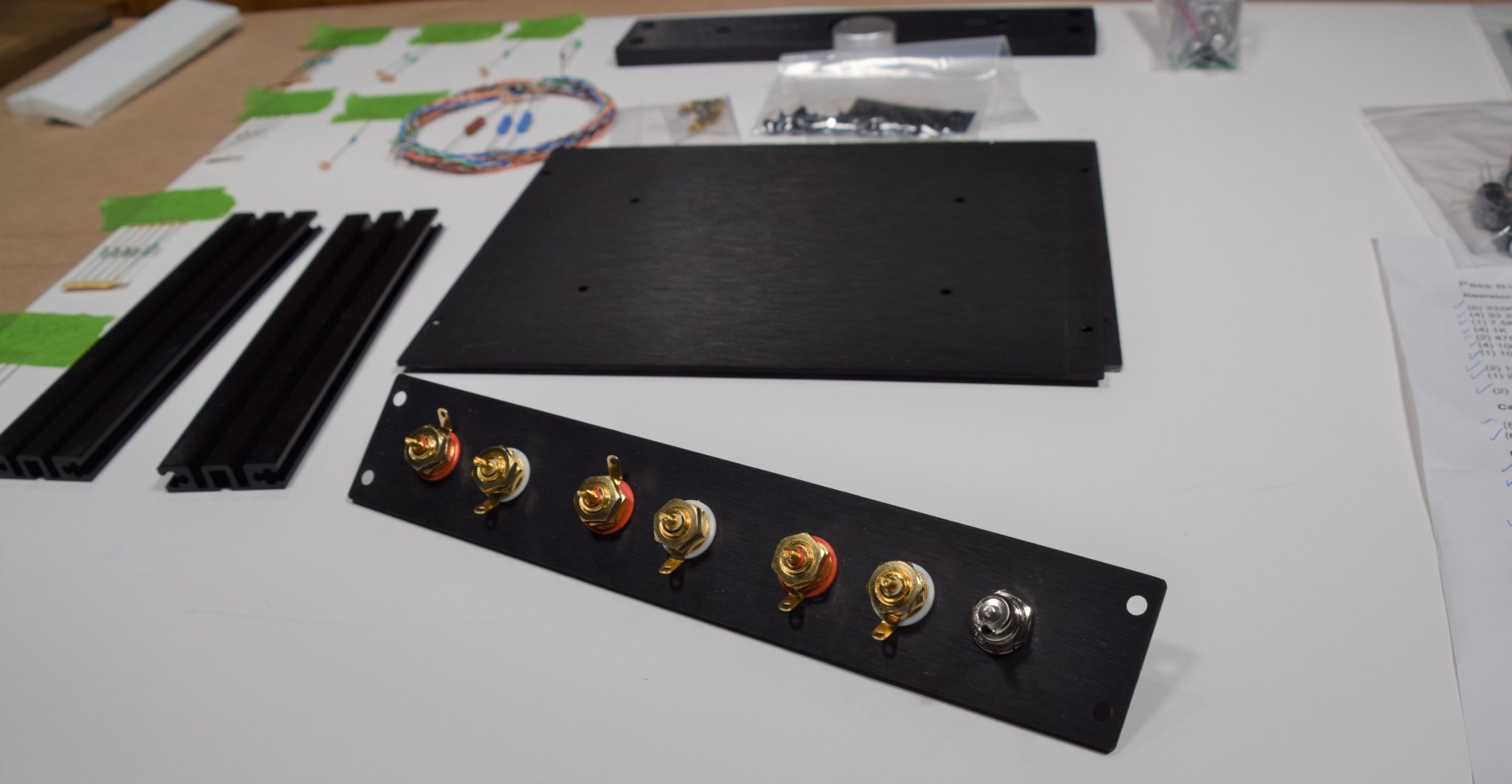

How are most of you assembling the RCA input/output jacks as far as placement of the ground ring connector?
The build guide shows in order: RCA jack > outer insulator (with shoulder) > back plate > inner insulator > ground ring > nut >nut.
That is how I currently have it assembled, but as I was putting them together I was thinking to myself maybe the ground ring is supposed to be between the two nuts instead? I have seen a few build pictures where others have done it this alternate way, but nothing definitive.
Is this simply builders discretion, does it even matter (probably not)? I searched both in the forum and the Internet and have not found anything concrete. Does anyone know the manufacturer of the RCA jacks used, perhaps I could refer to that documentation if I knew what terms to search for.

It will conduct the same. I have done it both ways with no ill effects. I like to have only one nut un front if it as it makes it slightly more ergonomic when soldering.
I suppose the washer could help the outer nut loosen. However, still unlikely. I haven't had any issues and I am constantly swapping gear around.

Alright, thanks.
After playing with it for awhile I agree with your take. The one nut seems more than enough to keep them firmly in place, and I am sure the electrical conductivity is just fine.
Also, I don't plan to unplug components too often anyway, so I doubt they would ever come loose. I think I am just over analyzing everything too much and just need to relax and enjoy the build.

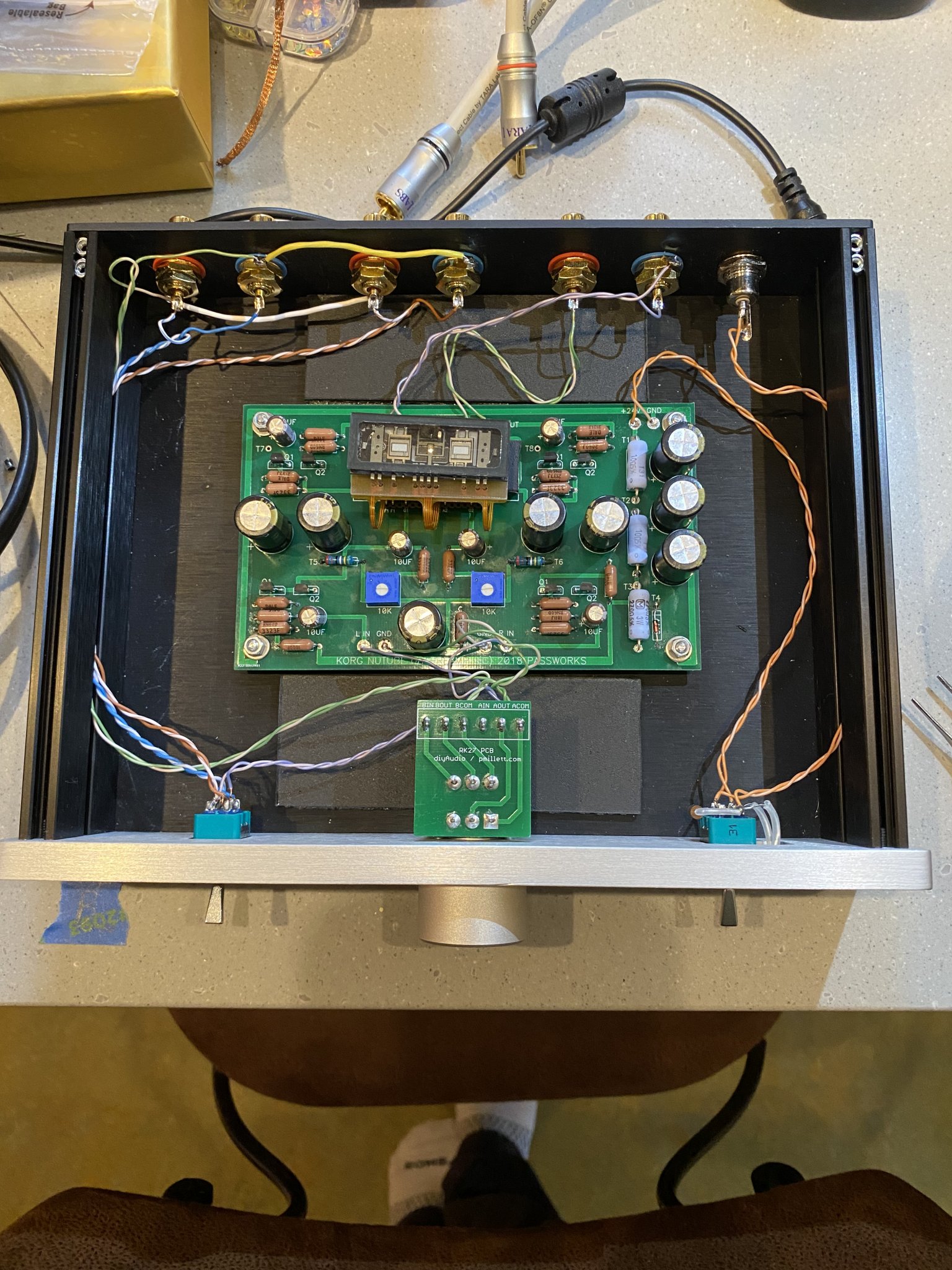

I managed to wrap this project up last night, it wasn't too bad of a build. The kit option makes it a breeze. One small nitpick, if I were to do it again I would use slightly thicker stranded wire for the connections instead of the included thin core solid.
Initial impressions are it sounds good and I don't seem to have the micro-phonic issue under normal use. I did hear it if I tapped the case with the handle of my screwdriver, but with normal operation including listening to music, adjusting the volume control, or switching inputs were all quiet.
I did use the whole length of the Kord triode circuit board's leads though keeping about a 1/2" or so spacing off the main board, so that might help.
I didn't get too much time in for listening yet, I will plan that for this upcoming week.

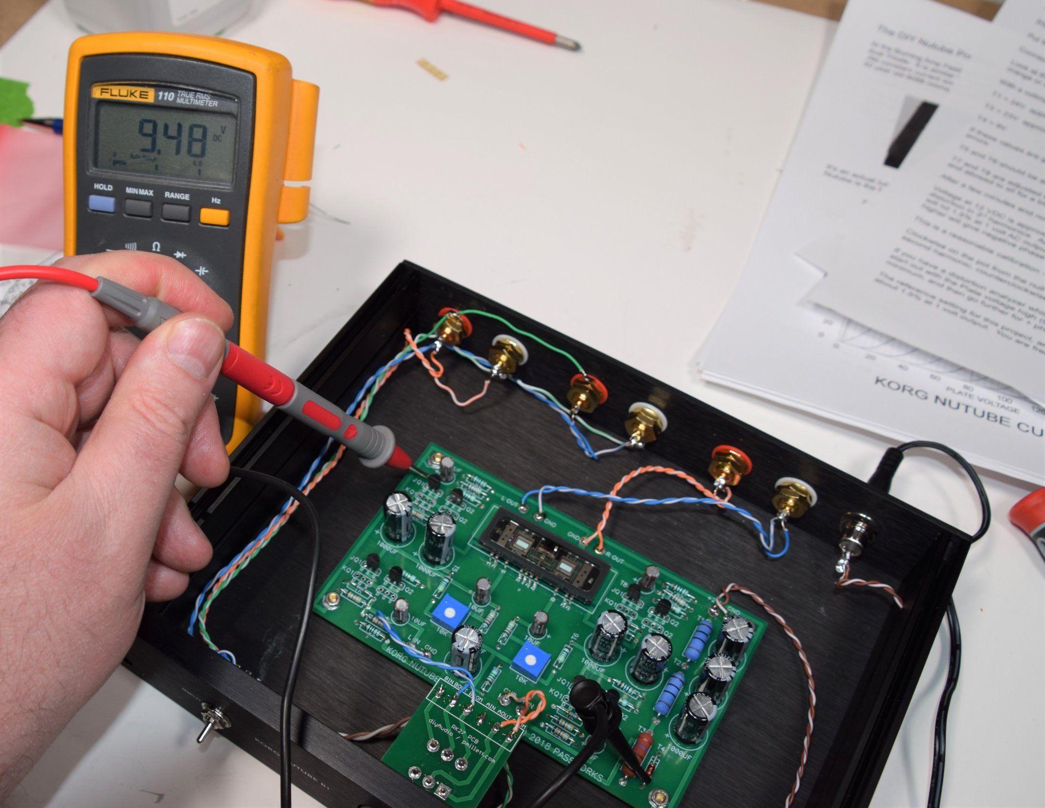

One question I do have, how much warm-up time does it take for the voltage to stabilize using the trimmers and measuring at T7 and T8? I had them set to 9.5V as recommended (after about 20 minutes running) and an hour later there will be a slight drift, usually lower to say 9.47V or so. I then readjusted them back to 9.5V exactly and after another hour or so they drift lower again by a few hundreths.

I found it to be most stable after 1h, and i've set it then. Hasn't moved since (takes about an hour turned on to heat up, and reach the voltage set each time i power it up, i usually do it in the morning). Also do note that your multimeter has a % margin of error so relax, that is fine
Thanks for the comment.I found it to be most stable after 1h, and i've set it then. Hasn't moved since (takes about an hour turned on to heat up, and reach the voltage set each time i power it up, i usually do it in the morning). Also do note that your multimeter has a % margin of error so relax, that is fine
Yeah, I realize the voltage reading is probably not exact at that small of a resolution, but the key takeaway was that in all cases it drifted lower by some small percentage.
If it were a more random reading within say a +/- .05v range it would be one thing, but it seems after several iterations of taking the voltage reading, adjusting the voltage back (up) to 9.50 V, waiting a hour and taking a new reading, in every instance the drift was always going lower. Four or five .03v increments in the same direction start to add up to a 0.15v drift I was just wondering at what point it is safe to adjust it and have it stay put (at least in a relative stable range).
From what i gather, it always drifts no matter the amount of time? Yes, it is ok to set 0.15v more, people set it much higher, it affects the harmonics, but doesn't present a threat to the device. I'm new to the b1k, and haven't had the issue, but you may try to set it at 10v as per papers that came with it suggest, but leave it for couple of hours. Then set bias to 9.5, and leave for couple more hours. If it drifts again, id recheck caps and resistors (which brings me to, if you checked them before populating?).
Also what are your voltage readings on other reading points?
All the other test points were within tolerance, I know the supplied wall-wart PSU measures a bit low, like 23.6V but it is stable at that voltage and doesn't drift. That was actually my next thing to try, switching out the PSU for a more robust linear supply.
I did check all the resisters and caps and they were all well within tolerance. I also performed the suggested check of the board at the assembly point where just the power supply components were attached, and measured voltages within spec, again considering the slight lower voltage reading of the PSU.
It may all be nothing as it sounds fine. I might just increase bias to a higher value 9.8V or something and maybe also finding a supply measuring closer to 24V.

There is absolutely no problem at all adjusting at higher voltages - even as high as 14V (with obviously very different caracteristics and if you know what you are doing and why).
Having said that, my B1K doesn't drift at all with time and after nearly 2 years, it is rock stable after a very short warmup period of a couple of minutes.
I know it is quite obvious, but I take it your meter has fresh batteries and perhaps you can confirm your measurment with another meter?

Yeah, I brought my better meter home from work to double check, same results.
The voltage does seem to have stabilized a bit more, I think I am going to set it at 10V for now and check in a day or two after a couple of long listening sessions. Unless if drifts substantially I will not worry about it anymore.
