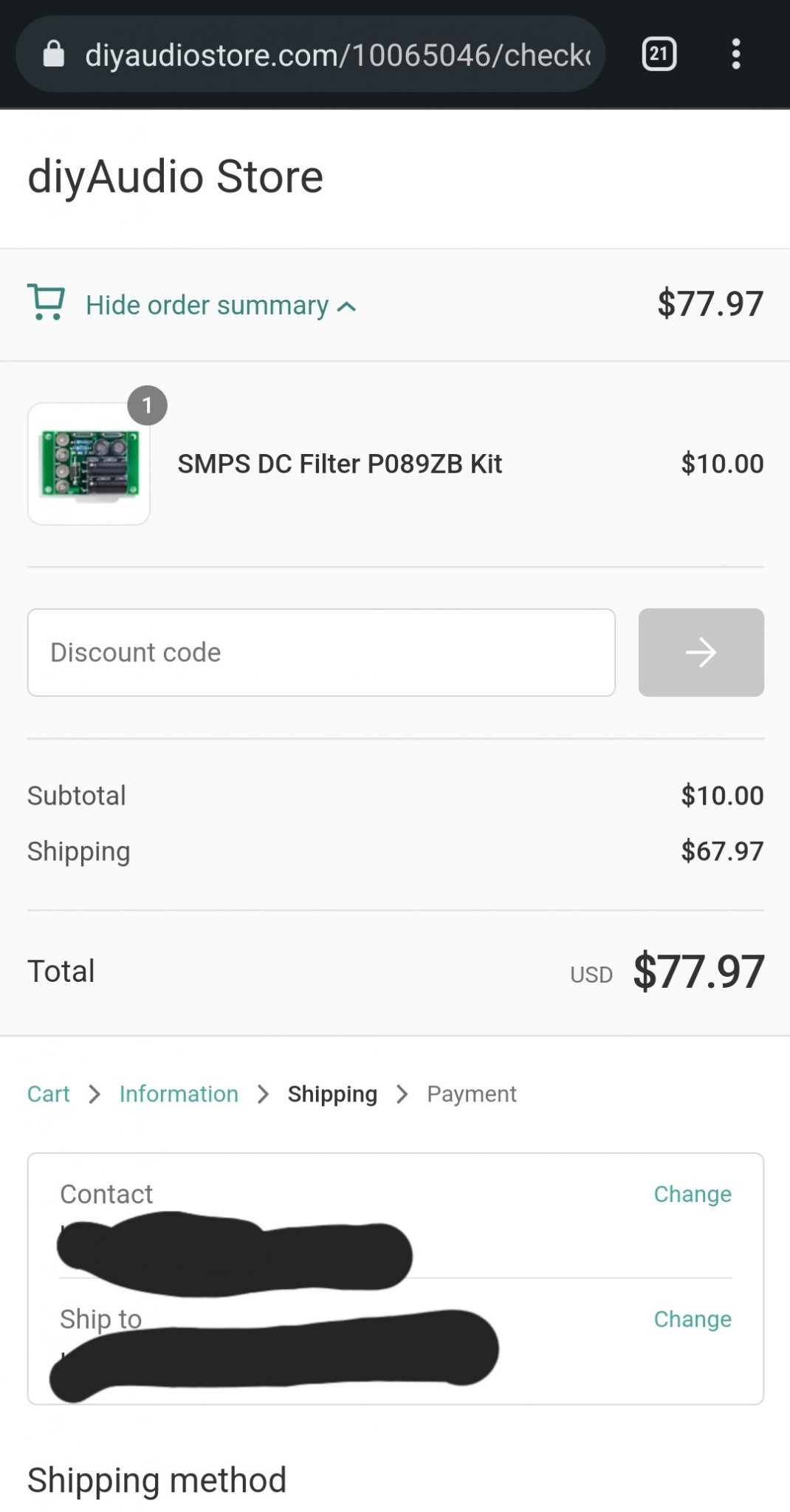

One issue i have is that i really cannot obtain P089ZB as it would cost me 100$ just to buy it and shipped to me.

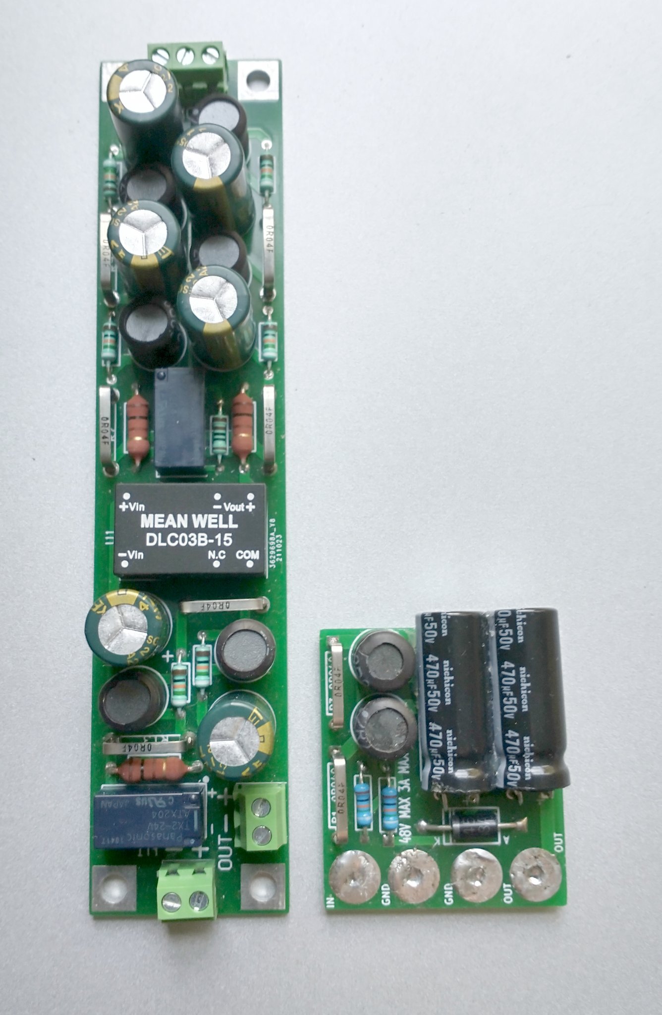

Do you plan to have the power modules in one chamber and audio boards in the other, or does each chamber hold a PS and audio board? If the former, could you take DC power from the Eval-1 PS to power a DC-DC converter for the B1K? You'll only need a small module like the Mean Well SKE10x-24 which has 80mV ripple, 0.5% regulation, and is entirely metal-encased on six sides. You could put it on a pcb with the P089ZB filter components and still have a very compact supply. My own B1K PS board has a converter, two relays, and the filter on all three voltages -- 24,15,-15 -- and still fits beside the B1K inside the small diyaudiostore chassis. I think you could do the whole thing -- PCB from China, converter & filter components for 24V only -- for around $100US.
If you switch both boards simultaneously you might want to include a delay relay on the B1K to avoid quite substantial power on/off pulses from being sent to the power amp. I have the purifi power amp from VTV and had to install a relay on the B1K to avoid nasty thumps at startup.

As for P089ZB, as i said it cost me around 100$ to obtain it (purchase and shipment), so it's a no go honestly, unless you mean print the pcb and populate it (which i don't feel like, i give props to makers and purchase their goods). And meanwell, not so quiet as i had hoped 😁

When I first learned about the P089ZB I asked a question or two online and a fellow spoke up to say he would send me a pcb and most of the parts "just because," and he did that. A lot of fellows who believe in the filter have purchased multiple pcbs from China and I'll bet you could find someone near you who could spare a pcb, and you can order the components from a distributor or maybe someone has a full kit that you could buy at minimal cost. Ask on the P089ZB thread, others have asked before you. Hard to believe a $10 kit will cost you $100 by the time you receive it.

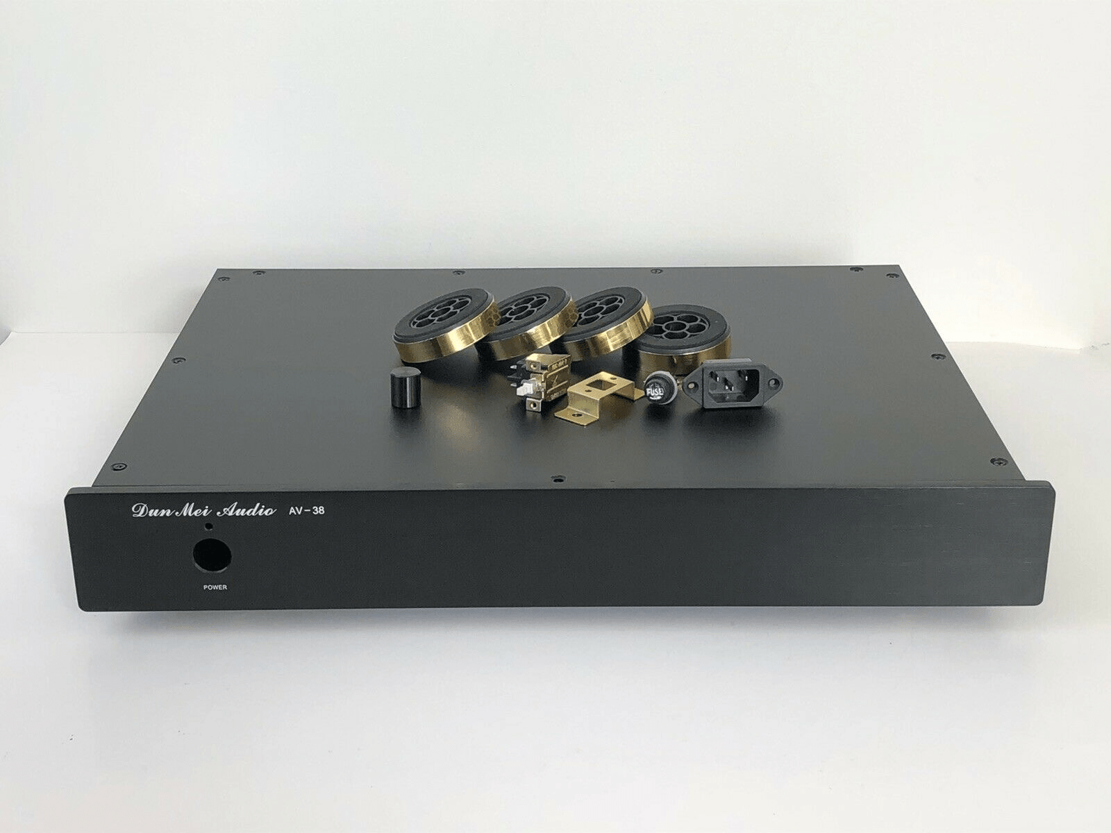

Question about this preamp. I built one of these preamps for a friend with toroidal transformer, Sigma o11 PSU, and upgraded Film caps. I wanted to build another for myself and accidentally bought a chassis that did not come with vent holes.
Can I get away with not having any ventilation or do I need to drill some holes? Any other way to add ventilation if it is needed?
Probably better without vent holes. The original B1 Korg chassis in the DIYAudio store had vents and they were removed in the revision to reduce microphonics.
No holes needed in the DIY chassis.
The only holes that make sense, IMHO, are a couple on the top plate to reach the bias pots ( I got the test points wired to rear panel jacks). One of these days when I stop listening...

78$ for item and shipping. Not 100 my bad. But still too much.Hard to believe a $10 kit will cost you $100 by the time you receive it.
Good thing the schematic, parts list, and PCB manufacturing files ("Gerbers") are freely downloadable for everyone. Navigate over to the PO89ZB discussion thread and read post #1. Doing It Yourself might be a lot of fun while also saving you some money.
