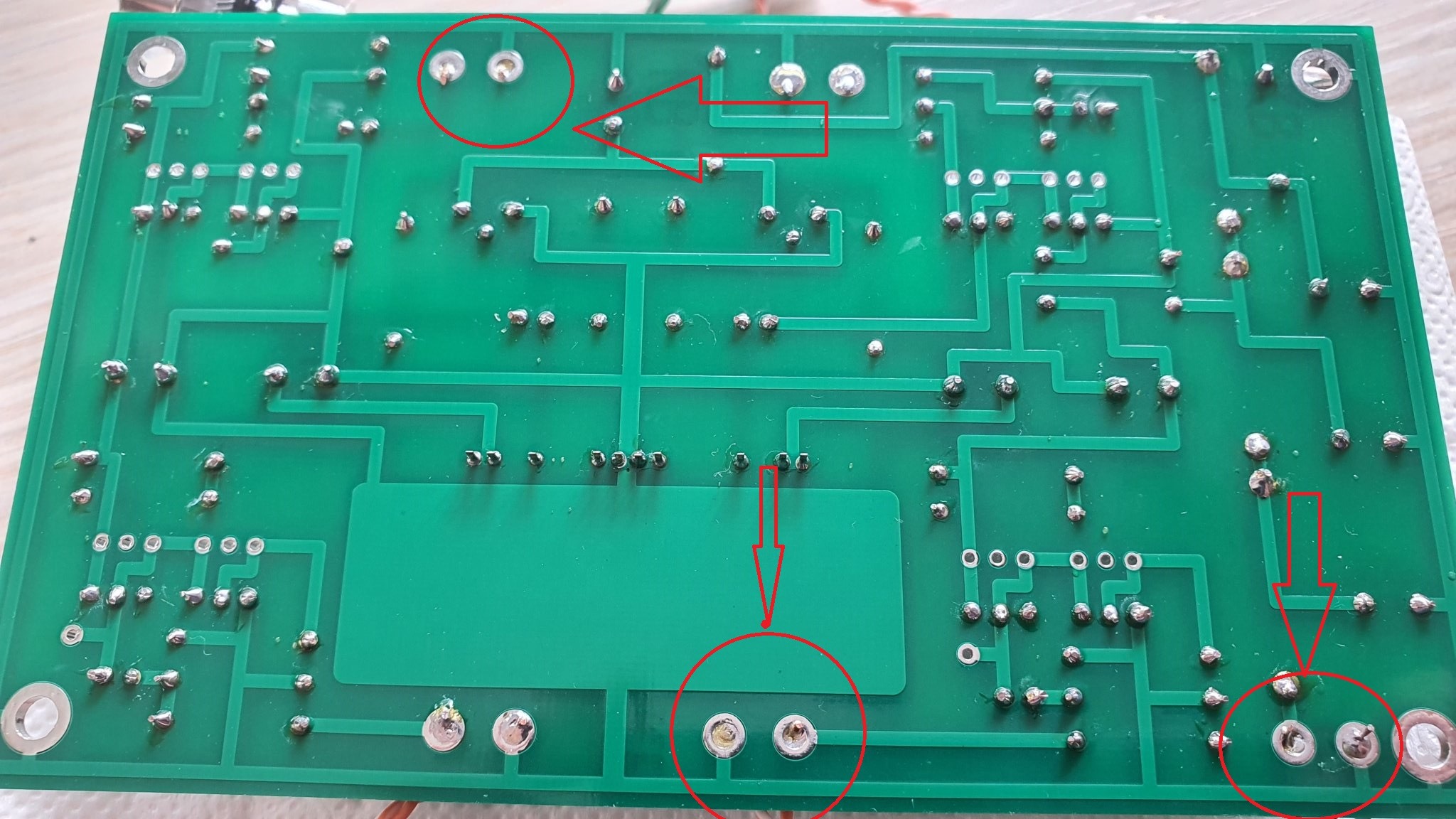

Picture in post #7576 does not show the solder joints clearly nor does it show the bottom side of the board. Solder joints of Nutube to board are not clear in the pictures. Have a close look at those joints and re-solder any joints that look suspect.

Post #7,569, it show soldering clearly there.Picture in post #7576 does not show the solder joints clearly nor does it show the bottom side of the board.

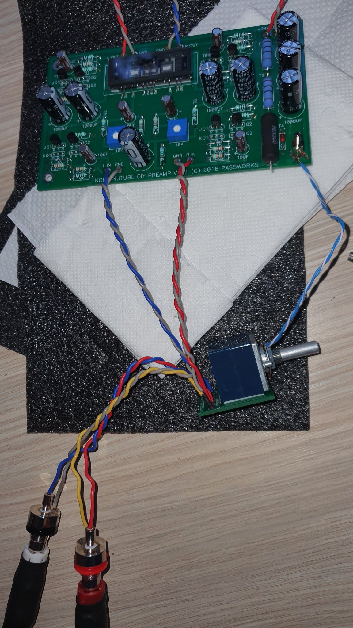

Haven't grounded it, it's on the table and i haven't used the box yet (to be made). I can probably get some makeshift alu box soonish to try it. Until then, where to ground the vol pot/board?

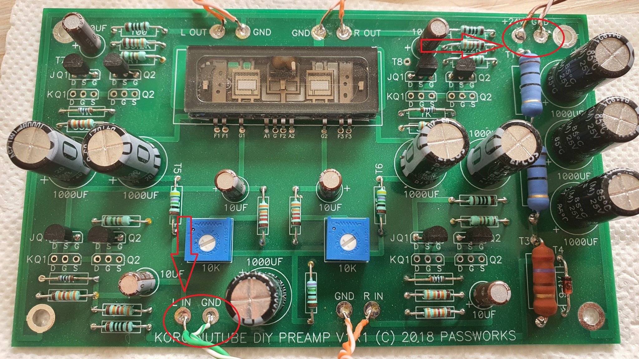

Looking at your board (post #7569) there are some solder joints that look a bit rough. One such joint is the V+ to the board. The line in and line out and ground wire connections to the board look rough too.
I was looking at #7569, but in your following post you said that you resoldered, so I wasn't sure whether the photo of #7569 was still current.I've just resoldered wiring including connections on alps, removed p089zb filter. ..........................
The body of the volume pot should be grounded. Probe the body of the pot and board ground with you meter. If it shows high resistance then connect a wire to the body of the pot and the other end to the power supply ground point on the board.

I've just grounded the pot, first at the bolt location at the edge with a screw and nut, then soldered directly to power supply ground point and still nothing. I recoded the sound it produces at three spots in this order tweeter, midrange, woofer. It's in the attachment.
That hiss and bzzz more towards the woofer. Bzzz gets louder the louder i turn the pot, but the hiss stays the same volume.
Doesn't sound like hum. Sounds like hiss with a steady beat. Is this from both channels? Perhaps a bad power supply connection? Motorboating?

Some not so good looking solder joints:

That's progress! So the hiss and buzz is left channel only? It may be a bad solder joint or joints in the left channel.
Since the noise was still there when the inputs were shorted, that most likely rules out the source as the problem. Just to rule out the amplifier, switch the left and right channels at the preamp OUT jacks. If the noise and hiss shift to the right speaker then the amplifier is not the problem.
I suggest then to redo all of the preamp left channel solder joints.

Have you redone the solder joints that I pointed out in post #7,585? If not then do them. The larger solder joints need more heat than the small joints. Is the power output of your soldering iron adjustable for more heat?
Also have a close look at the Nutube solder joints. At this point have a close look at all joints. The solder should be smooth and shiny.

The output at the plate is quite high impedance, which is why we buffer it with a jfet before sending it out into the world. This makes for opportunities for noise picked up from the environment, noise from the load resistor and possibly high frequency oscillation. For the latter you can explore some gate resistance for the jfet or some small capacitance (pf) attaching the plate to somewhere else.
