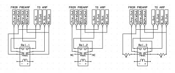

From the early days of my B1K, I have been using a start delay relay to keep the “thump” from going downstream to my amplifier.
Recently I agreed to do a cut-down version of my circuit for another fellow on this thread, and have been re-drawing the circuit to fit on a small board, and it occurred to me to wonder about the way I had configured the output relay in my original design.
Attached is an image the depicts my original design which I am using now (Rel_1) and two alternate ideas that I came up with after I began to wonder about my original decision.
Rel_1 – the preamp signal is disconnected from the power amp cable center conductor and the center conductor of the cable is shorted directly to the cable’s outer shield ground thus grounding the input of the power amplifier. The grounds remain connected to each other and the preamp signal conductor floats.
Rel_2 – is a simple disconnection of the preamp signal from the poweramp cable center conductor so both preamp and power amp center conductors are floating. The grounds remain connected to each other.
Rel_3 – the preamp signal is disconnected from the cable middle conductor and instead connected to the ground conductor through a resistor, perhaps 20K. The grounds remain connected to each other and the power amplifier cable center conductor floats.
Is there a clear winner of these three options or perhaps yet another configuration that is considered to be best practise?

having output cap in preamp, simplest and best way is to simply ground outputs with relay
meaning - relay simply shorting output to GND
So if I understand correctly -- 100R is enough load for the B1K to ground continuously and the relay grounds both the B1K and the power amp at the relay without disconnecting the preamp from the power amp? If this circuit were to be used possibly in other preamps -- i.e. treating as a univeral delay circuit -- then would this solution still be best?

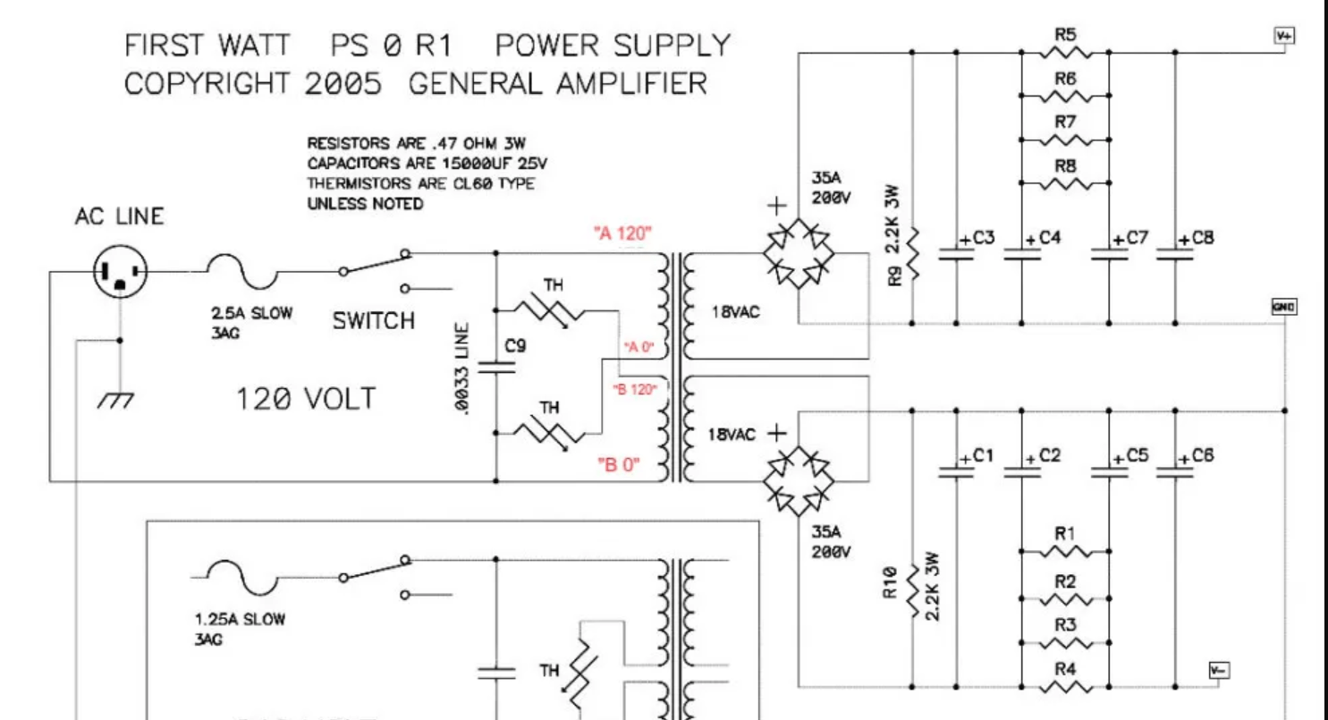

How does one size thermistors for the transformer primary of a PSU?
My B1K is powered via an external PSU which is a 25VA tordial transformer feeding ~5000uF reservoir caps (Pi filtering and regulation after).
I have some SL-15 lying around. Can I put them on the transformer primary like the application attached?

no need for soft start function of NTC in this case - small mains xformers are not inducing big inrush currents
