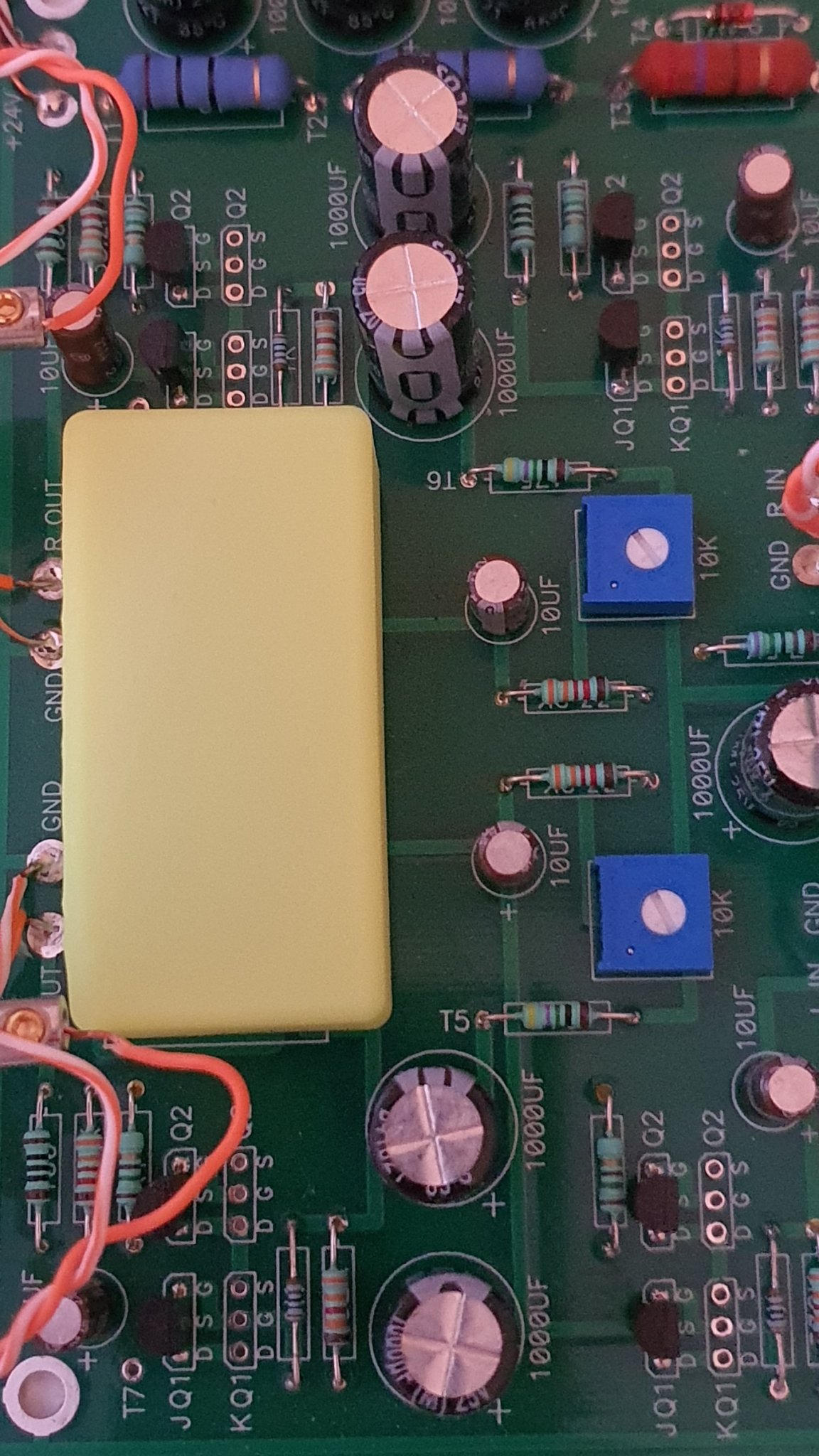

I recommend you get the SMPS filter from the DIYaudiostore as well as some film caps. I used wima PPP films. WIMA FKP .22 in the first location Wima FKP 1uf in the middle and as of now have 6.8uf clarity caps PX on the outputs.
The wima's are nice because they don't require any fiddling to get them to work with the holes that were used for the original electrolytic caps.

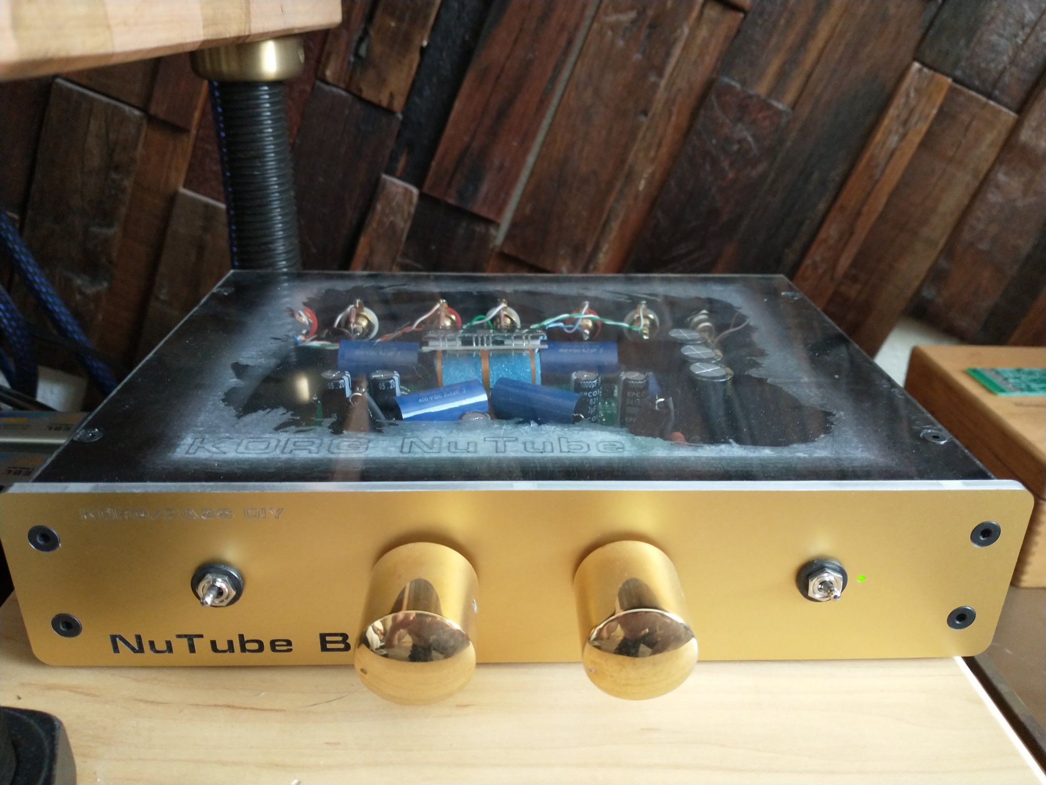

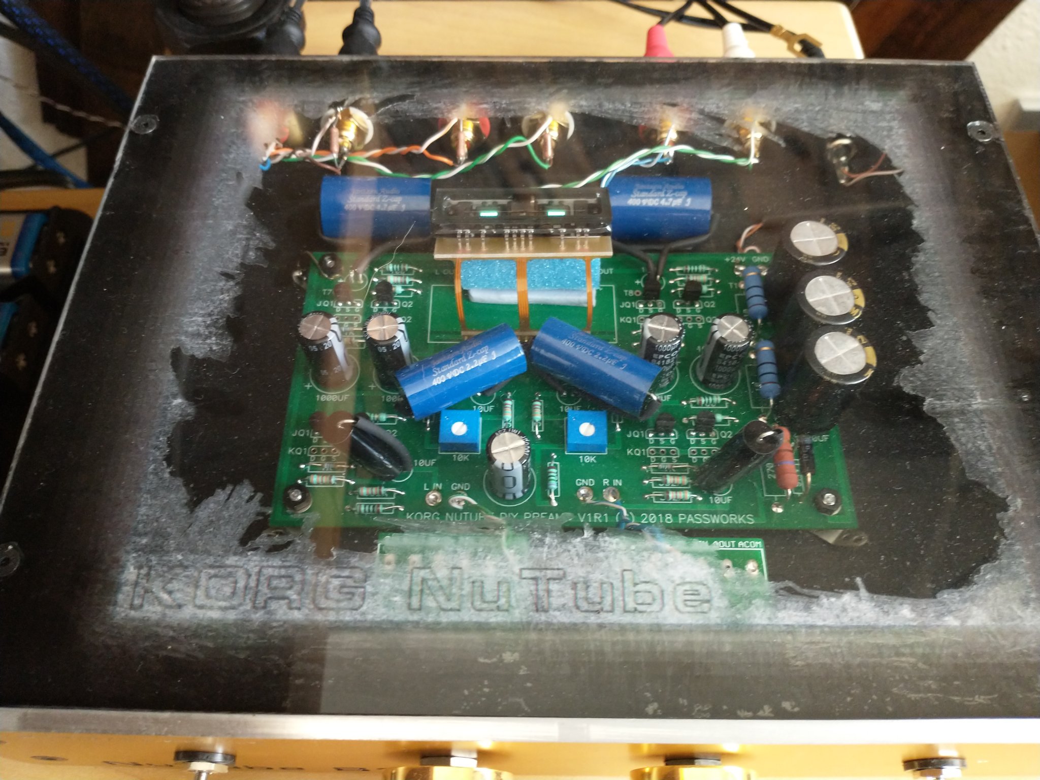

Simple and cheap solution for sensitive nutubes. This one is for air motion sensitivity, if you have an open case that you don't wish to close. Costs about few $ to print out in material (my suggestion is resin, half abs like and half flex resin), and you can use double sided transparent rubber tape cut out to measure as it is 2mm thick wall (it sticks just enough not to make it hard to peel off when you need to replace the tube, and it's gummy enough to absorb vibrations). 3d model is in zip file.

I think so. I wasn't able to A/B test it with a stock unit but it certainly sounds very nice. It fits nicely off to the side so long as you use taller standoffs. It is cheap and takes about 20 minutes to put together once you have the soldering station going and the case opened up.
I drilled two holes as I thought that 4 weren't necessary. Lay the board down and drill your holes before you have the board populated. I installed it after the power switch.
I made a plexi lid with some graphics that, though not as planned, turned out interesting.
It has had enough time to settle-in (the poly caps burned-in prior to the build) and I like it!

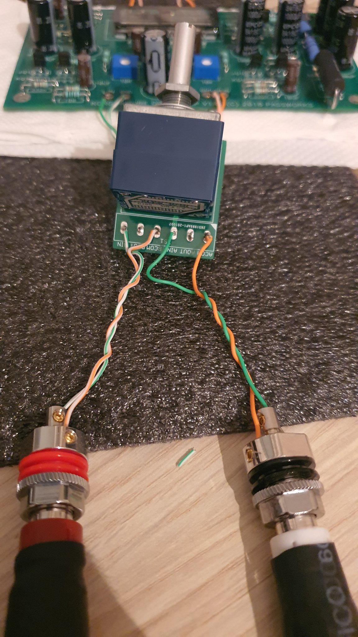

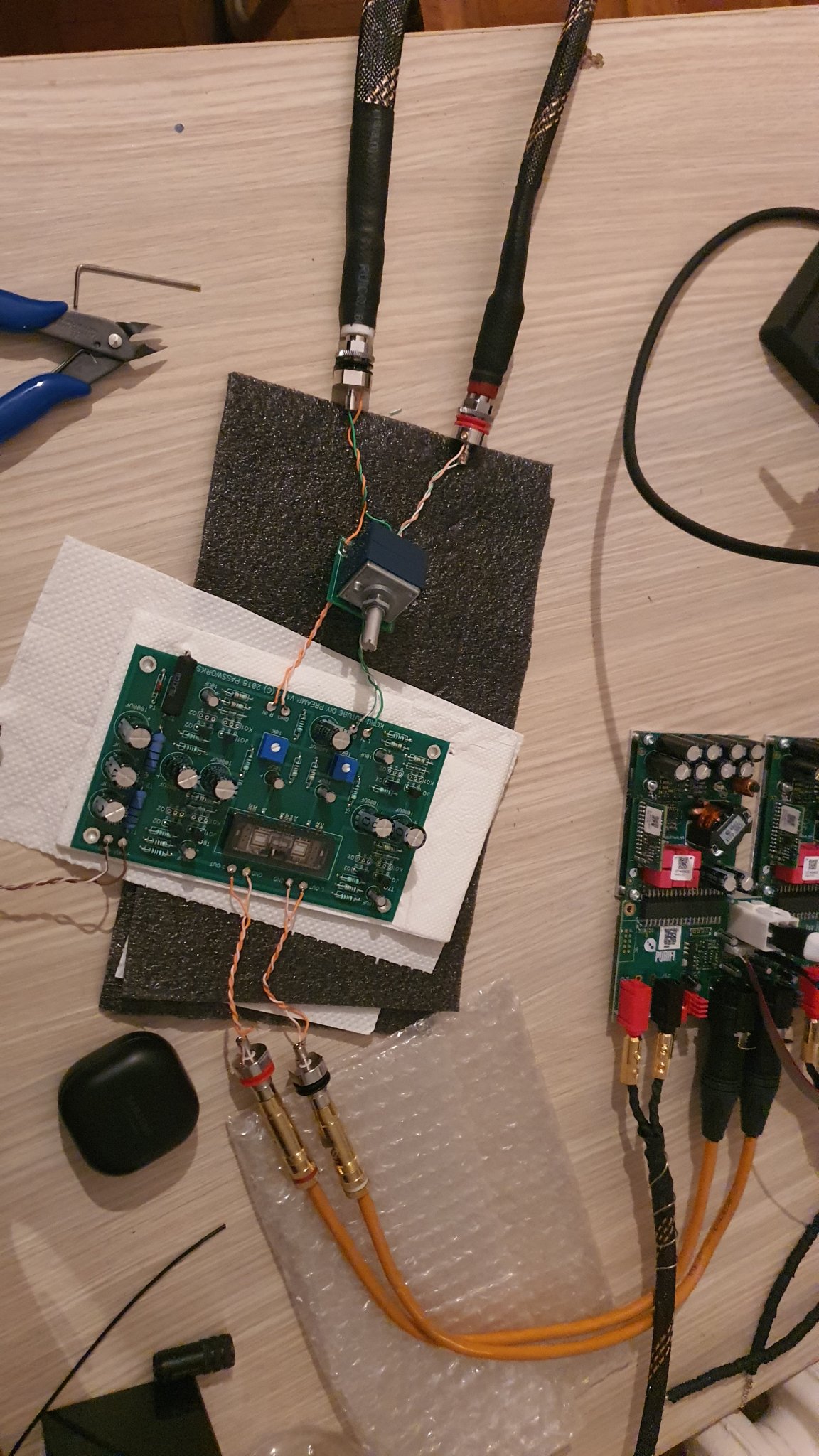

B1k i made for myself ended up staying in my friends system on his nc400s. So i made a new one for me, but i have an issue. Do mind it is not in a box yet (but neither is the one that friend now owns).
It hums, also it has active phone near old pc speakes ticking noise, on both channels, but only one channel plays music. Hum is persistent even without input from dac. Nutube shines the same on both sides, and voltages across the board are as follows:
T1 24.14v
T2 23.28v
T3 22.24
T4 8.94v
T5 0.627v
T6 0.657v
T7 9.52
T8 9.52
As for hum and ticking noise, i suspected interconnects but they work perfectly when i connect amp (purifi eval 1) directly to dac, dead silent(although friends interconnects were just rca, these are rca>xlr (shield to 1, signal to 2, negative to 3)). The only difference is that i made p089zb filter for this one that friend is about to get as well. I have also removed wifi router and modem from power outlet, and any other smps powered device to rule that out, and it is morning now, nothing is on atm within my apartment.
Voltages all look good, so the channel with no music may be a wiring/connection issue. Double check all wiring and their solder joints to board and RCA jacks.
You mentioned rca>xlr. Simplify by using rca/rca and rca source. Try switching source from left to right and vice versa.
As for hum and noise, simplify by removing PO89ZB filter. Check that RCA jacks are not grounded to chassis.
Make sure basic preamp works properly before adding extras.
And post well illuminated and focused pictures, including overall shot of the whole preamplifier showing all wiring.
@Ben Mah I will resolder wiring just in case, the rca are not soldered but screwed in place connections.
I have no means to check rca to rca with amp until weekend. Source is rca so just regular cable there. It hums and ticks even eithout source connected to inputs of b1k.
I'll be removing the filter now.

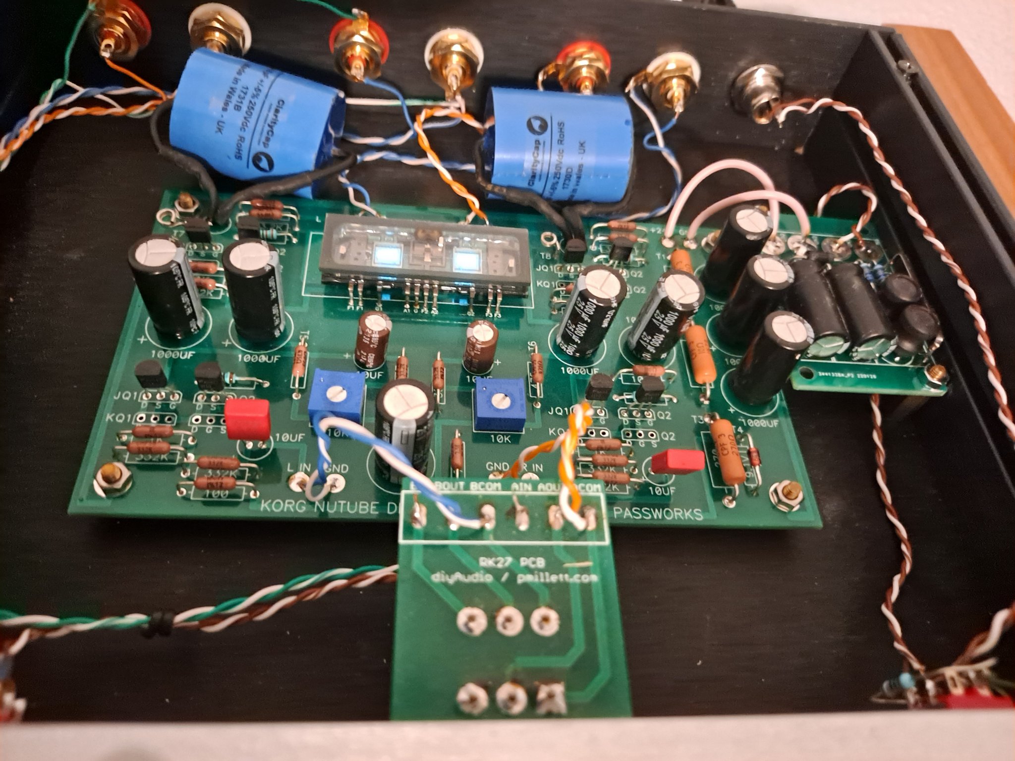

Here are the pics. I have upgrade components but wanted to use kit ones first to make sure all is well before swapping caps and some resistors.
I've just resoldered wiring including connections on alps, removed p089zb filter. Still hum still active call noise ticking. One thing i just noticed, as right channel is working, left is not, when i turn the volume to almost zero, i can hear song coming from the left channel as well but really faintly with my ear on the speaker drivers. Also switched left to right, right output works only even switched to left.
At the cable xrl connection, there is a fourth pin (neutric xlr connector) that is ground(which connects the plug casing), and i've found conflicting info on this matter as to jump pin 1 to it, some say yes some say no, and i didn't jump it. Perhaps try jumping that point so that the ground is on the xlr side plug? But it is still a long shot from what i see because when i connect dac directly to amp via the same cable no hum, dead silence.
It's currently on the bench table. First one was literally in plastic box and it had no hum issue. But as i said it was rca to rca, this one is rca to xlr interconnect (shield and negative soldered together at rca, at xlr end shield to 1, signal to 2, negative to 3). Don't know if that makes the difference.
XLR to RCA wiring is correct.
Again, without seeing all of the wiring and layout it is impossible to determine the cause of the hum.
It's like calling up a Doctor and say you are sick and based on that, without further information, expect a diagnosis. 🙂
Well... does the hum change in intensity when you touch your volume pot or one of the grounds with your finger?
Not quite. Passive hum is more like silent white noise, occasional ticks as an active phone call near old speaker. When i touch volume pot i hear different sound, bzzzzz, not the same.
Also, that passive hum is the same loudness no matter what volume i set, but that bzzz on pot touch is louder the volume is higher.
Is this "passive hum" and "silent white noise" like a hiss? What frequency range is it?
A hum is more 60Hz and/or 120Hz and is generally associated with AC ripple and grounding issues.
Buzzing and ticking may be caused by bad connections, bad solder joints.
Have you grounded the body of the volume pot as suggested by ClaudeG? If not, then give it a try.
Looking at your board (post #7569) there are some solder joints that look a bit rough. One such joint is the V+ to the board. The line in and line out and ground wire connections to the board look rough too.
I'll check the frequency tomorrow, it's almost 2am here. They look rough as i resoldered and haven't cleaned the flux, so it's a bit darkish, will brush up tomorrow. Overall soldering of components you can see on post before, with daylight clean photo. I did add 5W dale 270R meanwhile while i was at it soldering, as the 3W kit one is too hot for my taste.
