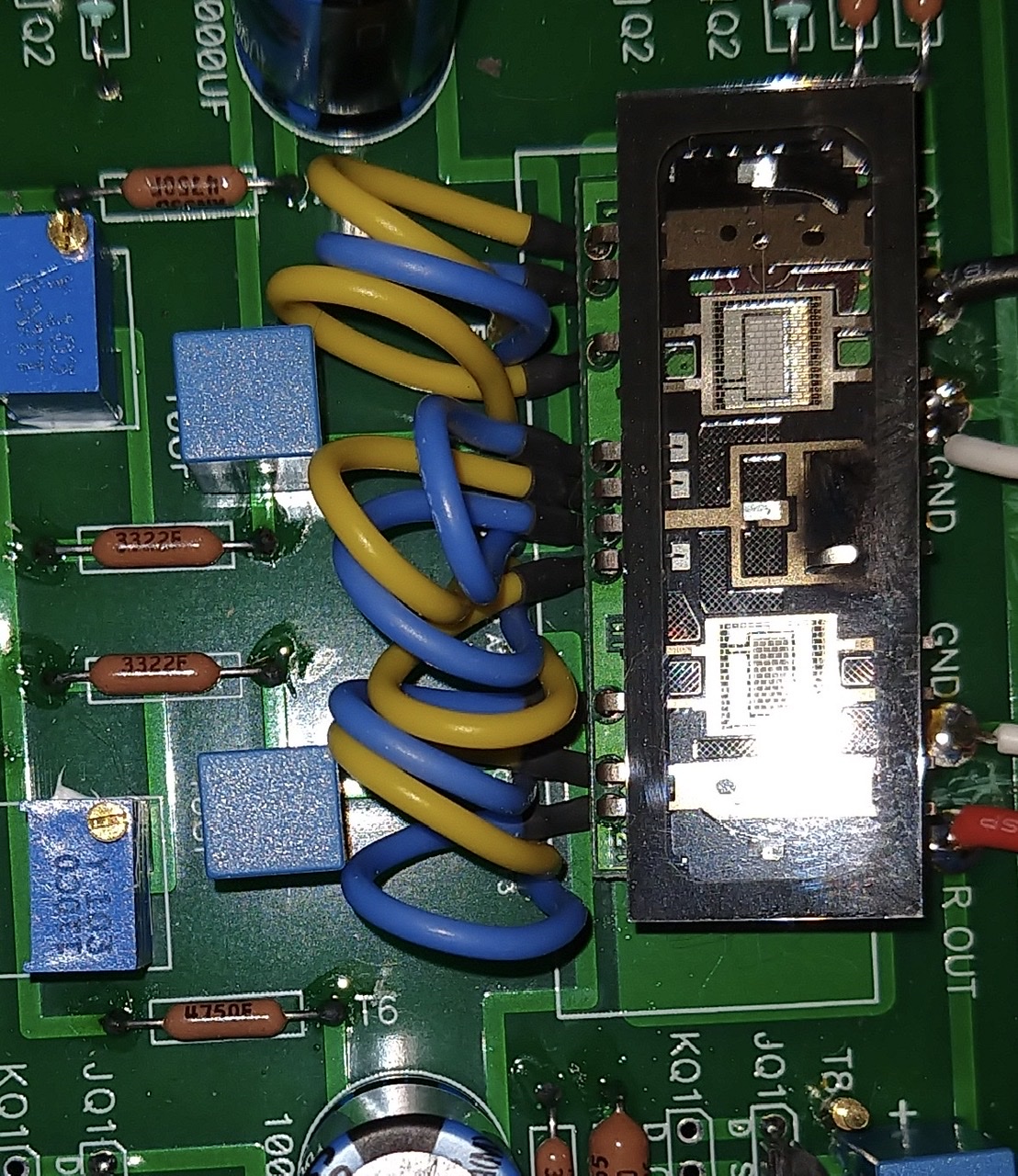

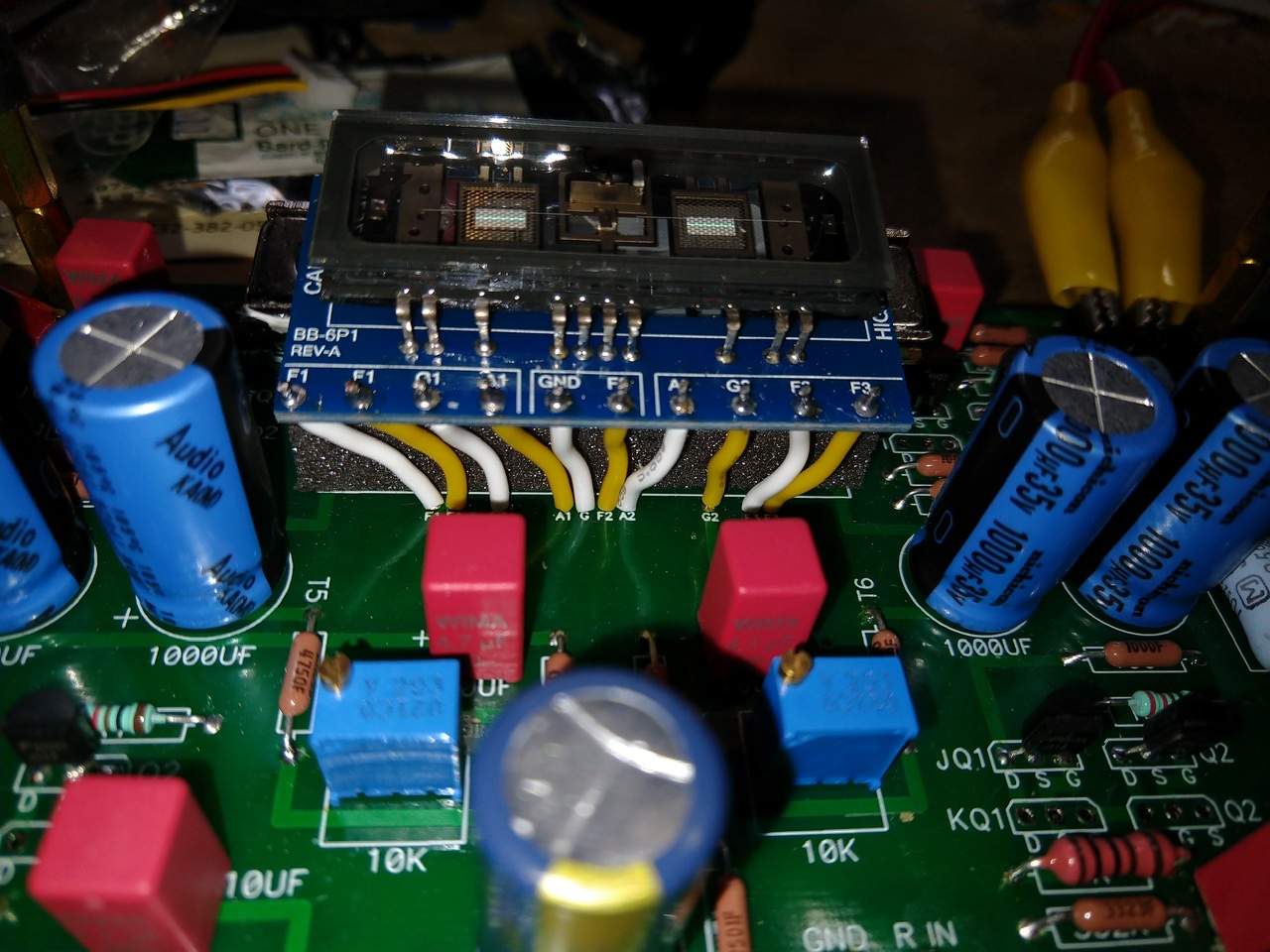

The biggest effect on this tube, in my experience, is vibrations through the mounting pins. So whether one uses PM’s suspension product, or how the builder in post #6048 did it, or my less elegant approaches (pictured below along with the board I used purchase from Ebay & double-sided sticky foam from Home Depot) all will help stop vibrations to the tube. One is straight wire attached to the Ebay board the other is a looped wire soldered directly onto the Nutube pins (all wire is the multi-stranded flexible silicon coated type and tubes are mounted on foam). This is probably the best bang-for-the-buck to eliminate most ringing/microphonics with the Korg. Yes, sound damping will also be a productive endeavor as well.
Electronic failings of the tube is a completely different story.

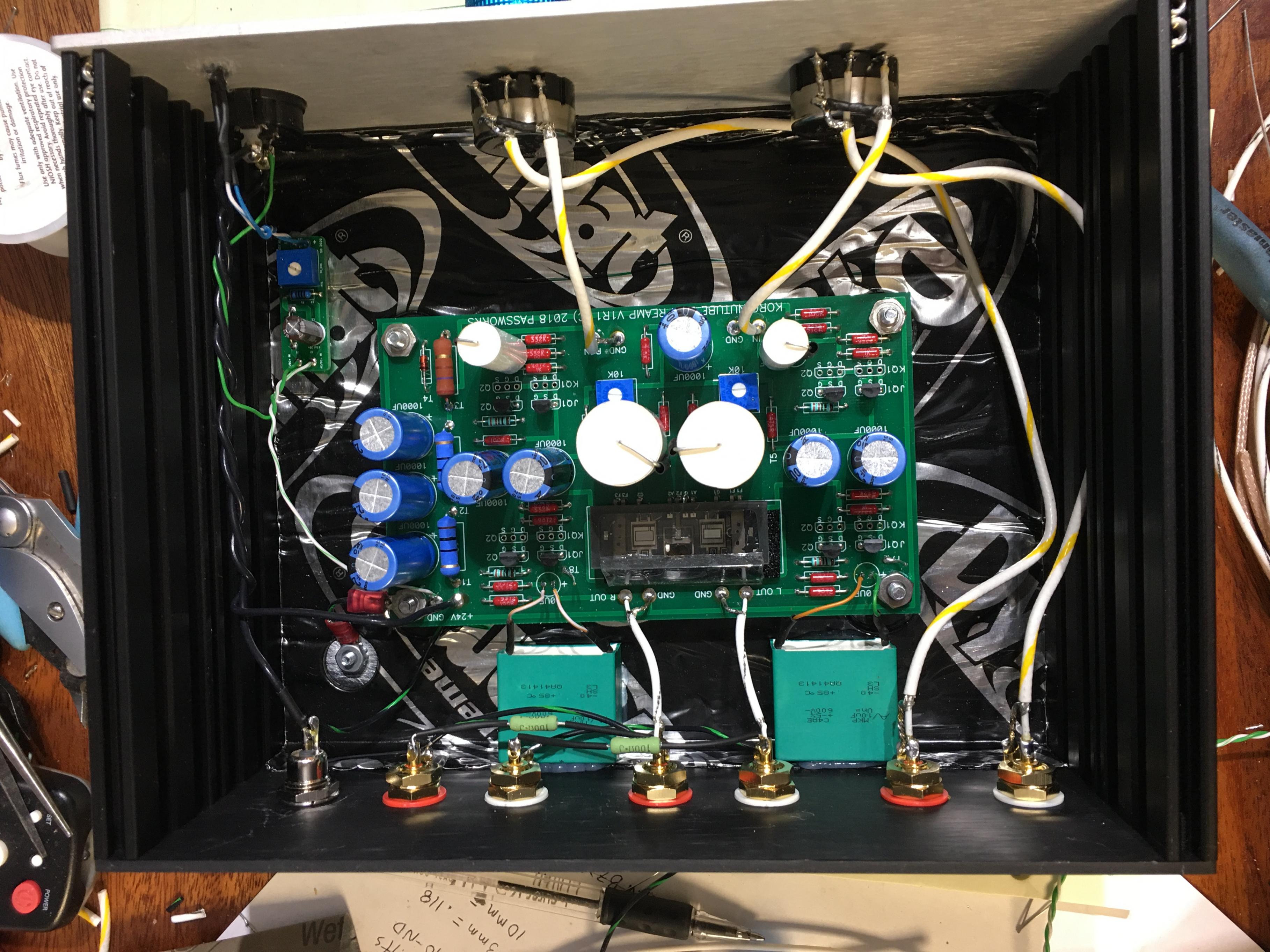

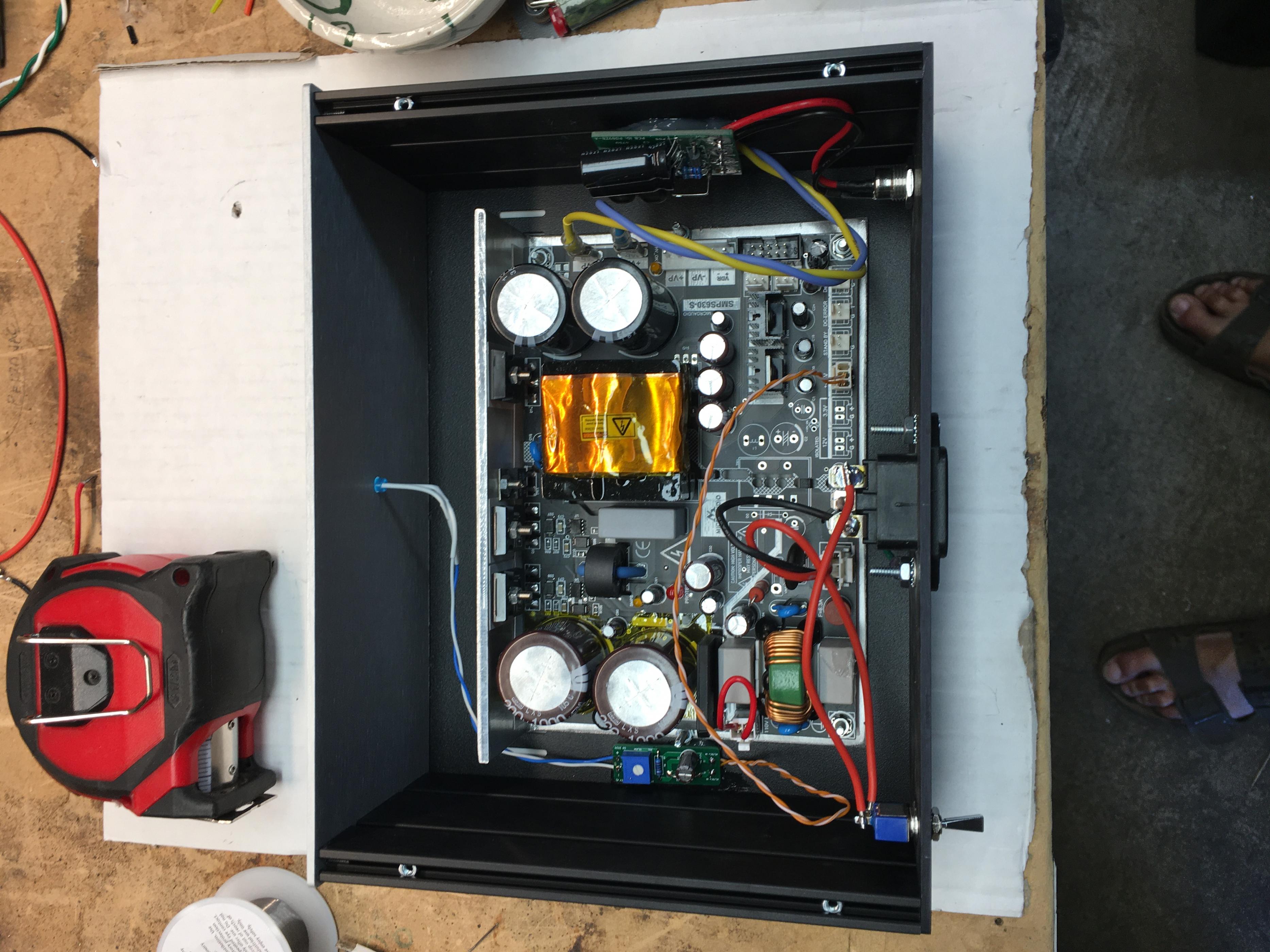

Just to put things in perspective. And maybe I'm very lucky. But I have no ringing at all. I used only double sided tape for dampening. The board is mounted inside the class D power amp. The housing has slids. Definitely not all NuTubes behave the same.The biggest effect on this tube, in my experience, is vibrations through the mounting pins. So whether one uses PM’s suspension product, or how the builder in post #6048 did it, or my less elegant approaches (pictured below along with the board I used purchase from Ebay & double-sided sticky foam from Home Depot) all will help stop vibrations to the tube. One is straight wire attached to the Ebay board the other is a looped wire soldered directly onto the Nutube pins (all wire is the multi-stranded flexible silicon coated type and tubes are mounted on foam). This is probably the best bang-for-the-buck to eliminate most ringing/microphonics with the Korg. Yes, sound damping will also be a productive endeavor as well.

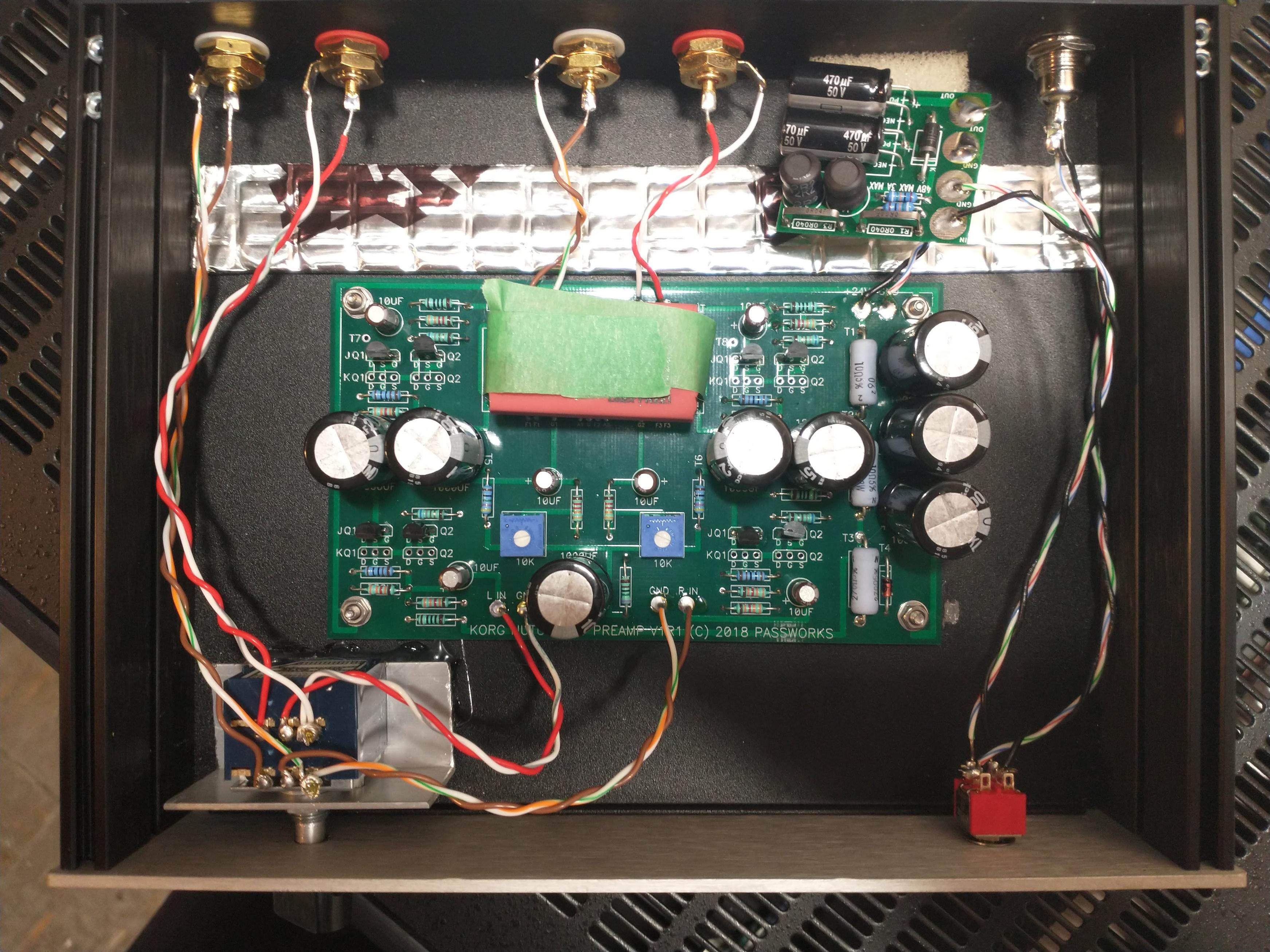

Still getting hiss
Absolutely loving this build, but I still get a hiss that isn't terrible but is keeping it on the bench in favor of a DCB1.
Does not seem effected by volume. Good continuity between ground and chassis. Nutube rings when you touch the chassis, but in normal playing I don't notice it.
Currently have just the eraser on top, had foam underneath but I took that out.
Any suggestions?
Edit- took out the filter to make sure that wasn't it.
Any suggestions?
If the ALPs pot, or the L-bracket it’s mounted on are not grounded to the chassis just try that. Your aluminum bracket looks like it’s glued to the chassis? I’m supposing your PCB is mounted to the chassis with conductive standoffs?

Yes I followed the build guide section 4 - "use an aluminum L-bracket, a small wooden block, and a hot glue gun to secure the volume pot." In my defense I was trying to bring the pot further in as the shaft was way too long for the knob I had...
Good news, while I was testing the grounding on the pot/bracket I noticed one of the signal wires was just touching the metal frame of the pot. I moved it up and it seems much better.
Will also look into passively attenuating, thanks NP 🙂 I do have more gain than I need in my system so there might be an additional benefit to that.
