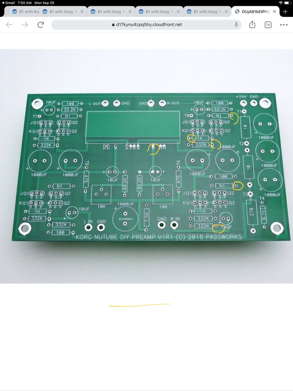

I've built the kit and it looks like something's not right. I'm a novice so don't really know where to start looking to find the problem.
-When I turn it on, the Korg glows blue on both sides but brighter on the left.
-When I adjust right trim pot it doesn't change anything.
-Measurements are:
T1=24V
T2=23V
T3=22V
T4=9.18V
T5=0.65V
T7=9.5V (after adjustment with trim pot)
T8=19.7V (doesn't change with turning trim pot)
Any help on where to look would be much appreciated.

Here's a picture of the board. Now I know why the instructions said to place the resistors with the values upwards. Is there a photo somewhere of the bare board so I can check against that?
If you think all the resistors (on the troubled side of the board) are in the right spot (yup, always easier to diagnose incorrect resistor placement if you can read values printed on them) get some flux paste and re-flow all the solder joints starting with the resistors. Do one side of each resistor first then come back and do the other side..don’t want to overheat anything. I’d re-flow the jfets on the troublesome side as well. Visually some looked a bit off so I’d start with them first (see picture).
Good luck.

>>>>>>>>>For those who have already addressed this observation, great. For us who said WTF when looking at the Fairchild transistors and noticed that though they were all J113, we might have noticed that some had KH33 or KH44 written on them as well. Been a little bit since I built the last B1 and noticed this. As I recall, there is no trouble about those numbers being different on some of the transistors, right? Everything else is swell.
The one and only
Joined 2001
No problem. All of them were tested for Vp, so that they would be operating
at Idss where the Gate and Source voltages would be the same on each follower.
This allows for easy measurement of the high impedance Plate voltage of the tube.
And of course you are welcome to use the Toshiba parts....
