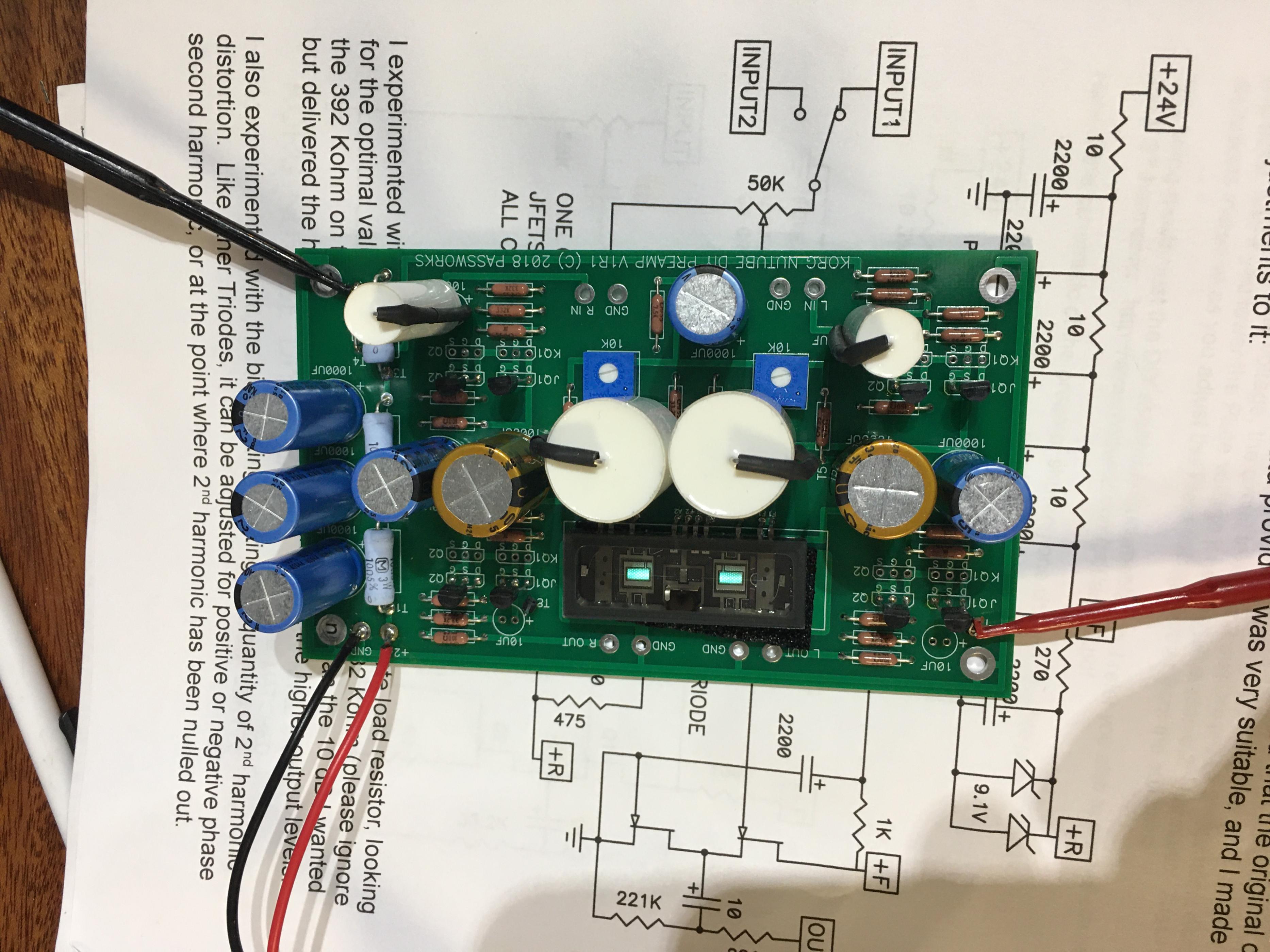

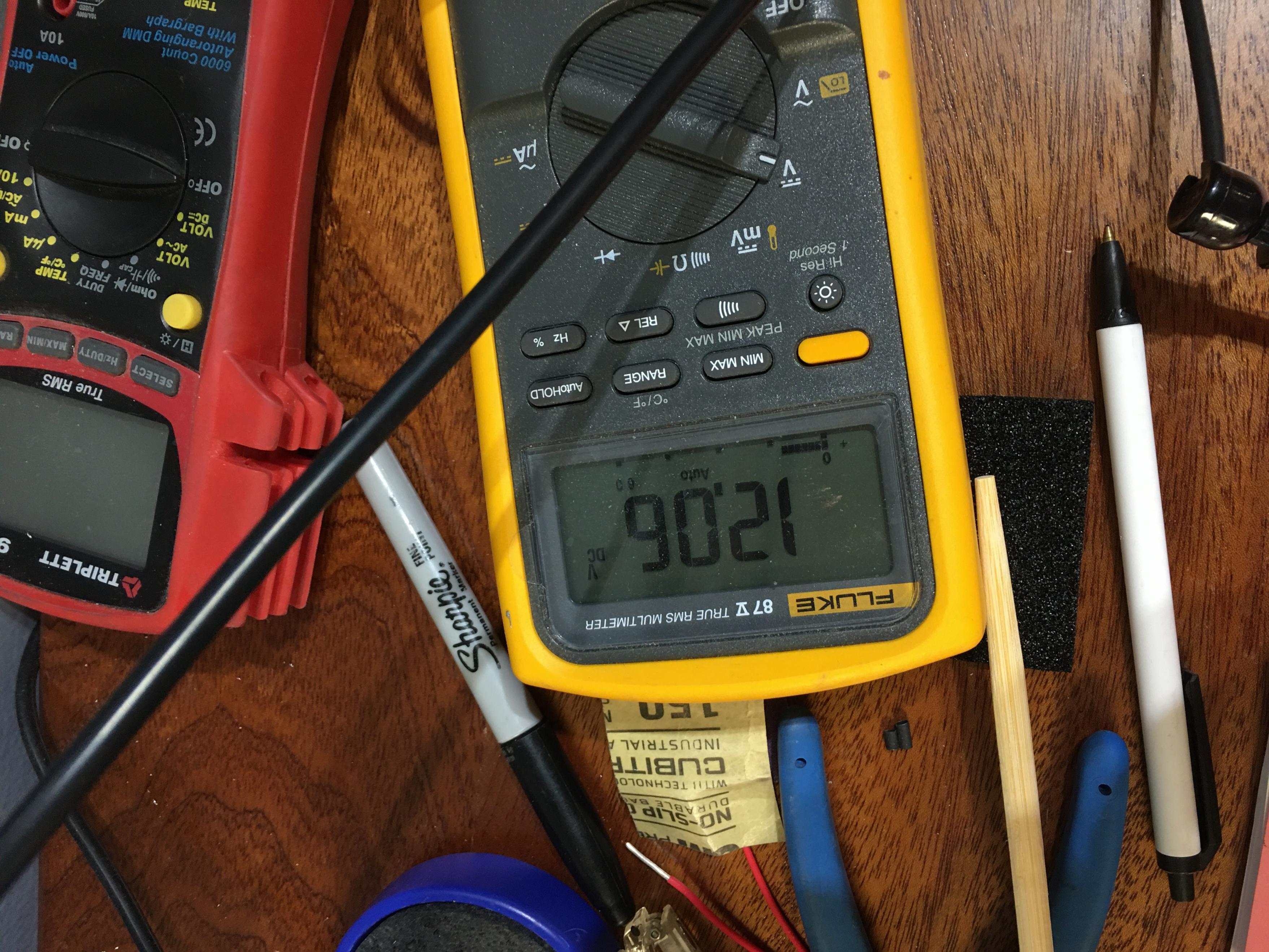

Hello…both my pots are maxed…one side (T7) is very close the other (T8) I can only get to 12.06v.
T4=9.48
T1=23.98
T2=23.17
T3=22.37
T5&6=.65
How do I get more range in those pots?
Thanks for the help
T4=9.48
T1=23.98
T2=23.17
T3=22.37
T5&6=.65
Thanks for the help

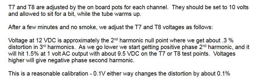

In the paper written about this preamp, it states that the voltage at T7/T8 should be adjusted to 10 volts and then allowed to set a few minutes until the tubes warm up. 12 volts might be the maximum setting for this test point. Looks like 9.5 volts is the starting point and then voltage is adjusted within a unspecified range to determine 2nd and 3rd order harmonics. Distortion will also be affected by this adjustment.

Thanks for the feedback. I let it run for about 5 min…no change…pots are both maxed to one side….the 12.3 vdc (side) just goes up from there adjusting the other way. Hummmmmm

to Monk55
Hello Monk55,
why do you want to go higher than 12 Volts on T7/T8? You have zeroed out
2nd harmonic at around 12 V....😕 - so,very dominant 3rd harmonic.
I would start at around 9.5 - 10V and would only adjust very slightly.
And depending on your setup - invert polarity at speakeroutput (the B1 NUTUBE pre is phase inverting) to test what sounds better. If you flip your speakercables - please turn off the amps.
And you know - the DIY-NUTUBE-pre has a turn-on-thump...
Only some thoughts....

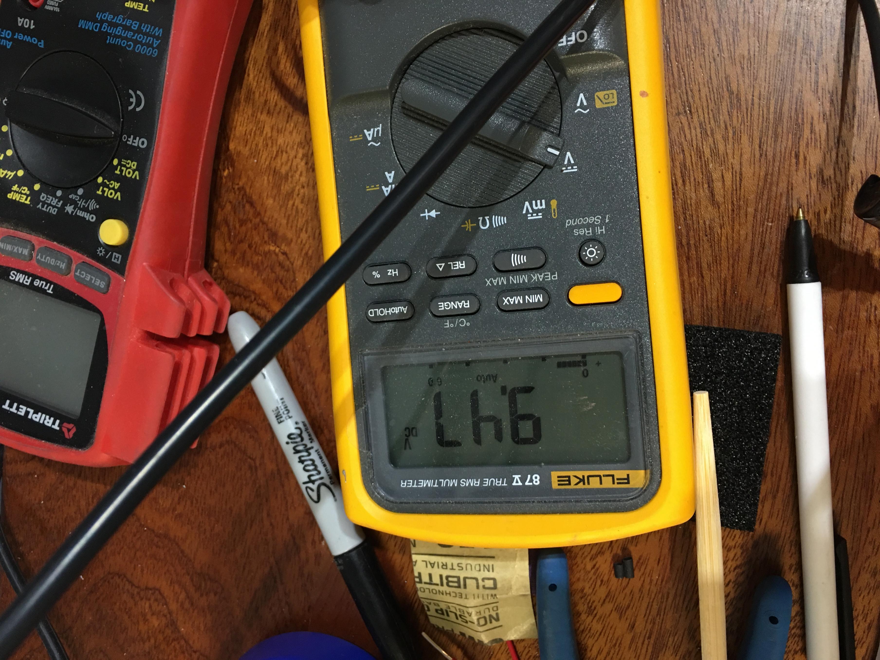

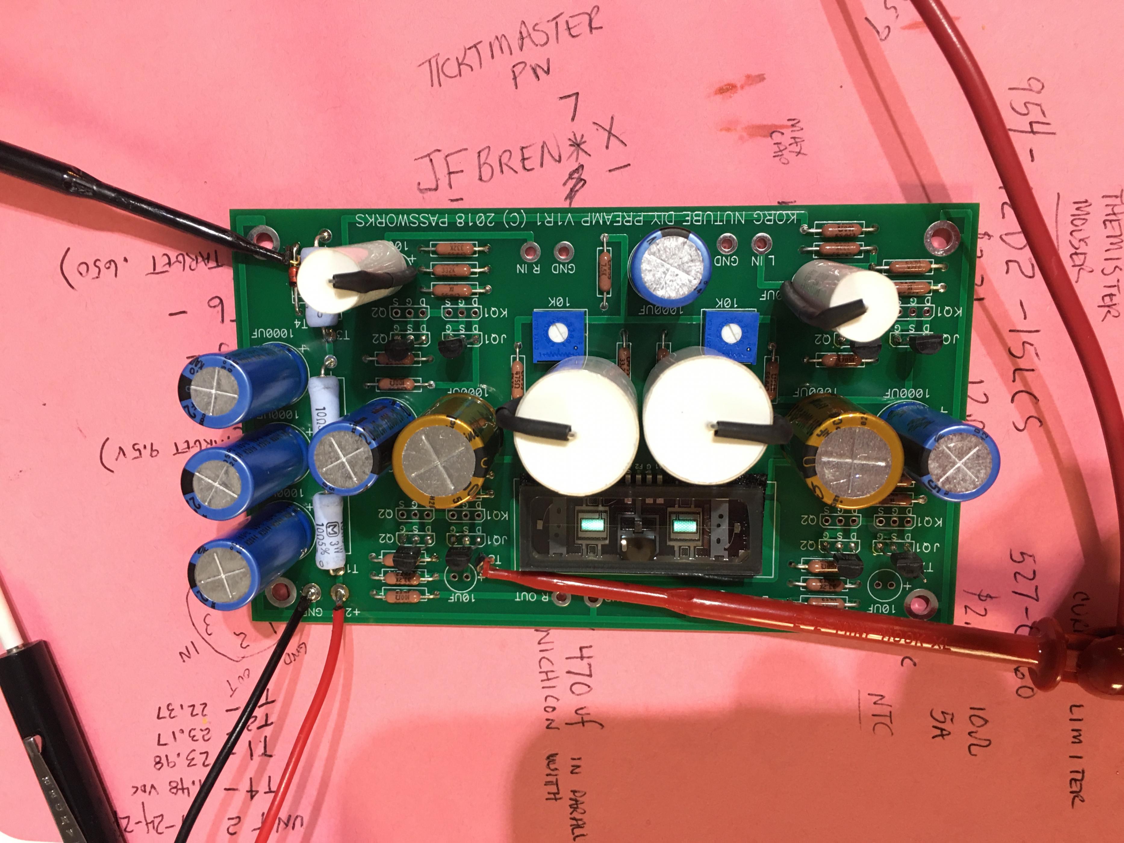

Thanks for reaching out….the NuTube acted funny on first start….glow then no glow…reflowed. More jumpy…all voltages spot on. I matched all components on both sides. After a tedious NuTube extraction (fortunately I had a backup) I replaced. Fired right up…able to set both at 9.5…it’s still running. Been about 10 min. I’ll let it go. No doubt a bum tube from the get go.
I think that he was saying that the voltage was Starting at 12.3 and went UP from there instead of down. After reading the post I am still not sure. Pots Maxed out, clockwise, or CC?
I’ve had three NuTube’s now, one was bad. I need to replace my stash. 2 good preamps up & running. And yes the pots were turned fully clockwise with the bum tube…but the filament was just fine looking so not clear what was wrong with tube. The back of the bum tube had 7BA.
