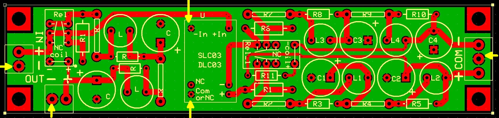

Need a grounding scheme
I would appreciate some help with a “how to ground” question.
I’m finalizing a design for a power supply for my B1K (24V) which includes the Academy Audio volume control (+/-15V) to solve the following issues:
1. The specified wall-wart does not provide adequate current for all the capacitors in the supply chain on startup, and the ON led comes on, then turns off, then comes on again permanently which indicates that the power supply’s short-circuit detection is reading the capacitor load as a short-circuit and momentarily shutting down before resuming.
2. The floating module which converts 24V to +/-15V works OK but there is no hash filter at the output so is probably delivering voltage with 50mv p-p hash riding in it.
3. Space in the diyaudio store chassis is limited, especially with my third pcb that deals with input & output relays, trigger circuit, etc.
So, I have come up with the single-board power solution as in the attached image.
1. Input surge is solved with current limiting resistors and relays that short them out after initial voltage has reached a reasonable (17v of 24, 9V of 15) level.
2. Added Mark Johnson’s PO89ZB hash filter to all outputs -- the 24V and both 15V.
3. Made the board as small as possible, and shaped it to fit along the side of the chassis with outputs at the right locations to minimize wiring. The board is 5.175 inches x 1.15 inches.
So, now I have to figure out grounding – considering the other wiring of the B1K, which input grounds and output grounds on this board should I connect together and which should remain isolated. The output of the dc dc converter module is floating (not connected to the module’s input ground), and what to do with this is my question.
Ways to deal with this could be a) split the ground plane as required and/or connect the various pcb ground points with traces in the appropriate manner.
I’m scratching my head and I don’t want to mess this up so any help would be very welcome.

Never mind, I think I got it. In this case connect the floating ground to chassis ground because this application doesn't benefit from keeping it floating as long as it doesn't create a ground loop.
Lots of articles about how floating grounds allow esoteric solutions and unusual configurations and not many address a conventional application like this one. :confused:
