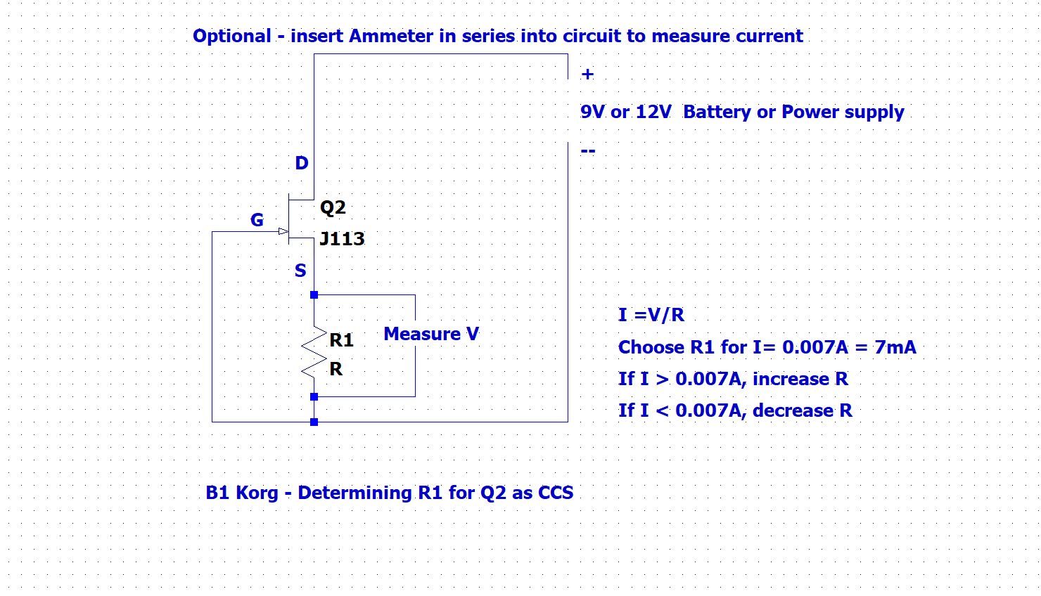

Q1 is the input buffer and Q2 in conjunction with R1 is a Constant Current Source (CCS) that sets the current through Q1.
The current sets the operating point of Q1, and NP prefers 7 to 10 mA:

Idss of J113 varies greatly from sample to sample, and is generally much higher than 7mA, although some may be in that neighbourhood. So to use the J113, it is easiest to test and find the value of R1 that will work with Q2 for a current of 7 mA. For this any J113 with an Idss of 7mA or greater will work for Q1 and Q2. R1 is chosen individually for Q2. Matched JFETs are not necessary. The only matching is R1 to Q2 for each channel. If you prefer identical R1 in both channels, then Q2 needs to be matched.
Matching procedure:

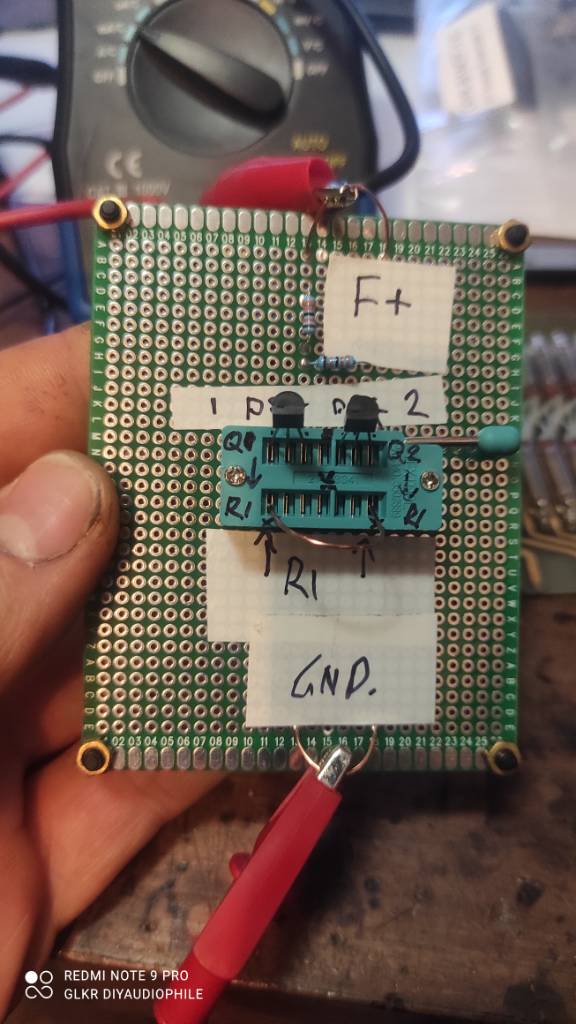

Matching j113 FETs won't be a problem, I bought a 1000 pack,
They all however sit between 15 and 24mA idss.
I have multiple boards I've made to test the proper Idss values as needed.
This test board is the B1 buffer circuit I've assembled onto this PCB board.
And I'm feeding it 24v reg power, and watching mA draw.
These jfets in the board are two matched at approx 18mA each, with R1 as 0 ohms.
They read 9.3mA approx, I can easily trim it down via R1 to the correct mA draw if this is acceptable.
Or pick lower idss jfets if I can find them.
I was wondering if I'm on the correct path.

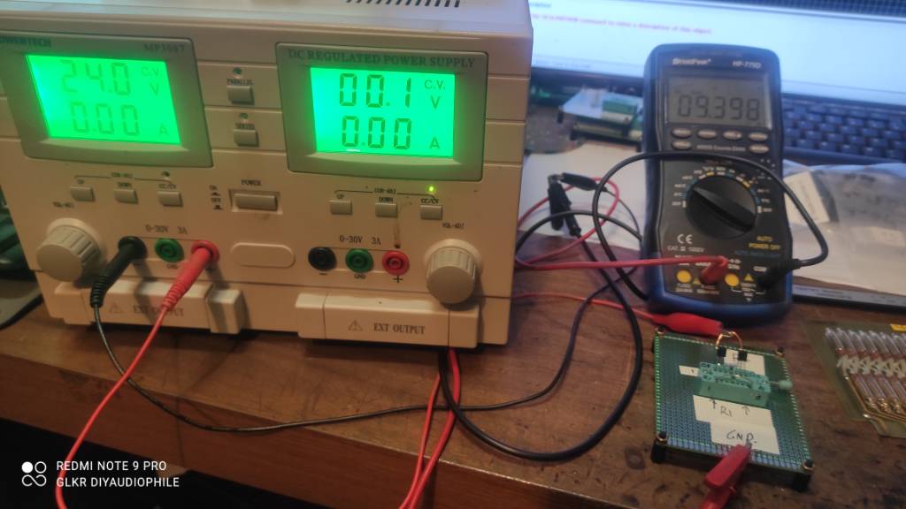

I use a Tkd pot on front to adjust the current. You can get the sound you want. But now I am selling my Korg to a friend. Haven't used it much. There is a Aleph 1.7 as buffer after the korg. There is better possibilities out there.
View attachment 993964View attachment 993965
It's hard to tell from the pictures what your test circuit is. A schematic would be informative.
If the Idss of both J113 is 18mA, then the current in the J113 CCS/J113 Buffer circuit should also be 18ma if R1 is 0 Ohm.

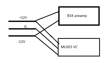

Hi need some help here.
I'm going to add cademyaudio MUSES remote volume control with my B1 Korg, on their web site there is a pdf file shows how to use it with B1 Korg, but seems little complicated, so just make things simpler, I will use a PS with +12V/0/-12V, connect +12v/-12V to B1 Korg, and +12V/0/-12V to MUSES, will it cause any problem? Thanks

Not sure what you mean by connecting +/- 12V to the Korg. The B1K requires 24V with the 24V ground tied to the common of the +/-15V for the volume control.
On the AA website there is a paper that suggests making quite a number of changes to the B1K pcb in order to make it play well with the AA power supply which powers their volume control. I think this is what you are talking about. Yeah, too much modification of the Korg pcb for my taste.
My preferred alternative is to simply generate the +/-15V (or +/-12V) for the volume control from the 24V B1K supply.

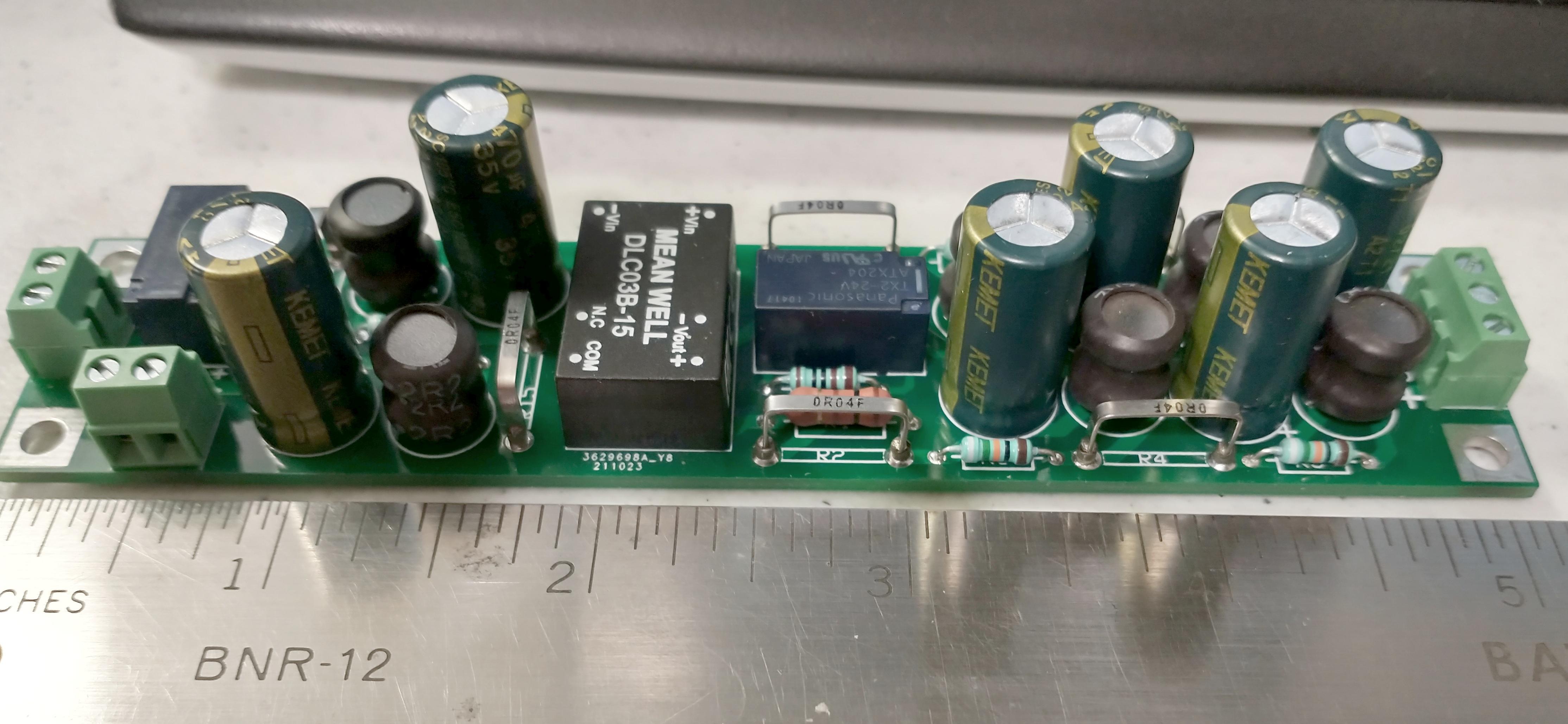

When I first built my B1K I used a basic Mean Well dc-dc converter to make +/-15V in-chassis from the 24V wall wart to drive the Academy Audio volume control while simultaneously adding Mark Johnson's hash filter to the 24V B1K supply. It worked fine. I have now designed a board that includes Mark's filter on all three voltages. It fits down the side of the chassis starting at the power input jack.

That's what I thought about, but you mentioned the ground of B1K need to connect to common of MUSES PS, so it won't workNot sure what you mean by connecting +/- 12V to the Korg. The B1K requires 24V with the 24V ground tied to the common of the +/-15V for the volume control.
If I add separate PS for MUSES only, does two ground need to be connected?
