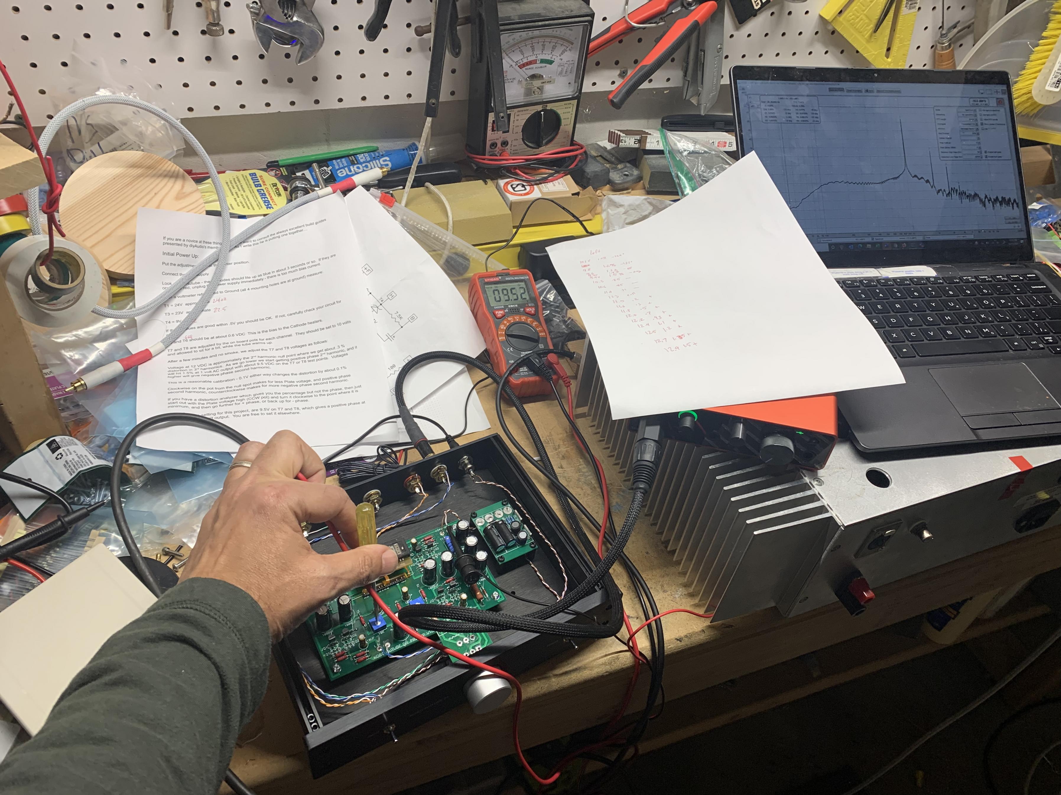

Another B1 Korg is born! I put a smps filter in, and used a Pete Millet vibration mounting kit in the build. This one doesn’t have the microphonics problem I was worried about. I don’t know if it’s the tube itself, the mounting kit, or both.
I used my Akitika signal generator, Focusrite scarlett solo, and REW software to measure distortion profiles at 1kHz and 1V. I found the null point and ran up and down to 1.5% positive and negative phase for both channels, then set it for 1.3% negative.
Once again the DiYAudio build guide is FANTASTIC. This is a fun project build and sounds quite nice!

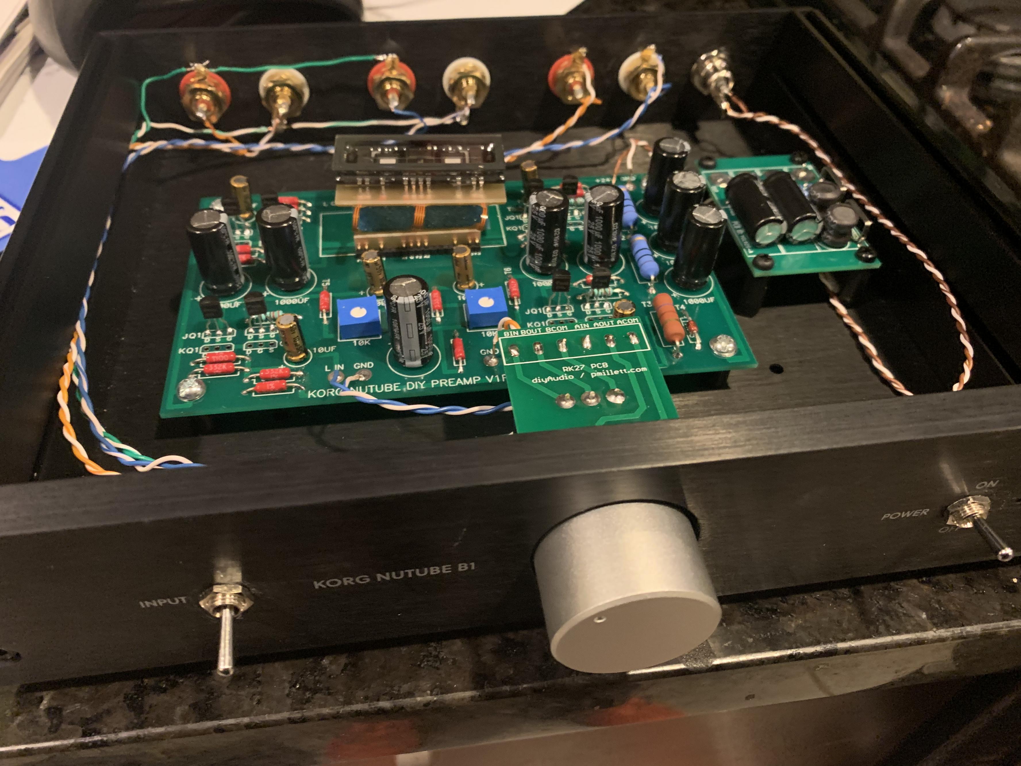

Updated version…. Changed to 25 turn pots and added some test point jacks to the back of unit for ease of adjusting. It’s singing now with a rebuilt F5 clone I also finished this week.

ROTLOL... now we got to get those test points to the back panel, with a switch selector in the front and an old fashioned bakelite calibrated VU meter.
YOU DID PUT THE TEST POINTS...
