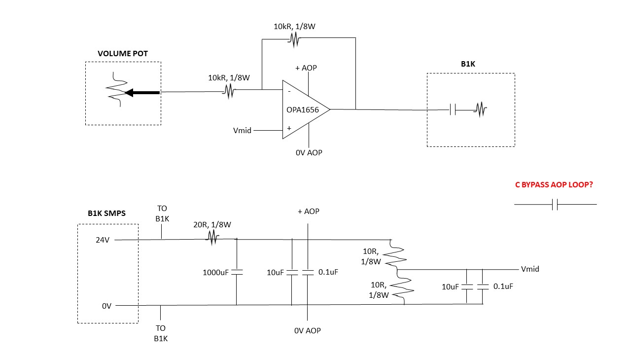

That's what I thought about, but you mentioned the ground of B1K need to connect to common of MUSES PS, so it won't work
If I add separate PS for MUSES only, does two ground need to be connected?
Yes -- 24V gnd and dual supply common (gnd) must be tied together. The schematic image you attached will not work, don't try it.

This is what I came up with regarding inverter circuit and not polluting the B1K power supply...
First time I do this, so if you see anything, please shout!!
Especialy since I took various values as I felt "reasonable"... and wasn't sure about inserting a cap in the (negative) unitary gain loop
Thanks for your help

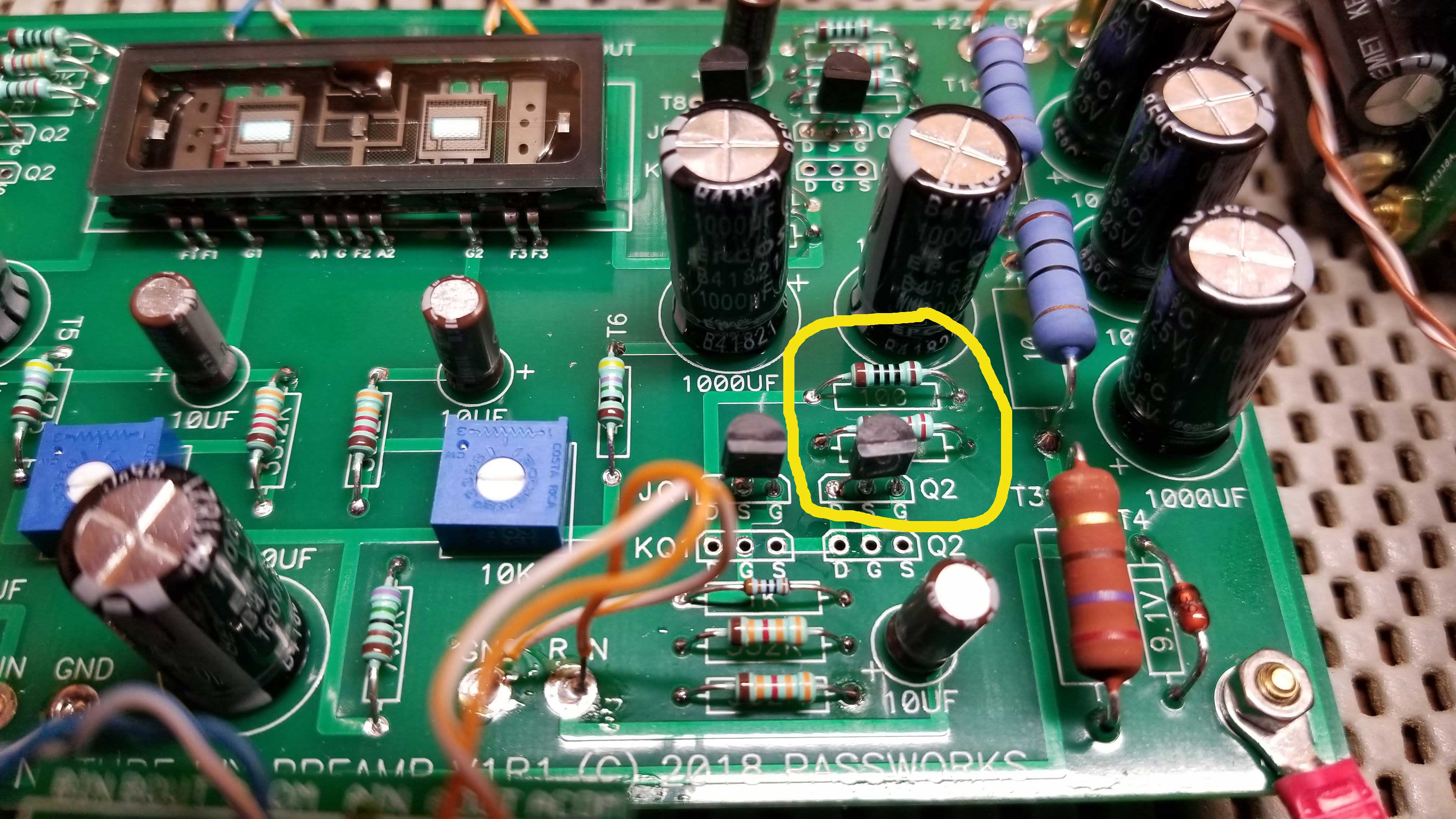

Resistor Heat
Enjoyed this build to put in front of an Aleph J.
I'm wondering if it's normal to see R1 and the 100 ohm resistor on the right input side putting off a lot more heat than the left (~30c difference)?
It's a stock kit build, with an SMPS filter.
All the voltages are close to what we should see, and sounds great:
Joined 2012
If both resistors are the same value and if the voltage drop across them are equal, then there is equal current flowing in each resistor. You didn't mention the resistor value so I have no idea what the current is. However, assuming that the resistors are of the correct value and therefore the current is also correct, the resistors should not be dissipating enough energy to heat up. Were the J113s and R1 resistors part of a kit or did you match them yourself?
So it may be that the 100R resistor is heating up R1. What is the voltage drop across the 100R resistor?
Also check the voltage drop across the corresponding 100R in the other channel. It is located at the lower left of the PCB, below a 332K resistor.
Joined 2012
The voltage numbers are more or less the same for both channels and they do not look out of place. The 221R for the resistor seems reasonable as that would give I = 1.67V/221R = 0.0076A, which is within the specified range of 4 to 8 mA.
I don't see a reason for the resistors to be that hot. The 100R resistor dropping 1.5V is dissipating 0.023W and the 221R resistor dropping 1.67V is dissipating 0.013W, so they should not be hot.
So except for the hot resistors, everything else seems normal.
