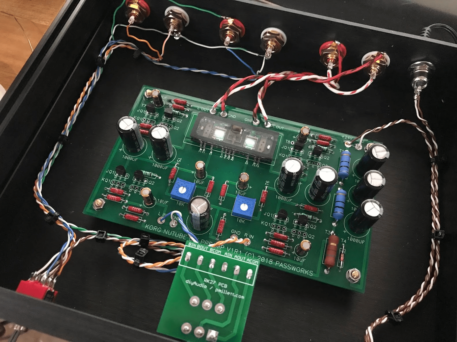

Hi all, very loving this preamp built from kit. Bit of a troubling issue possibly unlrelated to the build but all help appreciated.
I have a home energy management system that communicates over powerline ethernet to a smart hot water tank. When the gateway and tank are on (they're each on separate mains circuits), there's audible hash coming out of the preamp. Turn the tank off, still there (different noise), turn the gateway off and ahhhhhh, quiet. No other audio system in the house suffers this problem.
The wallwart is plugged into a filtered powerboard. Deleting the powerboard doesn't change that, neither does swapping the wallwart for a minty-mint Meanwell 24DC item.
The hash is most audible when the volume is set at minimum.
Any ideas?

Try using, if possible, wi-fi instead of powerline ethernetHi all, very loving this preamp built from kit. Bit of a troubling issue possibly unlrelated to the build but all help appreciated.

No can do. Hot water tank is powerline eth, and very chatty.Try using, if possible, wi-fi instead of powerline ethernet
Trying to get an understanding of what's causing this; signal route ATM is DAC>pre>active speakers, when I bypass the pre and go DAC>actives... not a peep. Dead quiet. Very odd. Any ideas?
@rmpfyf
I don't understand why you used single twisted pair for L & R signal and another single twisted pair for signal ground of L & R on input RCA, that is conceptual wrong.
Twisted pair should carry only left (or R) hot and signal GND, other twisted pairs should be for rest of the RCA connectors. Twisted pair have function to minimize interference picked from nearby wiring. Is your case grounded? don't see well what type of power socket it is, is it isolated from case? If not isolated then you have power GND connected to the case and you form protection from outside RF signals or interference. Is your case anodized aluminum? If yes, then you should on some way enable good electrical connection between parts of the case to comply Faradey cage.

@pitbul thanks much for this reply.
The twisted pairs confused me also, it's wired as per the build guide https://guides.diyaudio.com/Guide/B1+with+Korg+Nutube/12
Power socket is just a usual plated 2-pin barrel jack carrying 24VDC. Case is the kit case as per that build guide (anodized aluminum). I haven't e.g. taken off any anodising around the barrel jack for continuity to the chassis; will test tomorrow (~3AM here) but it may be isolated from the case.
Is anyone else with the kit doing differently? Did I miss anything obvious?
