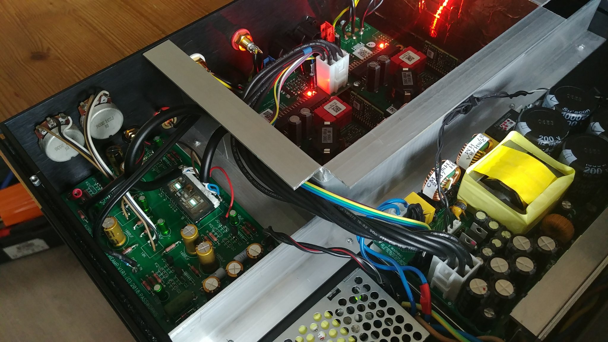

Look at this pic
Blue/white-blue will go to input of the board, Orange/white-orange will go to another RCA input (other channel not attached to better understand the pic), all white-any color are connected together at switch side as you can see.
As you can see single twisted pair will carry one channel (green/white-green = L left channel & brown/white-brown = R right channel), white-green, white-brown and white-blue are tied together, alternative is to use another pair of switch to switch signal ground, but I do not prefer that. If you have spare switch contacts you can do that and isolate signal ground of second RCA input.
I took this pic to clarify your error.
Please check is your power connector with minus pol connected to the chassis, simple switch off unit on the switch and measure if you have connection to the chassis. If you have that connection that is your ground loop. With switched off unit measure do you have connection between signal ground and chassis, if yes then you have your board grounded and you don't need another join to the chassis, that is your ground loop and you will probably loose your unwanted noise.
@pitbul I want to thank you personally, I rebuilt it using your guidance. I did have a wiring error with one of the power connections just touching the chassis. I rewired the signal routes as you suggested and went a little further - I bypassed the switch altogether (I only have one output) and wired the two outputs parallel (so I can run 2.2).
Sounds much better and the PLC noise echo is gone. There's a bit of hiss though I'm not convinced it's the pre's fault.
