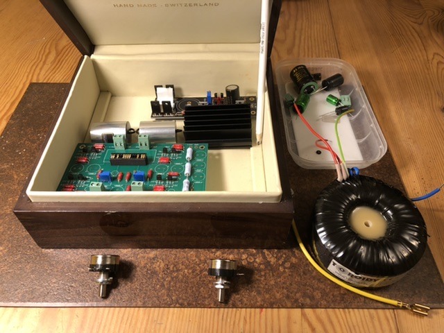

B1 with Korg Triode
Yep, sure, one half each of 2 stereo pots does the trick... it is just more expensive and the Alps won't sound as nice, but no drama, it is an OK pot.
It's okay about the price difference being a little more costly, Claude. Just want to make sure that setting this up with two volume pots was not going to induce any extreme negative consequences to the Mr. Pass's overall Korg design.

Thanks Mike,
I only asked because I was going through some old electronic parts stash and came across a 100K Alps pot that looks very similar in shape and size. I can safely conclude that the 50K and 100K are an obvious mismatch for the intended purposes of using a separate dual L&R volume pot.

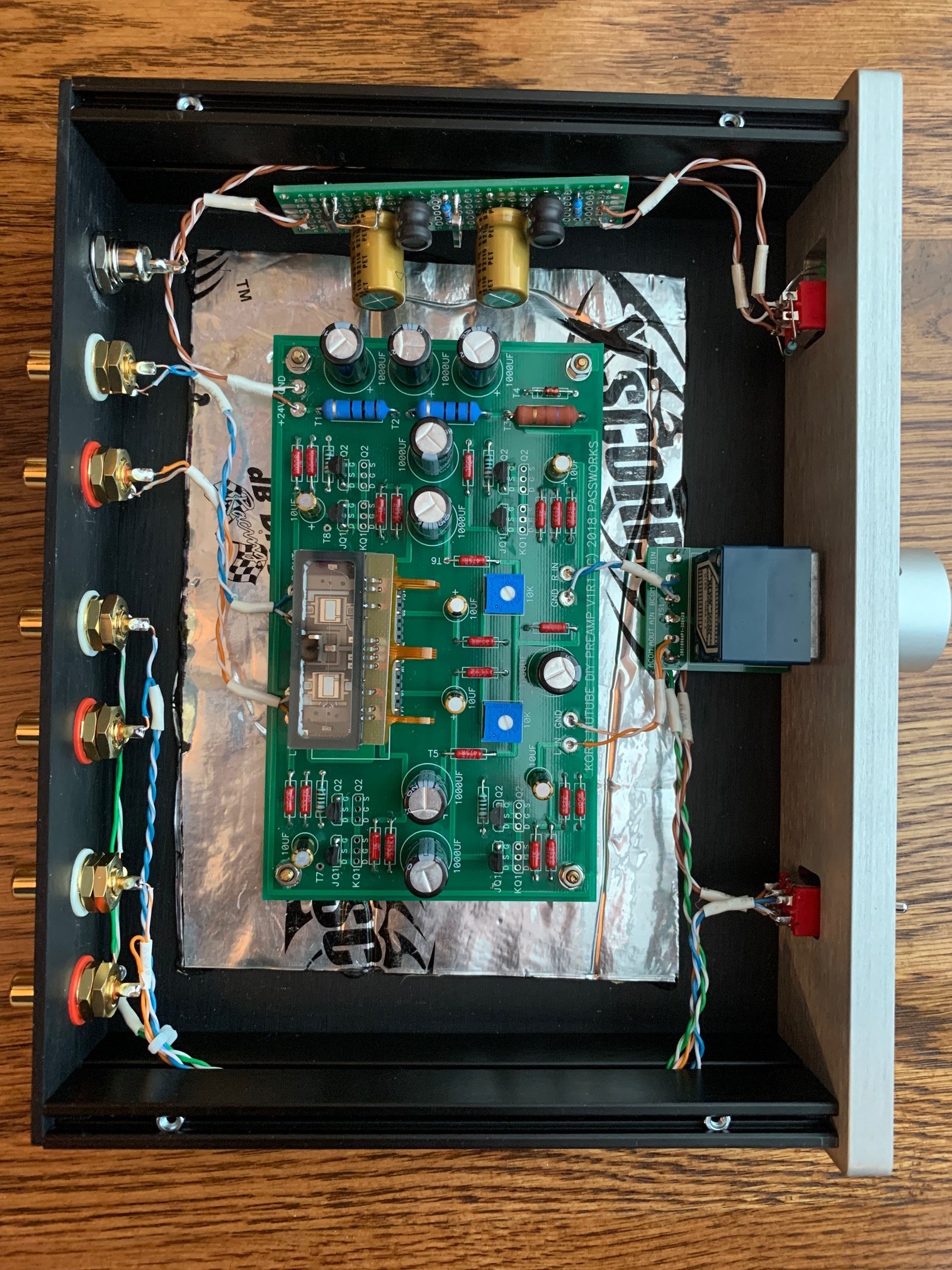

Another Korg B1 success. Great fun.
P2P wiring for the inline filter - fits neatly there on the side (just need a couple of standoffs to mount it properly)
Was able to source unused sliver front kit from fellow DIYA member on swap forum because I had no patience to wait for DIYA Store restock.
Currently teamed with Nobosound D class amp at my temp home in DC, so looking forward to getting it home to UK next year to try it with my ACA and other amps.

Nice! Where's the inline filter from?

Thank you. When they're back in stock I'll order a bunch - what a useful little board.
