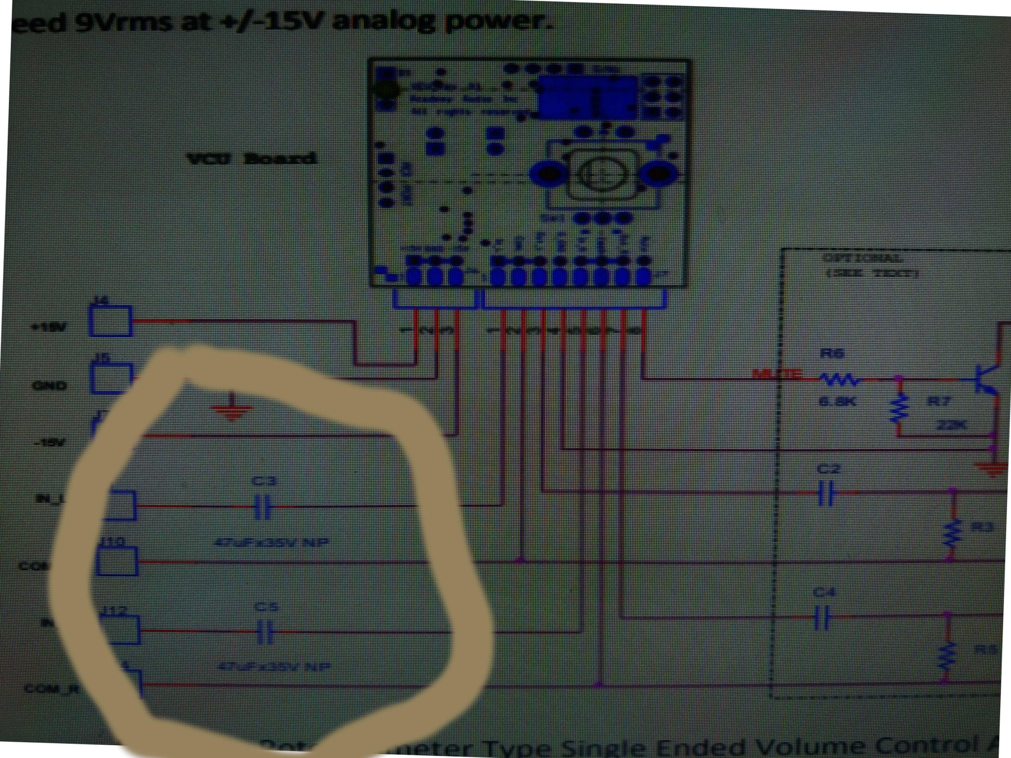

Hi, I would like to put a Muses remote Control on my unit & am confused. the Audio Academy site advised that a DC blocking cap around 47uF should be fitted on the inputs with a bi-pass cap. However on studying all the implantations on this site I can find. I cannot find anyone who has done that. So are they needed & if so what would the best recommendation be. I have a separate P/S for the unit so this is no problem.

Did the thing others have done bypassing the signal caps with 0.1uF polys (Wima FKPs in my case - Vishay makes caps with a similar construction, though more costly, and Pana made nice ones now out of production).

Hi, I actually was inquiring about the blocking caps for the input.
-Just to clarify, I am placing my Muses V/C before the B1 Korg, is that normal? or the Muses be placed after the B1 Korg. With the Muses placed before the B1 do I need the 47uF blocking cap & bi-pass as per Muses instruction sheet.

Yep - sent you a PM to that end the second I realised!Hi, I actually was inquiring about the blocking caps for the input.
Yes, normal to be before.-Just to clarify, I am placing my Muses V/C before the B1 Korg, is that normal? or the Muses be placed after the B1 Korg.
If you wanted to use blocking caps you could use most any non-polarized type just to get it started. If you expect no DC, just start without them.-So yes now I see how the the by-pass caps on the board, however the Wima at Mousers has a 33 week restock wait!! So I will have to find something else.

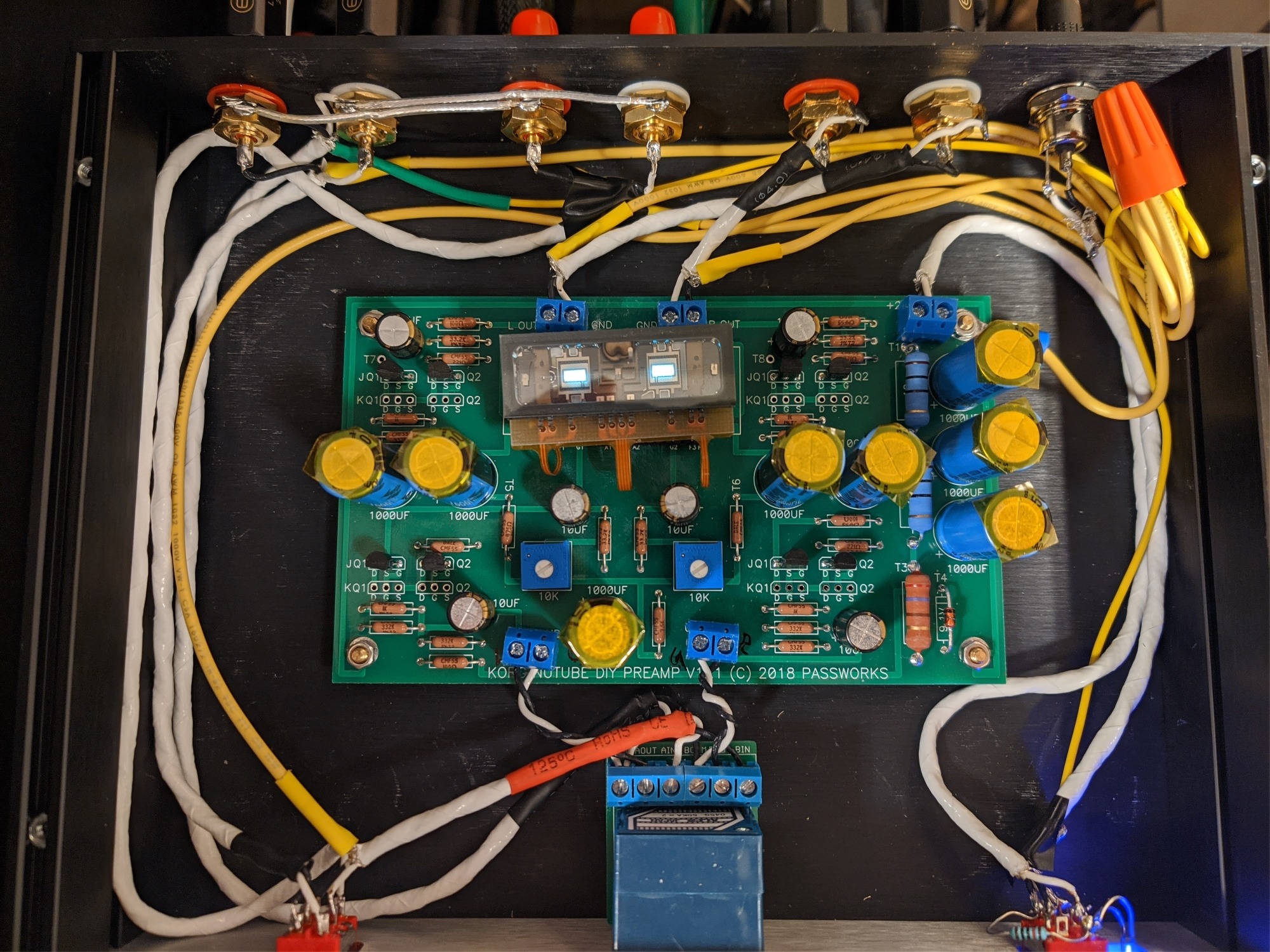

I'm also looking to refine my construction of the B1K as well. As you can see in the attached image, I used shielded wiring for signal, and the shields yellow wire all tie back to the orange wire nut, which then ties to the ground nearest the voltage input on the B1K board. I did it this way before putting a lot of thought into it, and I wonder if it would be better to shorten up shield wires and attach them to the nearest PCB mount, curious on what peoples thoughts are on that.
