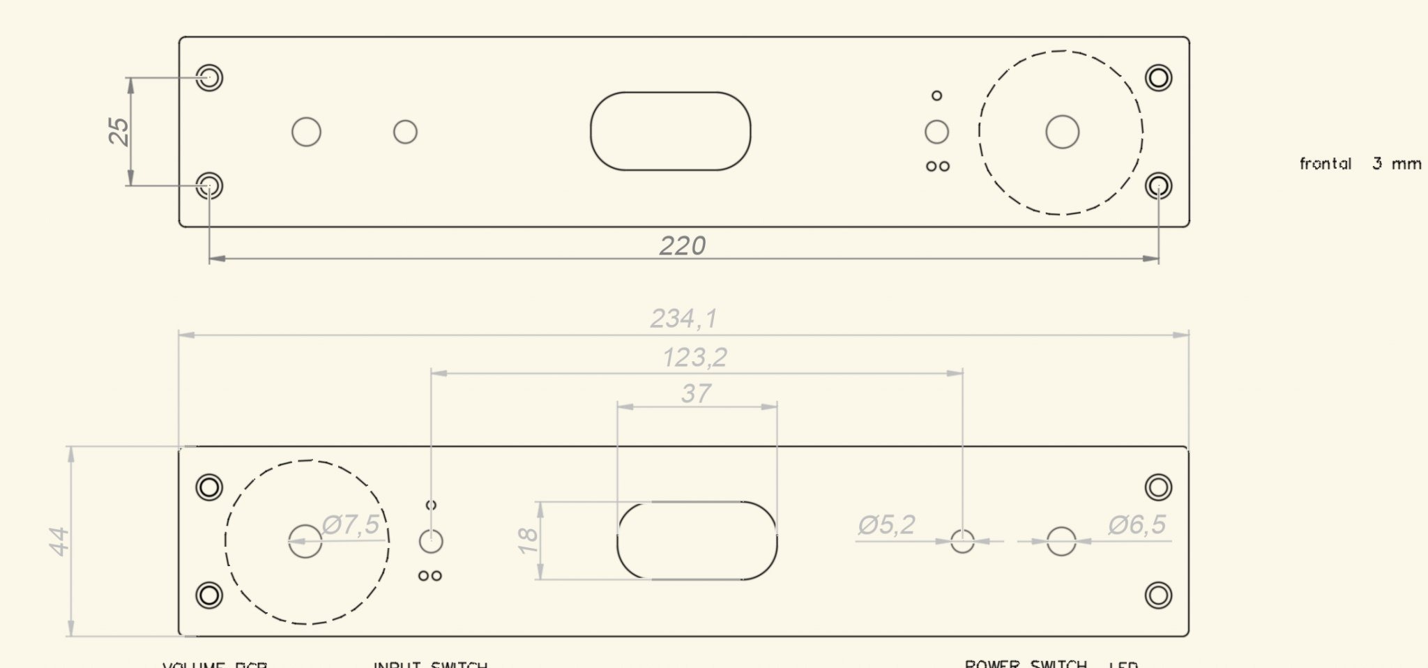

Thanks for the feedback seipersei. I believe you are correct, it is a Galaxy 247 front panel.
Front Panel Express has their own software (very simple for guys like me) so if I know the spacing I can locate them appropriately. I looked on the Modushop website without any luck.
Right, I found the measurements of my own front panel design. Take this with a pinch of salt because I used the 3mm thick version and I can’t find the DWG for the 10mm version, and as HiFi2000‘s website was just renewed a lot of their links are broken at the moment so I can’t download their original file to double check. However I‘m pretty sure the front panels are interchangeable so the mounting holes should be the same. Also, ignore the other holes as they’re for my own choice of components and so they may not fit the DIY Audio store kit

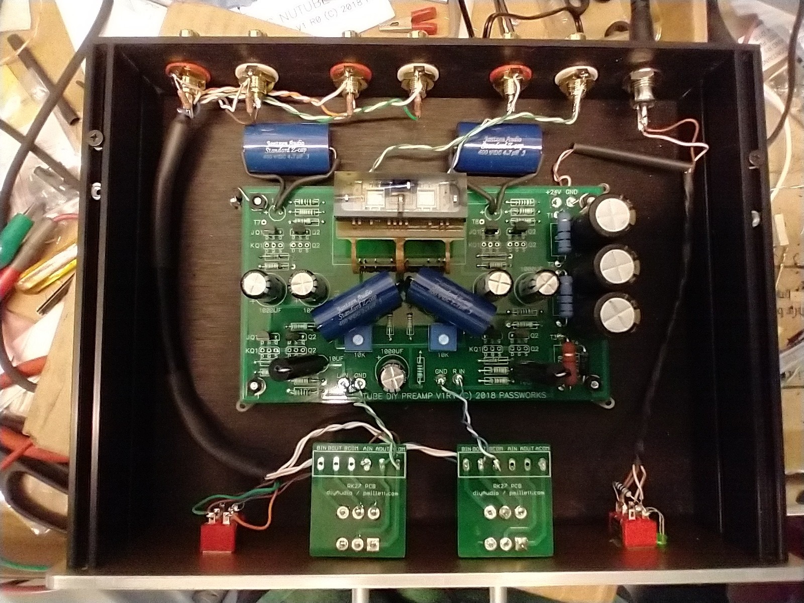

I've just completed building my second B1-K, using the output cap values proposed by Claude, and it sounds terrific.

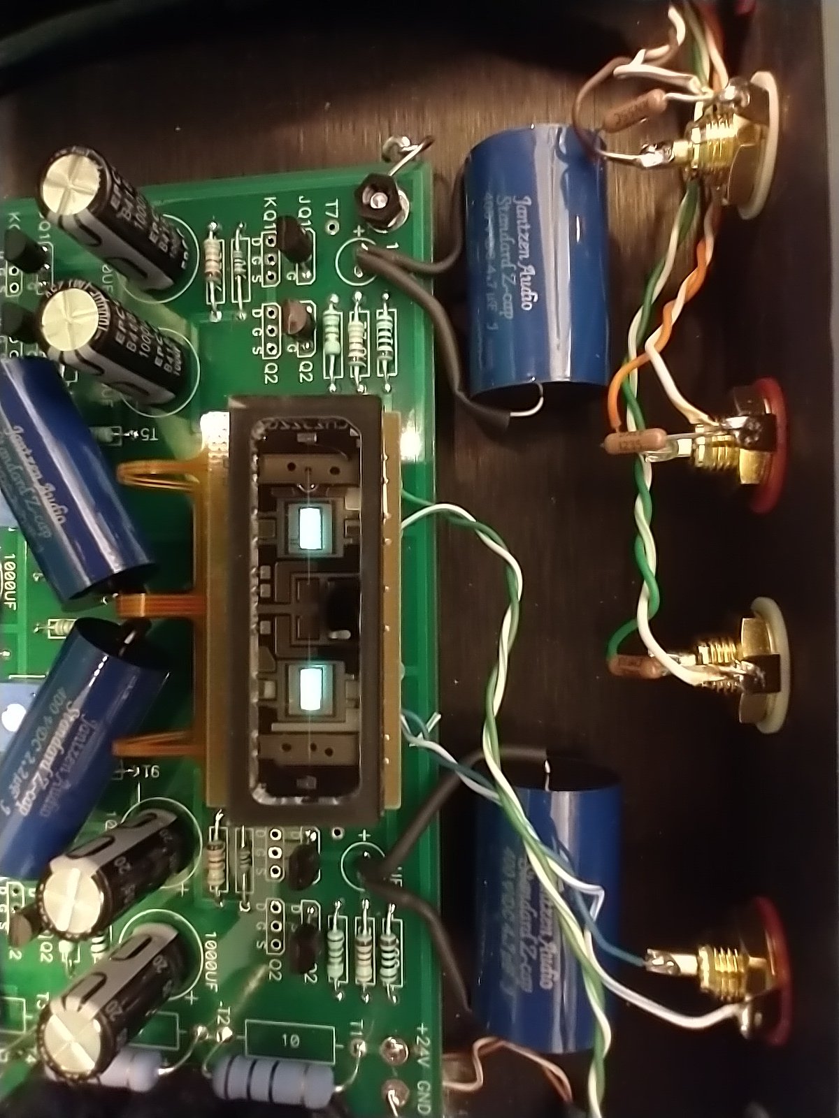

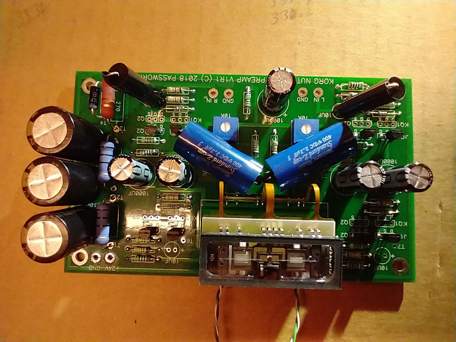

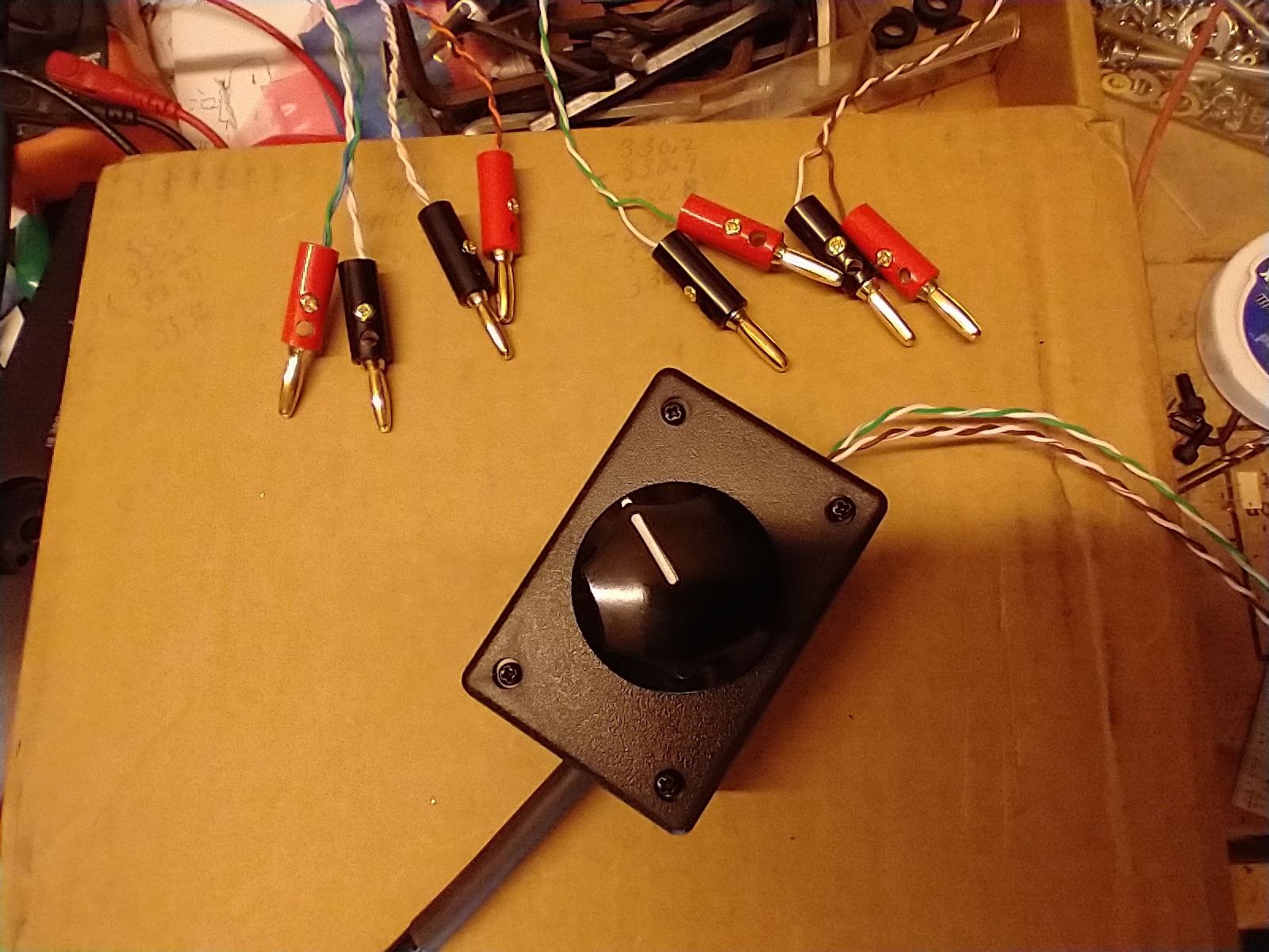

Board is stuffed, well except for the output caps. While I wait for the front panel I built a switch (4 pole, 3 pos) that will allow me to switch phase with the twist of a knob.

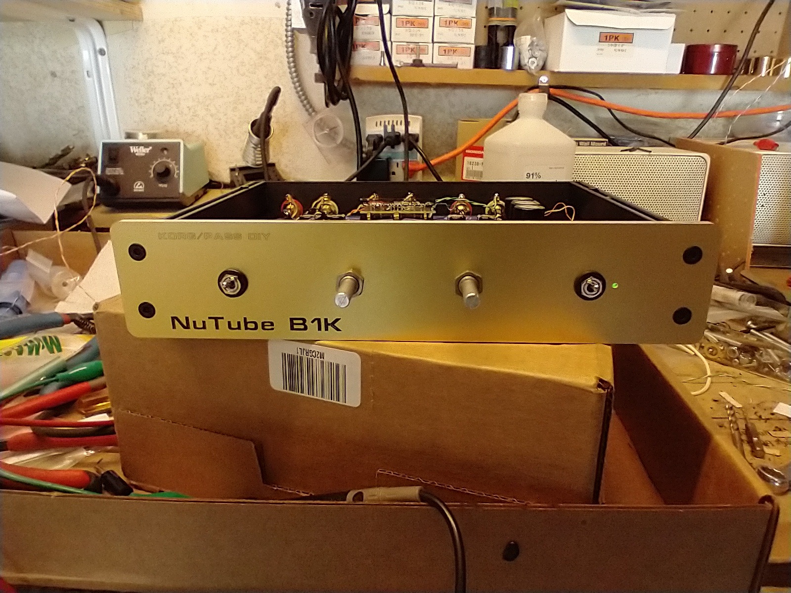

It's up and running. NuTube has a nice blue-green glow. TPs 5&6 - .66 - .68 V. TPs 7&8 started out close to/just over 11 and adjusted down to the recommended 9.5V. The off-board caps are stuck to the bottom of the chassis with Blu-Tac and the PM NuTube mount is held gently in place with a Blu-Tac/Foam/Blu-Tac sandwich. I removed the anodizing on the panel contact points/screw locations and connected a single ground wire from one corner. The sound check on the bench showed no hum or noticeable microphonics, even without the top plate installed. Now I need to find appropriate volume knobs and give it a proper listen in the upstairs rig.
Thank everyone that contributed to this thread and project; especially Mr. Pass.
Karl
