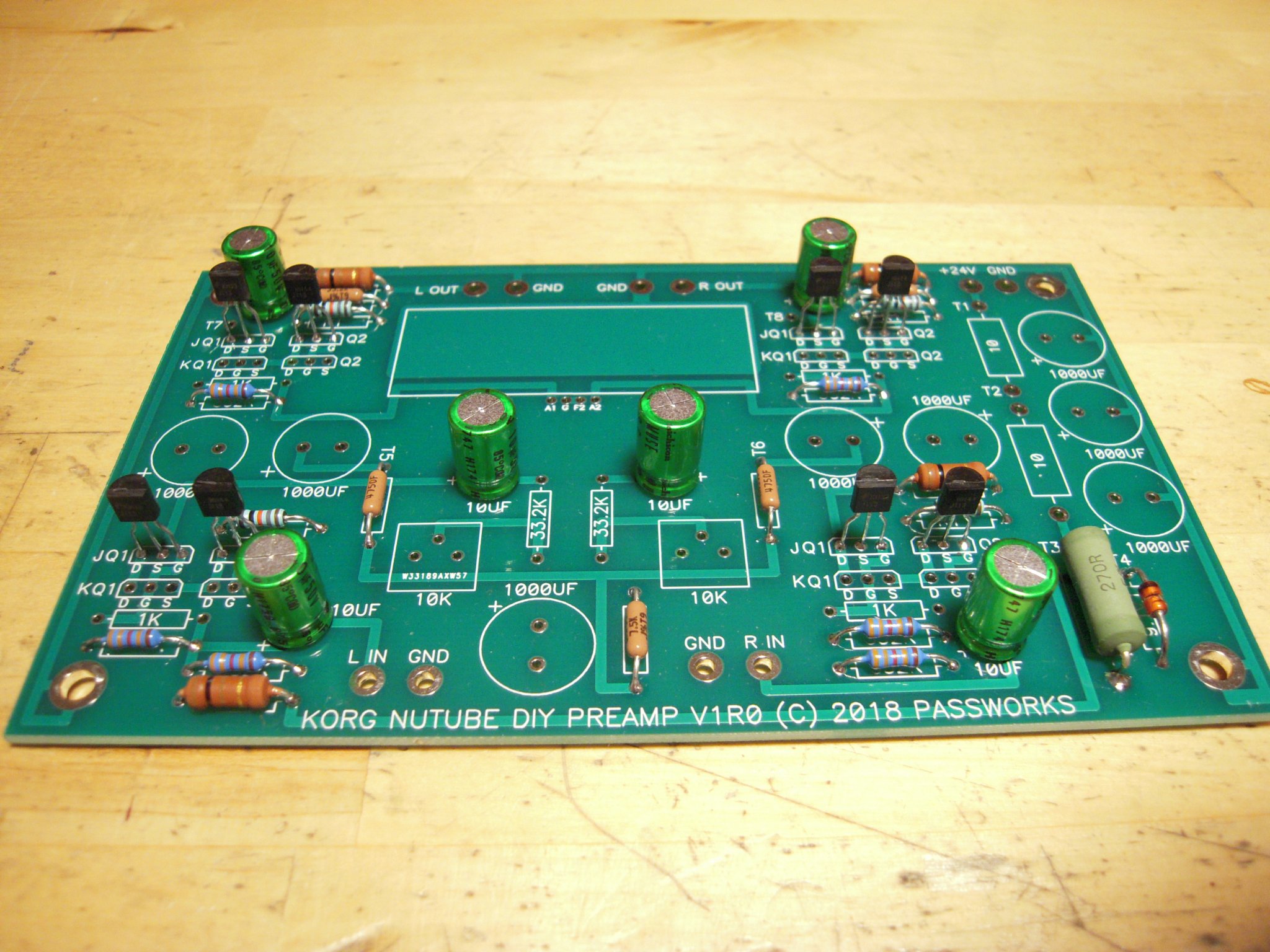

Good evenning Mr Pass, i have just receive and build the B1 korg nutube pre and i need some advices from you if you can.First the transistor that they send me for Q1 does not fit in any of the two places (JQ1 or KQ1),( I check the transistor that they send me and it is SDG,see the attached picture) do i need to change the transistors with new one or not? My second question is that i have an extremelly high gain and too much bass sound ,any suggestion please? I build it following your video ,i dont think that i made any mistake.Please help

Hi, the photos are very very low in resolution, it's hard to tell exactly what you mean. Can you post them in a higher resolution? Also assuming that you're using all J113 I think I can see that you put Q1 in the right place but Q2 in the wrong place (they should be on the same "J" row, next to each others)
thrasos:
Your mega tester is mis-leading you. SDG=DSG. Source and Drain are interchangable as far as some testers are concerned. Put all kit supplied J113 devices in the "J" row.
You are right ! I put them on J row and sound get much much better, Thanks a lot!! Is there any other suggestion to upgrade it such as better capacitors or something else ?Thank all of you in advance
Before getting into capacitors, plate voltage and signal polarity will have the most effect. Starting with the voltages at T7 an T8 stabilized at +9.5V, try reversing loudspeaker leads and decide which polarity you prefer. Then try upping the T7/8 voltage a bit. I prefer +9.75V with speaker wiring reversed. Your preference may differ based on your specific system. Once you are happy with that, then you can get into smaller refinements like input coupling caps.
