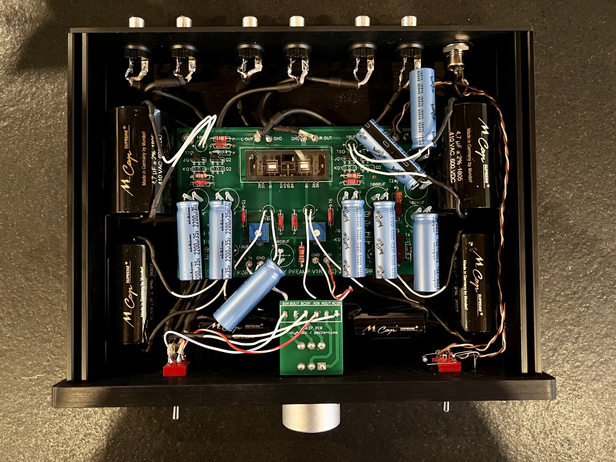

Hello Everyone,
I just built one of the kits for a friend of mine, and I combed through this thread somewhat carefully to see what everyone was doing for upgrades and tunes to this piece. I ended up going with the following (thus far):
KLE innovations RCA connectors
Takman REX Resistors in critical locations
Mills MRA-5 Resistors in power circuit
Vibration isolating rubber standoffs
Mundorf Supreme coupling caps (0.33uF, 1.0uF, 4.7uF) Precision matched
Nichicon UKT 2200uF 35V Electrolytics
Mogami shielded signal wire, PTFE/silver plated wire in signal path.
It was definitely a tight fit in the stock kit chassis. The coupling caps are double sided taped into the case so they don't move around, and it definitely required a bit of creativity to get the nichicons to all fit (definitely an oversight that they wouldn't clear the case top!)
The results are.. WOW. This thing competes with some really good stuff. Its clean without being solid-state-sterile. Excellent bass control, superlative mods, and realistic on the top end. Thank you to the community here for keeping such great tabs on the process, development, and mods for this little beast! Might have to go build myself one next!

Have you tried a different power supply brick? It seems like noise in coming through the lines and the stock power supply is allowing the high frequency noise to come through.No can do. Hot water tank is powerline eth, and very chatty.
Trying to get an understanding of what's causing this; signal route ATM is DAC>pre>active speakers, when I bypass the pre and go DAC>actives... not a peep. Dead quiet. Very odd. Any ideas?
For testing.... remember that homes have two sides of the 220 coming in... the "neutral" being the shared line. Try plugging the Korg's power supply into the other leg of the 220 ( get a long, three prong, heavy duty extension cord ). I figure your water tank, gateway are on different circuits but both are on the same leg, and your Korg is too. See if powering the Korg from the other side "solves" the problem.
Fundamentally, IMHO it's not a good idea to use networking over the AC lines... but it is what it is... so what you need is to add some filtering to the Korg's power brick AC line, or get a different one brick.

Actually, my B1 Korg has that part as well.
Thanks. I'm in Australia where mains is LNE. The house has multiple incoming phases though the gateway communicates on the lot of them. I was a le to achieve a better outcome with better wiring etc. Not all noise is gone - it's within range of my tv (plasma - throws off some significant noise!!)
Tried multiple bricks, same result. Getting noise abatement right is part of why we DIY with much nuance to learn, and honestly the diyaudio community always seems to ship good parts.
I'm on the wait list for those filters though honestly I'm likely to recase the kit alongside a sigma11 PSU for fun, and switch the volume to a shunt type.
