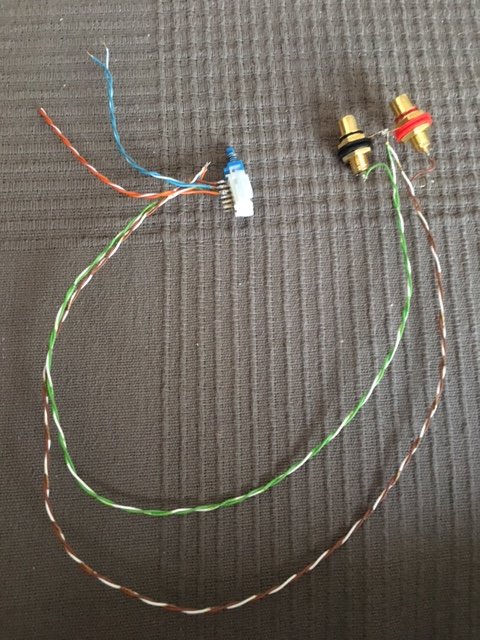

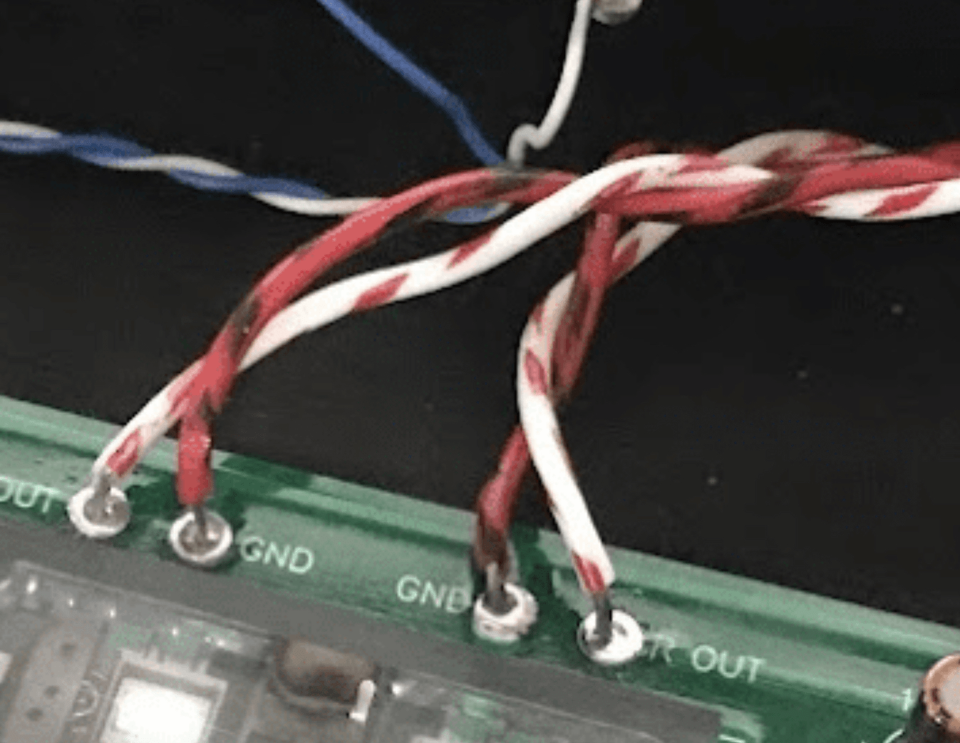

I don't understand why you used single twisted pair for L & R signal and another single twisted pair for signal ground of L & R on input RCA, that is conceptual wrong.
Twisted pair should carry only left (or R) hot and signal GND, other twisted pairs should be for rest of the RCA connectors. Twisted pair have function to minimize interference picked from nearby wiring. Is your case grounded? don't see well what type of power socket it is, is it isolated from case? If not isolated then you have power GND connected to the case and you form protection from outside RF signals or interference. Is your case anodized aluminum? If yes, then you should on some way enable good electrical connection between parts of the case to comply Faradey cage.
I feel like those wires aren’t twisted, but it’s just a pattern printed on the outer sleeve. @rmpfyt is that the case?

Those wires have a weird patten on them and yes, the +/- pairs are lightly twisted. I ran out of skill with the supplied Ethernet core, so I grabbed what I had handy... wouldn't imagine that's the cause of this interference?

Look better what is grounded, on PCB there are some points which may be grounded to the chassis (case) and your power input connector too.
So, maybe you have ground loop which may introduce some strange noise (unwanted audio).
You did mess up for sure input wiring. Output wires will not have much influence on your problem.
Try to check that your input connectors do not have connection to the chassis (normally when ground wires unsoldered).
Who placed these pictures, what is your reference to build your Korg, do not know much about signal and return path. I suggest that you try what i suggested.
You will for sure get better L-R separation. You don't need connection between RCA gnd, they will be connected together on input switch selector. What is on the picture will have some sense if input RCA were in function with balanced input but that is not the case in this build. This build have two unbalanced input with switch input selector to select which input will be used.

I followed the official build guide linked earlier. I may have made a mistake (but I can't see where honestly - on that guide the L/R pos come off a twisted pair, which seemed strange but I didn't argue). I have enough wire to redo that.

Look at this pic
Blue/white-blue will go to input of the board, Orange/white-orange will go to another RCA input (other channel not attached to better understand the pic), all white-any color are connected together at switch side as you can see.
As you can see single twisted pair will carry one channel (green/white-green = L left channel & brown/white-brown = R right channel), white-green, white-brown and white-blue are tied together, alternative is to use another pair of switch to switch signal ground, but I do not prefer that. If you have spare switch contacts you can do that and isolate signal ground of second RCA input.
I took this pic to clarify your error.

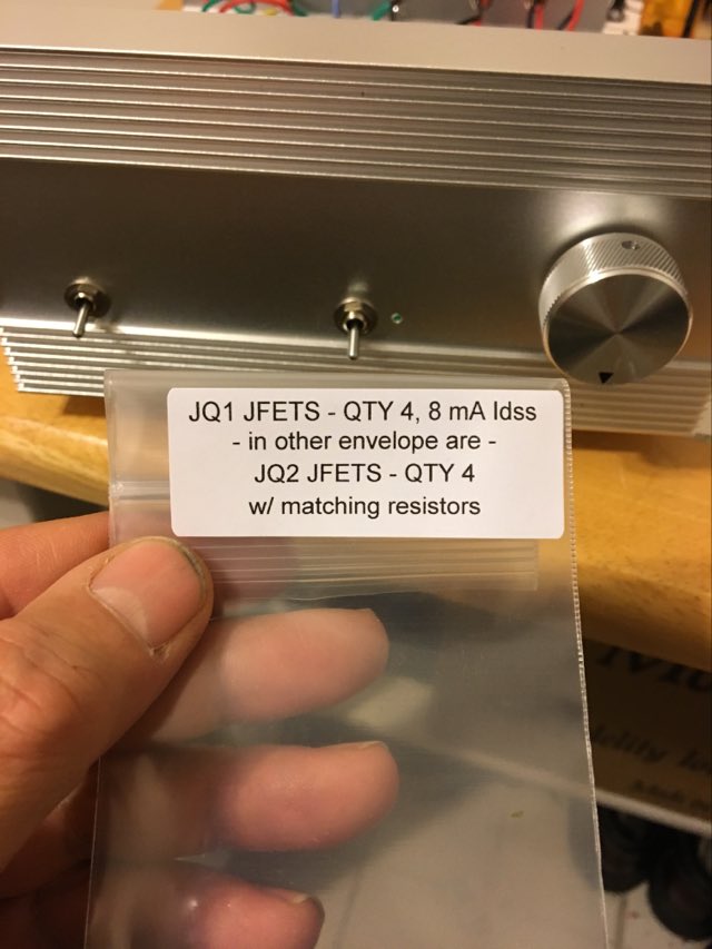

I just finished up building my second Korg Nutube Triode in which I had sourced most of the parts from Digi-key.
Only parts purchased through the DIY store were the transistors with matched resistors and the Alps volume control PCB add-on board.

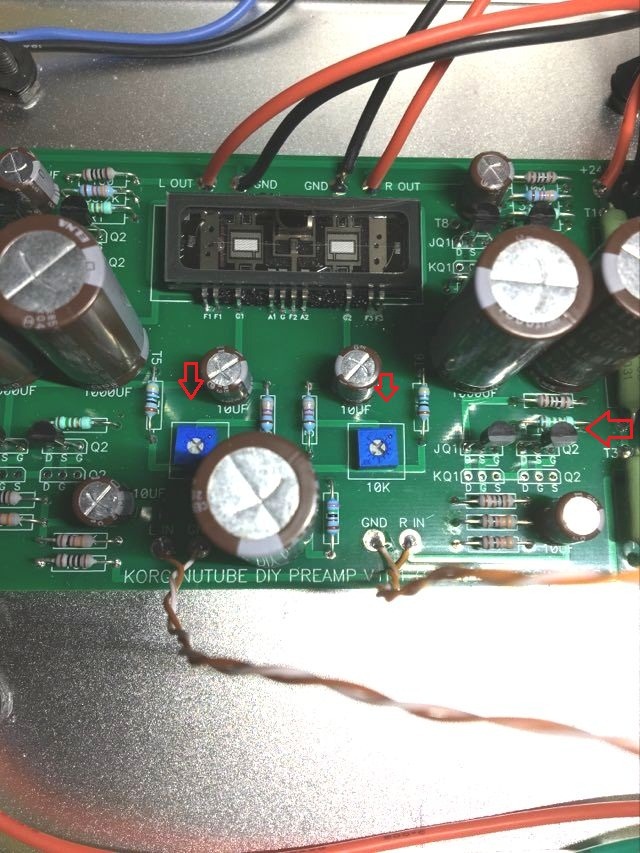

Here's the problem I'm having.
All my voltages are great except for the adjustment of the two 10k trimmer pots.
I couldn't find the 10k trimmer pots supplied in the kit sold by the DIY store so I substituted these Bourns Inc.
10k ohm 0.5w pc pin top. (see link below)
https://www.digikey.com/en/products...1088425?s=N4IgTCBcDaIMxwGxgE4EYAMcA2AzEAugL5A
No mater what I do with the trimmer pots the voltages remain up around 16v.
When making adjustments on the trimmer I do see the Nutube dim and brighten, but the voltages just about remain constant.
I also noticed that the transistor on the right (shown by the red arrow) temp is hovering around 138-f and all others around 80-f.
Any help from the Guru's would greatly be appreciated in helping me sort this out.

Hi Benjisan, Sorry to see that you have problems.

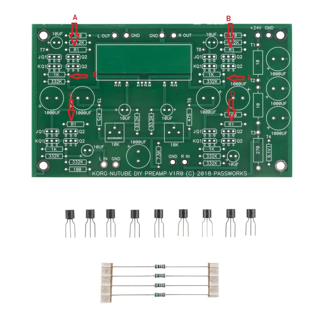

Since adjustment of the trimmers affected the Nutube, the trimmers are probably working. But to check, measure the voltage at points that I marked as "E" relative to Ground and "F" relative to ground as you adjust the trimmers. The voltage should vary with adjustment.
Since you purchased the JFETs from the diyAudio Store I assume that the JFETs are J113. Are all four resistors that came with the JFETs the same value? And what is the value?
The next check is to measure the voltage drop across each of the R1 resistors that I marked "A", "B", "C", and "D". If the resistors are the same value, the voltage drop across each resistor should be more or less equal. And the Voltage/Resistance should be between 0.004A and 0.008A.

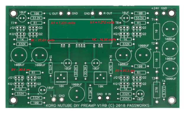

I posted a bunch of pictures to better illustrate the voltages I'm seeing.

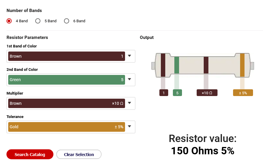

The first picture is the resistor value reading from the 4 supplied R1's that were included with 8 jfets within the DIY store Nutube kit in picture two.
The 17.01 v and 16.98v is taken from the leg of the 1K resistors.
I didn't get any voltage variation when adjusting the 10k trim pots from either side of the 1K resitors at all.
R1 by T7 measured 1.231 volts and R1 by T8 measured 1.272 volts.
R1 by T5 measured 00.8 millivolts and R1 by T6 measured 0.13 millivolts.
Are the discrepancies between the two sections of R1 voltages the issue at hand?

1.23V and 1.27V across the 150R are good, approximately 8mA.
0.8mV and 1.3mV are not good and will need to be looked at. But it should not affect the issue of the trimmer not having any effect on the Nutube.

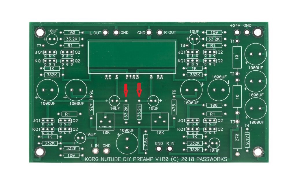

To continue with the trimmer issue, please measure the voltage relative to Ground at the two points indicated on the pcb. The voltage should vary when the trimmer is adjusted.
Also please measure the voltage across the 33.2K resistor.

The 33.2K resistors when referenced to ground for both 10K trimmers become variable and can adjust up or down on the voltage. I set both 10k trimmers to 9 volts and I noticed that right hand side of the triode near T-8 has a much brighter blue glow than the other side near T-7
When measuring voltage directly across each of the two the 33.2K resistor individually I'm seeing between 00.1 mv and 00.5 mv as it is fluctuating between those two values.
I hope there's a clue in those numbers. I also lifted the board and I'm not seeing any solder bridges on either side.

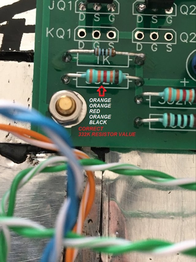

Also please check that the 332K resistor next to the 1K resistor is the correct value. Check both channels.

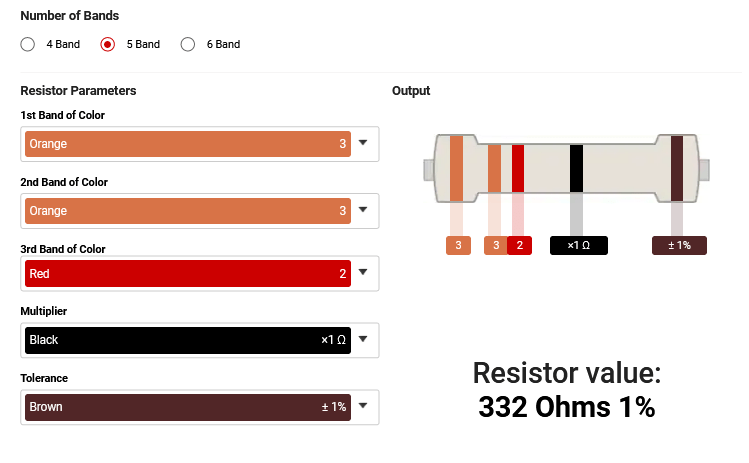

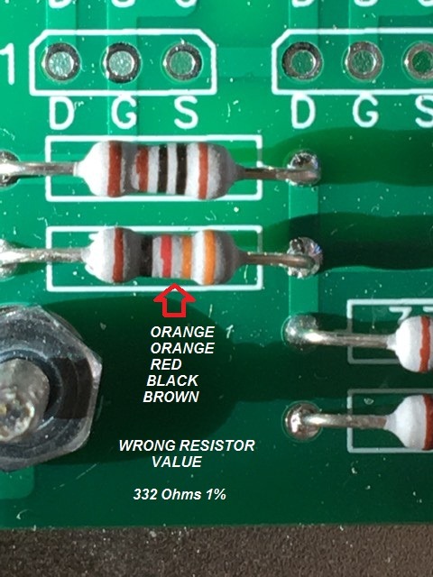

Ben, that was it.... :worship:
I have made an error in my purchase of parts from Digi-key and installed six NTE 332 ohm 1% resistors instead of the correct 332K 1% resistors.
See pics below.
Now I'm going to have to scramble and try to find some replacement resitors that can be delivered before Christmas as this second Korg preamp is a present for my brother. I just hope I didn't damage anything while testing and trying to fiqure out what was wrong.
Also I want to say a BIG thank you for your kindness, knowledge, and the patience for sticking with me in order to figure this bone head mistake of mine out.

Benjisan, it's good that you found the problem. I too hope that the very high current did not damage the Nutube.
The issue of the low voltage drop across R1 by T5 and T6 still needs to be addressed. Such low voltages indicate that practically no current is flowing through the JFETs at the front end. The voltage across R1 by T5 and T6 should also be about 1.25V. Since the JFETs and R1 resistors all came from the diyAudio as a package and the set at the output works, I suspect that the set at the input should also work, and that the problem is caused by something else. Perhaps you have another resistor value issue. Please check the value of the 4 - 332K resistors at the bottom of the board and also the R1 resistors, which should be 150R. Also check solder joints of the resistors and JFETs.
Hi Ben,
Thanks for the further follow up.
When I realized that I had made a mistake and misread and ordered the wrong resistors----> 332 Ohm, and not the 332 K resistors. I also verified that the others resistors (1k, 33.2k, 100 Ohm and 475 Ohm) were correct since I was going to be placing an order over at Digi-key for the 6 correct resistors.
Also I already de-soldered the six 332K resistors from the board earlier when you pointed out that I should check them to make sure they were of the correct value.
I could go over R1 resistors solder joints, JFETs and other resistors, but would I still be able to conclude any futher testing with the six 332K resistors not being populated in the board?
