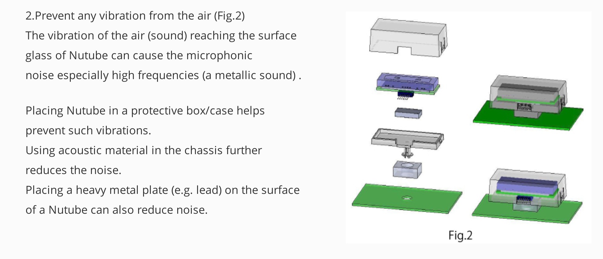

And with standart tubes, you have grading scale, some based on noise and microphonics, especially for tubes destined to low level amplification. Since it is unlikely that audiophile will buy low grade tube, there is a bias in the audiophile population concerning the performance of standart tube.

Korg show us in official documents all informations future Diyers need to knows
about correct technique to avoid microphonic problem.

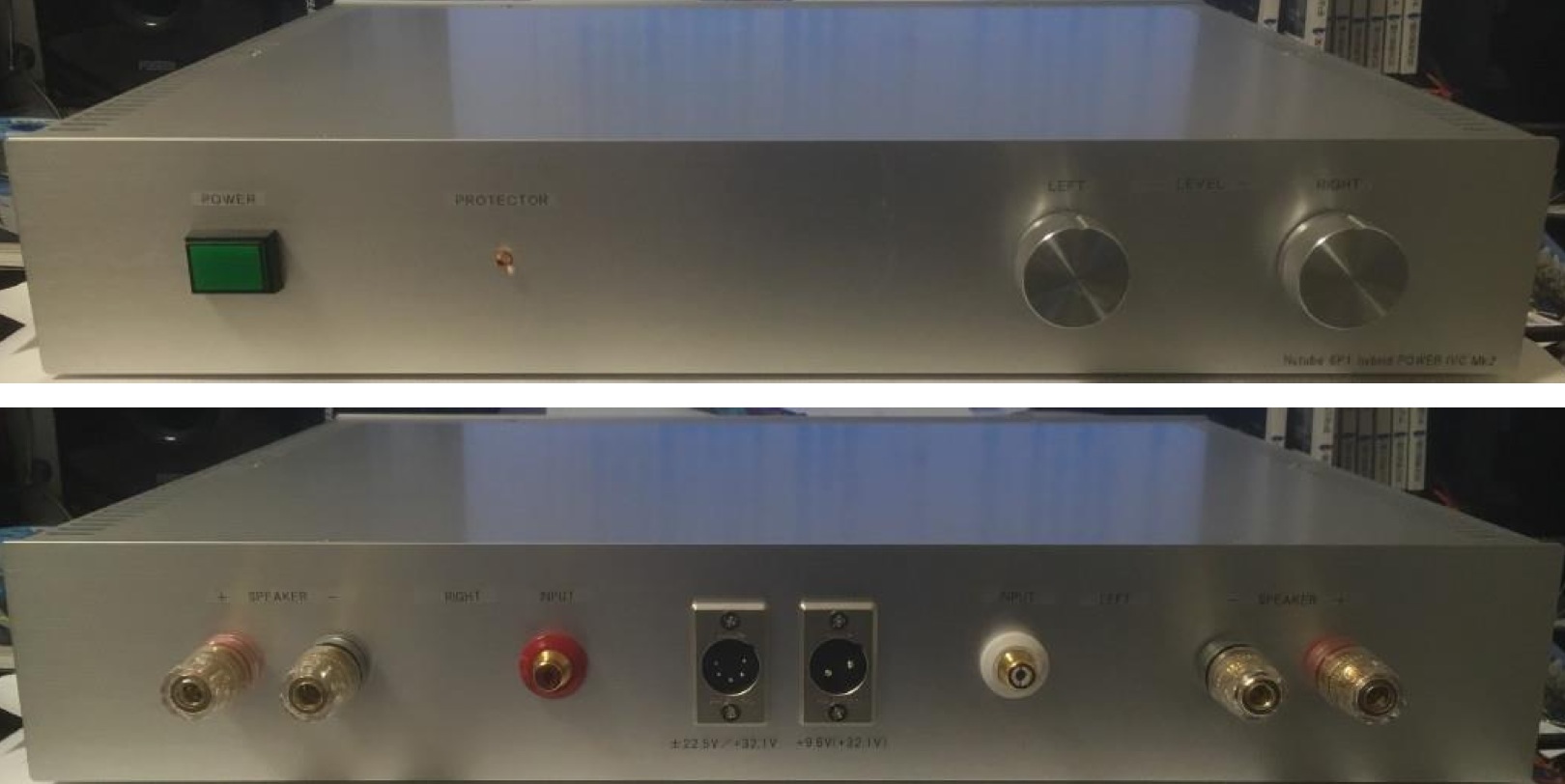

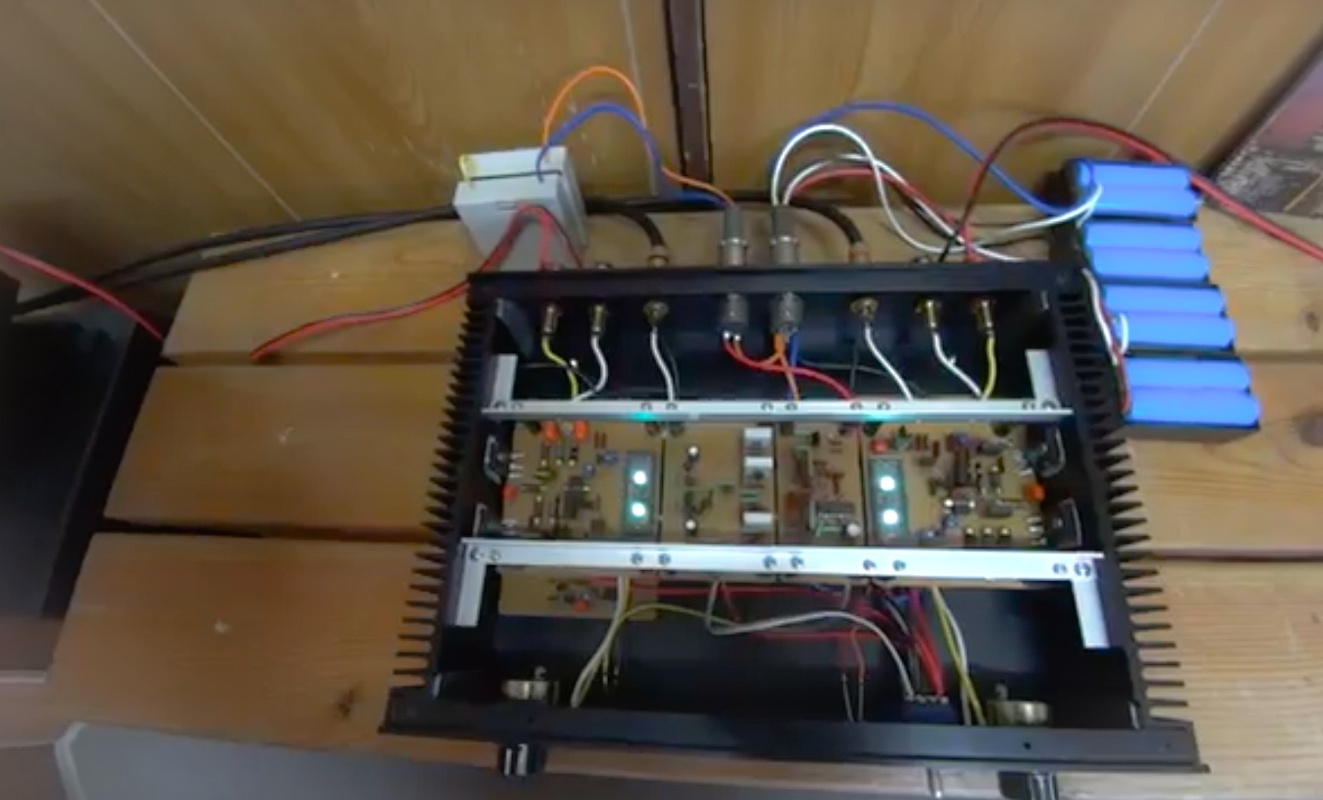

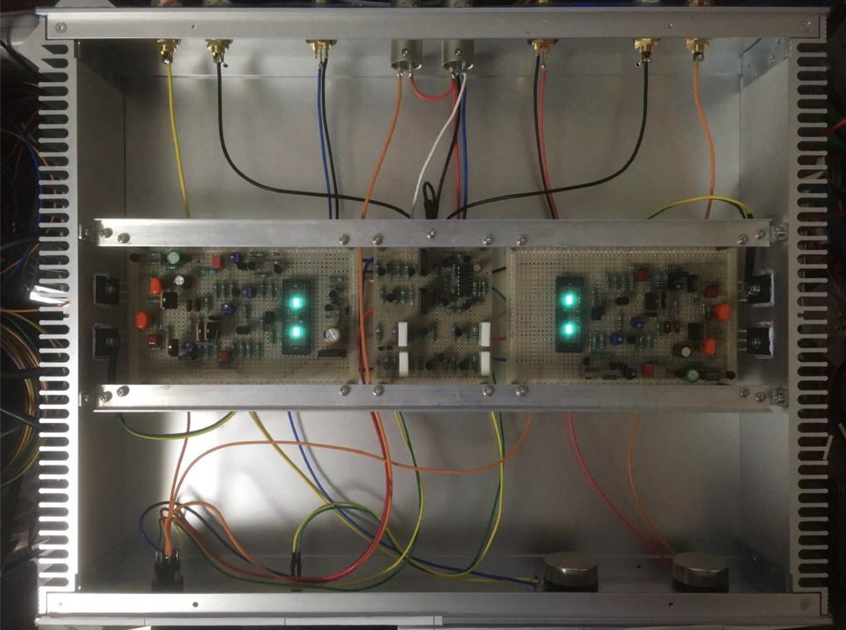

In Japan Akihiko Kaneta / Kaneda legendary DIY designer make dozen projects for hobby amateurs:
DAC's , preamps and hybrid Korg power amplifiers with SIC mosfets.
Kaneda DC amp No.262 NuTube Hybrid Batterydrive Power IVC2 - YouTube

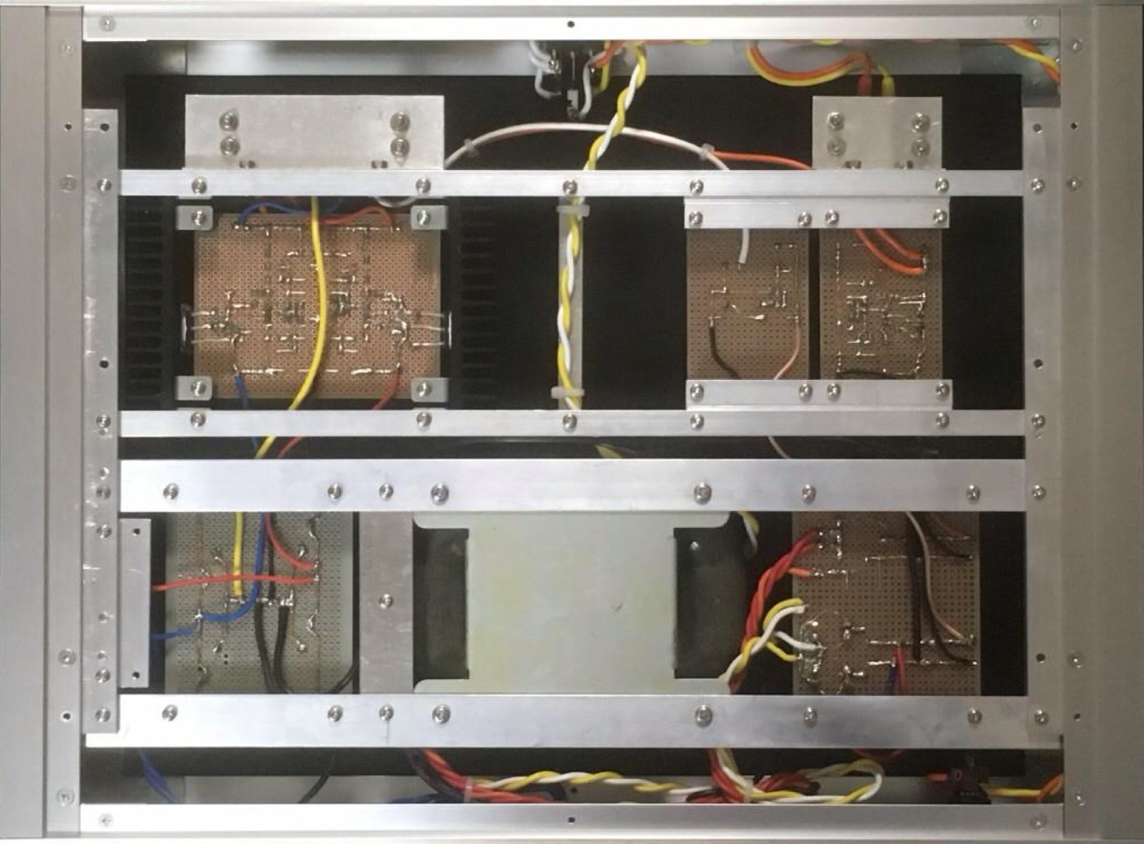

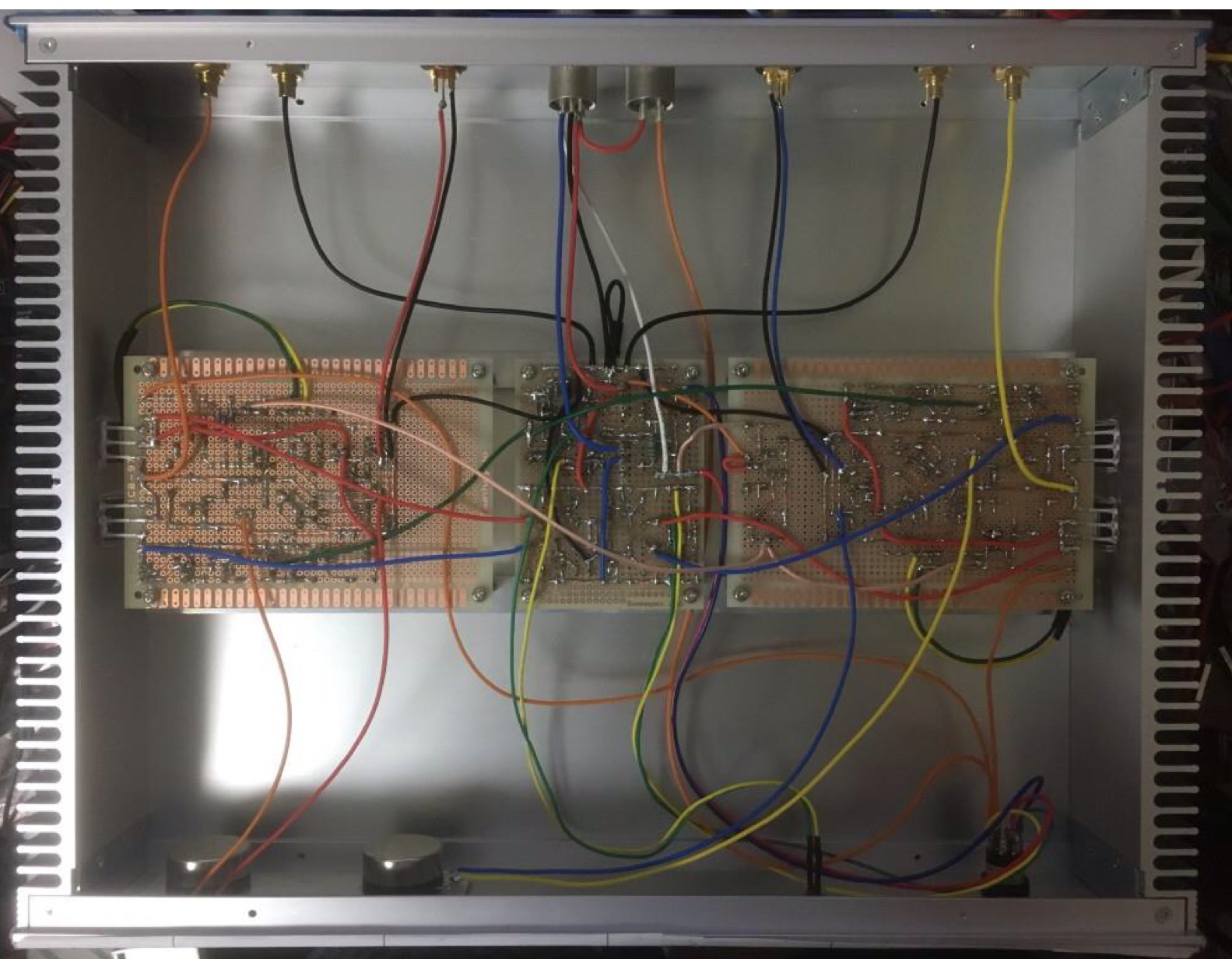

All Kaneta audio gear is always build point-to-point on the perfboards
Athletic training with soldering iron
😀 Papa style DIY is super easy !

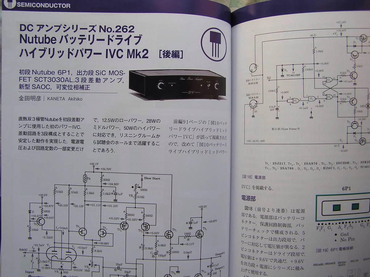

You can find pdf. documentations on this blog: レポート | 趣味の自作半導体アンプ
Nutube Current Power IVC MK2 http://myaudio.sakura.ne.jp/report/6P1_Current_Power_IVC_MK2_電圧伝送対応.pdf
Nutube Current Power IVC http://myaudio.sakura.ne.jp/report/6P1_Current_Power_IVC_電圧伝送対応.pdf
Power Supply Box2 http://myaudio.sakura.ne.jp/report/ACPowerSupplyBOX2.pdf
Korg Triode USB DAC http://myaudio.sakura.ne.jp/report/I2S接続USB DAC作成レポート.pdf
Kaneta San gear is always in the same one or two black chassis: amp etc. + separated psu ( or batterys )
First 3 photos..the silver color is a build by the hobby blog writer
Holy soldering smoke! Builds only for peacefuĺ minds..
