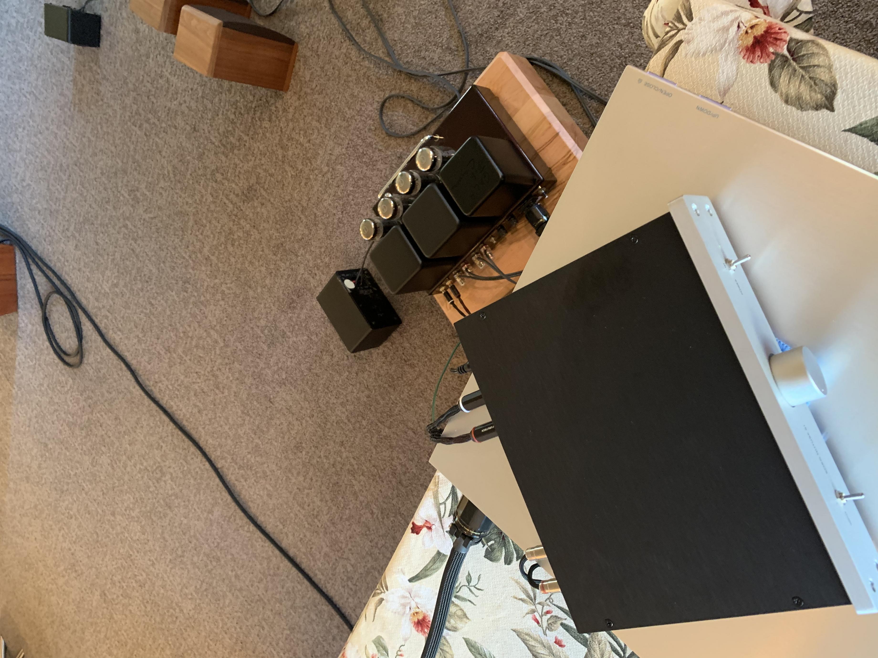

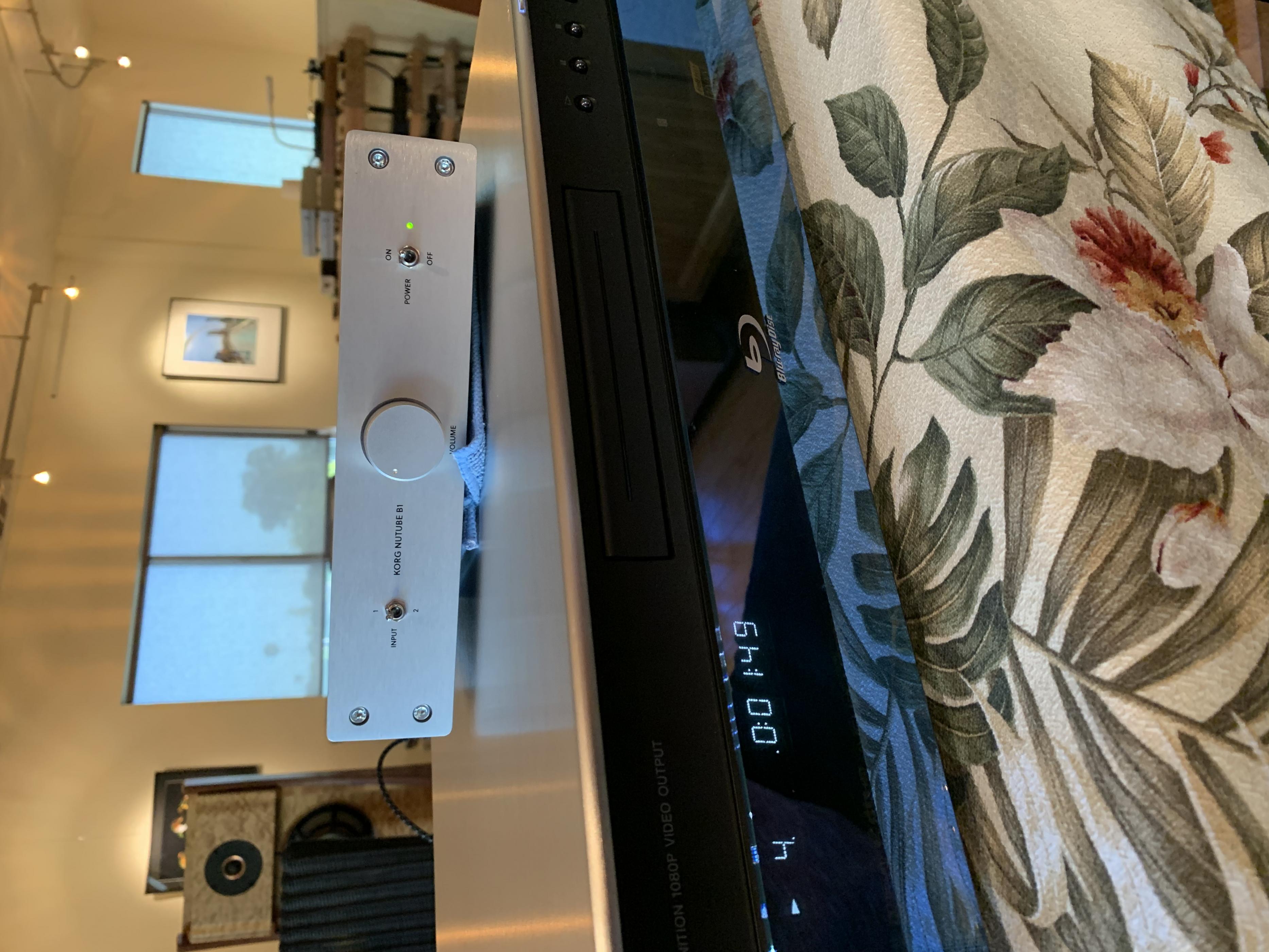

Another Korg Nutube B1 is alive
My friend goaded me into a race to build our Korg B1’s.
He has not started and I completed it last night.
Just hooked it up to test an old pair of speakers. Sony CD to Korg to Carver Crimson 275 to Realistic Minimus 7.
Speakers on the floor and there is a soundstage!
Thanks 🙏🏽
