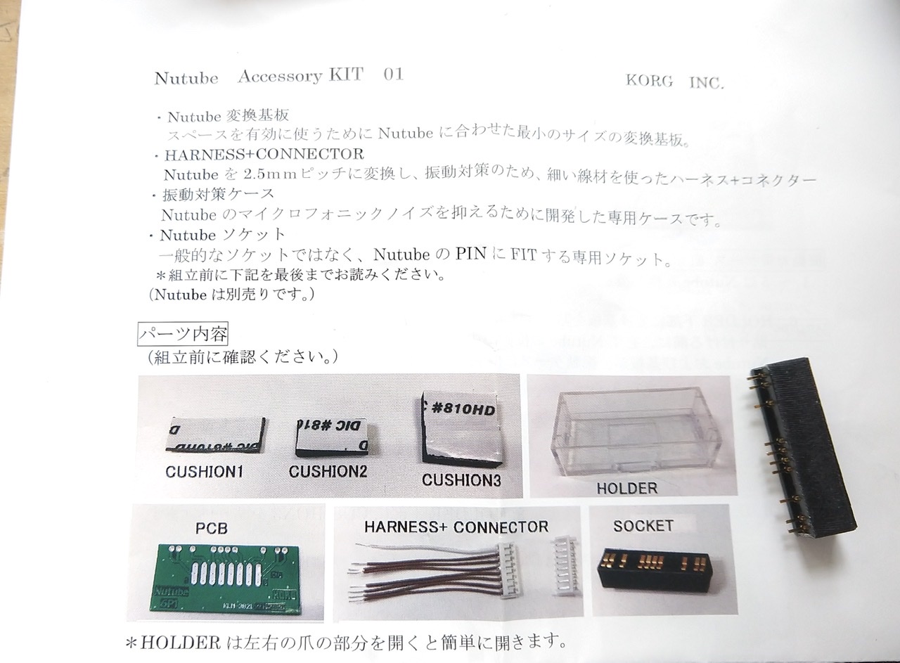

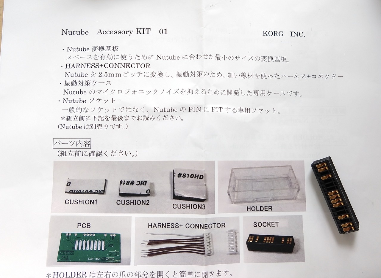

Yes you can actually buy these mounting kits but i had to order them from England. You get everything pictured (except that little raised mounting stem shown in the bottom picture) . I'll have to look up the ordering info and send it along
Cheers, Pete
This addresses all concerns for me too. Thanks Jason for your attention and follow-up on these concerns.
BUT, it appears Korg mounts their units with a ribbon cable to allow suspension. Are those cables available?
RS Components Ltd
Kit # 1812027
AccessoryKit of Korg NUTUBE
Pete
I am using the "carrier PCB" listed here and used rubber isolator stand-offs. I hard-wired it to the main board, but used the technique described earlier in this thread about coiling the fly wires a few times to absorb any vibrations and that seems to work well. I have a Korg Nutube overdrive pedal kit I built that uses the carrier PCB and their ribbon cable set. The board has two pieces of typical window insulation grey foam taped to the top/bottom and incredibly in a stomp box on the floor in front of a guitar amplifier I get no microphonic issues there either.

Chanthing: just to make you aware of a socket for the Nutube. It’s made by Korg as part of a kit you can buy. You’ll have to use a thicker piece of foam to support the Nutube onto the PCB but makes changing a snap. True, it’s a bit ridge of a structure and may lead to vibration transmission but the socket will accomplish what you seek and the male pinning fits the B1K exactly.
I posted the info on the kit recently in this forum so I won’t do it again.
Cheer, Pete
Cheer, Pete
Wow. Cool. Thanks for the pointer. When I went looking, I only found things that looked like breakout boards where the NuTube still had to be soldered in.
