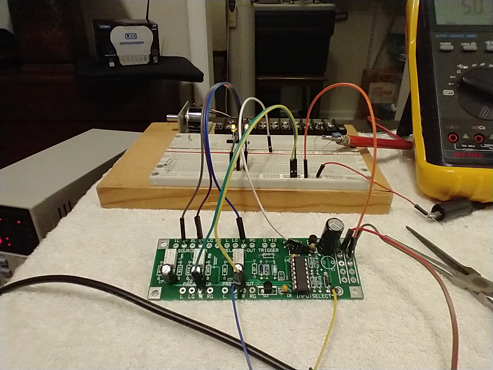

Got my Korg control board up and running on the bench using LEDs to show relay position. These are latching relays so current flows for a very brief time, and only while the relay is switching. No magnetic fields around the signal path.
1. At power on all relays are tested (about 50ms each) and reset to OFF.
2. Input select switch is tested for Input 1 or Input 2 position and appropriate Input relay is turned ON.
3. At about 3 seconds -- after the turn-on thumps are over -- the Output relay connects the Korg to the power amp.
During operation:
When the Input is switched, the Output relay is momentarily disconnected while the Input relays are in transit and then turned back on. Total time is maybe 500ms, and there should be no switching noise. I'm going to remove the resistors from the input sockets that were previously recommended to reduce input switching noise.
When 24V power is intentionally removed or accidentally lost, the Output relay and both Input relays are instantly disconnected, disconnecting the Korg from all sources and the power amplifier.
I haven't tested the trigger circuit yet, I need to reconsider the current limiting resistor value.
