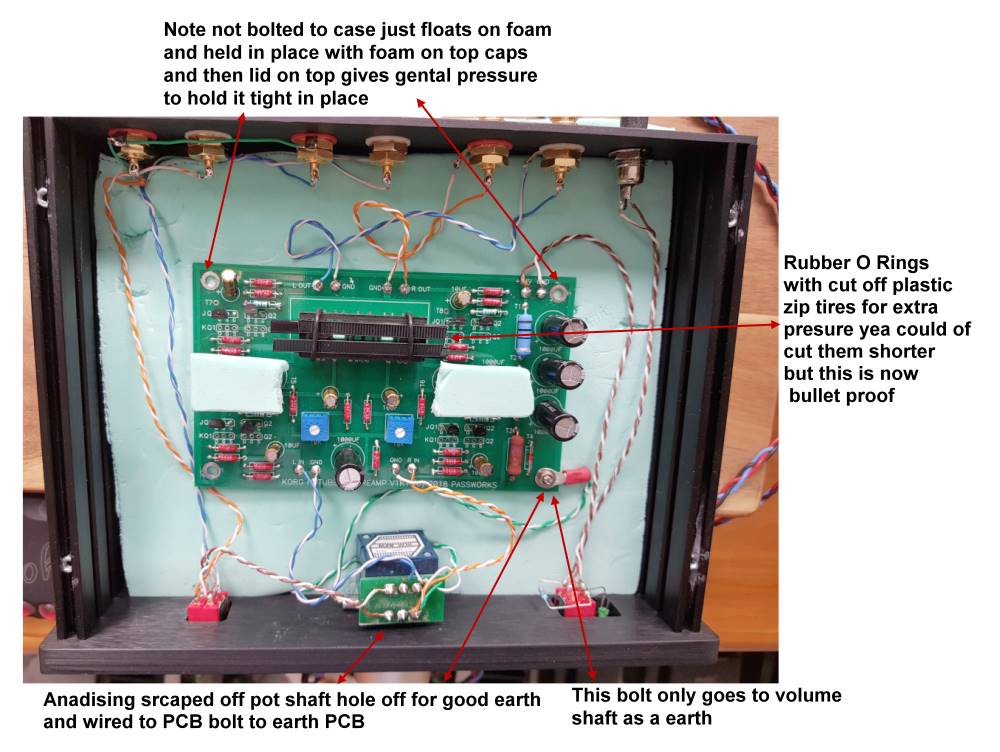

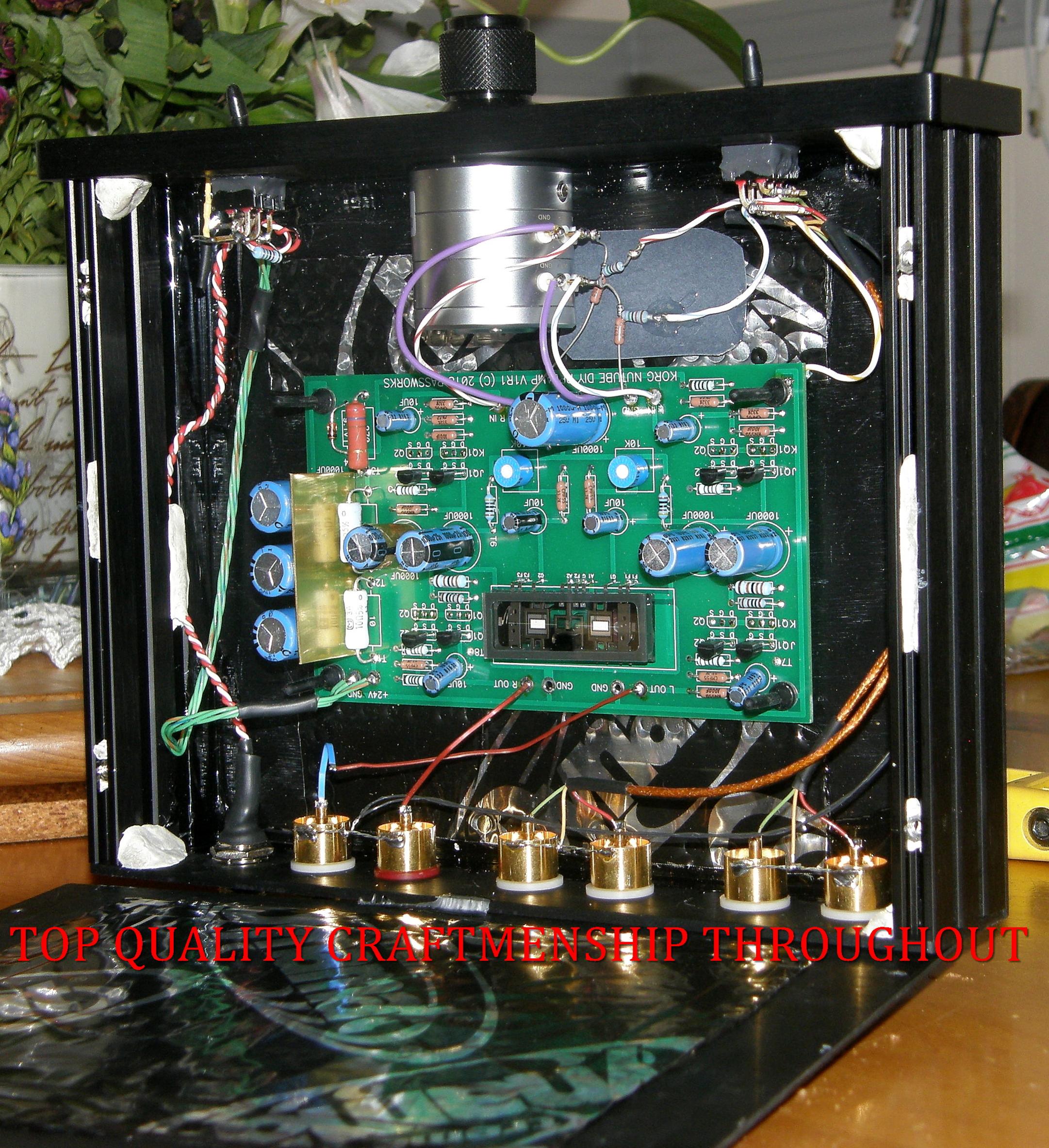

NuTube ringing is typically from loudspeaker sound vibrating the tube, sometimes airborne, sometimes surface vibrations through the chassis. Playing loud music while the preamp sits somewhere close by a loudspeaker can be a problem. If the power amp input is low gain and the B1K cranked up to compensate, that would tend to make things worse. Just sitting there it probably won't ring but I did have one channel of a NuClassD amp spontaneously ring with no source playing. That one tube was my only real problem out of 5 tubes although my B1K tube "dinks" when tapped on or the power toggel switch is snapped. You can "dink" the left side for a left channel noise or the right side of the tube for a right channel noise but it's fine in normal use.
So, you probably are not duplicating the physical conditions of your customer. This forum has many posts addressing ringing and its potential solutions. I believe 6L6 uses a Prismacolor Magic Rub eraser taped to the top. Do a search.
Thanks for your input. Yes, after building P. Millett's 50w class D amp with the SP1, I also had a ringing issue. Then it just disappeared. The amp sounded way better than I thought it would.
I agree with the location/damping of the B1. I have done everything that I can think of to reduce the microphonic issue, and as stated, it does not present a problem when set up in my shop system, nor did it in my home system.

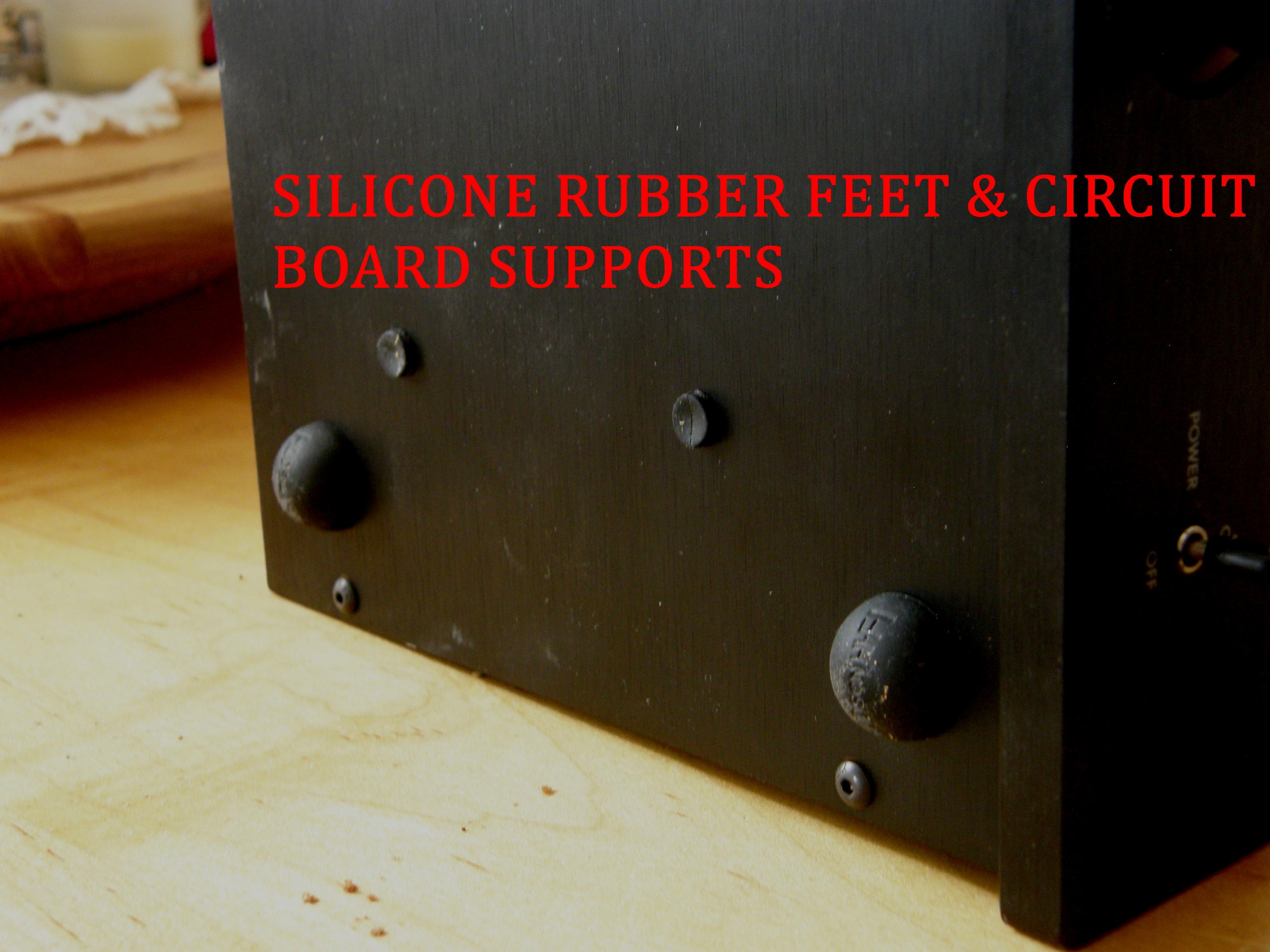

I put the fuzzy side of a piece of Velcro under the Nutube with the fuzz toward the bottom of the tube and slightly compressed. It seems to cushion very well. I've never had a problem with ringing and the wife loves to "crank it up" at times when she is in her office next to the listening room. I'm actually surprised it doesn't ring since after such a session she sometimes has to straighten the pictures on her office wall.

Here is the 'what if' I am dealing with. This tube rings/oscillates even when there is no input! And as far as damping, I have already gone to the extreme to deal with it. The ringing stops for a time, so then I play music and it returns. I will simply replace the tube and hope that the warrantee is any good.
My B1K rarely rings, except briefly when flipping the input switch. However yesterday I added a CD player to my system and the B1K rang in a weird way when the B1K was on top of the CD player. I moved the B1K down to near my ACA and the ringing went away. I suspect EMF might influence ringing.
While EMF may affect ringing, in ranshadow's particular case it MAY be vibration for the CD player generated as a result of the CD spinning. It may be difficult to demonstrate, however, as any shielding inserted between the CD player and the B1K may also act to dampen vibrations.
I was getting a high pitched whine out of my B1K every once in a while when it was sitting on top of my metal cased (unused) preamp. My B1K unit has soft rubber feet and the white magic rub eraser on top of the Nutube. I cut a piece of small bubble bubble-wrap and put it under the unit & haven’t had the whine since. It could be vibrations from the CD spinning, yes, or maybe vibrations (on a metal casing) from music being played cab cause ringing?
BTW, I even have the magnet mounted behind the Nutube replicating the report by the Japanese builder. Ringing can still occur (banging on the B1K case) but it sounds more like a quick metal "TING" than an extended ring. The whine I mentioned earlier lasted a long time and only disappeared after I turned the B1K off and on.
