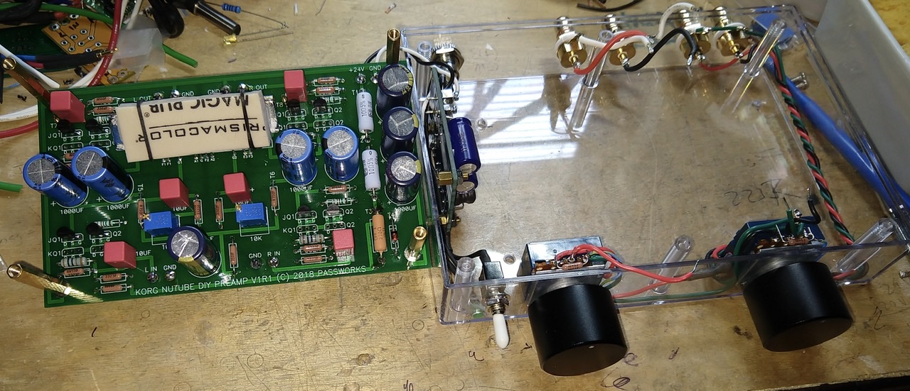

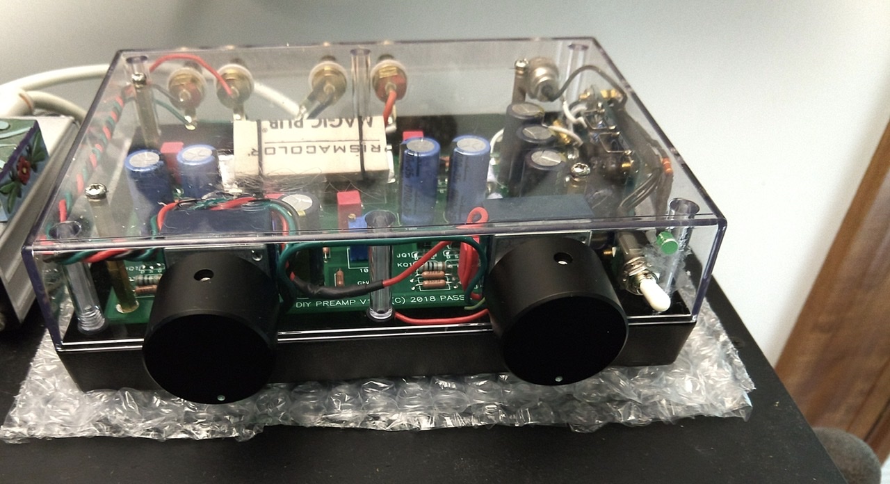

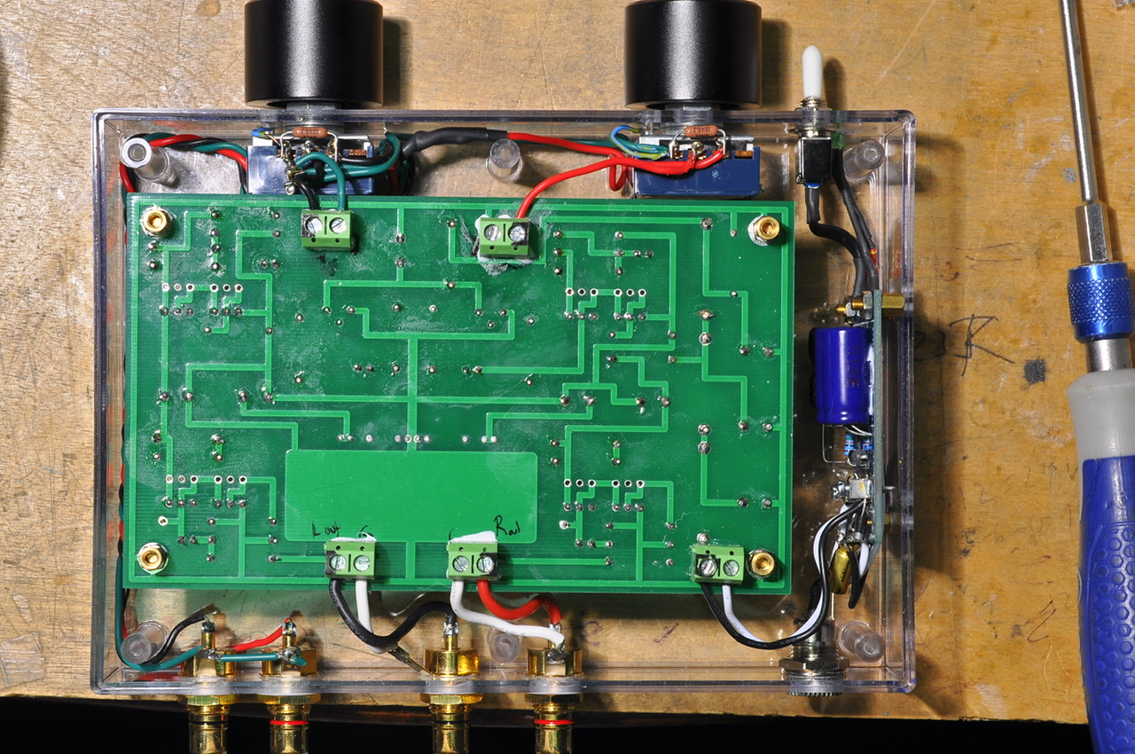

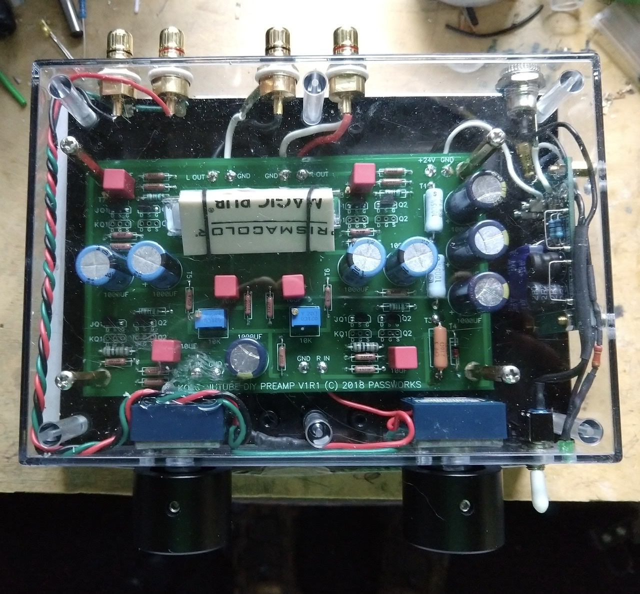

My B1K build…a little late to this party

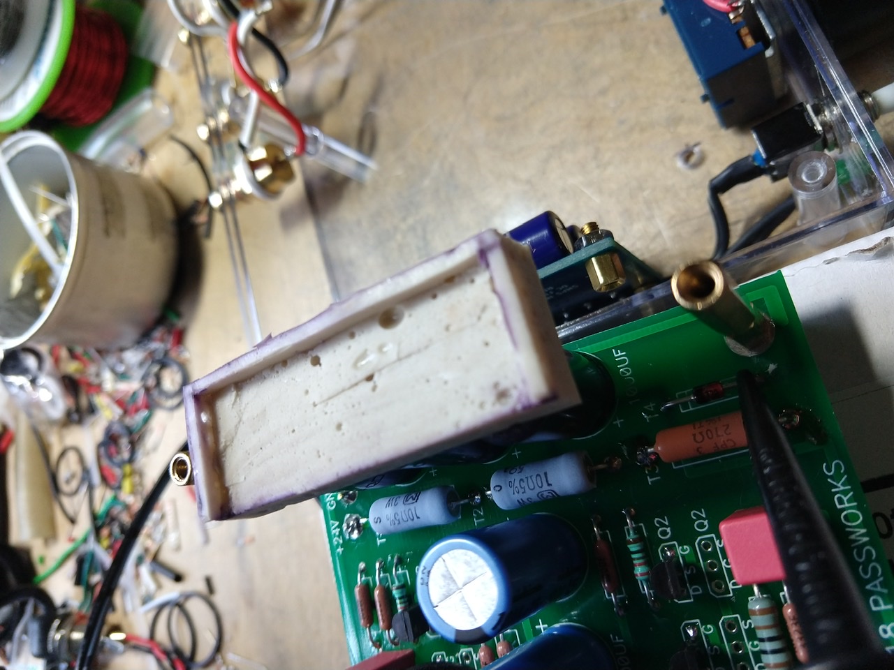

I built the B1 buffer first and it sounds solid but I became intrigued by everyone gushing over this Korg version. I didn’t intend to get really fancy with the build due to the numerous complaints of ringing and all the sound isolation/insulation that (might) be required. More probably because I could a real tube sounding preamp w/o spending big bucks.
I stole the idea of using a plastic Serpac case from bk856er in Pete Millett’s Korg Nutube forum (post #154) to see if I could build it just as compactly as he did. I intended to use the recommended wallwart so I decided to use Mark Johnson’s PO892ZB inline DC filter. I also made the initial decision to use dual mono pots (ALPS; 100K) so I could balance the L-to-R imaging better (and they were smaller too). I’m not a great believer (ok, snobby) in using electrolytics in signal path but I tried using Silmic II 10uF but didn’t like the sound so I switched to 4.7uF WIMAs. They may not be the optimum film cap to use but I had them and I was being cheap, remember? I decided to use Panasonic FCs in the PS section (low ESR & I’ve used them in similar situations in other builds). Nichicon KAs for the other four 1000uF caps. I mounted little posts into T7&8 so I could use clip on leads when adjusting voltages. I also externalized an LED since everyone was using those white erasers to contain ringing (who was I to argue) and then you couldn’t see if the unit was powered on. Finally, as a final build concept, I wanted to use the Japanese fellow’s magnet implementation to see if it both reduced the time of ringings and if it did (positively) change the sound as he claimed. The Alps pots were grounded to the signal input ground plane. Overall, I really didn’t think this was going to work so I didn’t protect the (easily scratched) plastic as well as I should have as well as having extra holes from moving things around. The initial signal 1K resistors are Takman right now and that’s the only resistor position I’ll potentially change to try and adjust the sound. All others are Dales. High tech bubble wrap under the unit for vibration isolation. Oh yeah, and the PCB is attached at the top of the case, not the bottom with screw terminals attaching everything on the underside of the board.
Holy Cow! The sound out of this unit is hypnotic. Is it accurate & present the music accurately? I can’t answer that but it really gives depth and silkiness to the music. I listen to mostly classical & jazz with Motown & R&R thrown in. It even makes all those terribly sound-engineered early cross-over R&R CDs tolerable. Metallic sounding "TINGS” are still heard if you tap on the case but are very short lived; other than those no ringing is heard.

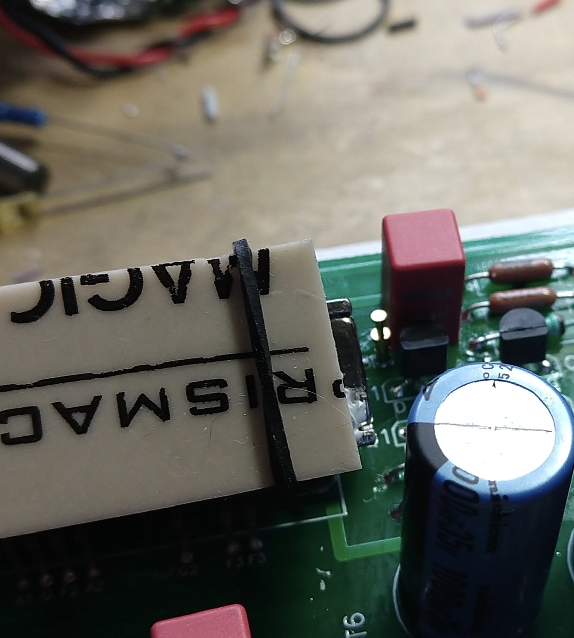

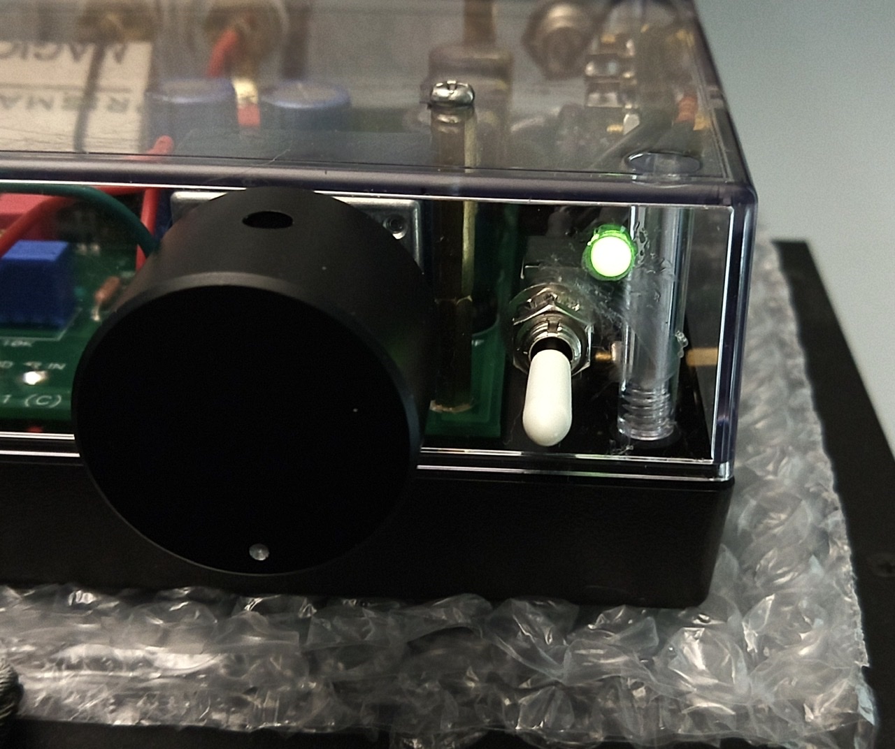

Do a process of elimination…take the TT & phono preamp out of the equation. Drive a signal using another controllable input source. Still rings? Try my bubble wrap thing under your B1K unit. Do you have the eraser on top of the tube?

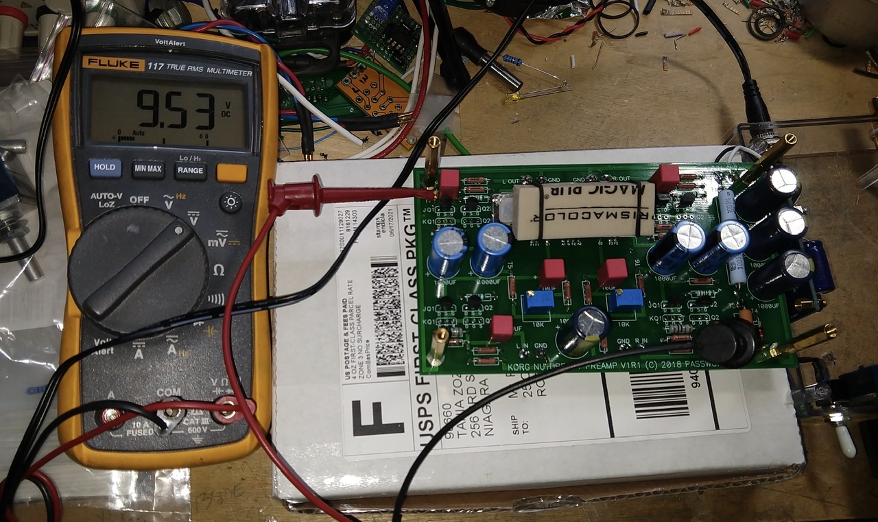

The elimination process so far has come to the point that this tube/circuit is the culprit. As mentioned before, it rings all by itself with no signal applied to it.
Regardless of what seems obvious, I will try your advice connect a CD Player to it. Before I even turn on the CD Player, I will wait to see if it continues to ring. If not, then I will turn on the CD player and play music at a low level. The lid will also be in place when I do this. I am betting that it will ring as before. If so, then the tube will be replaced. Question, can a tube self oscillate?

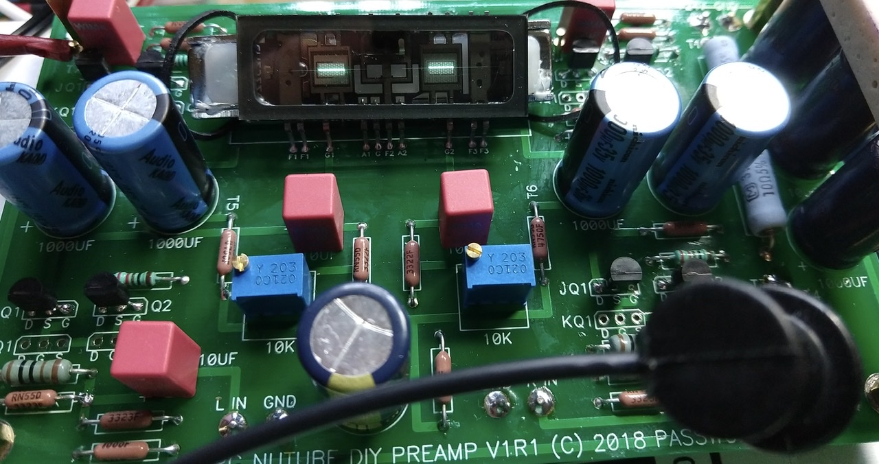

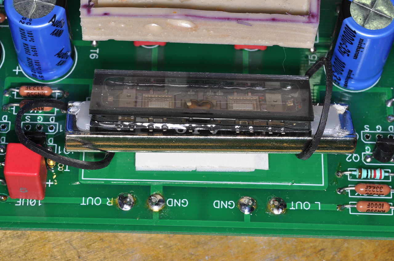

It really is amazing how finicky this tube/assembly is. Is your Nutube attached to the PCB with anything? As a test, try removing the Nutube from that foam/gel support, slightly bending the Nutube upwards so only it’s attachment pins support it (kinda free-floating). You just might have to buy another tube to eliminate a bad tube as the first factor.
Pete
Yes, in fact the tube is attached to the board. I will do as you suggest and see what happens. Thanks for reading my post and understanding about the conditions that apply or do not apply.
