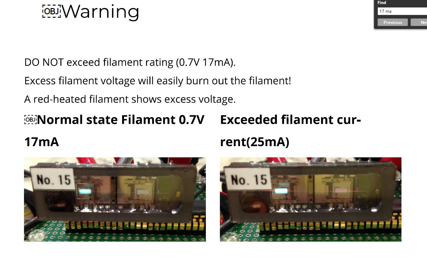

If you read my first post, I did not ask about opinions on any of that. I asked for test procedures. I received one which was poorly given at that since the circuit needs a filament to pull it down to the proper voltage. Supply V is about 9.1-9.5V from the zener source.
It’s two tubes being fed from a common supply. One channel is still doing perfectly fine and reads perfect voltage across the filament whereas the other has gone open.
Now, can someone provide test procedures for this?
Also, the recipient is a friend snd I don’t charge to assemble PCB kits to my friends.
In the Korg Application Note (extract attached) it says "DO NOT exceed filament rating (0.7V 17mA)."
If your zener is putting out 9.5V as you said earlier, the steady state current through the cathode will be 18.41mA, surging perhaps to 19mA at startup (cold cathode).
I have no idea how critical the 17ma is, but the DO NOT is in all capital letters so I think the Korg board is designed assuming an honest 17mA maximum but due to zener tolerances on the B1K it can run higher. How much difference your 9.5V made, I have no idea, but it does seem to deliver more current than specified by Korg.
I was headed toward adding a constant current modification to my board until I realized that a) the cold cathode surge was pretty minimal and b) my own measured zener voltage is well below 9.0V so I am operating somewhere below 17mA in my preamp.
