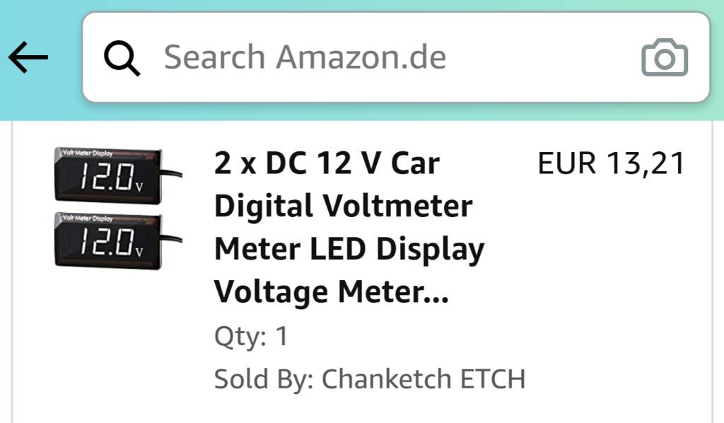

Sometimes these meters cannot use the same power supply that they are measuring. You may need to supply voltage from another source. You can get by powering the meters with a temporary lash-up battery source (too bad Radio Shack is out of business; you could have gone down and purchased a couple of battery holders).

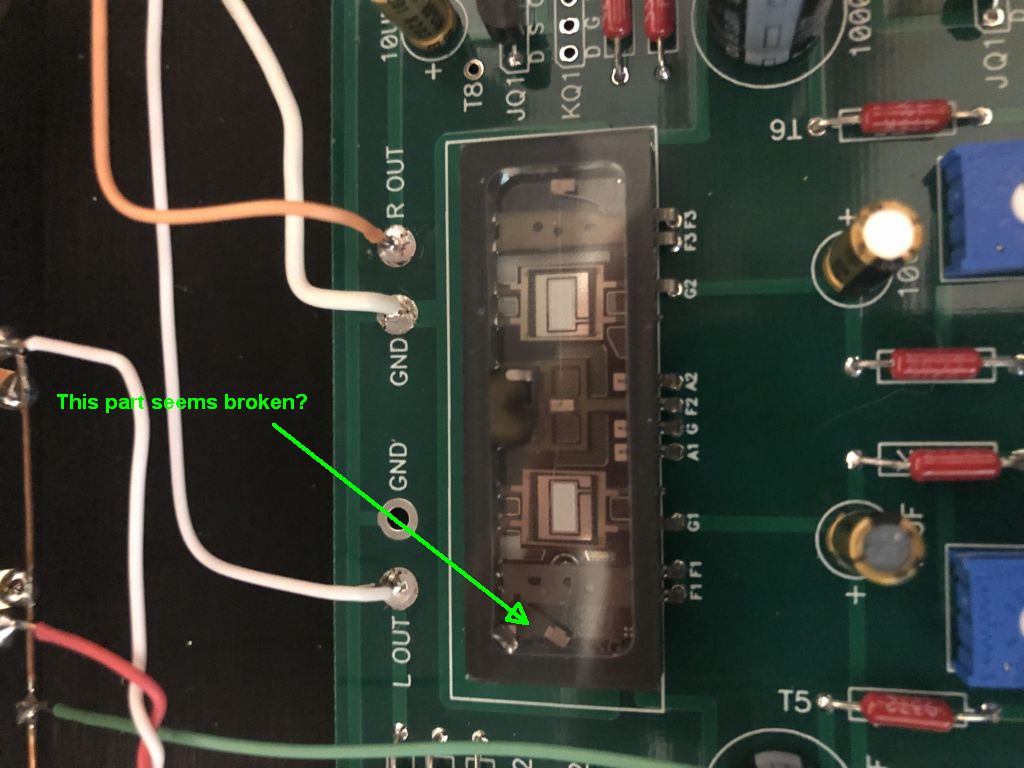

I recently built one of these kits for a friend. DIYAUDIO store was less than helpful and borderline rude about their responses. They referred me here. I believe I have a bad tube. I assembled the kit per the instructions and biased the test points to 10V for 48 hours to ensure they did not drift. All seemed well and it sounded great. I passed it off to the gentleman for whom I built the kit for snd about a week later, one channel went out. The tube is unlit.
Can someone provide the suggested test procedures for the kit to determine that it is the Nutube that is at fault? DIYAUDIO store won’t replace it unless I get a post here stating that the tube is bad.

Check the filament voltage between T5 and ground and between T6 and ground using a voltmeter that can accurately resolve voltages below 1V. It should be around 0.6V for each reading. Anything higher than 0.8V will exceed the manufacturer's maximum voltage specification. If those voltages are correct, and you have an open filament, then the tube underwent an early failure and was defective in manufacture.
