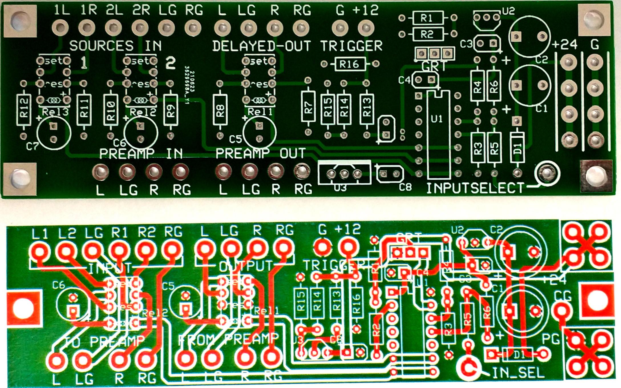

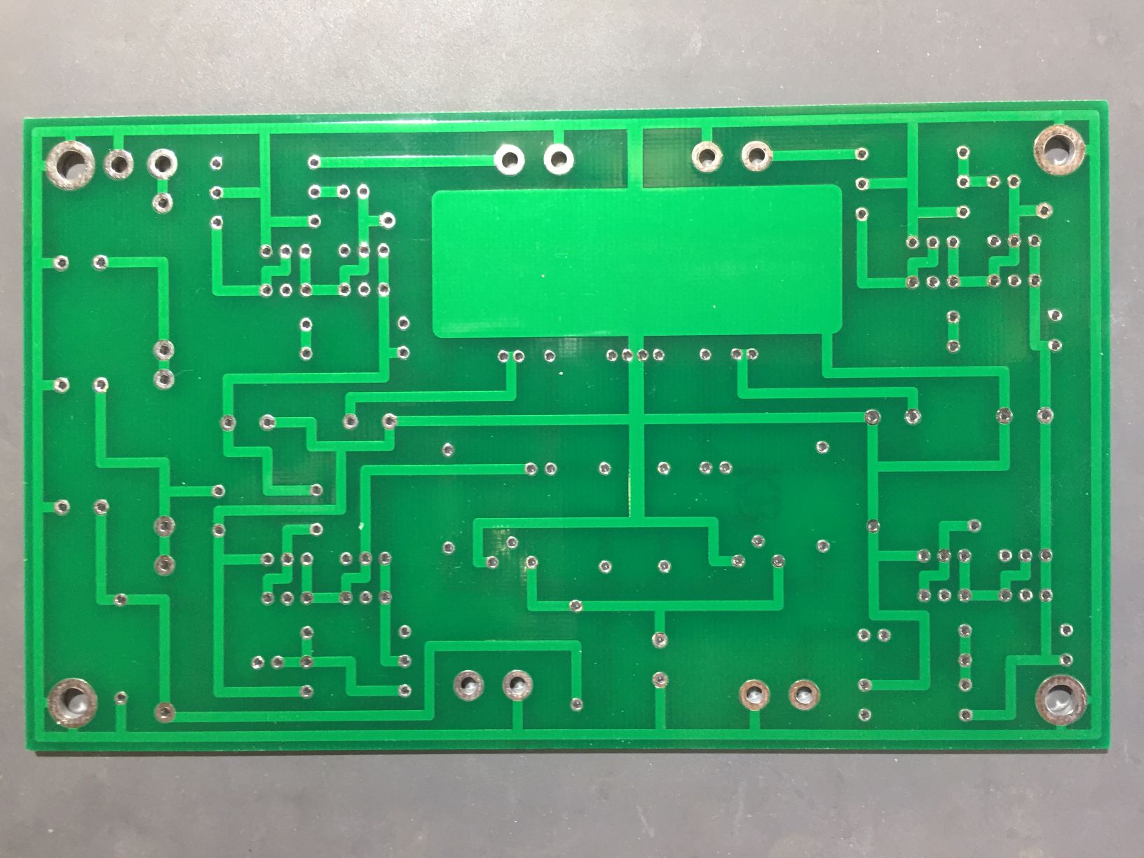

I would like to look at the possibility of powering the two Korg cathodes from a single 17mA constant current source and that means cutting and rerouting some traces. I can't find an image or a gerber of the diyaudiostore-provided pcb which I need in order to assign component numbers and follow trace connections. Does an image of the traces or a gerber exist anywhere?

See attached
It took 10 days for the pcb order to get here from China and, of course, in those ten days I redid a lot of the board and rendered the received board not exactly obsolete because it should work fine, but maybe OBE because my new board is ¼ inch narrower which doesn’t sound like much until you realize the first board was only 1 ½ inches to start with and it needs to fit behind the Korg pcb in the diyaudiostore chassis. See image -- top is actual pcb, bottom is redesigned to be smaller and simpler.
I realized some things after ordering the first board:
1. When going from a 4-input board to a 2-input board I could reduce the input relays not to two, but to only one if I didn’t bother to terminate the unused input to ground through a resistor which is unnecessary because
2. I don’t have to worry about input switching noises because I can momentarily mute the output while the input switching occurs which means the termination resistors are not required. The relays switch in 3ms, it’ll be totally unnoticeable.
3. I found a trigger supply circuit which I hope will work, reduced the regulators from two to one by combining the current limiting and voltage regulation to a single LM317 – it’s a constant current battery charger configuration which I believe will do what I need it to do here. If excess current is drawn, the voltage drops to keep power at a constant value.
4. I added a chassis-ground pad to the ground aggregator area.
So, I’ll assemble the pcb I have on hand and verify it and if it all works as expected I’ll combine it with a constant-current circuit to the Korg cathodes (thank you, avdesignguru) and that should solve all noise issues both switching and power, provide a better signal path, and make it reasonable to switch the Korg on and off frequently while also extending the life of the Korg tube by eliminating the turn-on surge of excess current through a cold Korg.
