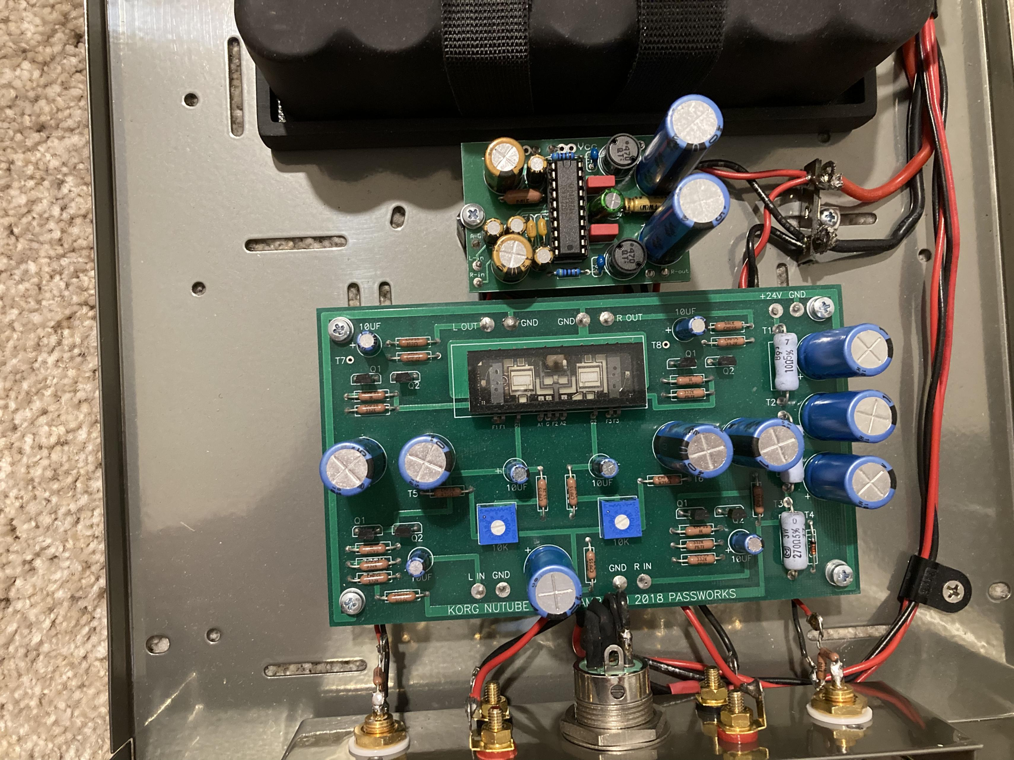

B1 with Korg Triode
Anybody know what this problem is and how to fix it? I run a battery powered hybrid power amp with the B1K as preamp and a Bottlehead Quicksand as the amp. I designed it to work with a DAP and it usually functions perfectly. A couple times I forgot to unplug the charger from the DAP. This results in the craziest digital distortion/feedback/weirdness that I have ever heard; sometimes sounds like R2D2 getting tortured. Same thing happens if I connect a different source that is powered via mains.
Both boards +/- are combined at a terminal strip and then goes to the battery. There is no case ground. I am guessing there is some insane ground issue occurring only when a source is connected to mains.

Thanks, but this is not the problem. Everything works fine when connected to a DAP that is not charging, despite it being a vented chassis. I don't think the B1K or the Quicksand is the issue. I suspect it is my overall topology and the grounding, or lack thereof.

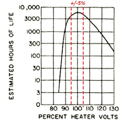

I no longer remember where I found this graph and others who have been doing tube stuff far longer than I have say they remember this kicking around for a very long time.
Nevertheless, here it is - a graph of tube life vs filament voltage levels. The plus/minus 5% dotted lines are my addition. Take it for what it's worth...

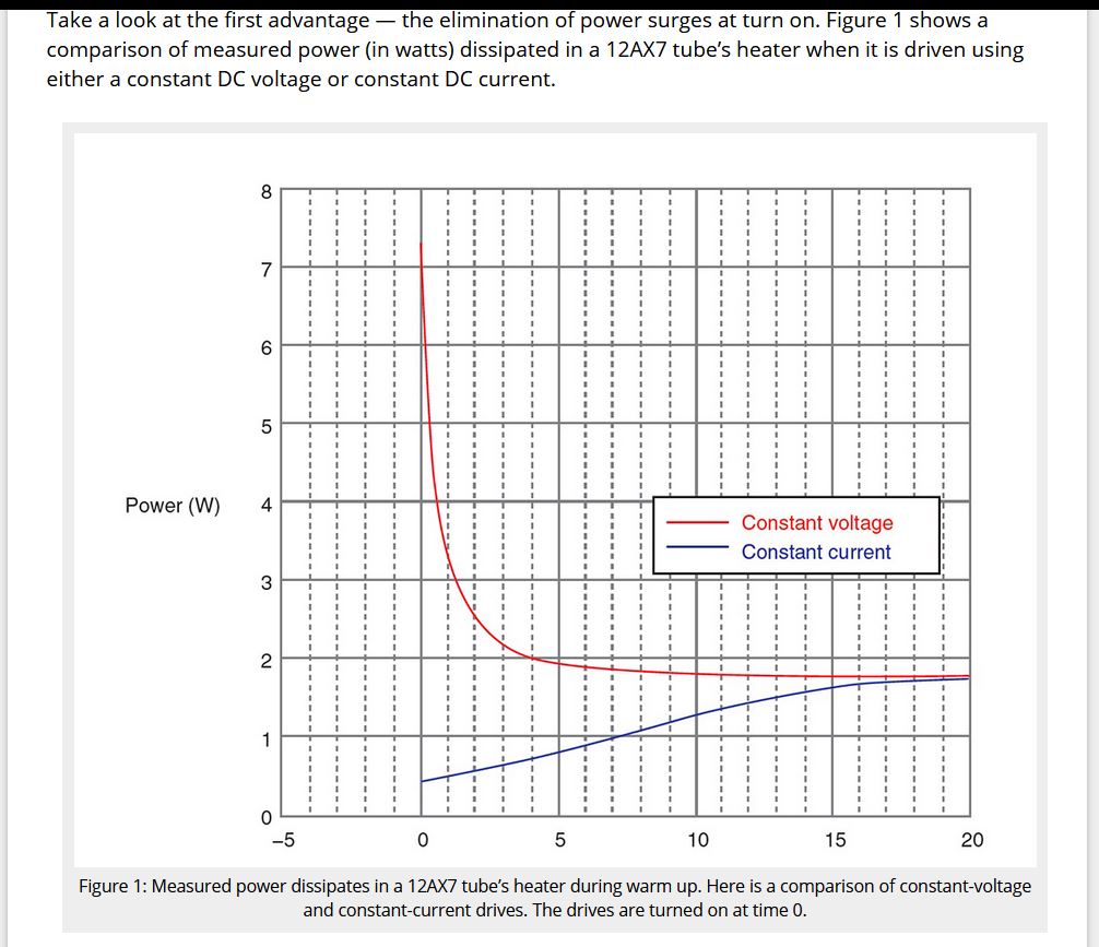

Here is a really informative discussion of constant current sourcing of heater versus constant voltage. The inrush current of constant voltage through a low-resistance cold heater is far greater than the steady state current after the heater has reached operating temperature and that, I suppose, is why you should not switch tubes on and off excessively.
Constant Current for Tube Heaters. Extend the Life of Your Amplifier’s Vacuum Tubes | audioXpress
Which suggests to me that an LM317 plus one resistor to replace the 475 ohm resistor to change the circuit to precision 17ma constant-current would prolong the tube by avoiding the inrush current associated with turning the tube on. Surely that would help with longevity?
Here is a graph depicting the difference in turn-on behavior of a tube heater -- constant current vs constant voltage. The B1K is a constant voltage.
The recommendation to keep a tube heater at half-power when the equipment is OFF rather than turning it completely off must be due to the fact that the surge will be much less if the heater is already partially warmed up when the turn-on surge arrives.

Curious - given the graph above, I don't think I'd want to keep any heater at 50% power. My interactions with Jac at EML seems to fit the graph pretty well - he indicated that his 300B tubes will tolerate a pinch (maybe 3-4%) of over-voltage far better than a pinch of under-voltage. He claims to be able to identify an under-voltage filament through visual inspection of the damaged filament.

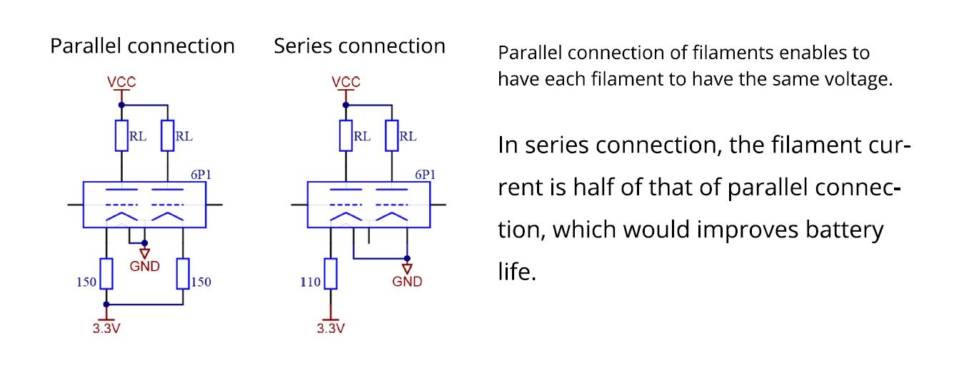

The B1K schematic shows that the two Korg cathodes are wired in parallel with separate current-limiting resistors and smoothing capacitors. Is there any operational (audible) reason that they cannot or should not be wired in series with a single 17mA constant-current source? I think the Korg Application Note schematic has an error -- the "series" connection doesn't look right.
