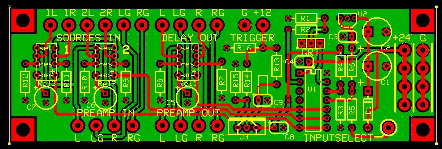

Ha. Shoulda seen that from the schematic, but I don't speak "tube" very well. What about reducing or removing power from the cathode? Would that shut down the tube so that it doesn't age while not in use? And what kind of thump would result when power was restored to the cathode?
Sorry to beat this horse, maybe it's dead and I should give it up. I have a pcb on order that includes delayed connect and instantaneous disconnect at power on/off so I'm not worried about the power thump but I would love to baby the tube for maximum life and I could easily modify my board to handle practically any power sequence.

As it happens, I've already done most of the work -- an addon pcb that handles everything you mention except for partial-power to the pcb which could be partial power just to the Korg and leaving the FETs full powered. It's fully automatic but I could add a switch control with three way off-standby-on positions using an on-off-on switch. the muting relay would operate on it's automatic delay sequence based on the switch position.
I have two spare pins on the programmable chip I'm using which could control a high-side FET to deal with power to the Korg cathode or cathode and anode.
My first design (pictured) is enroute from China now, should be here in a week or two.
