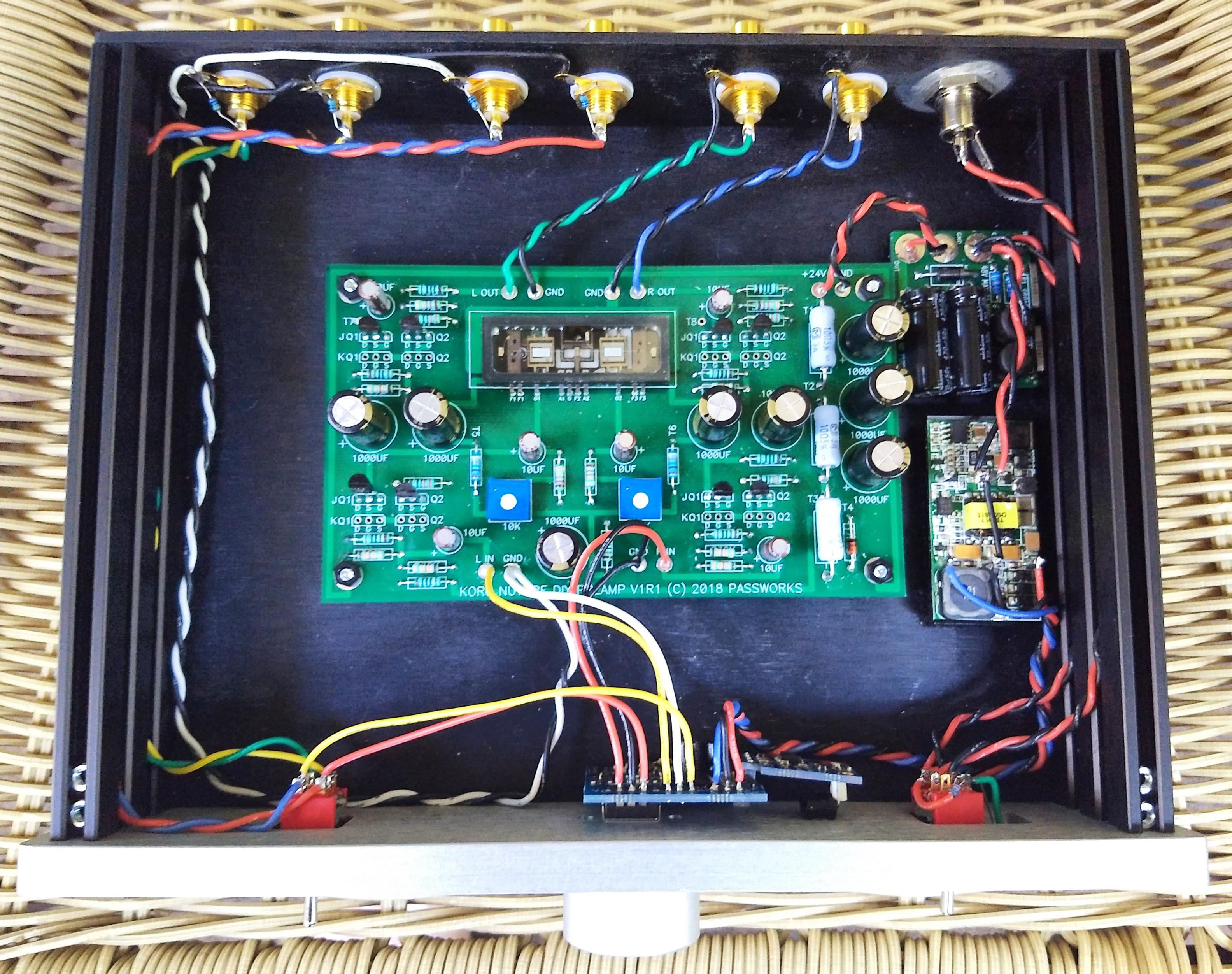

Does anybody recognize this noise?
This is what I’m getting out of the Korg B1. I don’t know what kind of noise this is. The link is to an .m4a file. Works on mac/apple. Not sure if Windows uses that format. I’ll try to save it in another format if someone can tell me what the preferred format is. Thanks.

My understanding is the board is grounded to the chassis via the screws that hold the board. As far as I remember that was part of the design I haven't checked though, but I would expect continuity from board ground to chassis via the stand offs.
I can't though tell you if that is the problem. BUT you can easily chekc that; just attach a wire to one of the stand offs and to a chassis screw, ensuring continuity, and see if your problem is gone.

I built the kit perfectly stock. I have a little bit of ringing, but only when the box is touched. But there is a hum. It’s not 60hz or 120hz. Someone in an earlier post said they heard a sound like an active cell phone near a radio. Not exactly crackling, but not periodic. The “hum” doesn’t go away when I change from input 1 to 2. And it doesn’t seem to be affected by the volume control. Any ideas where to start?
A few thoughts, perhaps you've already covered them.
If it's common to both channels then probably it's either in the grounding or in the power supply. If not, it's on the PCB or I/O wiring.
I listened -- it does sound like the kind of noise I used to hear on shortwave bands, never understood if it was a transmission or natural noise. Calling it a “hum” muddies the water – it sounds more digital square wave than sinusoidal analog. So, I wonder if it’s your SMPS wall wart.
The recording has two distinct sound signatures. Is that from the middle of a session with a Korg that has been on for a while, or is that the signature of what happens right after you turn the power switch on or plug in the power supply?
I kinda lean toward a noisy/defective power supply. For me the first step would be to try an entirely different power source -- bench supply, two 12v batteries in series, another wall wart, anything. See if the noise remains. After that, start looking at ground, but do the PS examination first. While grounding the chassis to the pcb should provide shielding from external noise sources I don’t think you need to connect to the third pin of a 110v socket. The Korg kit is designed to work with 24VDC provided from a wall wart that does not use that third pin.

You prompted me to take the action that fixed the problem. I had 2x24v Meanwell PSs for mono ACA’s, so as I swapped them, I inadvertently touched a Google WiFi node that was about 3 feet away. When I did that, the noise stopped completely.
Upon further experimentation, the cause of that noise was definitely the WiFi. I would have thought 3 feet would have been enough, but that was definitely the problem.
Any ideas as to why a WiFi node 3 feet away would make so much output noise on the Korg B1? Do you think it affects the “tube” itself or is it affecting something else? Having eliminated the problem, the question is pure curiosity as the problem is gone.

Because the device lacks an input RC filter. Maybe also stray in via power wiring. The device is best built in a metal casing.
As I was building mine recently there was a discussion about the SMPS filter that is now available for $10 from the diyaudiostore. I expressed interest and a generous member sent me the parts for one and it now resides in my Korg. It's very well regarded and fits in the Korg chassis (see attached image) and I feel more secure that powerline noise is not entering the audio path through the Korg's SMPS.

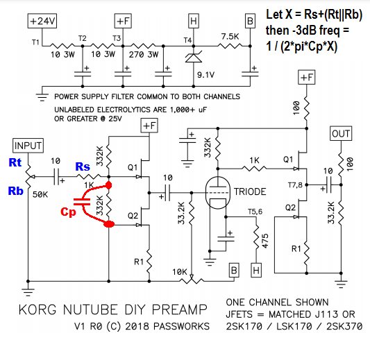

Possible causes and solutions for wifi RFI pickup

Several possibilities:
* You did not use a metal case.
* You did not twist the internal signal wires pairs (signal and ground) to the signal input and output jacks wires, or did not twist them tightly together.
* If the RCA jacks were insulated from the chassis with isolation washers, then you did not solder a small ceramic capacitor from the shield lug of the capacitor to chassis right at the entry point.
Some additional steps you could take:
* insert a ferrite bead or core on each of the twisted signal wire pairs, to dampen RFI. You can find these surplus at All Electronics and similar establishments.
* use shielded wire instead of twisted wire pairs.

thanks for the great suggestions, guys! A few questions/comments:
1. I used the metal chassis that came with the kit. BUT, I don’t see a clean path to chassis ground from the board. The closest is the stand-off screws for the board, but they clamp down on anodized aluminum (?). Do I need a real ground strap to the chassis?
2. I don’t recall anything in the kit or instructions about a small ceramic capacitor between shield lug of capacitor and chassis. If I should have that, can somebody provide more details? I don’t know what “small ceramic” means.
3. I have some ferrite snap-on “chokes”. Are you saying I should put one on each input wires inside the chassis?

You should scrape some of the anodizing off so that a good connection is made, that is essential.
There is disagreement here about the caps. My vote is to not do anything like that, ditto the ferrite chokes. Those could be essential in harsh environments like technical facilities or live stage performances where wires are long and signal is everywhere. In a home environment don't overcomplicate and you should be fine (my opinion, there will be others).
