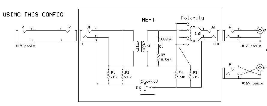

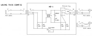

This H2 phase stuff confused the hell out of me 😕
...until I took Papa's text and created this reference diagram.
Front end (FE), I use a transfomer to reverse polarity. (The VFET FE does this, 2nd example IS the P-ch Sony VFET part 1).
Outputs on power amps, I reverse speaker polarity.
It gets more complex when you have more than one H2 dominant amp in your system.
I'm showing only one H2 amp in each example. FE is assumed to be fairly neutral/low THD.

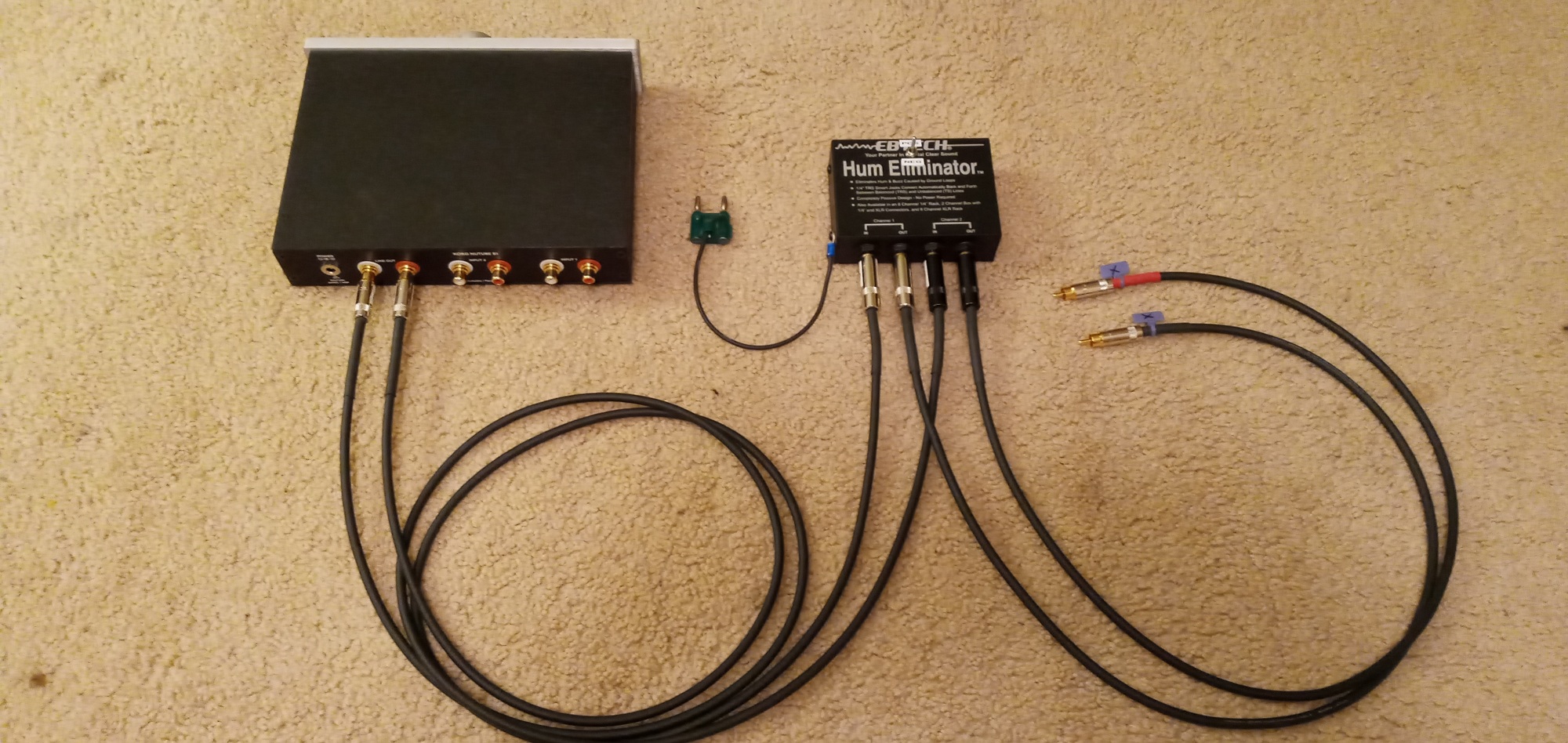

Here's what I use. Isolation transformer with custom cable to reverse polarity.I would love to see a couple of pictures of your B1K with the transformers Cinco 🙄
Later I modified the iso box with a polarity switch so standard cable could be used.
I've been using my B1K lately with MoFo as in 2nd H2 Phase example.
(FE being the B1K, both have +H2 then -H2 after speaker flip.)
I use the HE-1 between source and Iron Pumpkin to reverse polarity into Zen v8.
It has -H2, so 4th H2 Phase example connections to maintain its -H2.

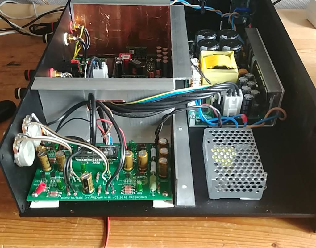

I have to add that I have connected the Purifi amp to mains with power cable without ground because otherwise its humming. Without connection to mains ground its really noiseless.
So the question really is if its sensible to connect 24V psu to the casing.
The Purifi module and Purifi psu both have clean connections to the casing.

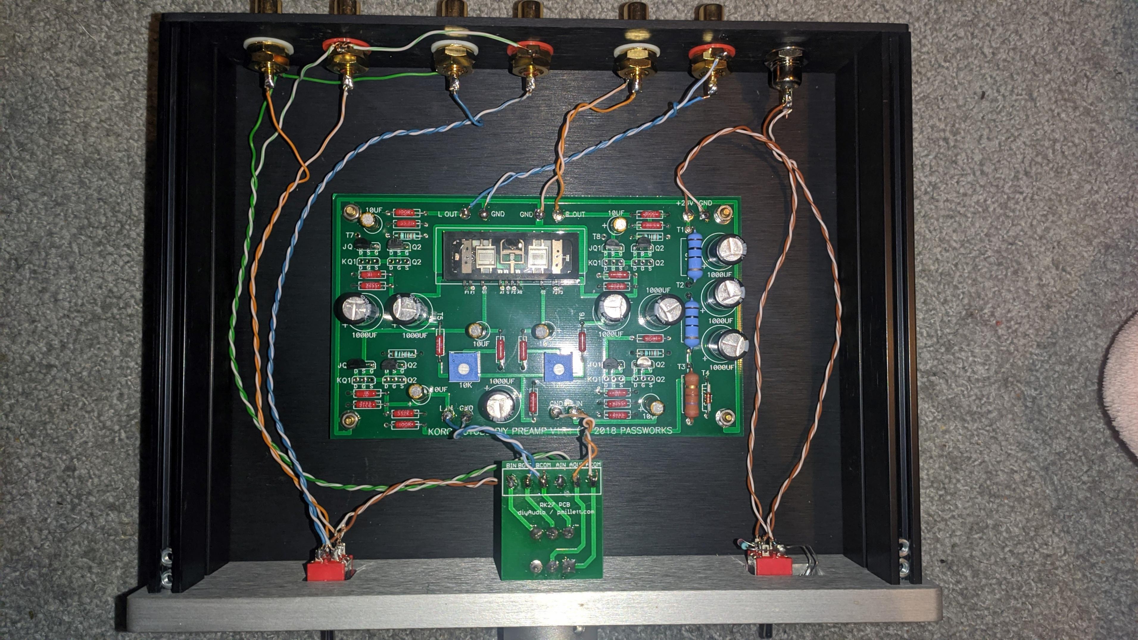

Hi, I made this pre amp a few months back and absolutely love it. It had been working fine for me up until 2 days ago when I noticed a faint hum.
the hum gets louder with volume and even louder when I touch the chassis, especially the volume knob or face plate.
Does someone with more knowledge than me know what the issue may be

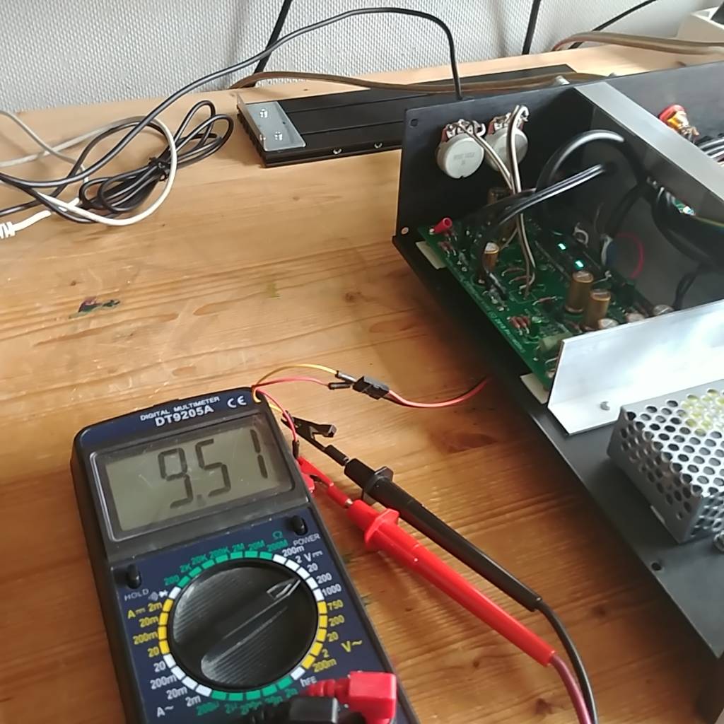

Hi all,
months ago I shorted something on the left channel while measuring.
Then I bought 40 On Semi j113s. Today I desoldered the output buffers to replace them. I matched the fets. Got pairs and a quad with 12V and a 100 Ohms resistor. Now I read that Q2 is matched to Q1 with R1 for 10% less current.

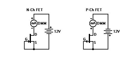

Hi all,
Can I use the On Semi and how do I find the correct value for R1?
Thanks in advance.
Matthias
Zenmod, thanks, does that mean I can take my quad and then I choose the resistance which gives the 10% difference?
