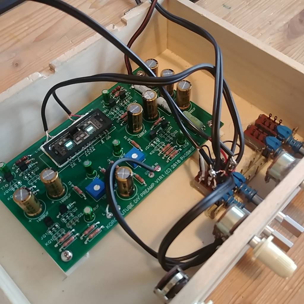

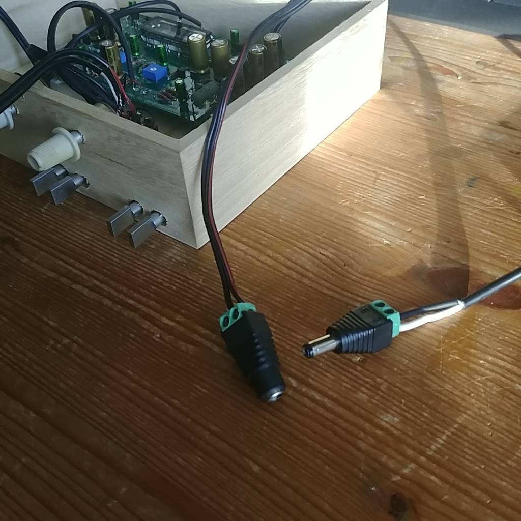

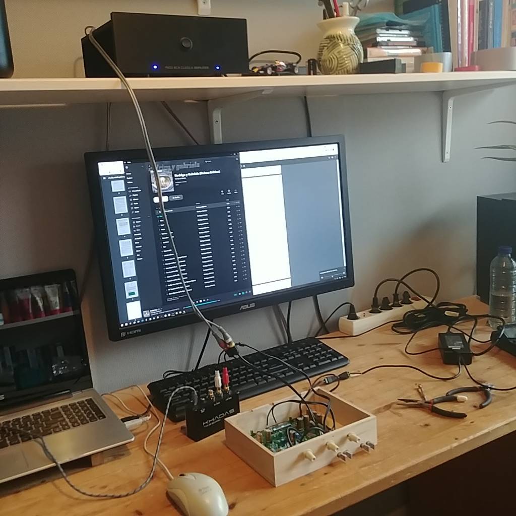

Hi, I might have a problem. I rewired the inputs, added a volume pot. Then connected the NuTube between dac and Pass ACA. Then wanted to connect the 24V power and got a spark between 24V plus and the NuTube ground. This before really connecting. Off course I did not connect. I don't see any false connections. When I measure the power input on the NuTube I get only 270 Ohm between plus and ground. Is that much to low or an result of the capacitors?
Maybe its normal to get a spark when accidentally touching 24V plus to ground? If I look closely I see black spots on both connectors.
Hi, I messure the (475 ohms). I bouth it as 470ohm ( did not assume it was that importent ). They messure 467ohm and 469ohm.
As NP say, 5ohm can make a difference. So, I will put in two Dale 475ohms ( messure 473.9ohm). Can also the ringing problem at start of testing the Nutube been fatige the nutube wire?
No problem on my side. Just a power connector that easily makes contact between plus and ground while connecting. I'll change that one.

Problem with both pots
I have trouble trimming T7 and T8 to 9.5 Volts.
Lowest value for T7 is 9.51 Volts, for T8 it is 9.75 Volts.
The sound is quite distorted.
My R1s are 220 Ohms.
T1 23.98
T2 23.11
T3 22.31
T4 8.81
T5 0.621
T6 0.637
All readouts after 1 hour warm up.

I'm thinking of wiring the two 10K pots to 10K pots on the outside of the box. And also wiring T7, T8 and GND to a insulated connector on the outside of the box. That way I could easily connect a multimeter and adjust the plate voltages. Can I do this without risk of creating noises?
Reason is I'm planning mount the NuTube into my diy Purify power amp housing. It would be a hassle to move and open the power amp for plate voltage adjustments 🙂

Those voltages aren't off enough to cause the problem. What is the voltage across the 221 ohm resistors?
