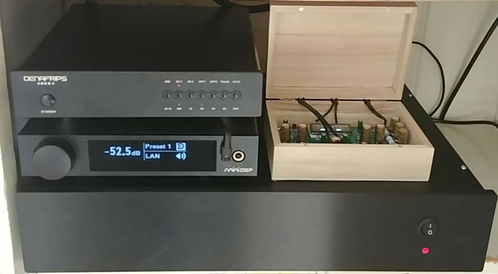

My set up is Minidsp SHD Studio streamer to Ares dac to Purifi amp. I intend to put the NuTube B1 between dac and power amp. Because I use volume control of the SHD Studio I want to leave out the volume pot and input selector and just connect the output of the dac straight to input on the B1 pcb.
Test set up is working well, sounding great.
nice ! I use (and love) the Minidsp as well. Connected to my DAC (Holo Audio Spring II) and then the B1 too

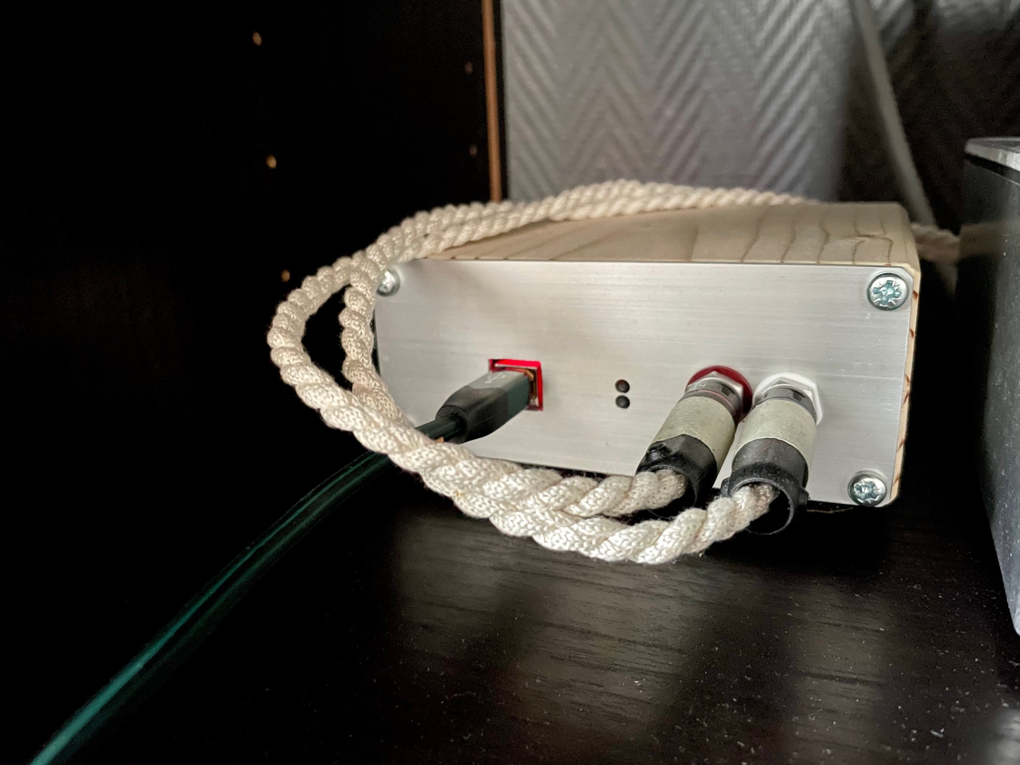

Your twisted wires pairs with cotton "sockets" don't make short contact ? Fragile isolant material..

Soundhappy: I dont know about the curent, have not adjusted/checked the Nutube for months. And yes the filament tread/wire is broken ( I can see ).
I messure alitle: T7-20vdc, T8-8.5vdc, 33.2K left side-33K, 33.2K right side-55K. I think I get all kind of crazy messurament with power on and broken filament.
Twisted cables with silk I am 99.99% thats not problem. I have hard twisted interconect cables RCA inn almost all my system, no problem. Ihave already ordred a new Nutube. Make more messurament with Nutube out. chanting: I will look at it. Now that all sound so good with new Accuphase F-20 and all

I try to understand the cause why the filament became broke.
Probably stay hot long time ~ 3500 hours make them fragile.
Better turn the psu power-off so filament can back to the cold state
in the hours you don't need listening music 🙂 What you think ?
