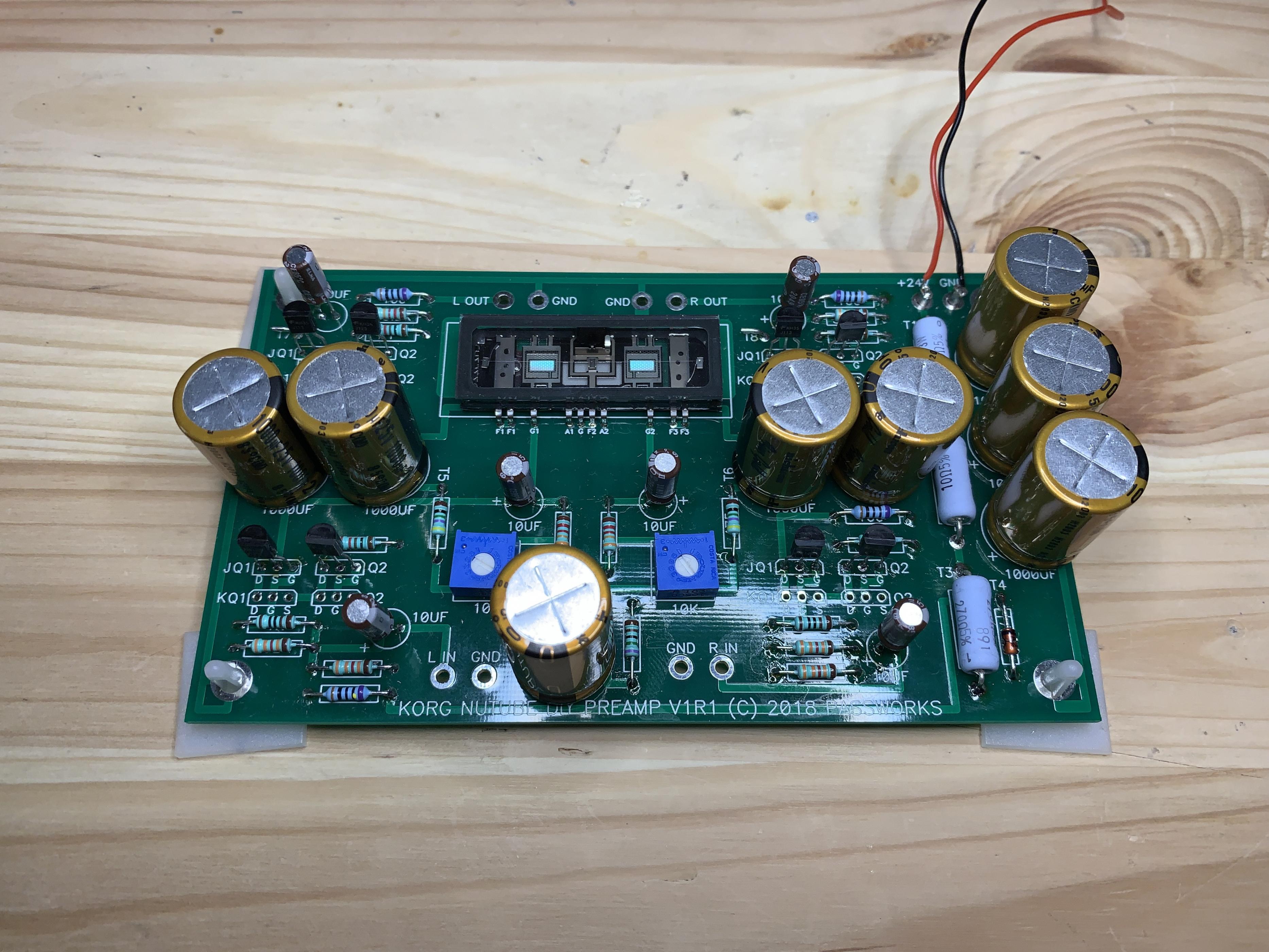

B1 with Korg Triode
Many many thanks for helping me.
As all R1s are connected to Q2s, I will refer to them by position on the PCB.
My voltages across R1 are:
Upper left 1.677V
Upper right 1.661V
Lower left 1.691V
Lower right 1.564V
Attaching a picture..

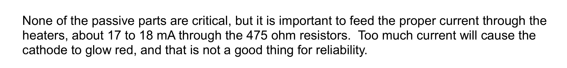

Hi, I have now desolder the failed Nutube.
Change the 470 ohms that was in the 475ohms spot with Dale 745 ohms.
Have been powered up now for one hour ( without Nutube in place, coming with post from RS later today ).
The readings I get is:
T1 = 24.02 vcd
T2 = 23.19 vdc
T3 = 22.36 vdc
T4 = 9.34 vdc
T5 = 9.34 vdc
T6 = 9.34 vdc
T7 = 20.31 vdc
T8 = 20.30 vdc
What do you think, solder in the Nutube? Frank
Those voltages aren't off enough to cause the problem. What is the voltage across the 221 ohm resistors?
Hope it is not considered rude to come back to this.
I now have double checked all components on the PCB with no result. Polarities of capacitors and resistors values appear to be good.
The only finding I have is, that 2 of the J113s are labeled KH33, 6 are labeled KH35. Is this Okay too?
I followed the beautiful build guide very precisely. I am very sure, that I have not mixed up the bags with the matched transistors. The two KH33 are both in Q2 positions, so they came from the Q2 bag.
Upper left 1.677V
Upper right 1.661V
Lower left 1.691V
Lower right 1.564V
Thank you very much! It is such a beautiful design, I would like to enjoy it.
