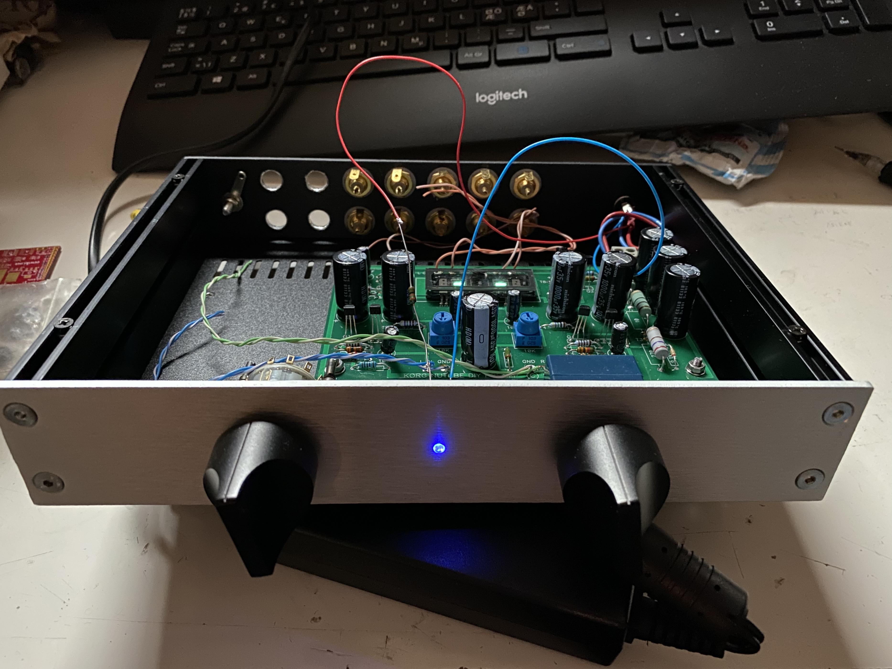

Hi, I have the Nutube B1 on order. My set up is Minidsp SHD Studio streamer to Ares dac to Purifi amp.
I intend to put the NuTube B1 between dac and power amp. Because I use volume control of the SHD Studio I want to leave out the volume pot and input selector and just connect the output of the dac straight to input on the B1 pcb. The Ares dac outputs 2.2V max on RCA but is usually set at - 40dB max. Is skipping input selector and volume pot feasible? Or should I take extra measures?
I would think you would want a resistor in place of the pot. Just between signal and ground to establish input impedence. If the pot is 50k, then 50k.
That said, I'm not sure why you'd want to add an extra component. Do you need the gain?
Thank you for your answer. I'll add the resistor.
Concerning the additional component I just want to experiment with tube sound added to the very neutral power amp. Could have bought a cheap tube pre but DIY is much more fun. I'm feeling a bit lost after finishing the Purifi amp. Already have an ACA in use in my study. Bigger class A amps are to big for my surroundings [emoji2].
Only the wiring remains. And four RCA sockets in the snail mail. (Might change the LED to yellow. Or green or red.)

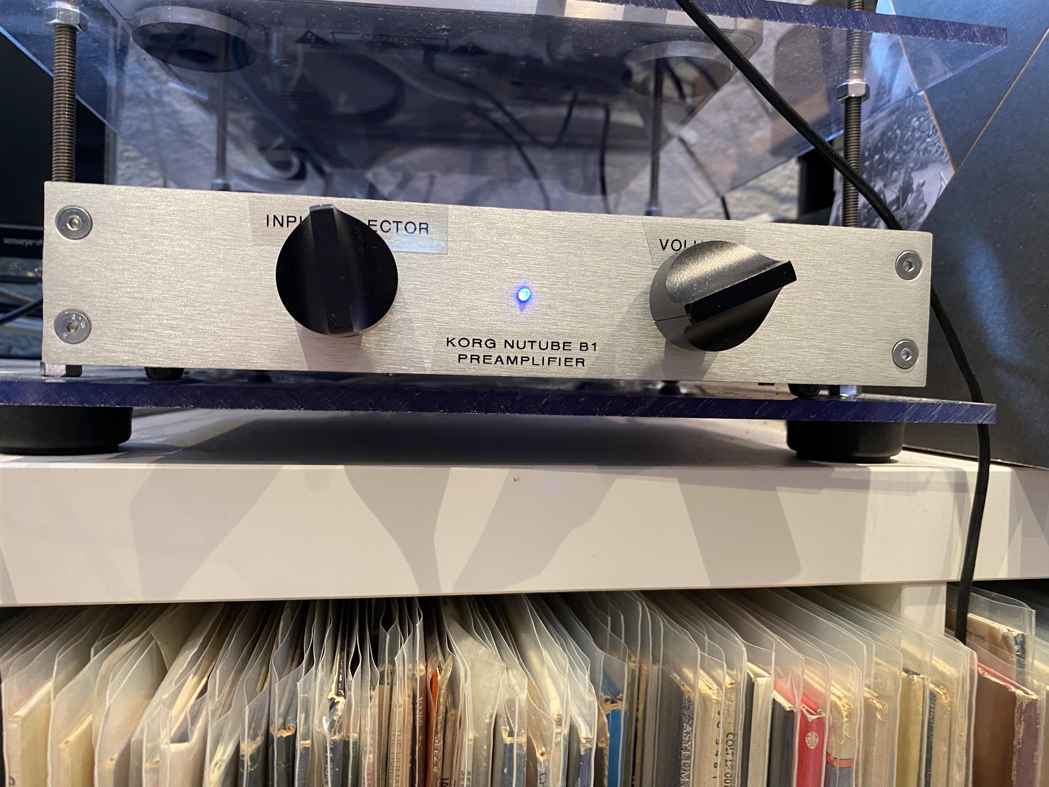

Lettering of the front remains. Earlier attempts of mine used a transparent with lettering, fixed behind an acrylic front plate. Seems the Lettraset I used in the past is no more available. I am looking for a nice and cheap way of finishing the front panel.
Thanks, Claude and Dirk.
