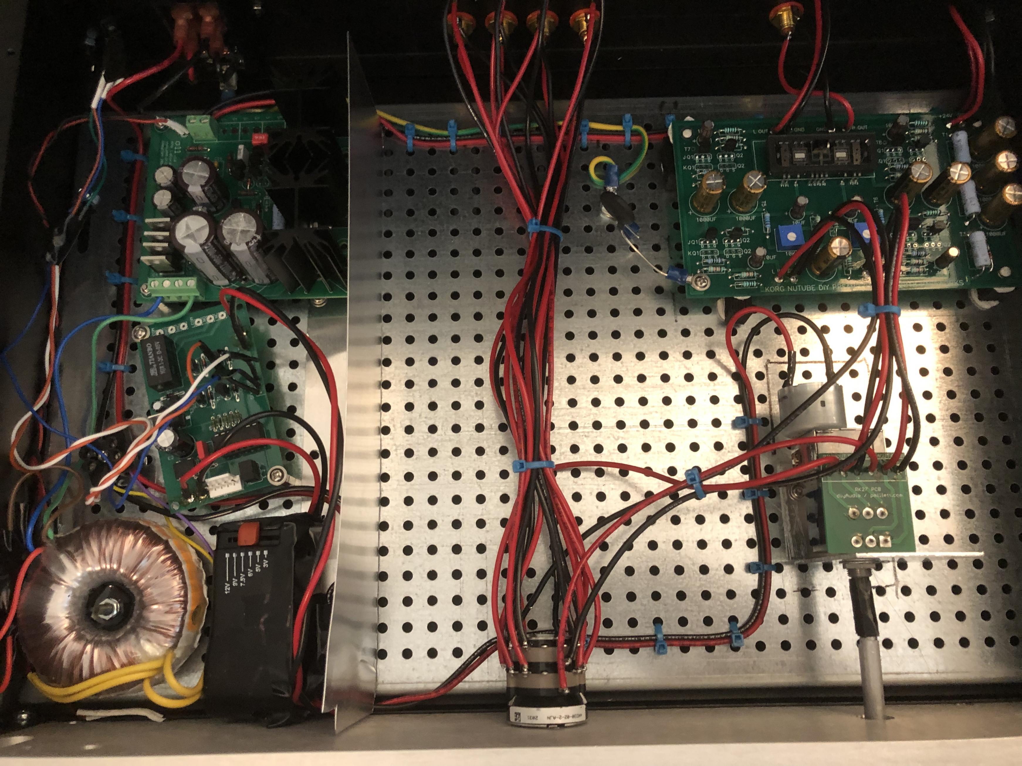

Rebuild with new psu
Hi
Rebulid with amb.org sigma 11 psu
Andreas

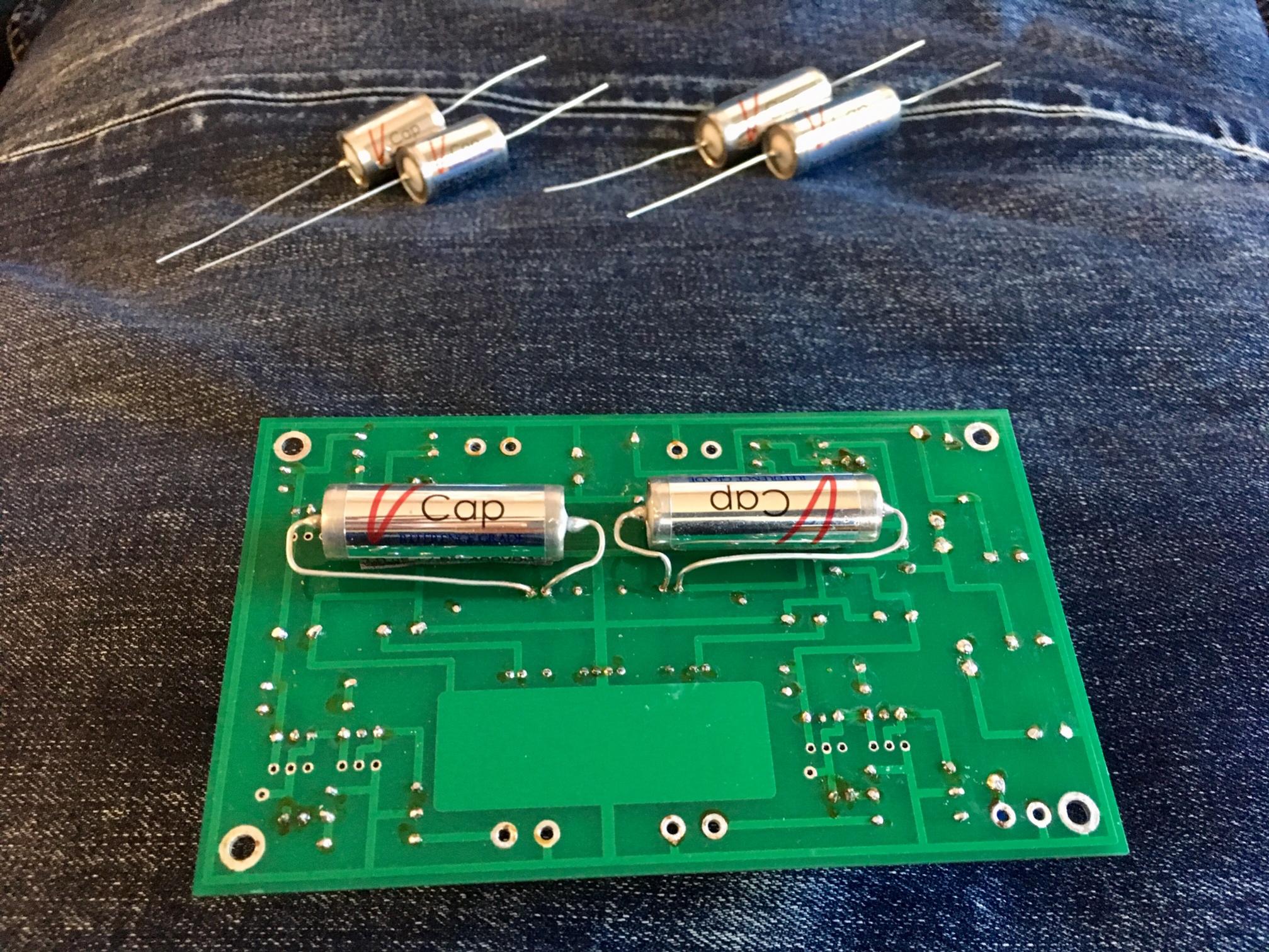

Hi, I now have instaled V-Cap ODAM in the signal way. Using 0,47uF - 1,0uF - 2,2uF.
Have played for 50 hours now. Its sound good with elctrolyts but with ODAMs I must say it sound more open, bigger soundstage,tight bass, sound not coming from speakers themself but more like mixed togther. Im not good at explane sound but I like what I hear ( ;
Frank

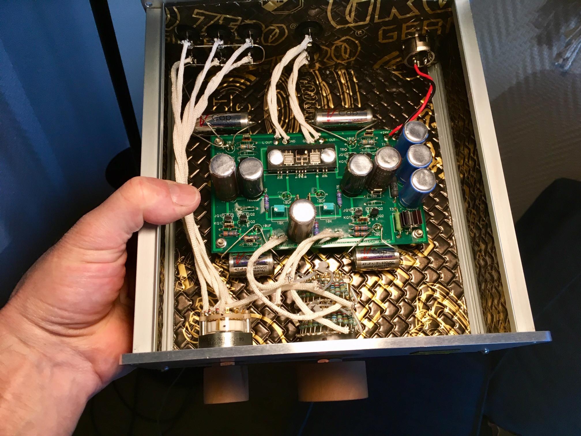

Excellent B1K build :cheerful: Congratulations
By the way, what's the material lining the box?
