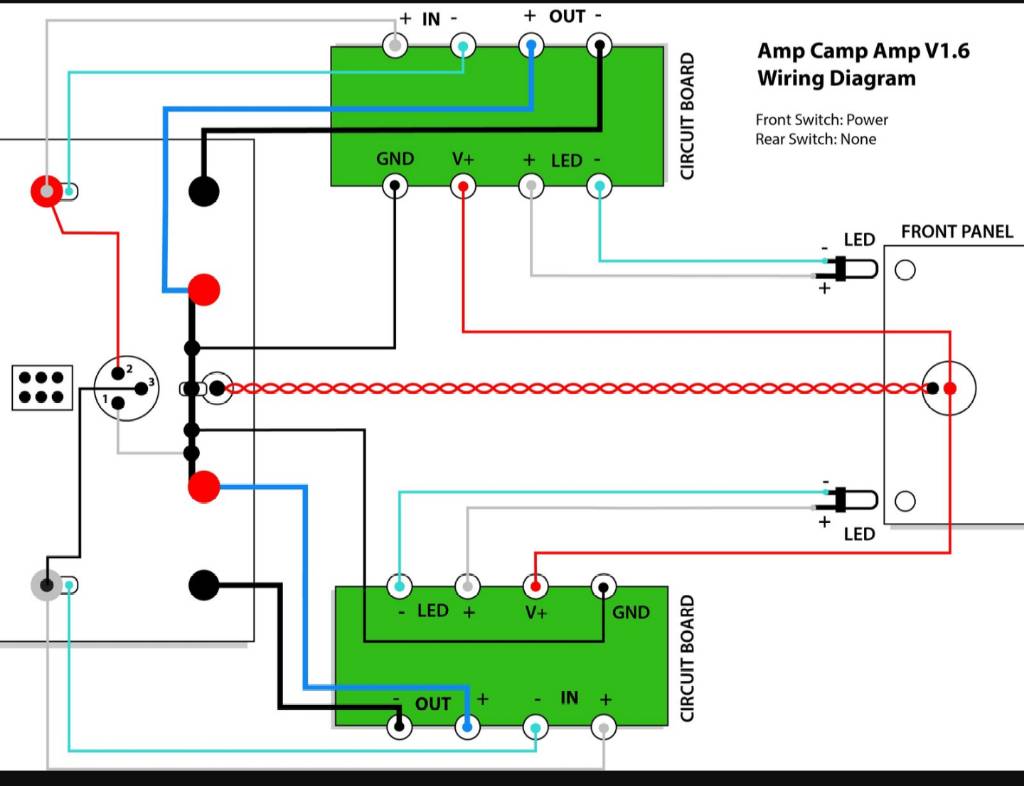

Does anyone invert the output of their B1? Does the Triode phase invert the input signal? If so, would swapping GND and Sigout work?

I too got confused about al this phase inversion stuff, as I use my B1K as input to an ACA, which itself is phase inverting, but which is wired in the standard wiring diagram to invert the phase of the speaker terminals thus correcting the phase inversion of the ACA itself. So as an experiment I inverted the speaker phase of an ACA with a B1K upstream of it and it was awful, soundstage collapsed completely, like I was listening in mono.

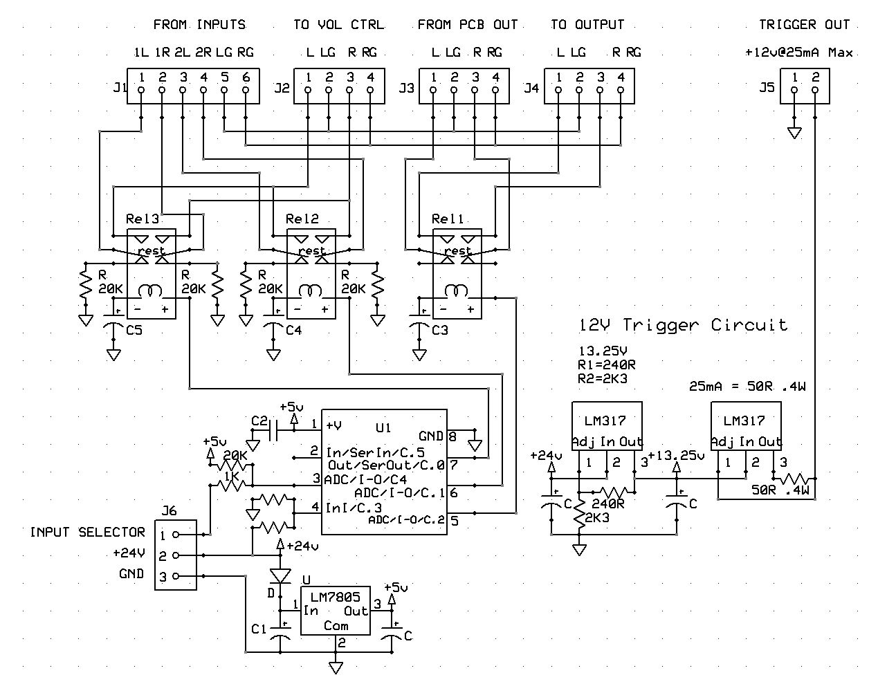

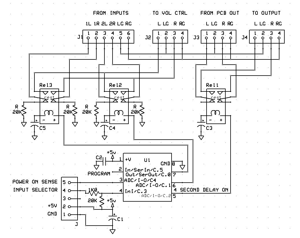

I have it in mind to install some additional circuitry in my Korg B1. First, I am indeed suffering from the turn-on and turn-off thumps and when my new subwoofer arrives I'm guessing it's going to get a lot louder.
I thought I'd move the Korg pcb about one inch or more toward the front panel to give myself room between the main board and the rear input/output sockets.
Note that the relays are of the hermetically-sealed, latching variety which consume no current and generate no magnetic field when in the steady-state regardless of which position it is in. Switching is accomplished by charging or discharging a capacitor through the relay coil. No diode is required and the resistance of the relay coil acts to limit current so no resistor is needed so long as the current demand does not exceed the ability of the chip to deliver. Relay coil voltage does not collapse to cause damage -- it gradually dissipates as the capacitor charges or discharges.
Disregard the logic chip circuit -- it's a partial circuit and I may go to a 14-pin chip to accommodate other capabilities if the need arises or to insure relay operation by tying two pins together to double the current delivery capability when switching.
I have a number of goals:
1) Make my input switching noise go away by moving the actual switching onto relays located right at the input sockets and by always grounding the input not in use to ground through a 20K (?) resistor. The front panel switch then uses a single wire to control the input relays which do the actual switching.
2) Make the power on/off thump a non-issue by inserting a relay with a 4-second turn on delay and instantaneous turn off when power is removed.
3) Install a 12vdc 25mA trigger circuit to control the downstream power amplifier.
I would like to hear any suggestions and advice that might make my design better before I start drawing a pcb layout. If I have missed a desirable feature that might fit here, I'd like to hear about that, too.
Questions I have:
1. Is 20K a good grounding resistor value for the input that is not being listened to?
2. Would the output relay circuit benefit from handling like the input relays -- a 20K or other value resistor terminating the output cable to ground when the output relay has disconnected the Korg from the cable?
3. Is there any benefit in provisioning a manual output relay control, or is the power-monitoring of the output the only useful control?
4. Is 12vdc @ 25mA enough current to properly drive a trigger circuit? Should I plan on different values of current?

I'm confused too. I assume you should connect the white speaker cable connector to the red amp output and the red to the white of BOTH speakers.I too got confused about al this phase inversion stuff, as I use my B1K as input to an ACA, which itself is phase inverting, but which is wired in the standard wiring diagram to invert the phase of the speaker terminals thus correcting the phase inversion of the ACA itself. So as an experiment I inverted the speaker phase of an ACA with a B1K upstream of it and it was awful, soundstage collapsed completely, like I was listening in mono.
That is the condition that destroyed the sense of soundstage in my system. I wire my ACA v1.8 per it's diagram (reversed output polarity) and the speakers red-to-red and black-to-black and it sounds great.

So this means that the phase invertion is Already solved within the ACA if you follow the build instructions correctly?That is the condition that destroyed the sense of soundstage in my system. I wire my ACA v1.8 per it's diagram (reversed output polarity) and the speakers red-to-red and black-to-black and it sounds great.

Hi Mooly, if I look at the ACA wiring I see no invertion. Red is plus on both sides. On inputs as well as on speaker terminals. Could you explain where the invertion happens? Thank you!The ACA is an inverting amplifier, you can not change that aspect of the design.
You as the user can preserve correct phase by reversing the speaker connections, something the ACA does if built according to the instructions by swapping the Red and Black terminals over.
