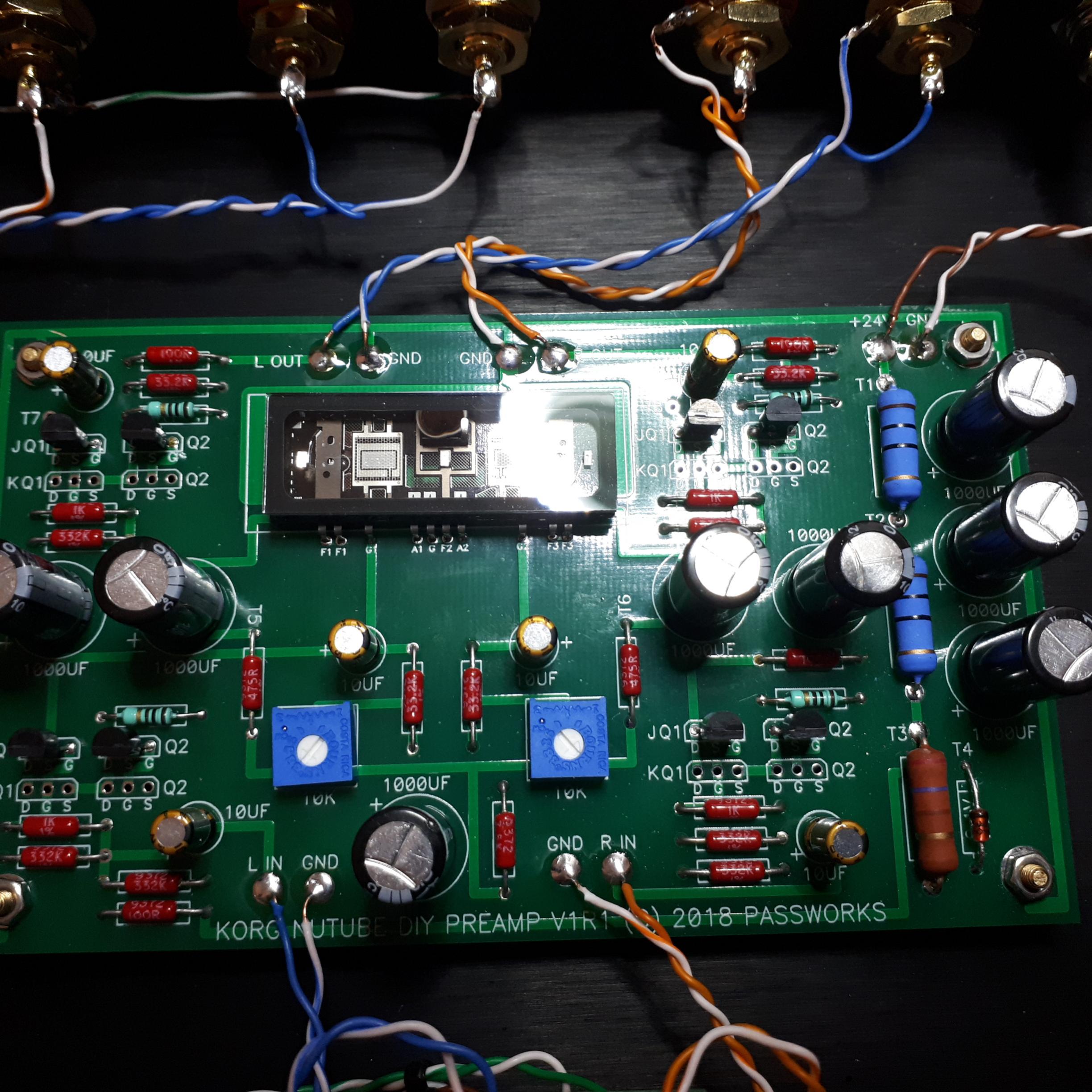

here is the complete board.
What does your power supply look like? Heater PSU is separate? I see two power entries plus a ground for the PSU. I am assuming one is for the heaters?

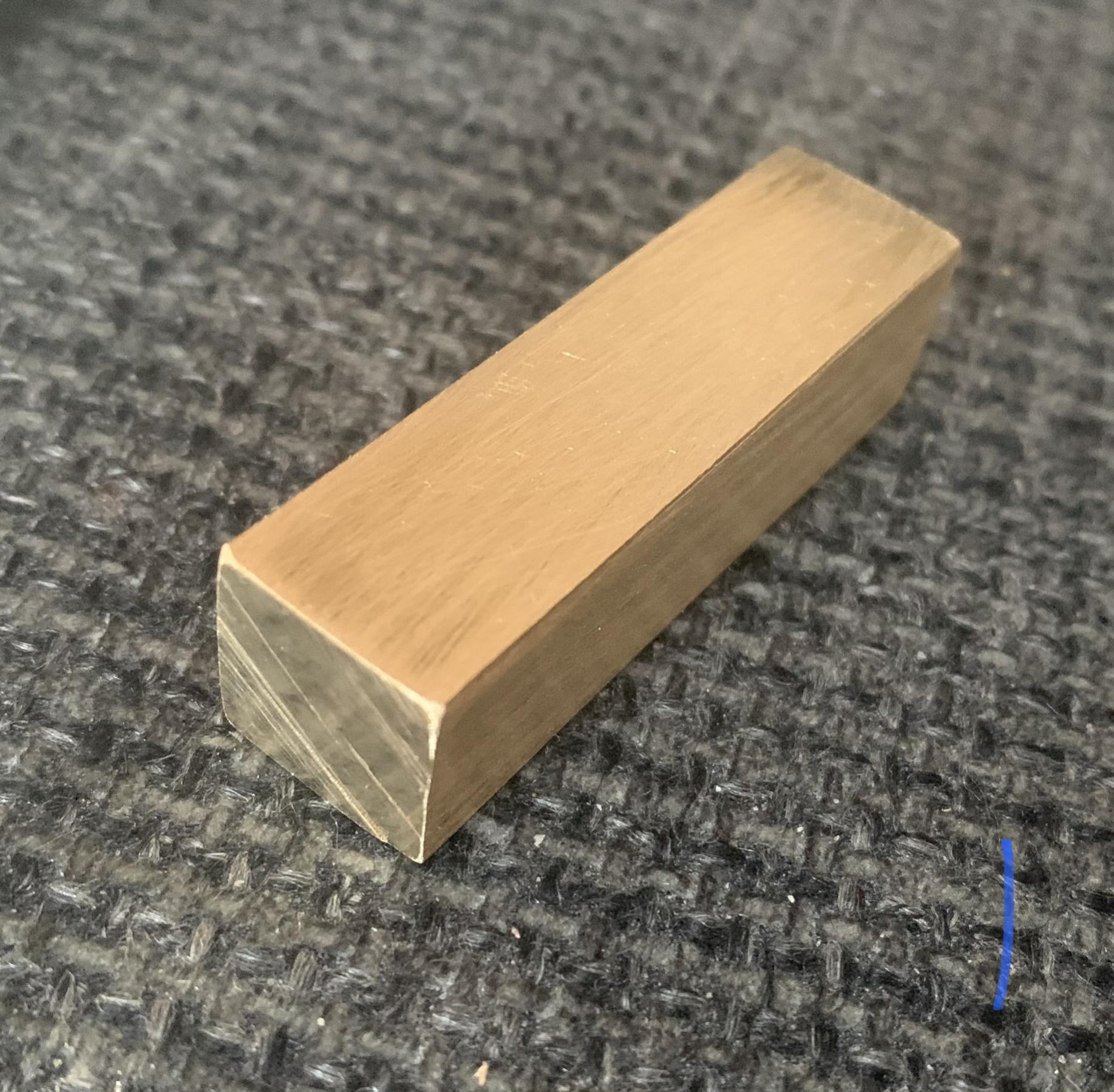

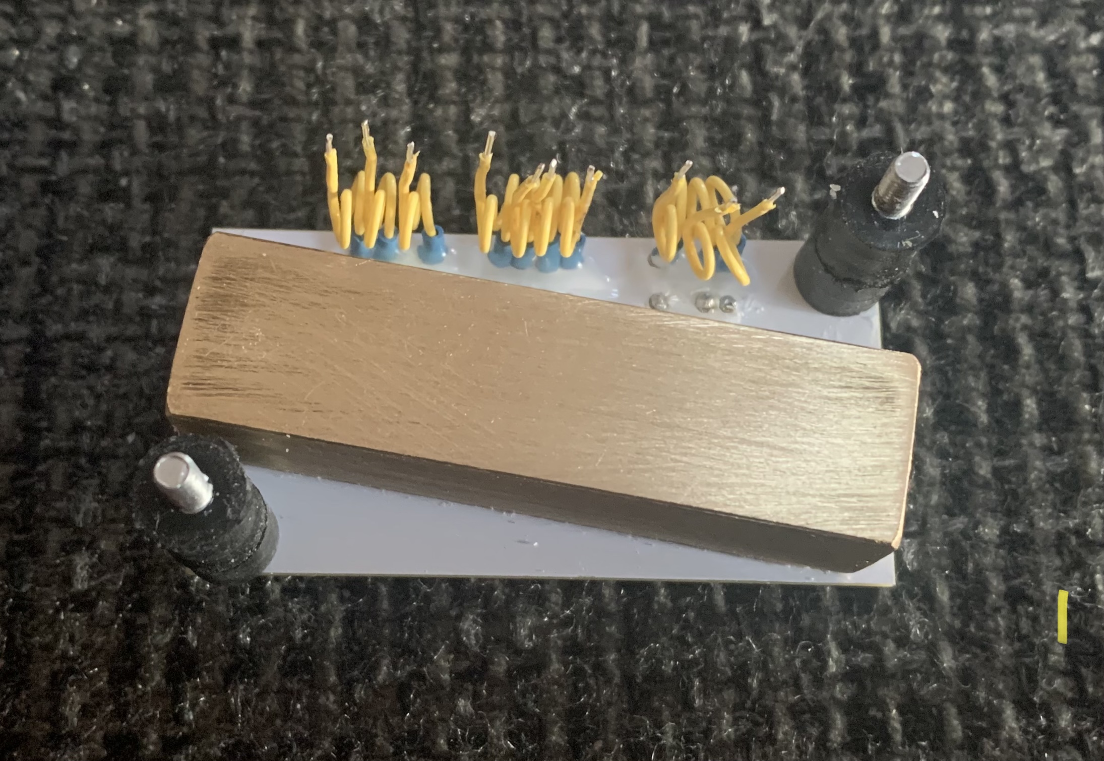

this is my solution for damping the nutube.
under the stand off board is a piece of brass
for more mass (120g)

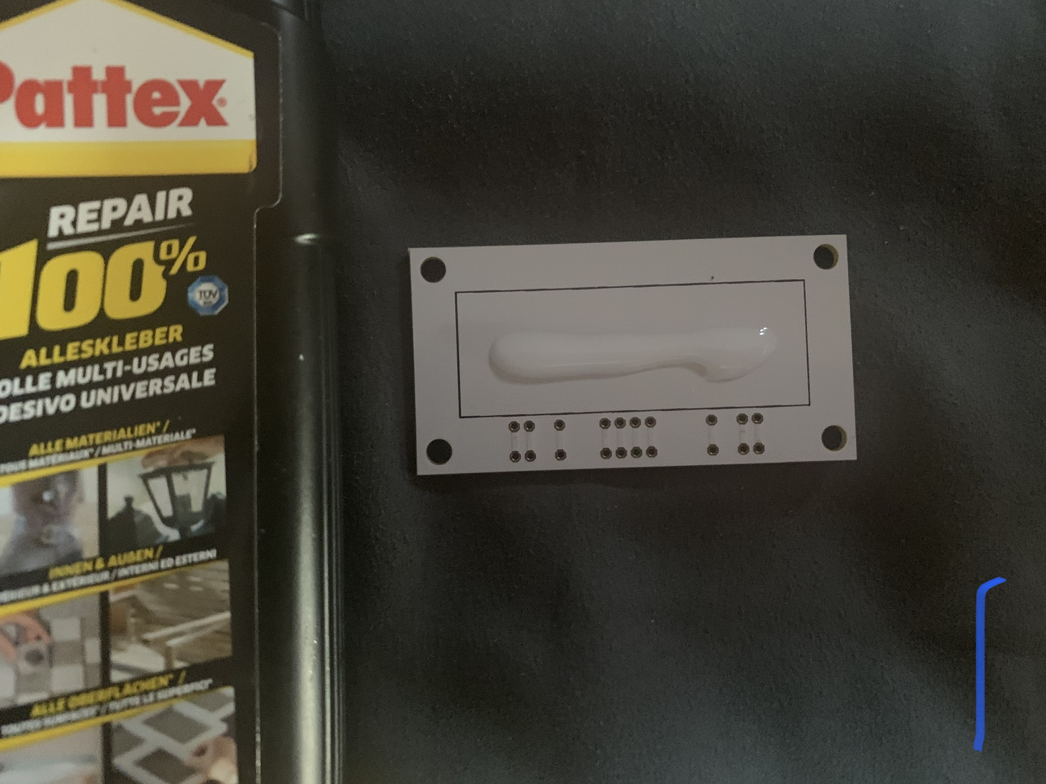

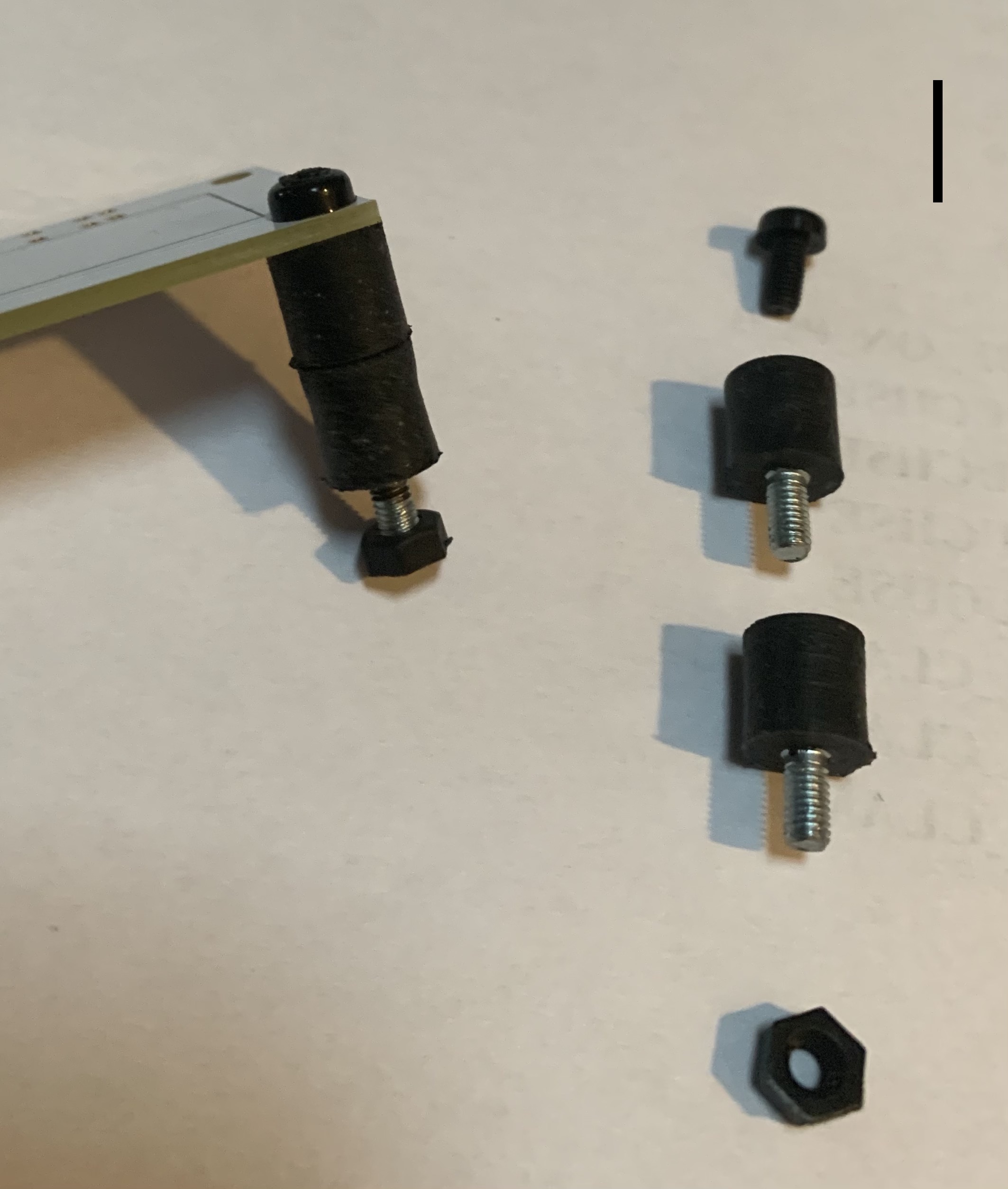

Here again some photos to explain.
the stand off board with the nutube weighs only 14g.
this is not enough, is stimulated so very quickly to vibrate,
also the dampers need a certain load to work properly.
I have bent the connecting wires like springs, so that they allow movement,
but also contribute to damping.
I’ve tested it, and it works fine.
a lot of effort and work, but it’s worth it.

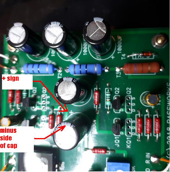

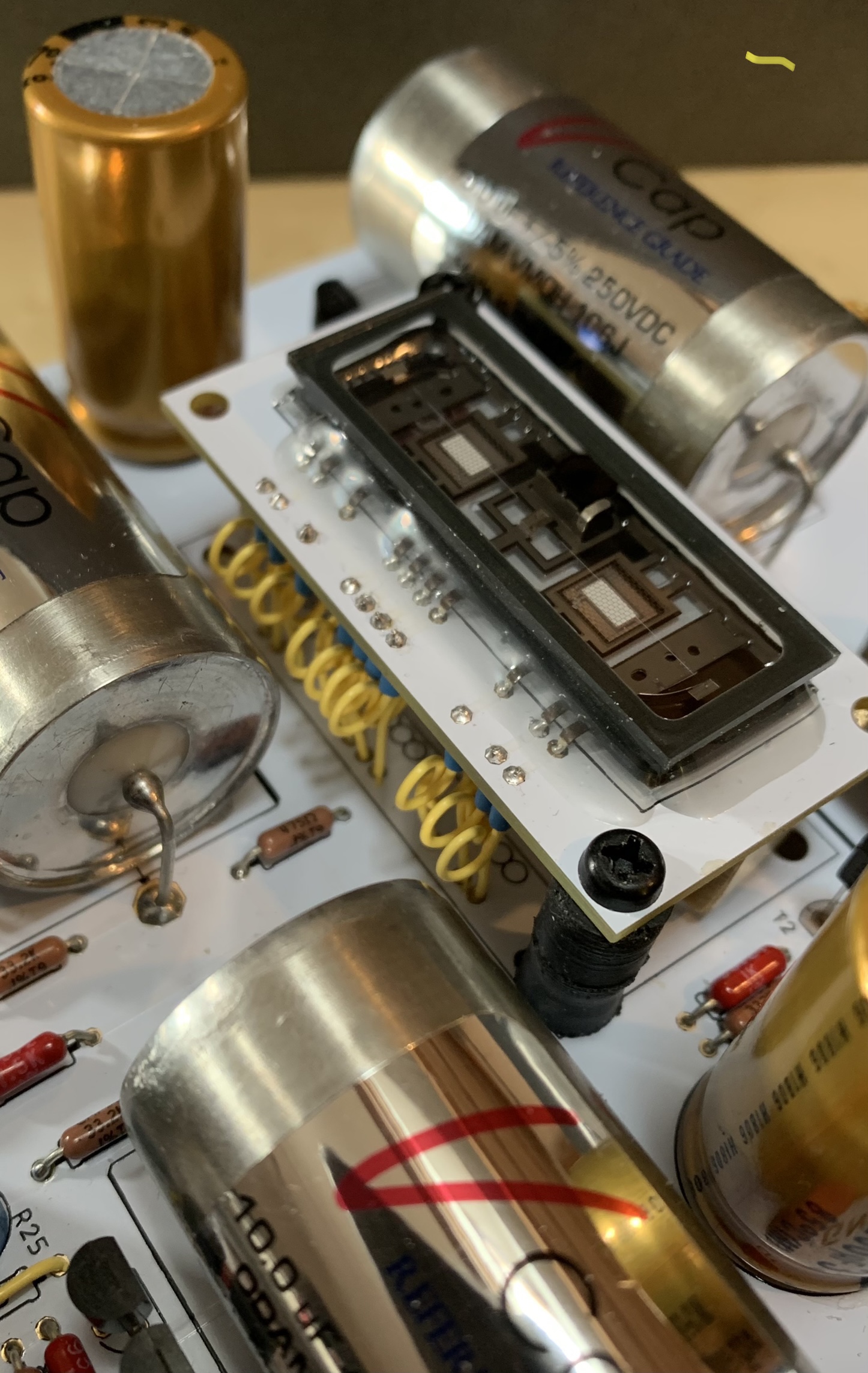

I just finished my board and the kit, checking all resistors, PCU etc. before soldering the rest.
Then I connected the Nutube B1 to the 24V supply. The left blue troide was slimming strongly, the right not that much. T1 was measured with 24V, T3 only with around 20.5 (should be around 23V) and T4 with 9V. After a few seconds, the right 1000uF Elko of the right channel had an issue.
Does anybody knows what's the problem?
Thanks a lot

Are you able to post some photos of your board so others can see if there are any build errors made?
Hallo Karim,
it looks like you put the two 1000 uF capacitors in the right channel in backwards, as well as the right 10 uF capacitor ...
have a look where the "+" sign is in the silkscreen of the board.
Best regards,
Claas
Edit: loudthud was quicker ...
Edit Edit: when you change the capacitors, also have a look at the resistors connected to them. Reversed capacitors can draw large currents, that could overheat the resistors as well. (don't have the schematic ready as for the resistor numbers)

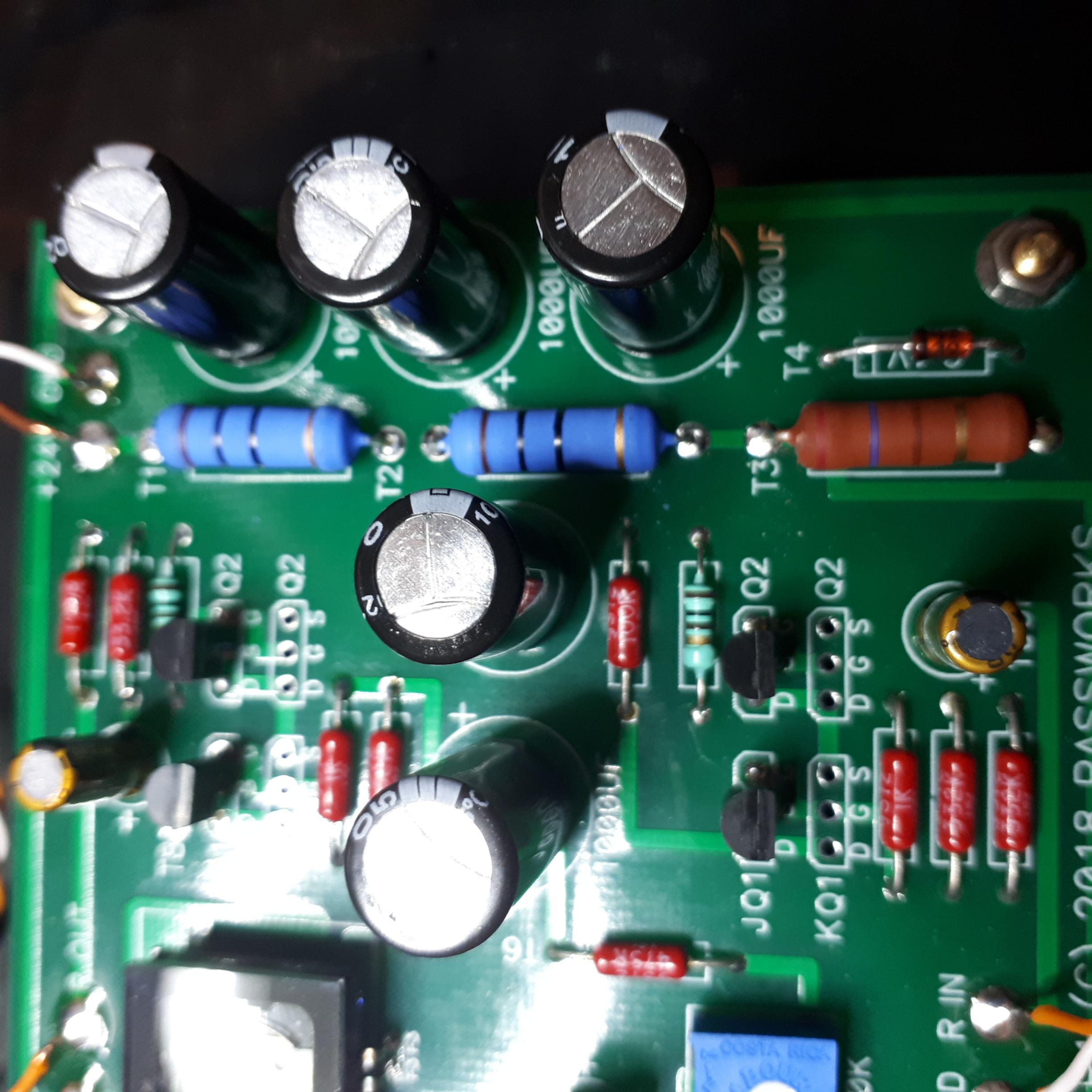

Attached you can find some pictures. T5 an T6 were also 0.6 VDC.
Thanks a lot Karim

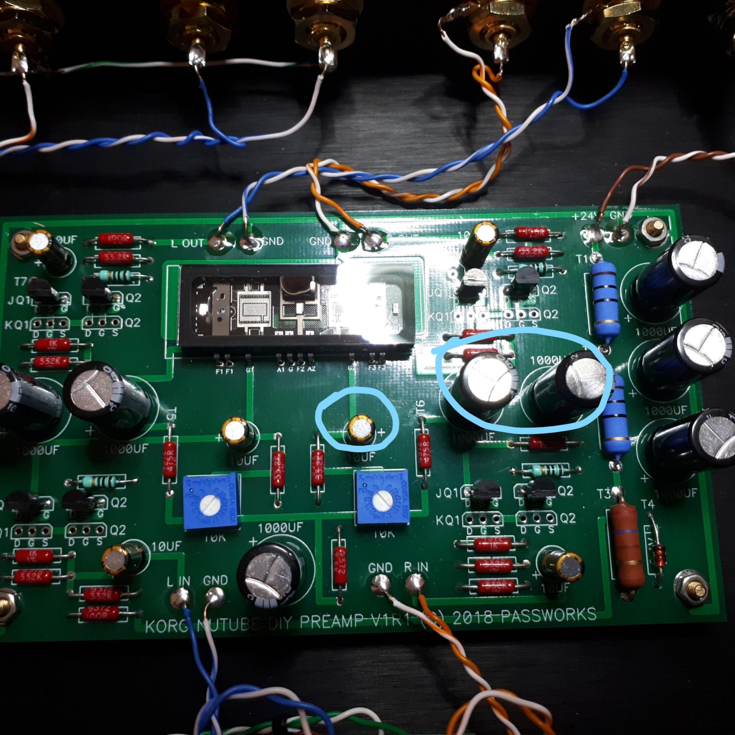

In the picture 20210410_201003.jpg one of the big electrolytics appears to be installed with polarity reversed, minus side of the cap near a + sign.
+1... Nice eyes Loudthud. You beat me to it. Just for clarity re: which one.
Edited to add and update the pic to grab the other two that Chede caught. What an awesome place.
Thanks a lot to you all guys. Yes, all three capacitors (2x 1000uF and 1x 10uF) have wrong polarities. Soldering to late in the evening yesterdays make these failures.
1. I will change the capacitors --> buying new ones --> do you have better recommendations (tubning options)?
2.I will check the resistors as well.

To second Loudthud... make that even 2!
The 2 big lytic caps, left pair on your first picture, seem mounted thew rong way!
