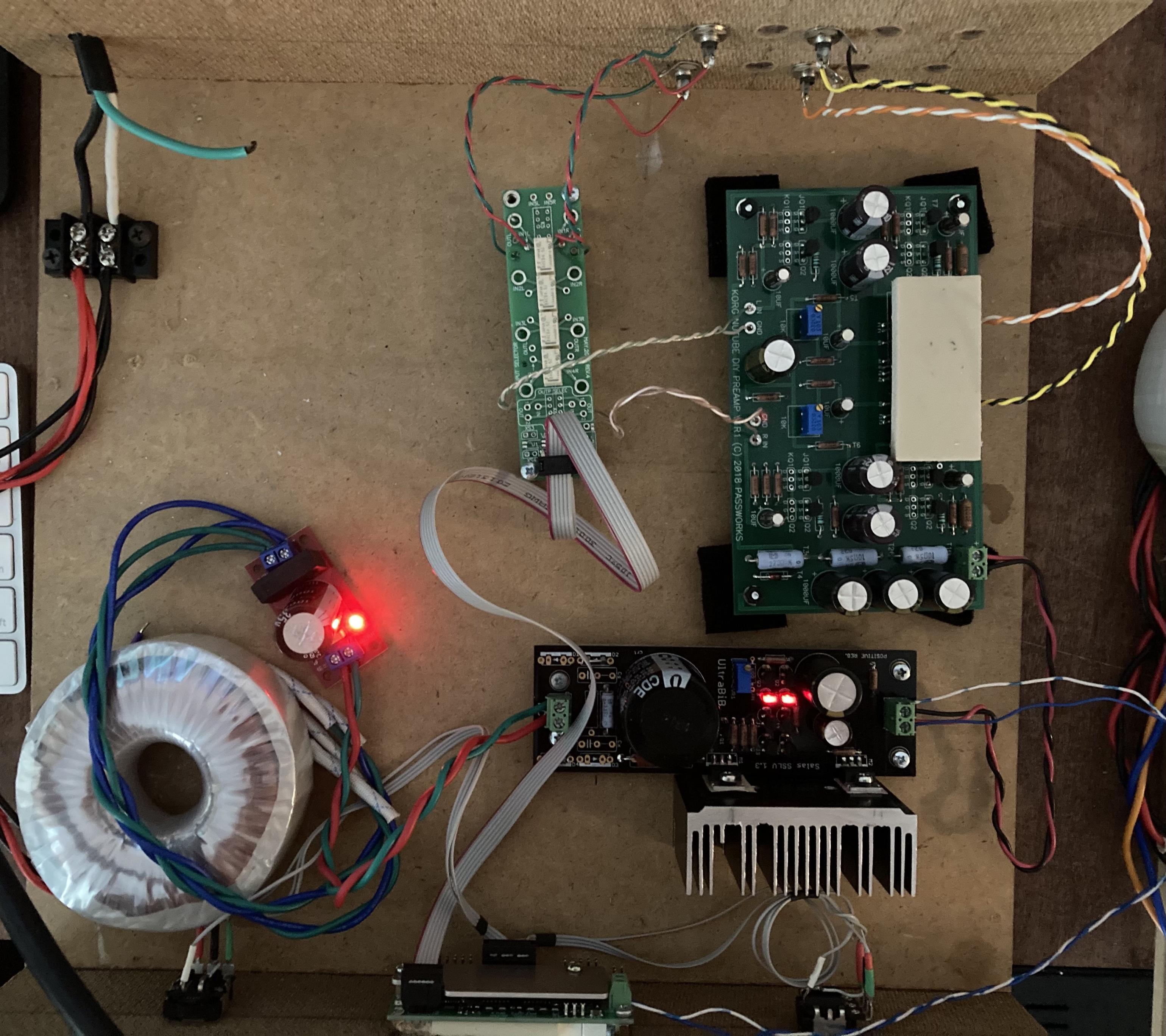

Anyway I had a AliExpress PS lying around based on a LT1085 and a suitable transformer to make 24VDC. Connected it and almost all noise is gone. Still a very, very small hissssssss coming from the tweeters of mij 89-90dB speakers.
I solved the microphonics of the NuTube by putting foam tape under the NuTube and using rubber stand-offs. It works but it is not a 100% solution in my case. Sometimes it still makes a terrible noise. When it's silent though I like the sound 🙂

simple silicon rubber mount can reduce microphonics easily.
(Photo from other forum on similar topic)
I'm using something similar, it solved 95% of the microphonics.
