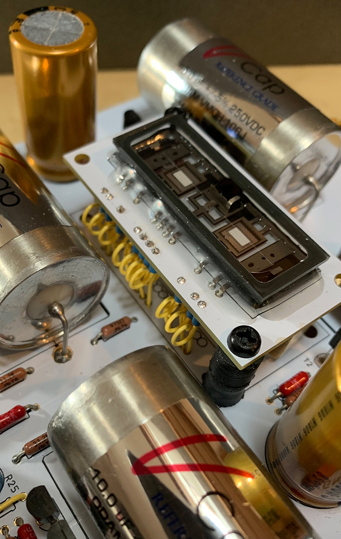

Wondering if I want to go the socket route when my replacement nuTube shows up. (Oh no! Another order from Mouser where I pay more for shipping than the parts.)
Thoughts? Suggestions for particularly good parts for this approach?

IMO, a socket is the only way to go. However, the NuTube socket and connecting header is difficult to source in US.
I would definitely treat the socket and NuTube leads with Cramolin. Assuming you can apply very tiny amounts, I would also use Silclear from Mapleshade Audio. I use it for interconnects and speaker cable interfaces (amp and speaker)and while it does not improve the sound after Cramolin cleaning, it keeps the connection from deteriorating due to oxidation. So no further cleaning is necessary after application. Without the Silclear, I had been cleaning my interconnects and speaker cable interfaces once a year.

A little antioxidant goes a long way. I've had a 25mL bottle of Cramolin Red for over 30 years and still have some left.
It is now marketed as CAIG DeoxIT. Same stuff. I prefer the 100% red solution in the needle dispenser bottle:

I'm using something similar, it solved 95% of the microphonics.
Those and the silicone on the top completely stopped my microphonics on my B1K, but for my next build I did get one of the readily available riser boards that the chip mounts on and has extension wires back to the main board. I got the riser boards because the Korg overdrive guitar pedal I assembled not long ago used such an approach and I've never had any microphonics even with the pedal sitting right on top of my amplifier playing relatively loud. It seems that decoupling the tube itself from the rest of the circuit or chassis is the key.

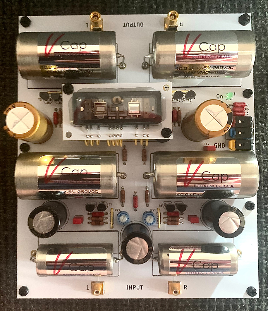

here is the complete board.
Quite spectacular!

Such a beautiful B1K
Waiting for music quality descriptions Congratulations
