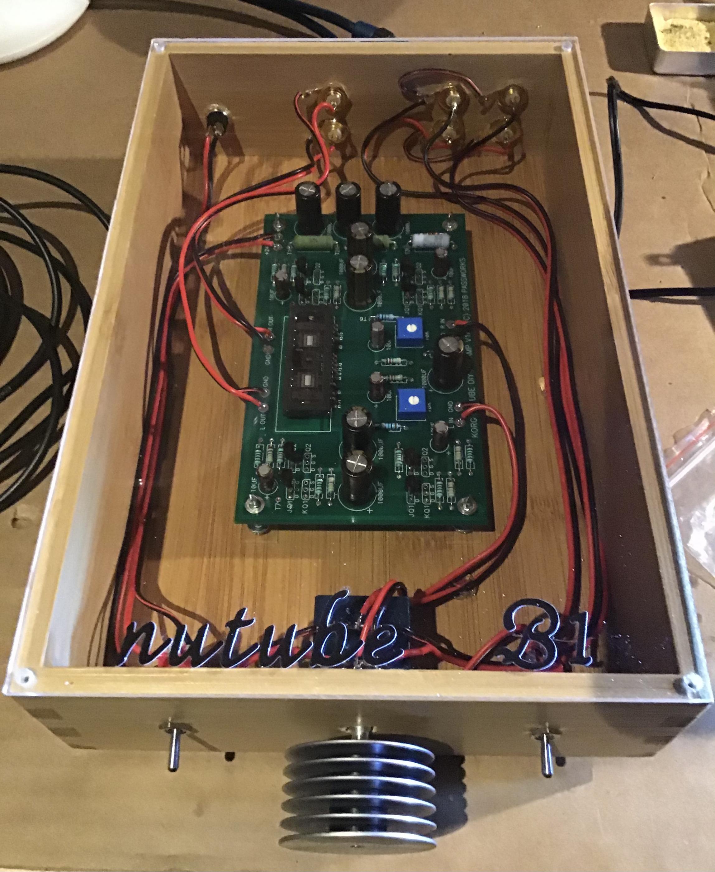

As the DIY store was absent of the “completion parts kit” I consulted NP’s list and sourced directly from Digikey. Chassis is bamboo w/plexi top, volume knob is a vintage CPU heat sink. No ringing whatsoever (have not damped the ‘tube in any way), and best of all it sounds great. Thanks to 6L6 for the well done assembly guideline.
