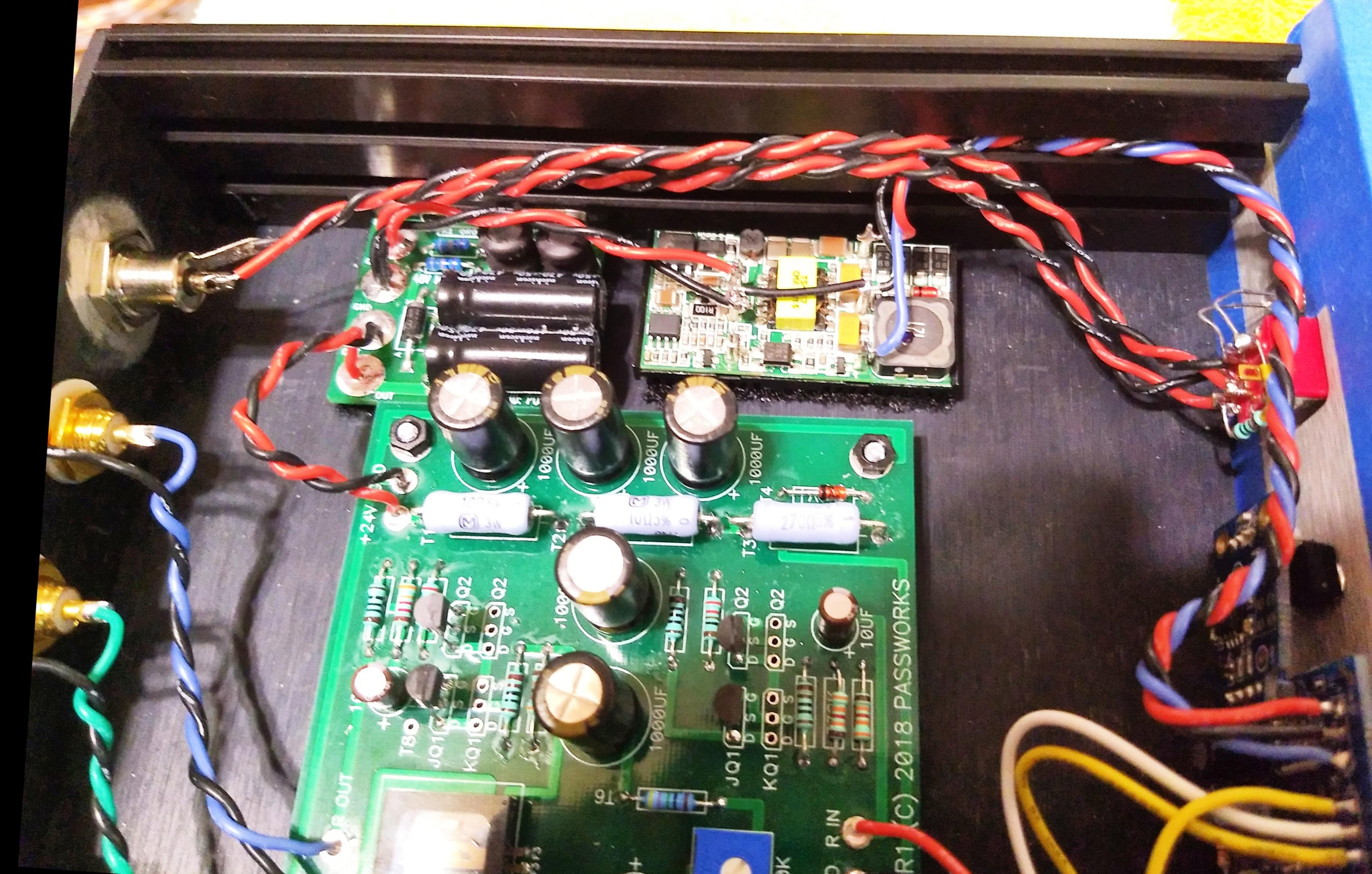

If you want the IR control (essential, IMHO) and you already have the AA VCU, consider trying an inexpensive ($12) power supply board that takes 24V from the wall wart and splits it into +/- 12v~15v for the VCU. No modifications to the Korg at all and later you can add smoothing or pull it out entirely without changing anything permanently. I use velcro with adhesive backing to attach small boards to the chassis (use full size to match the pcb on the chassis side for insulation, a smaller piece on the pcb side 'cause if you use it full size on both sides you'll need a crowbar to lift the pcb later.

Just got my Korg working with the Academy Audio volume control. I was impressed with the Korg before with my older volume control but I'm even more impressed now with the Muses chip volume control installed. I am using a simple SMPS device to convert +24V to +/- 12V for the control but I cannot hear any SMPS-caused issue and the sound is crystal-clear with no strain or veiling that I can discern.

Did you need to get a pcb to in order to use this? It looks as though it needs to be soldered on one in order to install it
No, I turned it upside down and used the magic velcro with adhesive back. See the photo.

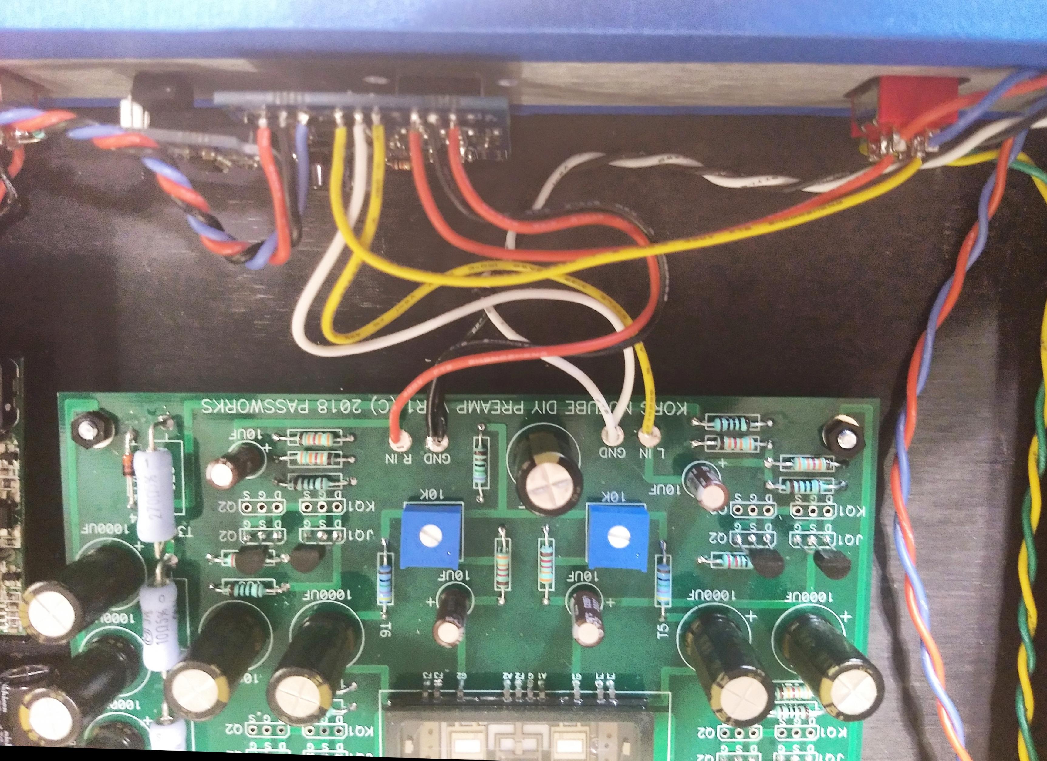

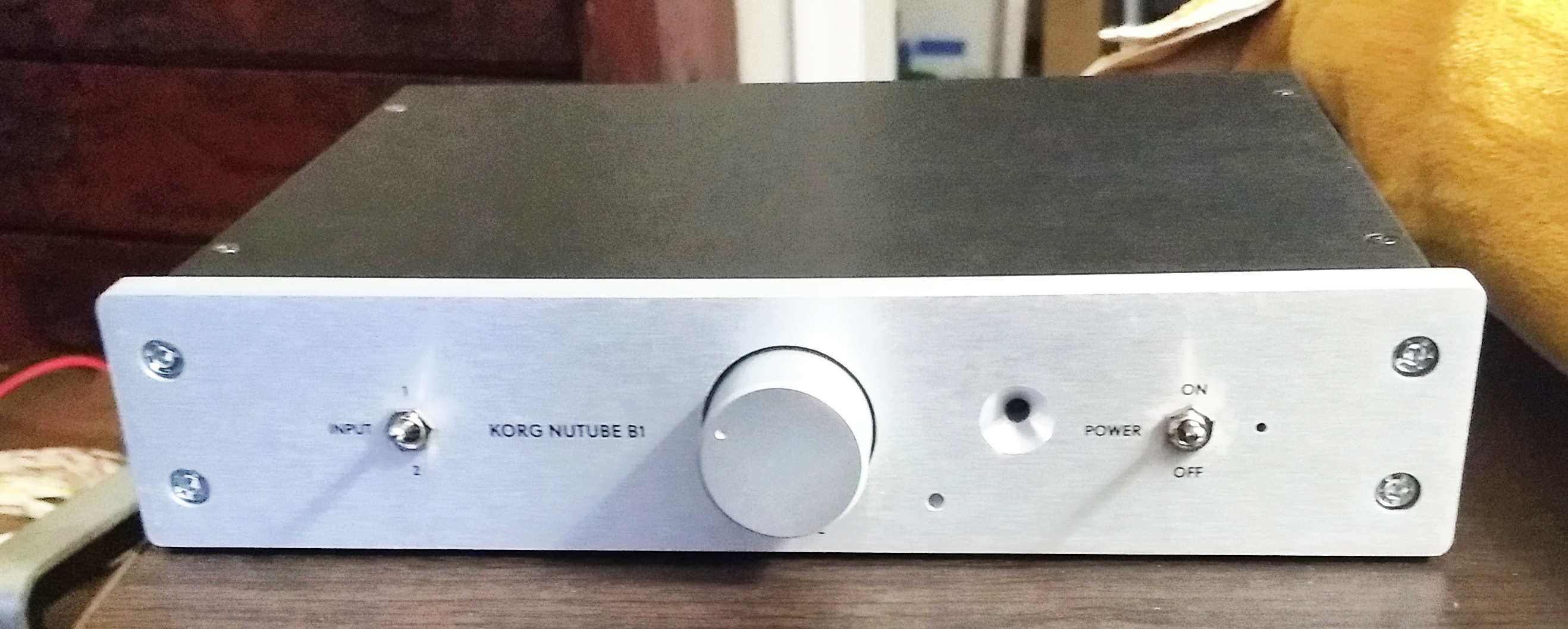

wapo, if you have a moment would you please post a detail photo of your connections on the Academy Audio volume control?

Here it is. The blue color is painter's tape I used to protect the front panel while I worked on the wiring, etc. The extra-long wires are there so I could work on the wiring with the front panel folded down flat on the table.
I unsoldered the pin connectors (slide the black plastic spacer off, then unsolder one-at-a-time), wetted a small mound of fresh solder on the pad, then removed a tiny length (2mm?) of insulation off the end of the wire, wetted the strands together, and melted the wire solder and mounded solder together to form a solid bond. Didn't push the wire through the holes. A fine-tipped iron is pretty important here.
Wired the signal common connections to the pcb pads together with the wires from the input jacks.
I added holes to the front panel to accomodate the IR receiver and the dual-colored LED. I can confirm the IR works from off-center directions. If I'd thought of it, I would have matched the size of the LED hole to that of the power LED, then increased the diameter of the hole on the back of the panel to accommodate the LED. The LED is hard-mounted and needs a hole big enough to accommodate it inside the panel.
One other thing -- the diameter of the AA VCU bushing is a lot smaller than that of the hole in the front panel. I used a short length of .041 (1mm) solid wire wrapped around the bushing to ensure the control was centered in the hole -- important so that the knob will be centered in the hole. BTW, for folks who didn't buy the complete kit and need to find a knob, found mine on eBay from, of course, China. It fits perfectly.
